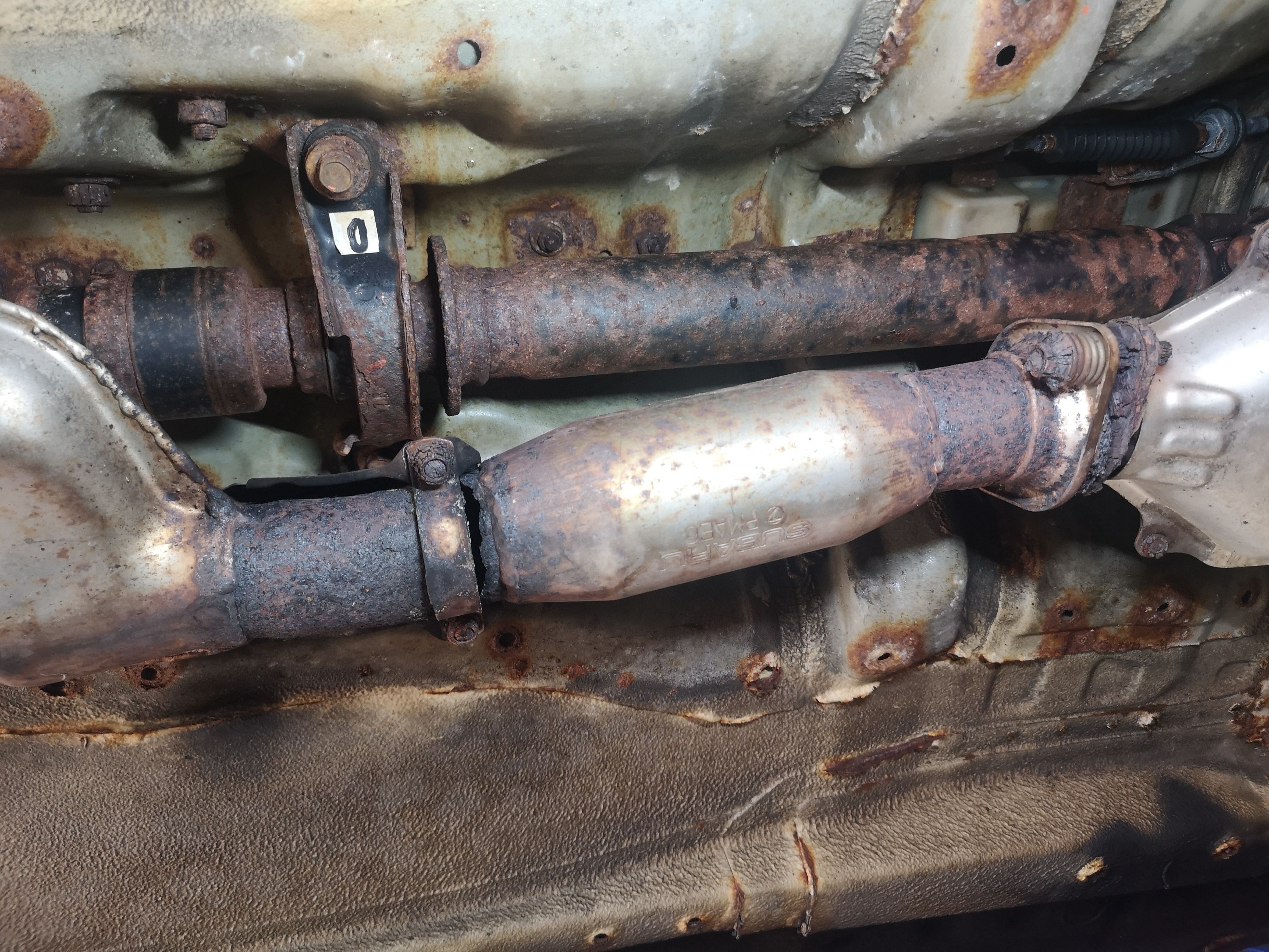

My 2004 turbo Baja has severed the midpipe between the 2 resonators. I'm debating about taking it off and trying to weld it back together or rather just getting a new midpipe.
subarupartsandaccessories.com lists the midpipe https://www.subarupartsandaccessories.c ... AE170.html for $416 (I'm not going to buy it, just looking at it for photo reference) but it doesn't look like my midpipe.
My midpipe more resembles the the midpipe listed at RockAuto for the 2004 Legacy 2.5 (non-turbo). https://www.rockauto.com/en/moreinfo.ph ... 8&jsn=1108 Walker 56243.
What has been other's experience with the exhaust? Does it match the Subaru spec?
My hesitancy with taking it off and welding is that I just took an impreza off the lift after welding a hole in the midpipe and it's still leaking a little through the patch I put on, not feeling the desire to fail another pipe. I probably will take it off tomorrow though since any repair is going to start with the removal of it.

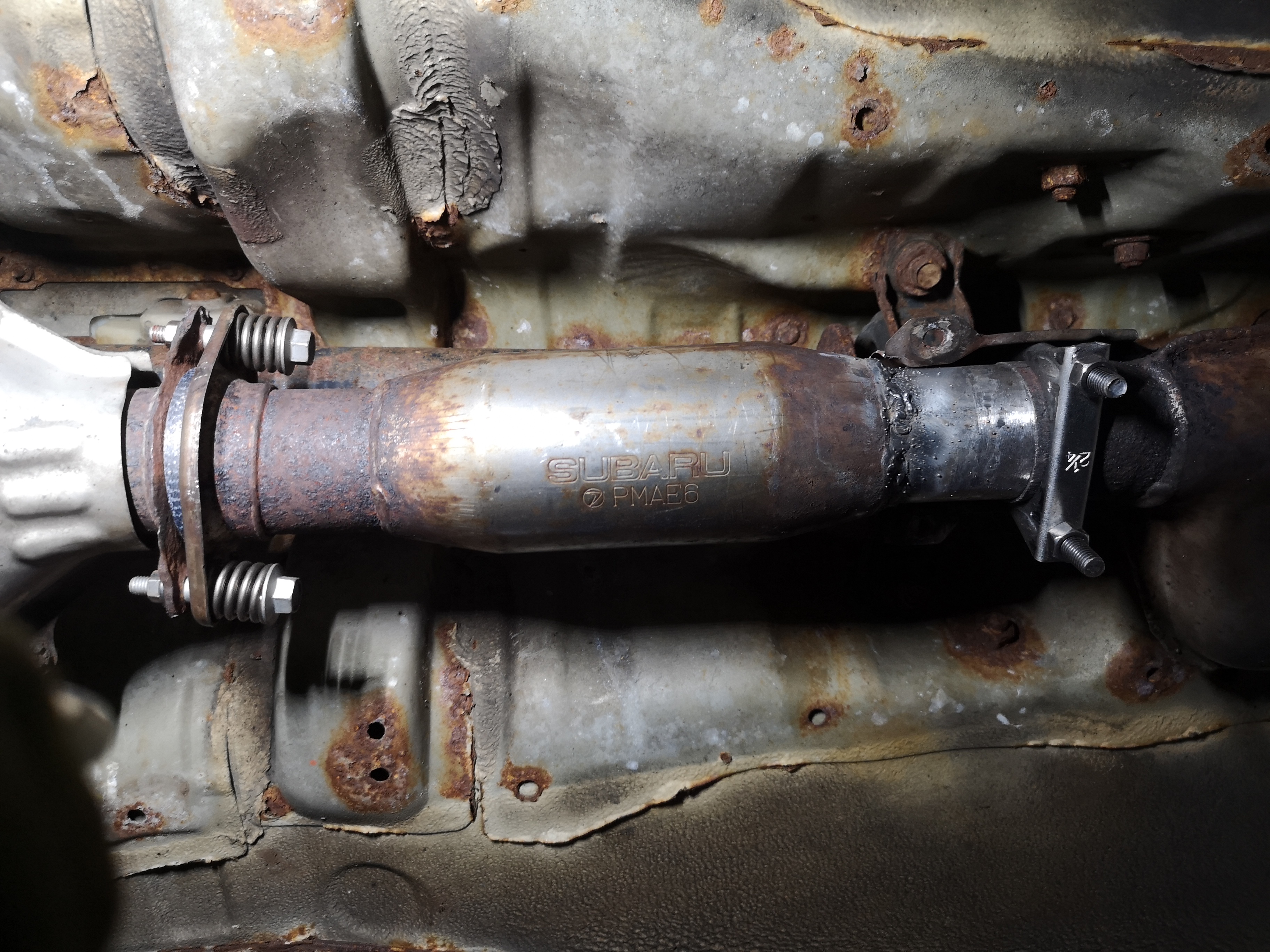

My solution on my NA when it went:
I ended up getting a new midpipe but re-used the split flanges at the flex-joint:
...but you get the picture.

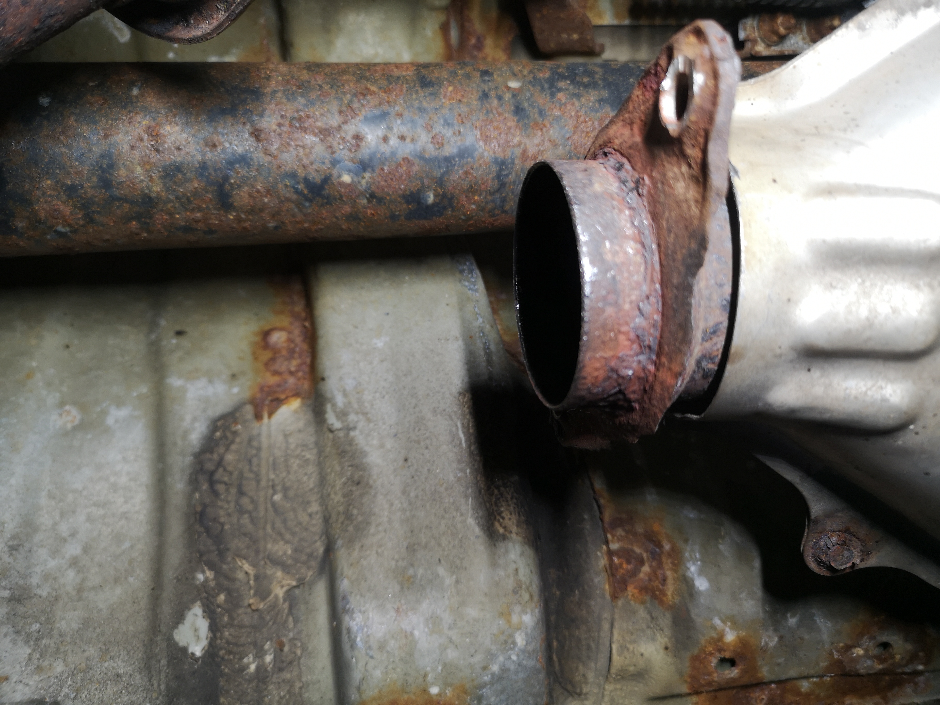

Mine is broken between the first and second resonator, about a foot past the cat.

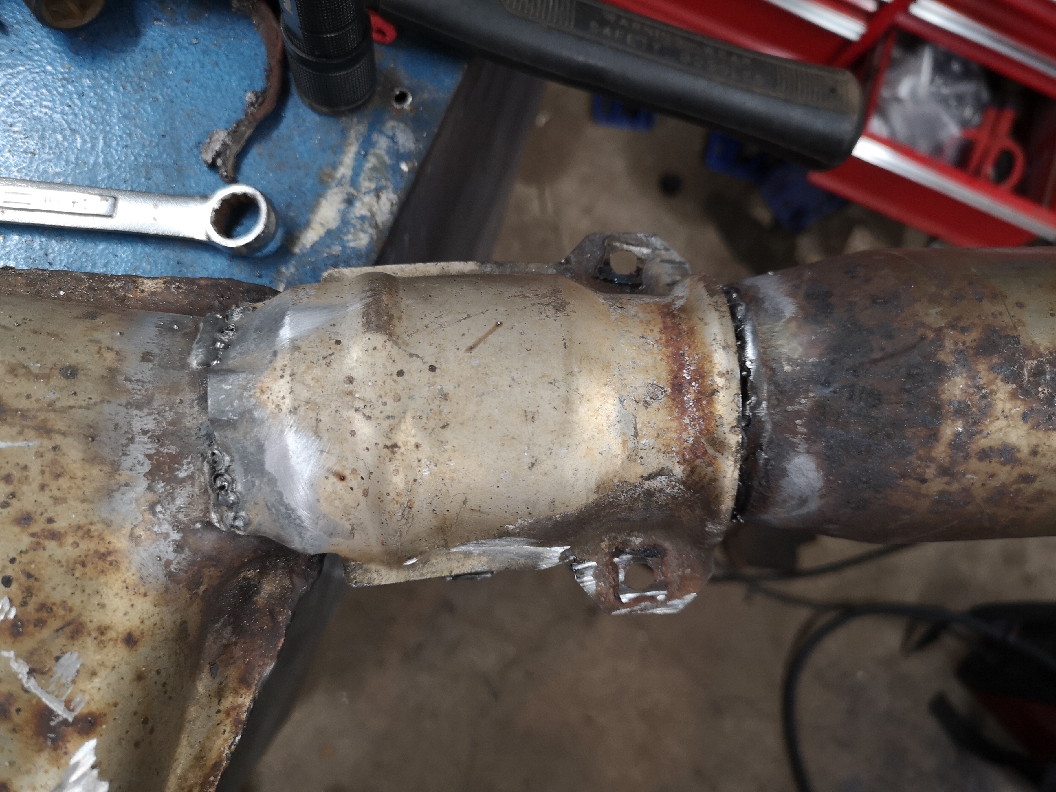

After grinding off the bolts for the front and rear flange i managed to get the midpipe out and cleaned it up. My plan is to get 2.25 OD pipe and slide it inside the existing pieces. Sorta like this picture but the piece of pipe I have is 1.875, this is just for demo.
My plan is to weld it to the front resonator which has plenty of meat to weld to and then simply put an exhaust clamp on the pipe by the second resonator. This gives me the added benefit of not having to be perfect aligned in rotation or length, I'll have a little wiggle room.

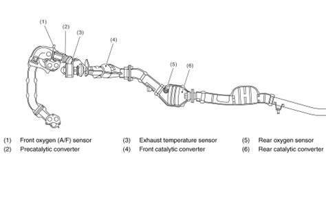

EDIT: I managed to actually find a (albeit small size) full diagram of a Turbo cat-front exhaust system, save this for your records because this is incredibly hard to find! (And this picture if off a now-dead blogspot but the images are still archives)
turbo exhast sytem.jpeg (12.94 KiB) Viewed 20625 times

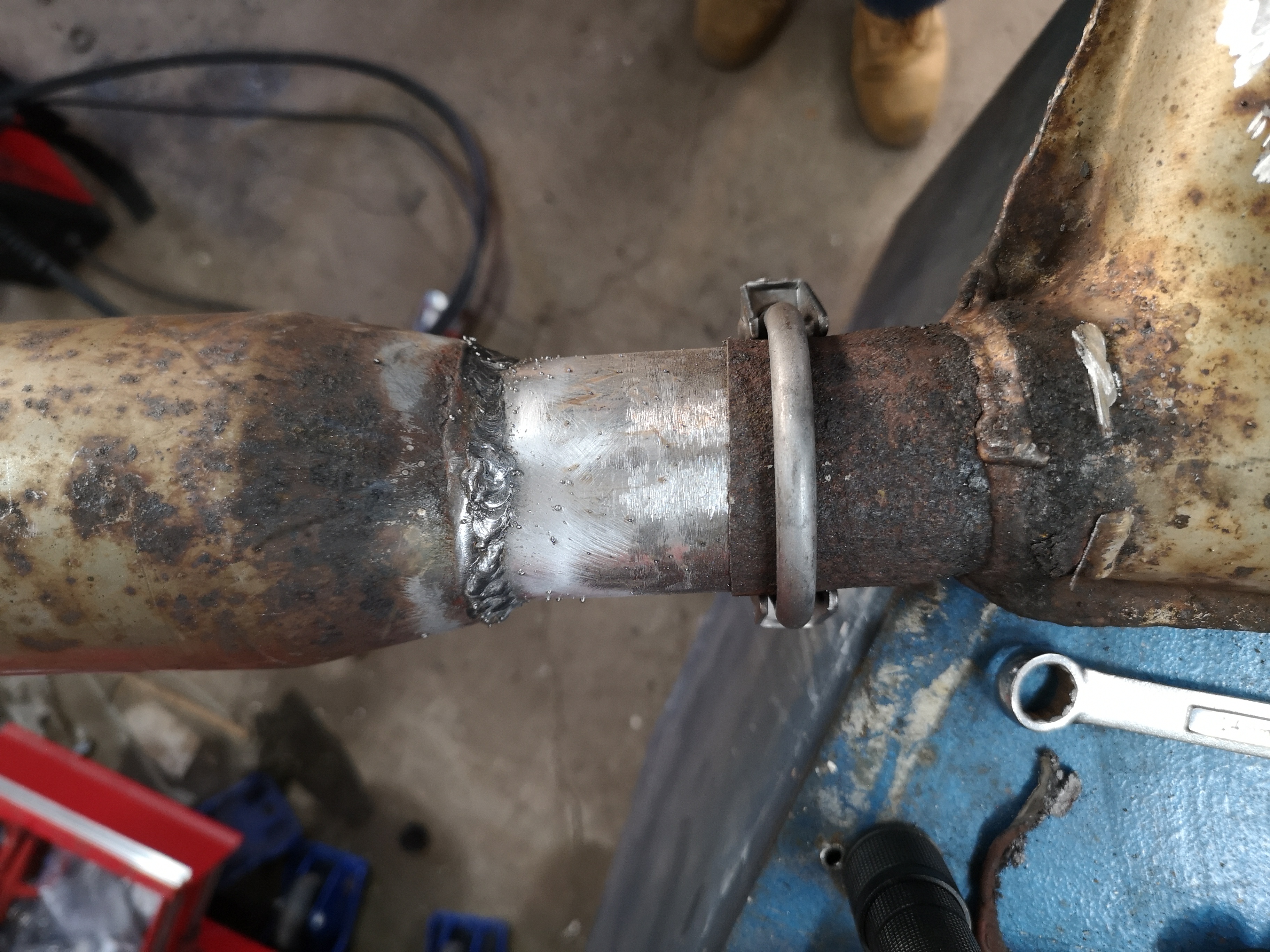

Alright, the Baja is back on the road.
Guacamole, thanks for the valuable info and the pic of the exhaust, I've downloaded and saved.
We both had the same idea on the pre-fitting before welding and a good thing I did. I ended up stretching the new pipe another 1/2 inch more than my initial measurements indicated.
Here's the final product welded in and clamped on:
I even went ahead and reweded the heat shield onto it, I'm guessing since it's right below the driveshat carrier bearing it's there to keep the rubber from failing.

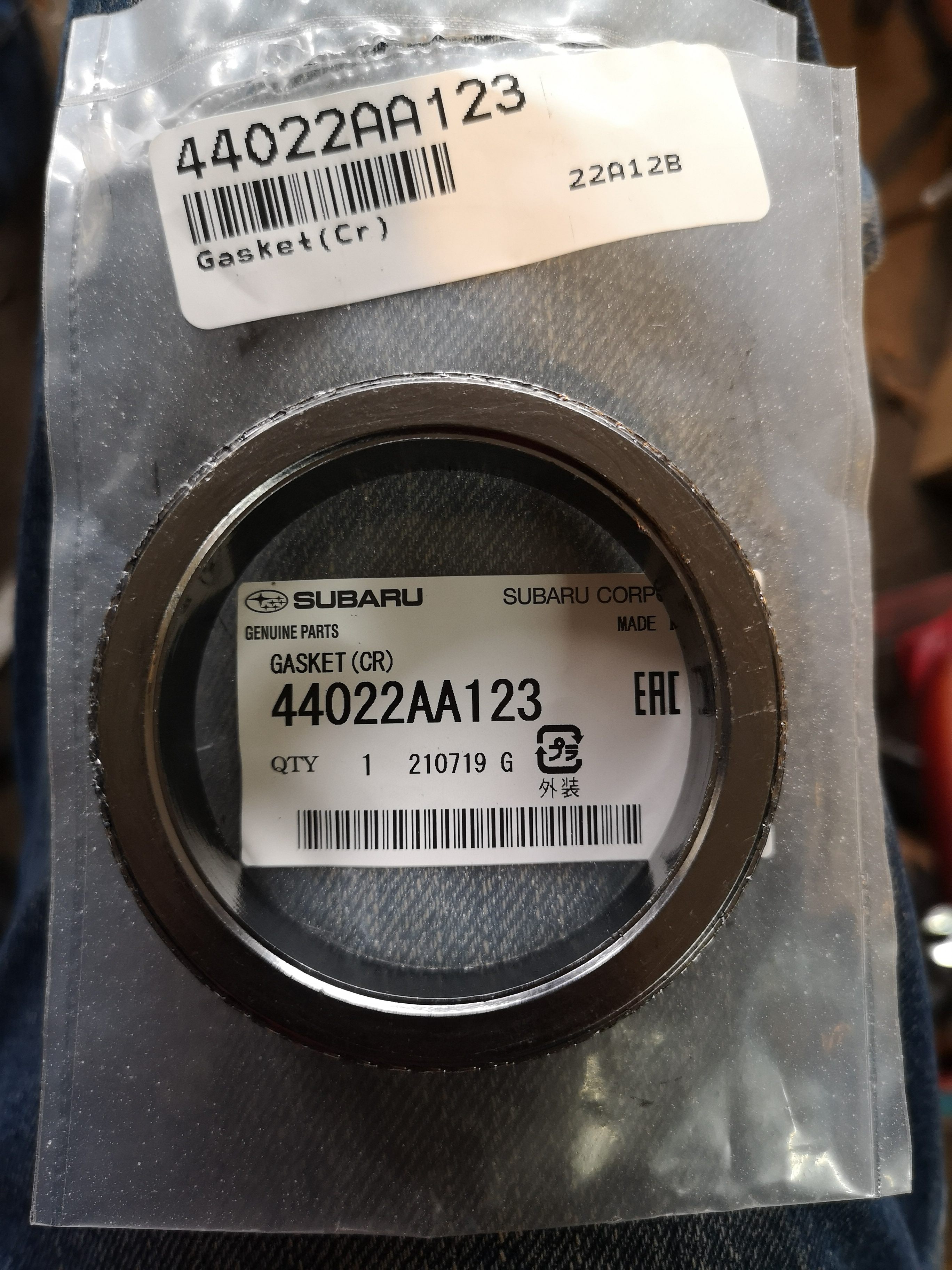

I went to Subaru direct and got the bolts and gaskets I needed.
Here's the parts list and prices for what I got, I didn't want to try to figure out what equivalent parts were.
Quantity Product Stock Number Price EA
1 Catalytic Converter Gasket (Rear) 44022AA123 $19.17
2 Flange Bolt Exhaust Pipe. . NO.1. NO.2. 44059AA010 $4.39
2 Spring Exhaust Pipe. . -1Y. 1Z-. 44044AA010 $5.09
1 Exhaust Pipe Connector Gasket 44011AE01A $4.01
2 NUT 802008270 $2.84
2 FLANGE BOLT 010510307 $2.00
Total ended up being $51 after discount.
Here're are the dimensions for the Donut gasket:
1/2 inch tall
3/16 inch thick
2 7/8 inch wide overall, about 2 11/16 inside diameter.
For the flange gasket the dimensions are:
2 1/16 inside diameter
3 5/8 center to center on the bolts.

Final installed pic of the repair:
One thing that needed work with a chisel and screwdriver was cleaning the Cat pipe to have the donut fit over it. Also cleaning the other side of the flange where the donut rides.
The new repair has zero leakage but I am getting leakage at all the flange points (including the downpipe to Cat connection which has not been touched.
It is not overly loud at all and without being under the car you probably wouldn't notice it so I'm letting that go (for now, until the next exhaust failure).
Thanks for all the help and support everyone! If anyone has questions please don't hesitate to ask, I'll be able to hold the memory of the job for a little bit :)
