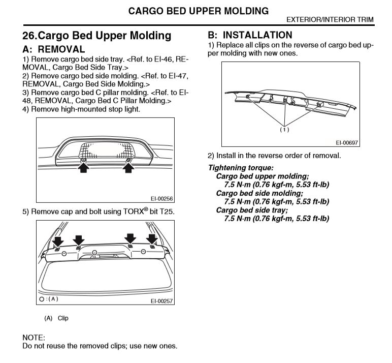

So dumb question here: How do you remove the cargo light lens? Does it just pop off? Afraid to "experiment" with Baja specific parts. Dennis
P.S. I had never even turned my cargo light on until I read this thread.
Re: Rear Cargo Light Modifications
Should just come off after you remove the 2 bolts at the bottom holding it in.
Thanks. When I get a chance, I'll have to take it off and see if I have the correct LED bulbs in my stash. If not, I'll pick up a set. Dennis
