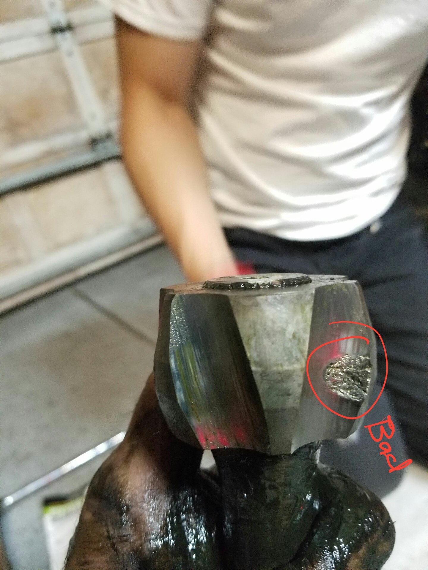

- Bad CV joint from MR2
- 20180618_220647-1.jpg (1.69 MiB) Viewed 12803 times

Wheel bearings are unlikely to cause the hopping/skipping/binding you feel on tight turns. I've changed enough in my time in a shop to know better than to say never but that's much more likely to be a a diff problem. I could see it being an axle though more than a bearing as the rollers actually ride a different part of the cup when you turn.
