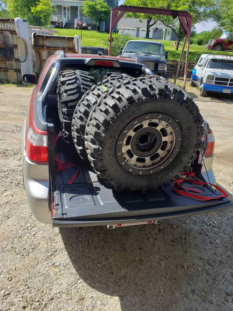

My name is Todd and I am Scoobytrash. As well as Biker trash. I have had a few Harleys and currently still have an 07 Softail Nightrain. I have been an avid Jeeper for over twenty years.... until 2 years ago. I took a 2017 WRX for a test drive with my wife. She bought one. 2 Months later I trade my lifted and locked 2006 TJ and 2009 3/4 ton Dodge truck in an a WR Blue WRX. Now I really do not like having only one vehicle each so I started looking for a viable 3rd vehicle. Needed something that I could drive fairly easy, like AWD very much, something that will not kill me on fuel, and could haul a few things. I find a 2004 Baja Turbo.Now I have my 3rd vehicle all is well.
I am a teacher at a local high school (welding) and get to talking to my auto collision teacher and... we come up with an idea. Every year we take our kids to a show called the Piston Powered Auto-Rama, put on by Summit Racing at the Cleveland IX Center. We are going to have our Senior class do a collaboration project and build this Baja. The scarcity of them makes them noticeable. Not many people take them to an extreme. We intend to do just that.
I feel that I should mention that the auto collision teacher also owns his own custom shop. I have gone over there and welded a few things for him that require structural welding and he knows that I did that for years prior to coming to the school. We are going to put a 4" lift kit on the Baja, 31x12.50 Bogger tires, carve out the fender wells, create a custom roof rack that will hold light bars and pod lights, and create mounts that will hold two spare tires as Boggers are directional. As time passes I will put pictures up as we complete bits and pieces of the project. I will also take before and after pics with the car parked at the same spot.

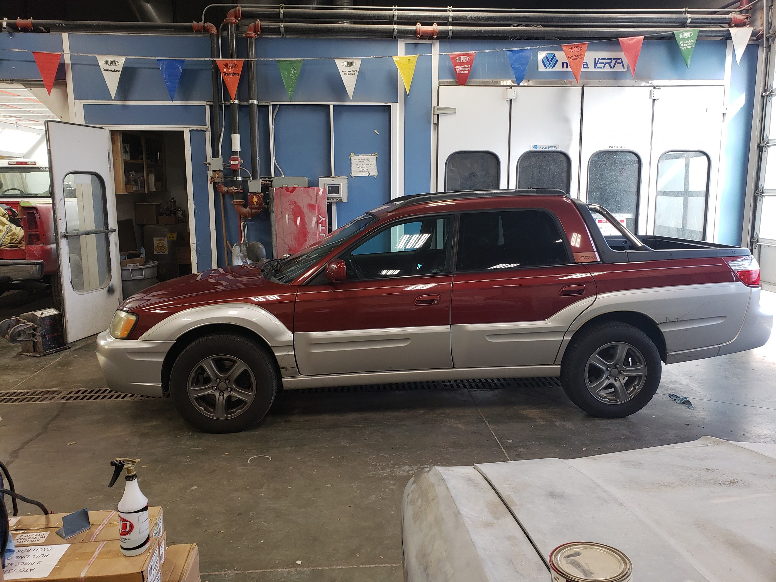

On the body shop side my partner has come up with a colour scheme that I think will work out fantastic. The lower portion that is silver right now will be colour matched bronze to the rims that are we are getting. The top half will be a blue... I think World Rally Blue would be appropriate. There are also rings on the rims that will be painted the same blue so as to tie everything together.

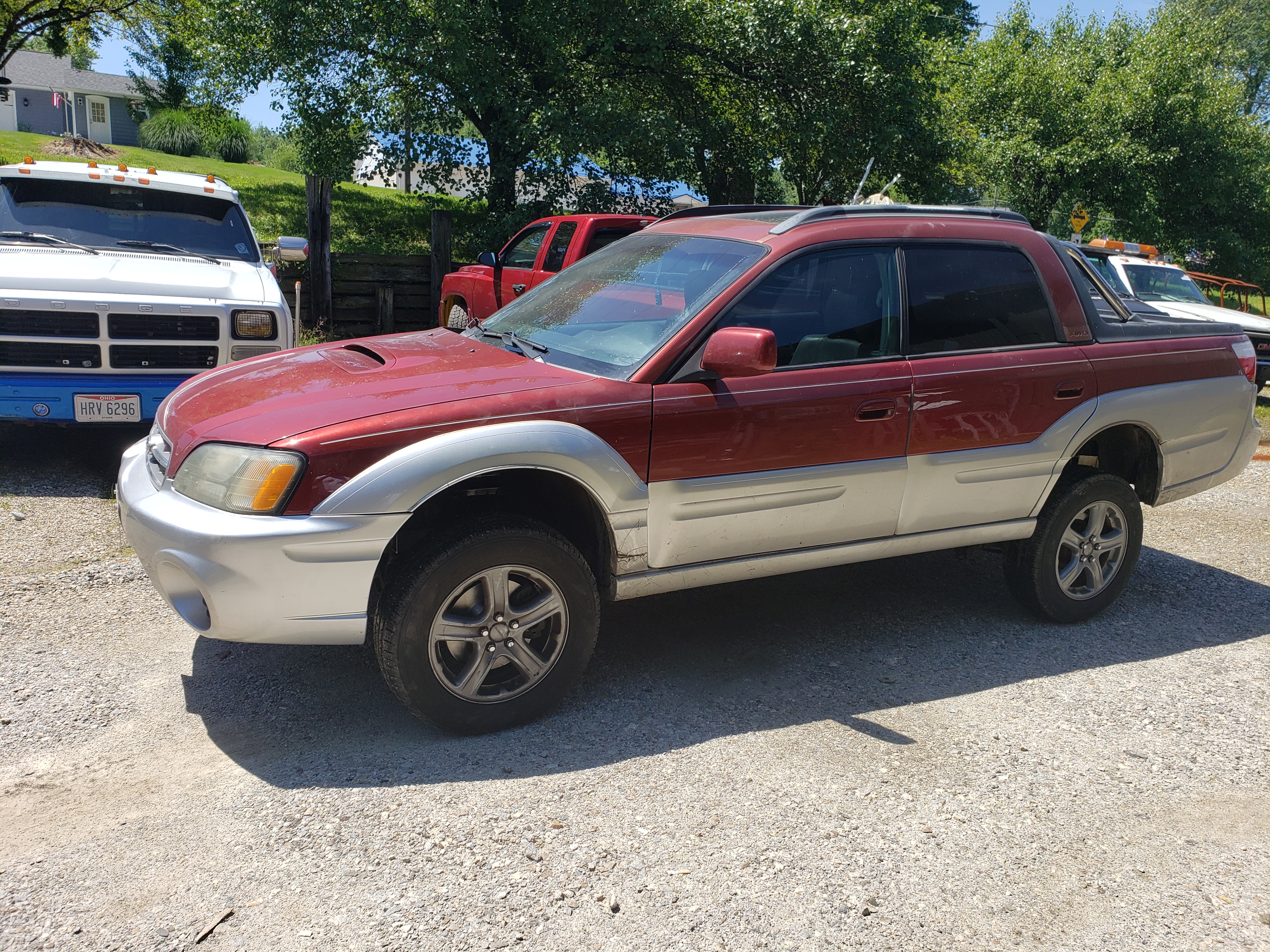

I have taken several photos pre-lift for side by sides to show the difference pre and post lift. Lift kit will be getting installed starting in a week and a half. I have lifted many a Jeep but never something like this. I need to get a steering shaft extension (Piece of tube steel that I will cut the shaft, lengthen it and re-weld it) to complete this lift. Then we can put the rims and tires on. Rims and tires came in and it was fairly funny hauling 6 rims and tires over to the shop I am putting the lift kit on at. I will admit that I was giggling like a little school girl when I got 5 of them in the bed and one in the back seat... need 6 because they are 31x12.50 Super Swamper Boggers and are directional. I will include a photo of that as well. I have run these type of tires before, on my CJ-5. It was fantastic to roll around on 35X16.00 Boggers... but man, do they make a serious road howling. After these are on the Baja, no more road trips.

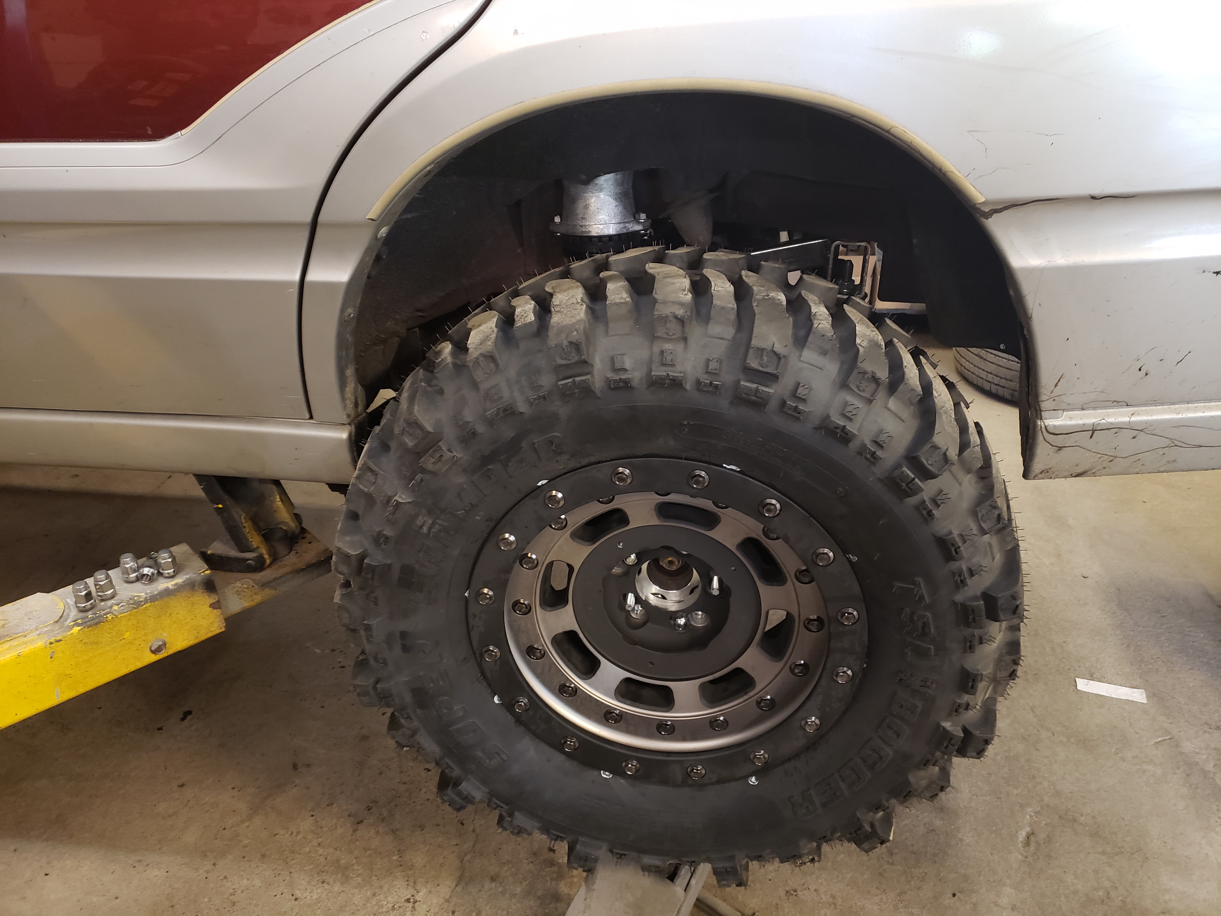

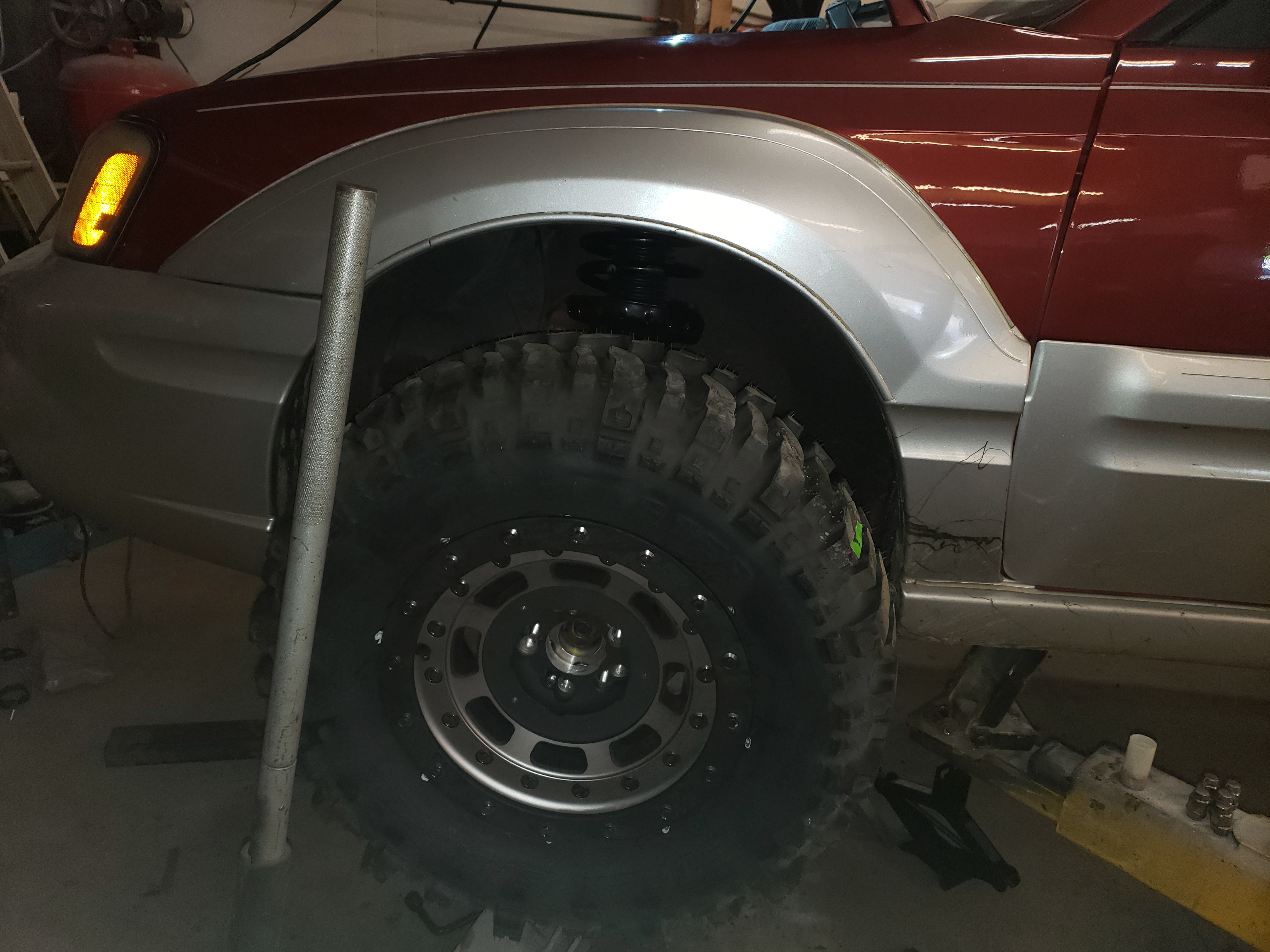

Re: A Project...

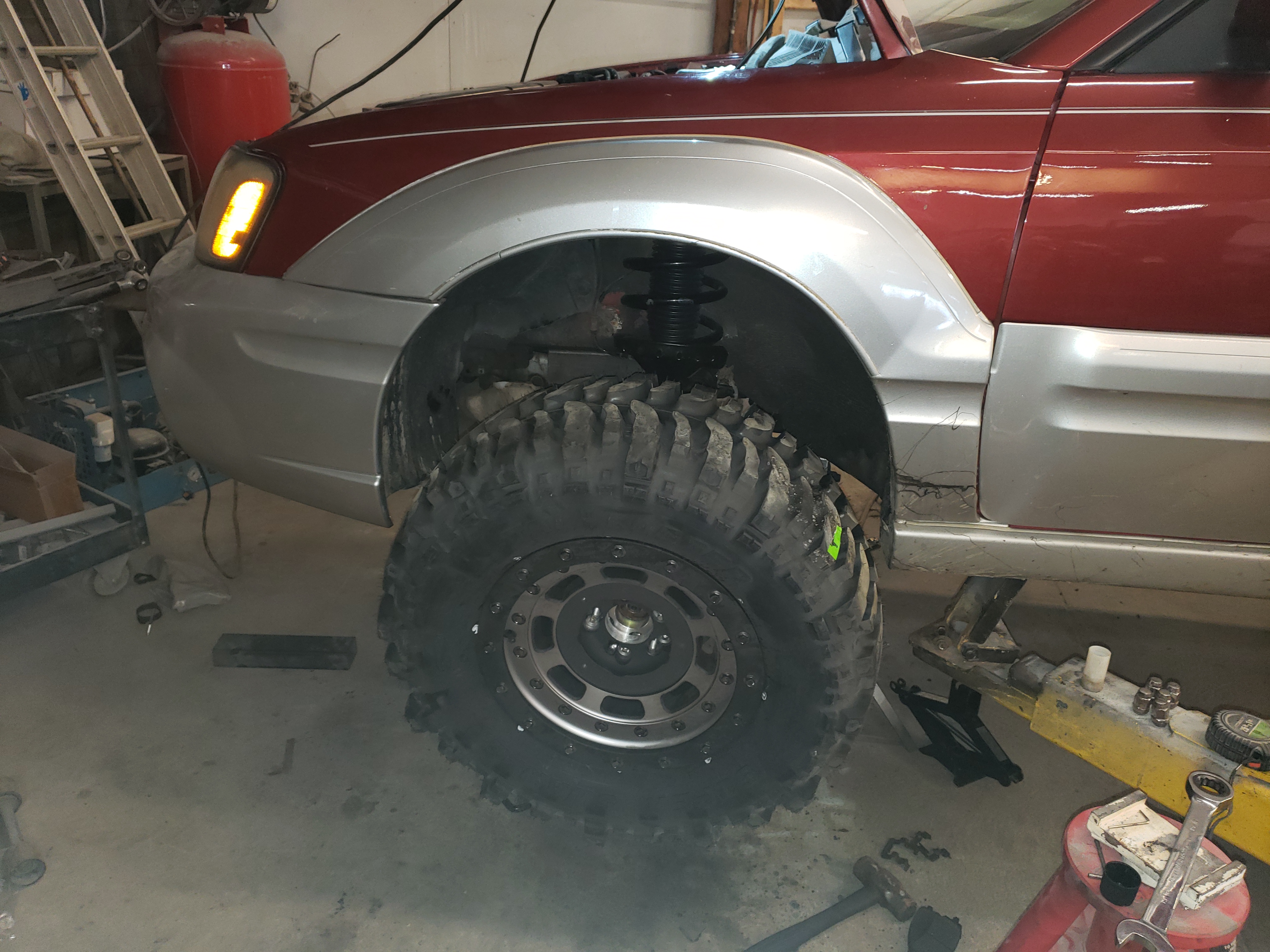

These are pics with the boggers on it... might have to trim a little bit of plastic out and a slew of metal... lol
This is full droop in the front
And this is what ride height would be at... all good going straight... not so much for turning as of right now.

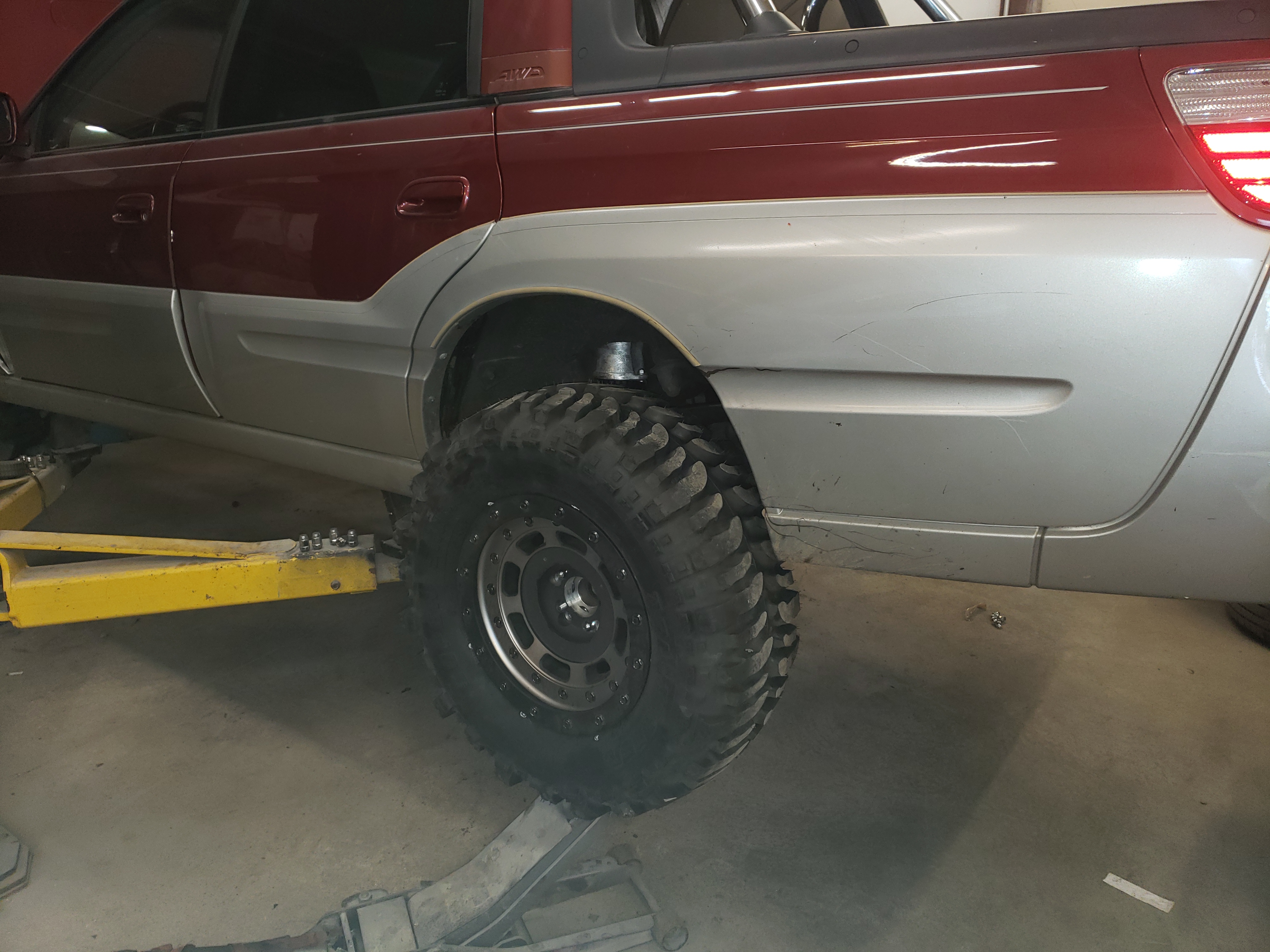

Now the back has a bit more of an issue. At droop all is well.
At ride height.... grinding the front of the wheel well. A bit of trimming required.
