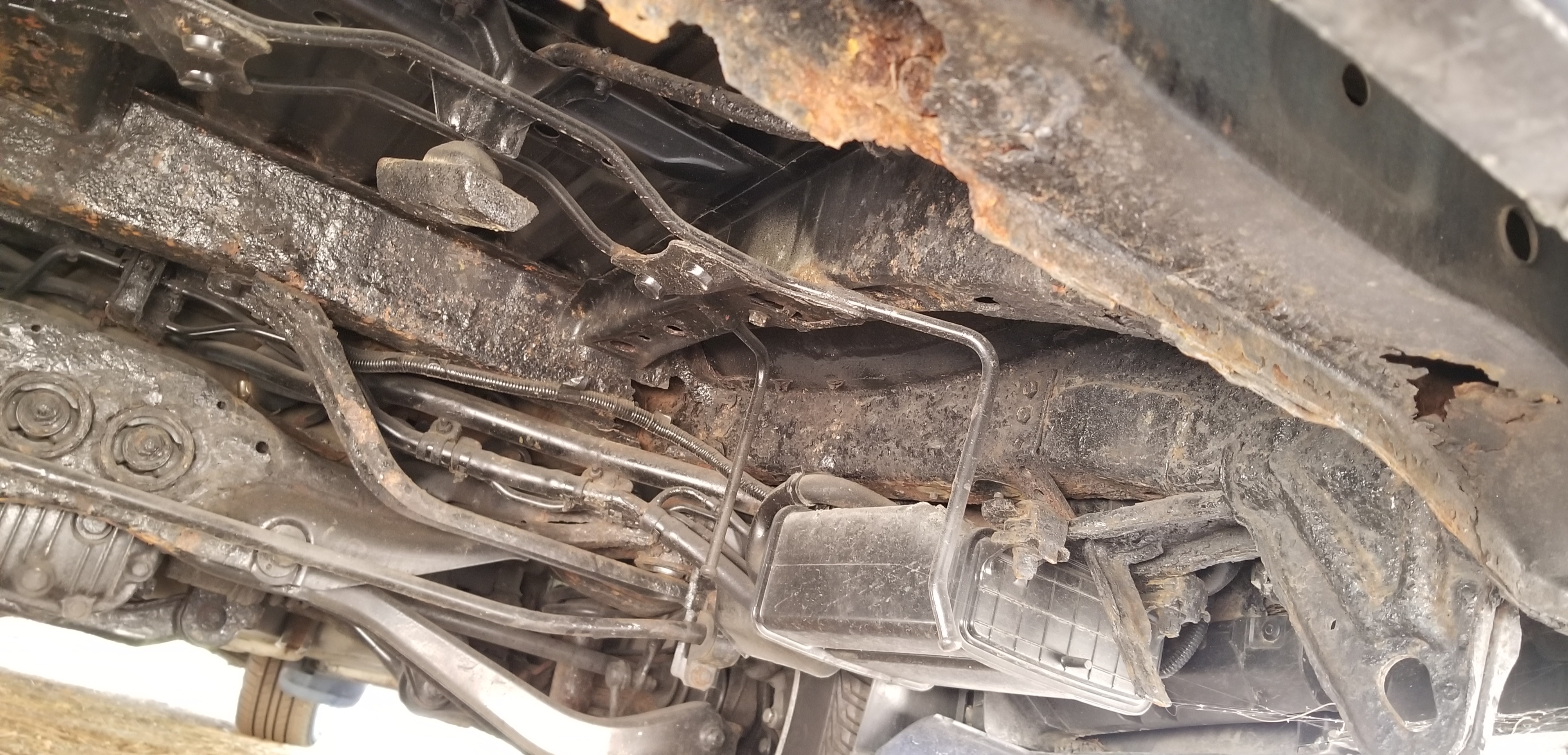

I had fallen on hard times and was graced with this gently used (read beat to crap) automatic Subaru Baja with 170k for a very fair price. She came a long way from Vermont to CA and her rear end is totally cancered out, her parking brake doesn't work and I suspect the u joint needs replaced as well as a couple wheel bearings and perhaps sometime soon her transmission bearings. The windshield bucket leaks and the axle boots are on the way out. The power steering pump complains at full lock and whistles sometimes, the ac compressor will not keep it cool above 85°. The exterior is a mess.

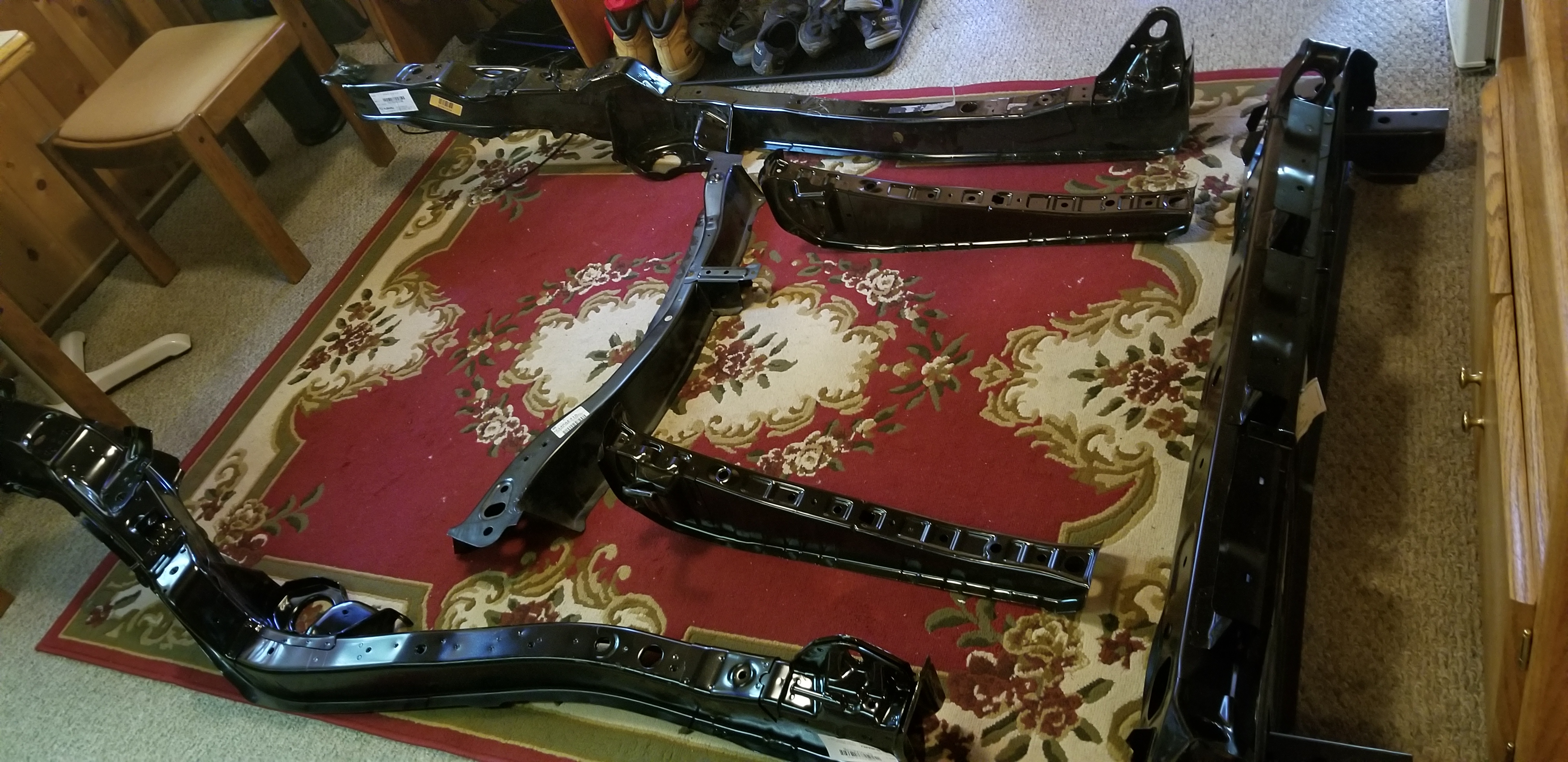

So far I've already purchased every piece of the rear frame including a new subframe. I had to get a duplicate LH lateral support because they don't make RH any longer and I ended up with the crossmember of a wagon variant but my welder assures me he can make them fit if they're not close/exact already. I chose not to purchase a rear bumper beam and to instead have something similar in shape but strong and reinforced made to mount a hitch in a bit higher than aftermarket because of the poor departure angle and terrain, then just slap the foam absorber back on and stock cover.

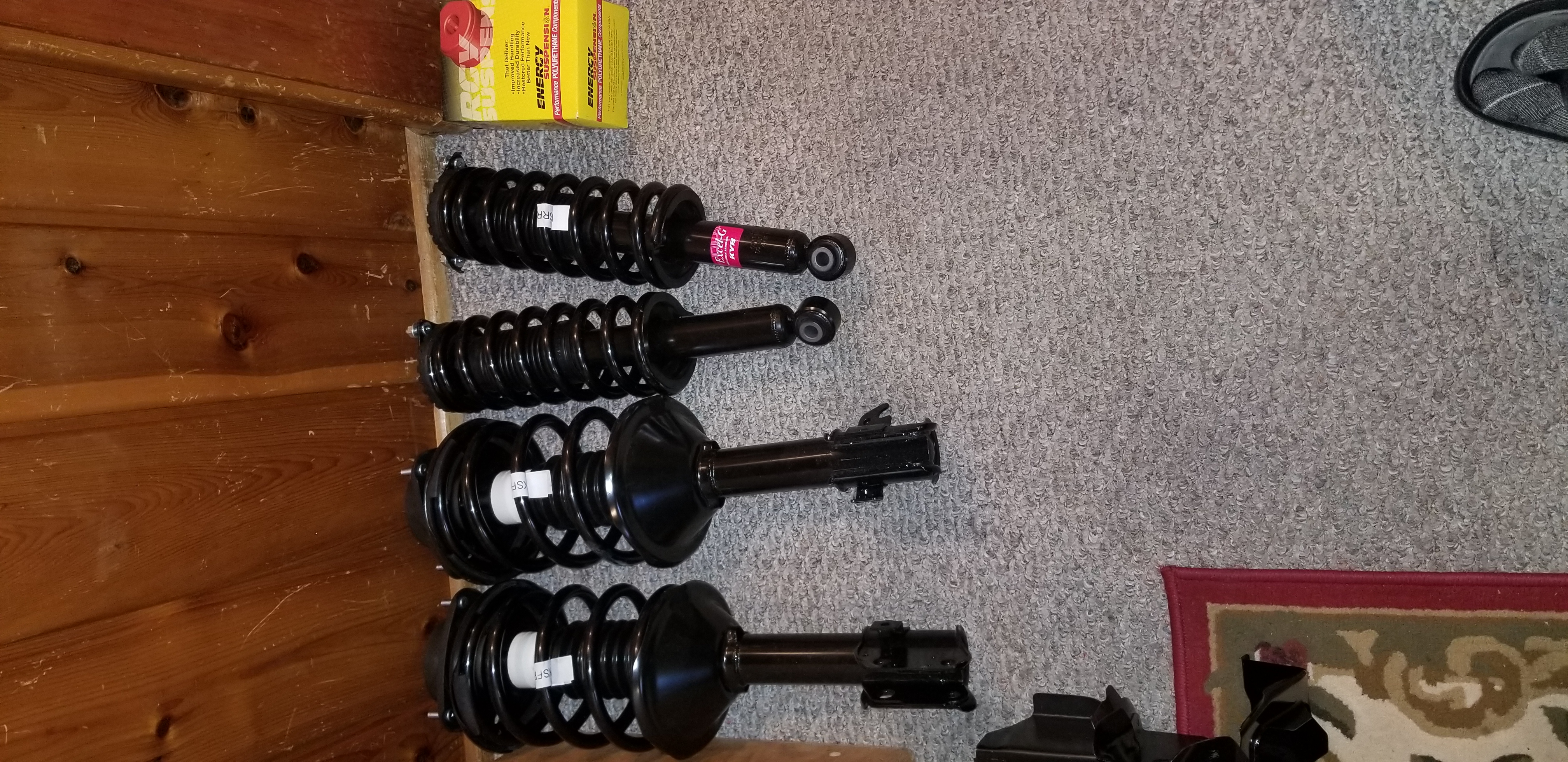

I have 00-04 legacy King lifted uprated springs and new GR2 struts waiting to be installed. I'm barely managing with the blow rear struts and sagged out rear springs but she is holding up fine. I also have an ADF 2/2½ lift and trailing arm spacers en route as well. I also have brand new Raybestos element pads and rotors plus new parking brake shoes waiting to be installed.

- Mm, crunchy.
- 20190607_190158.jpg (4.09 MiB) Viewed 10469 times

Speaking of which here is my entire rear frame replacement. My welder is going to cut everything out he doesn't like and replace em. You will notice two identical Lateral supports that go beside our spare tire carriers. I had to order two identical LH side ones because they don't make RH any longer. They are the same except for the extra exhaust hanger on the RH side which can be removed. The center horizontal crossmember is from a wagon variant but I just checked and it is identical to the Baja variant crossmember.
You will also notice two entire Lateral RH and LH frame pieces. I got the entire unit just in case anything forward of the rear diff is bad and needs replaced.
Also pictured is the inner rear skirt and outter rear skirt. My buddy will be making me a new beefier bumper to carry a 2" hitch instead of going oem, he said he'll probably tie it into those identical Lateral supports like aftermarket hitches do. It was going to cost $300 for that rear beam so I figured for the cost I'd have him whip something up and zip tie the foam absorber to it and stick the stock cover back on.
I have a replacement rear subframe too but it's too heavy to keep moving so I banished it to the outdoors. I also purchased a replacement rocker panel and rear sill (not pictued) so if he finds rust he can replace those without wasting time.
In case any wondering this is the entire rear frame sans the spare tire crossmember (which was good cause it was shielded from road salt), rear LH sill piece and forward crossmember and it cost a total of $1,300. My welder approximates it will cost $1,200-$1,500 for everything I've asked for. I can see how autobody work is so expensive!
Threw in a pic of the new suspension too!
- New suspension. Kyb gr2 and king lifted springs 00-04 legacy.
- 20190608_130720.jpg (3.38 MiB) Viewed 10439 times
- Anyone like puzzles
- 20190608_131441.jpg (2.51 MiB) Viewed 10439 times

Those parts look fantastic. To be clear, are those struts the 2003 Baja KYB's ones? I'm curious to see the difference in ride height with the Outback King springs.
My last "adventure" Subaru was a 1998 Impreza Outback sport, and I did brand new KYB's and King springs on that. Since that car had a factory 1" lift compared to the normal wagon, sedan and coupe, the King Springs only lifted my car approx 0.5" higher. But they were significantly stiffer than factory (the brand new struts played a part in that I'm sure), so the car handled on and off roads with aplomb. I really like that suspension combo.

They are the uprated 03 Baja KYB Excel GR2, yes. I'm not certain if they are stock length. If they are I might lose a little suspension travel with the +1.1" King Springs due to preload but the +30% stiffness definetely helps with loads and the mountain roads so it's worth the trade off. King Springs are also lighter than oem so frees up some weight in the corners. Sounds like a sweet little ride! I had a similar setup on my 05 OB. I do love this combination as well!mike-tracy wrote: Sat Jun 08, 2019 1:54 pm Those parts look fantastic. To be clear, are those struts the 2003 Baja KYB's ones? I'm curious to see the difference in ride height with the Outback King springs.
I will take measurements before and after the install.
I also have a 2" front and 2½" rear lift by ADF coming in. I don't know how it will effect body roll in the corners but stock 8.4" height isn't enough to keep my undercarriage off the ground especially in the rear with the poor departure angle.
