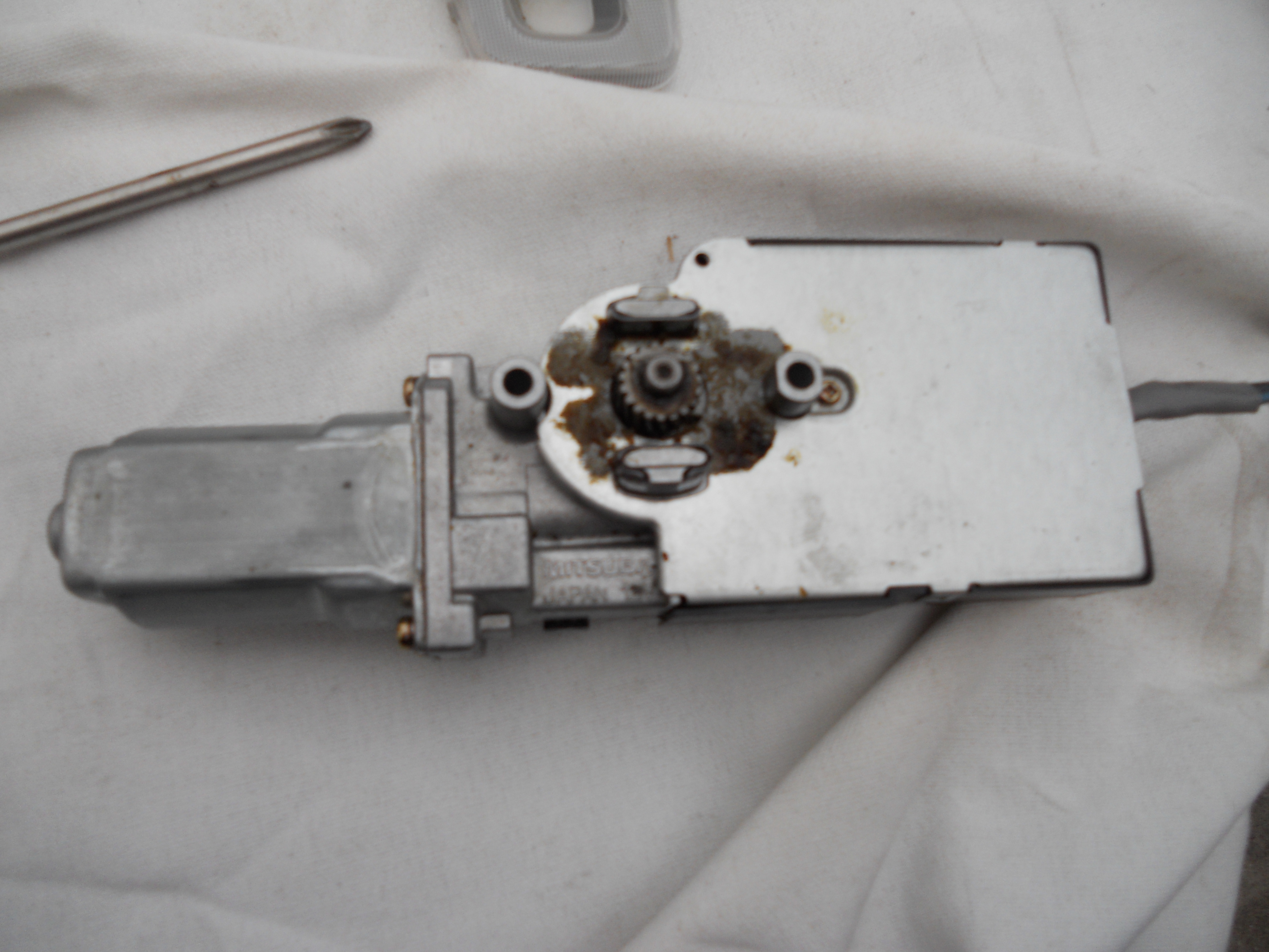

Top view small gear drives spring =like cable that moves

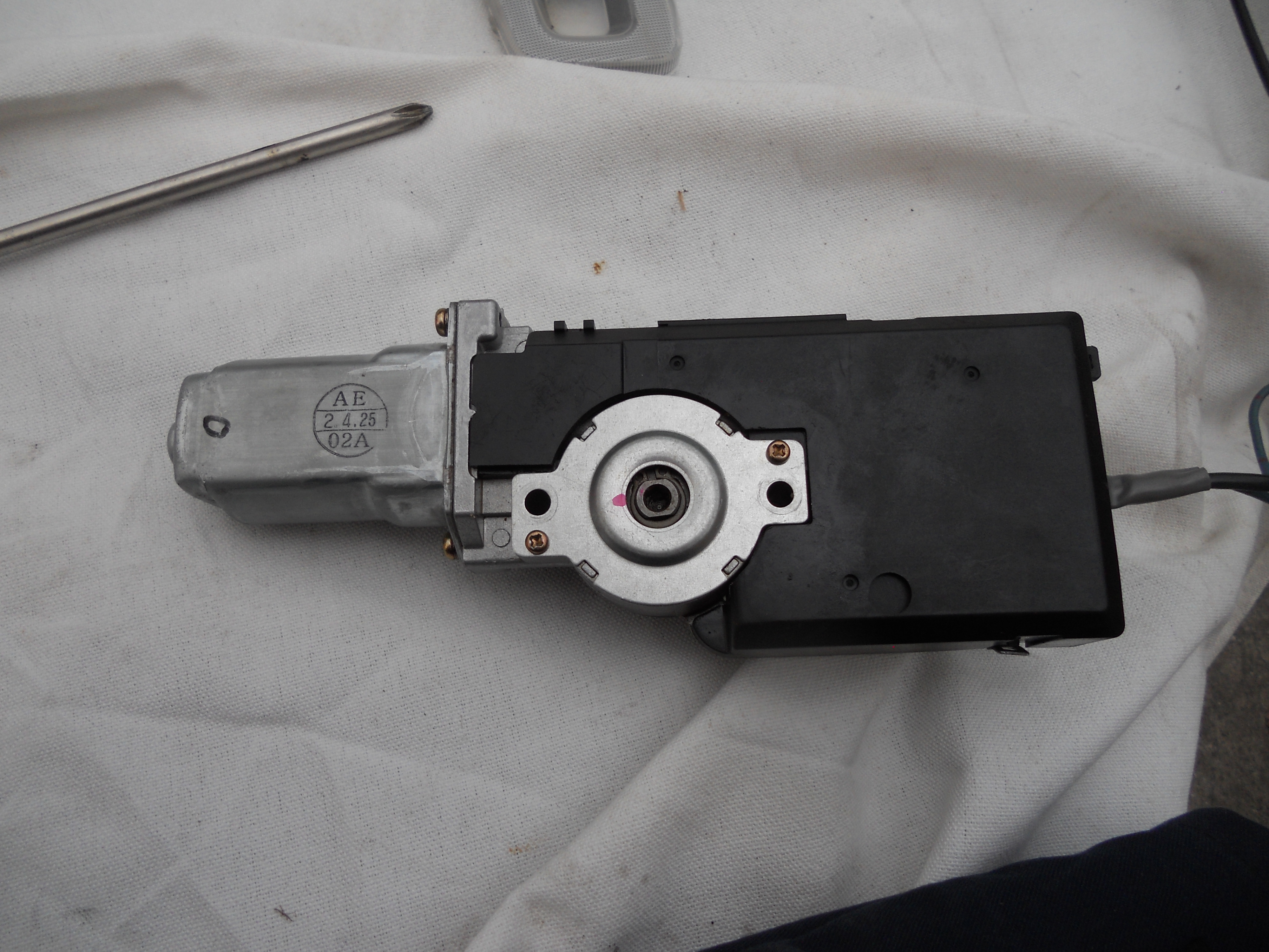

Bottom view hole in center is a hex key hole for manually opening or closing roof.  Dome light fixture must be removed first (yes, it's dumb)

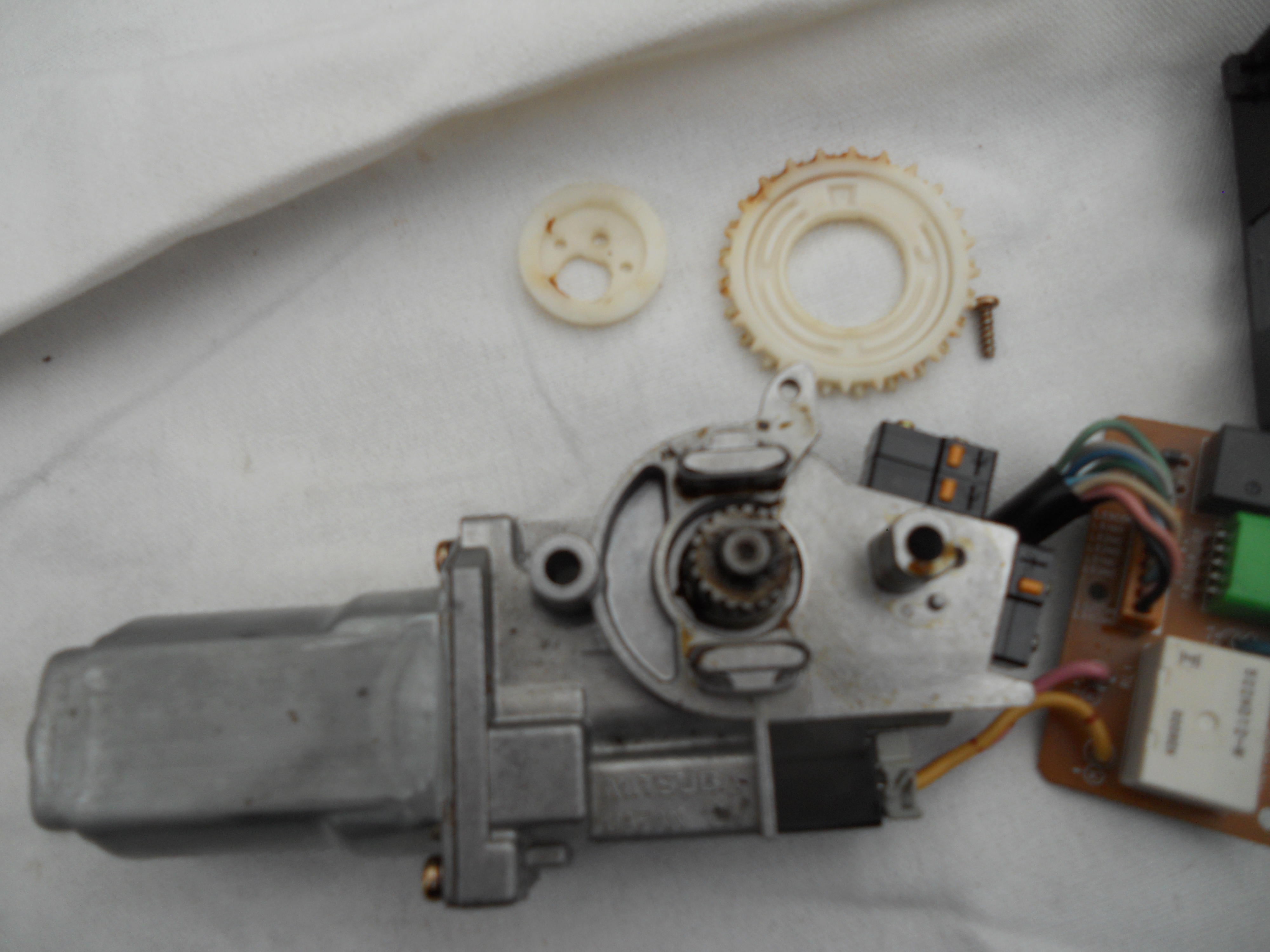

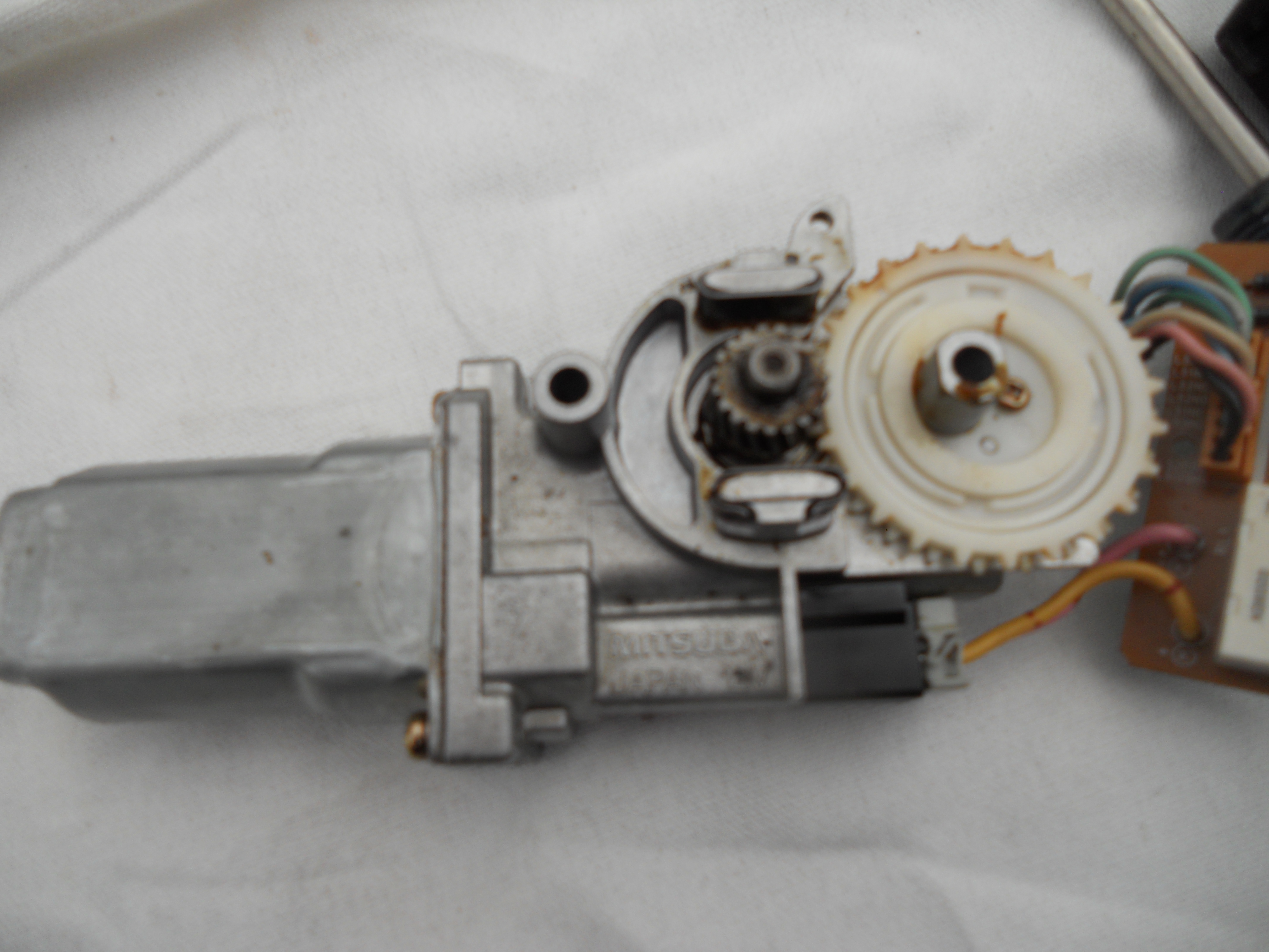

top view with covers removed showing cam gear (white)
Re: Sunroof issues
top view of sunroof motor with covers and cam gear removed showing micro switches. Circuit board is to right. White box seems to be relay.
Green is plug going to switches, black box is ??? Maybe reversing relay??? It seems to function where the switch powers it up and latches "on".
The cam / micro switch interrupts the circuit for the safety feature or fully closed, fully open, or vent mode. (as best as I can figure)

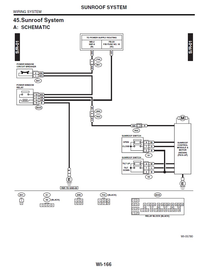

Here's wiring diagram for sunroof. Definitely let us know how it goes.
Re: Sunroof issues
Thank you for the schematic. It only took me about an hour and a half to take things apart and come up with that on a sheet of paper by tracing wires (I also drew up a schematic for inside the module box).
Wish ANY of it helped.
Originally, when working correctly, push the open button back and it opened. Push it forward and it closed partially, push it again and it closes completely. That's they way it is SUPPOSED to work. I never really used the tilt / vent option (didn't know what it was - I figured "up and down" were for the antenna (WRONG).

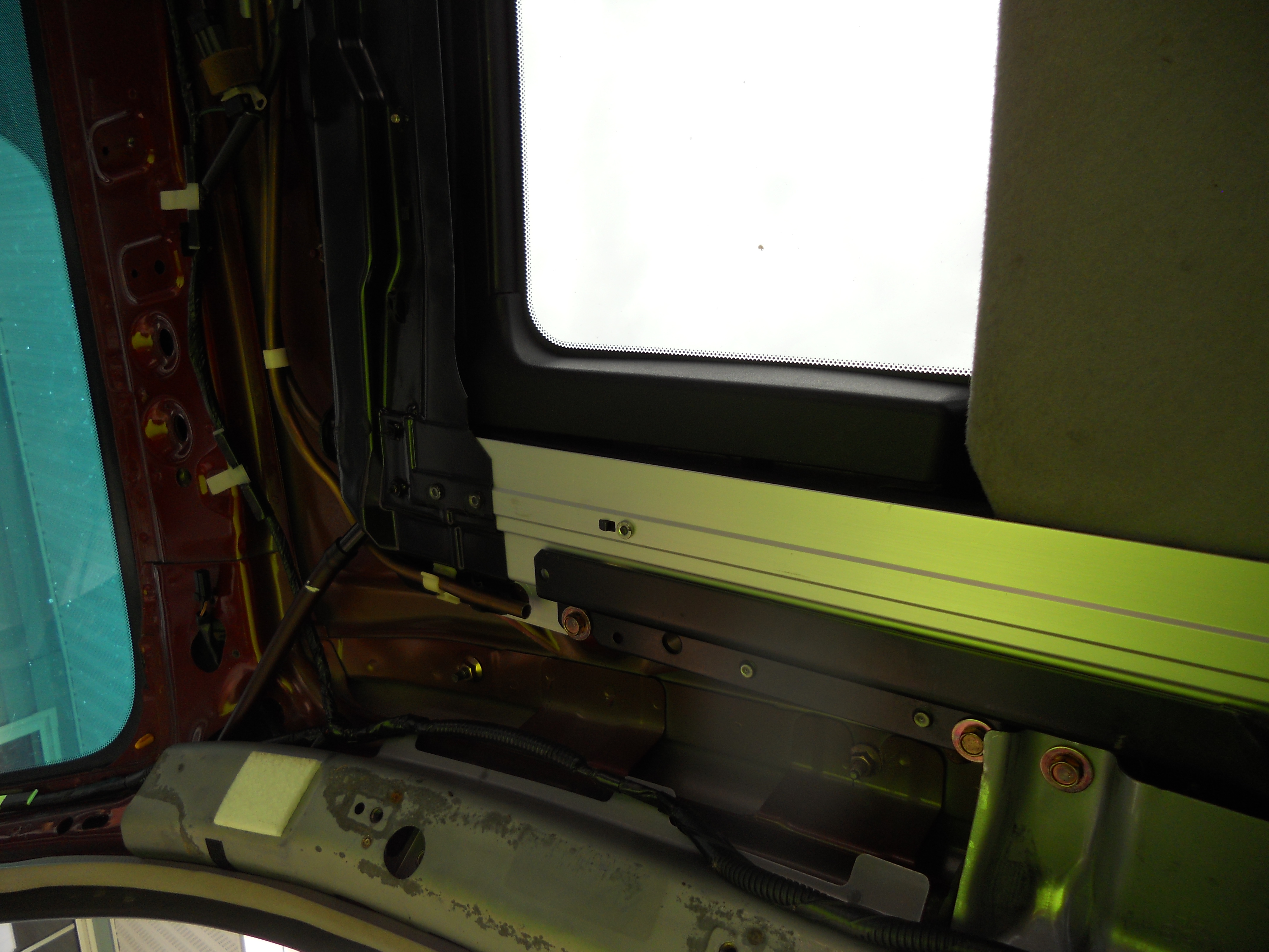

Currently, it seems to do whatever it wants. I have to mess with the up and down button, and then it will open. Push close, and it closes almost all the way, and I have to finish closing it with the up - down button. I have 2 motor / module assemblies, my original, and one I took from a Legacy sedan yesterday. I have 2 sets of switches. I can swap any of it around and I get the same results. I went so far as removing the entire headliner to see if maybe there was another micro switch in the track I didn't know about. There isn't. I did find that I have a rust issue in the R/R corner of my roof under the cargo rail :roll:. I also wanted to pull the headliner to clean it. The P.O. hauled a bunch of little kids and a dog around the the headliner was very dirty. Some spot cleaning seems to indicate it will clean up okay.
Oh, did I mention that it rained today :shock:. Fortunately, I had the roof all in the closed position before that started.
I will post pics of what I did in case it helps someone else.

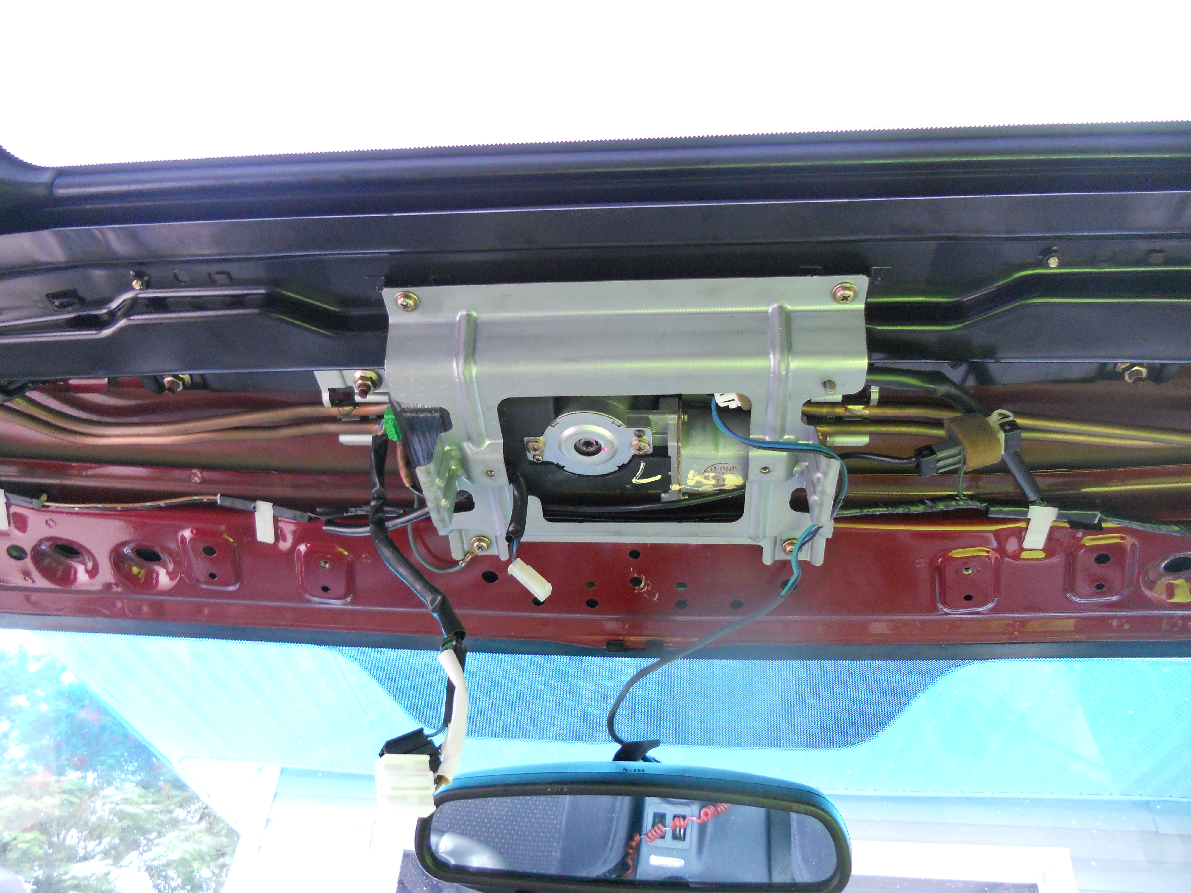

right side track
right side track
center track with motor
left side track
