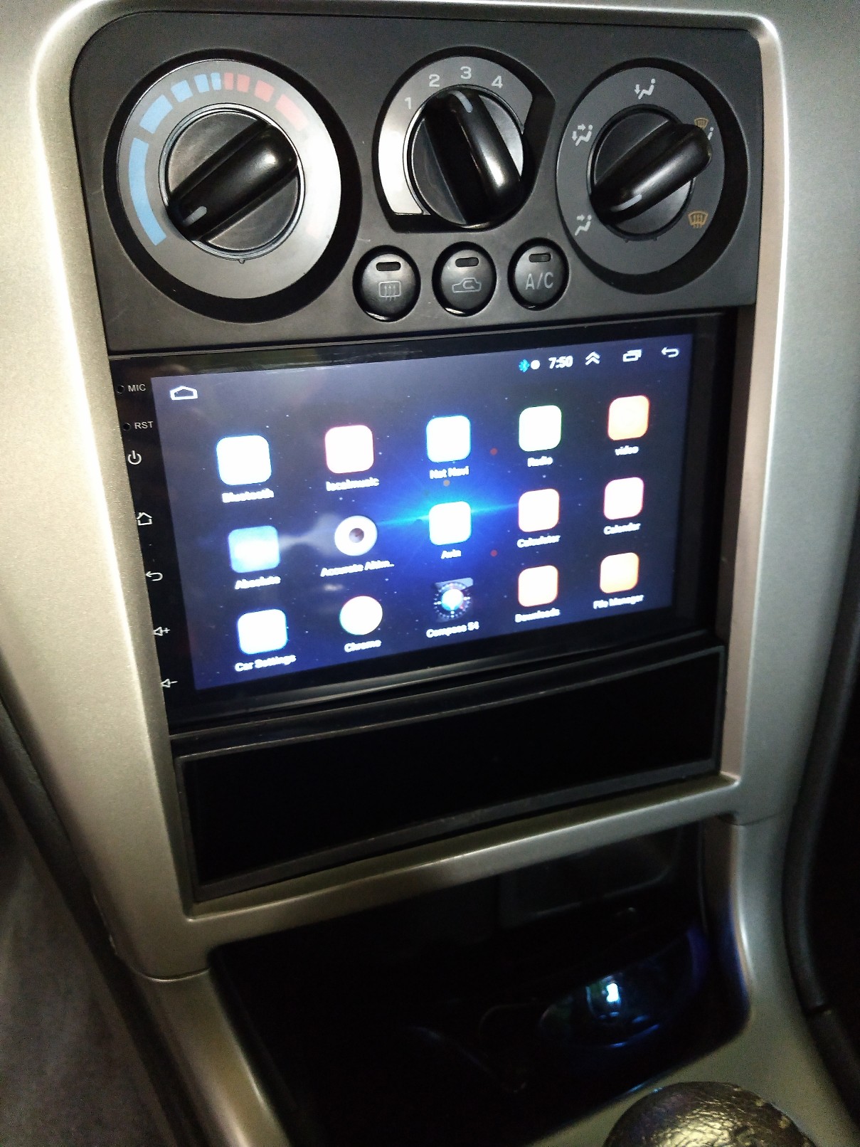

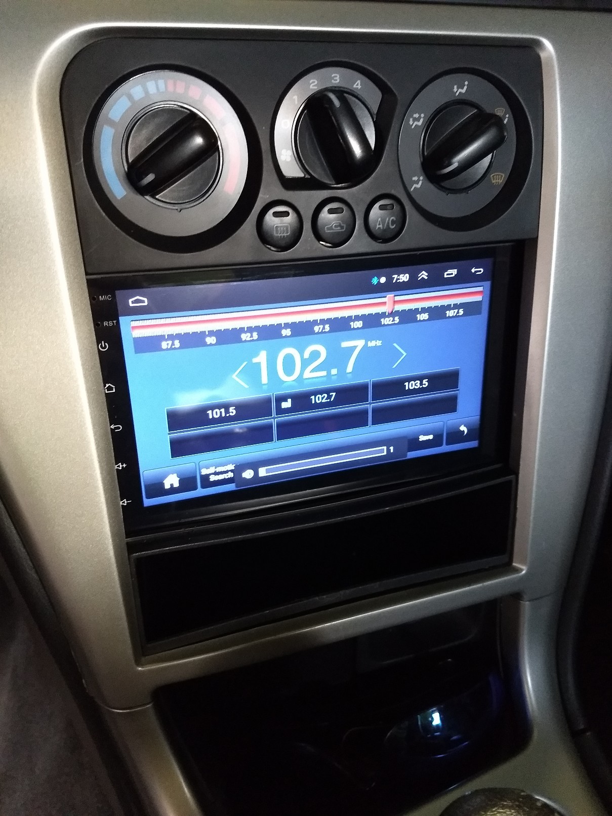

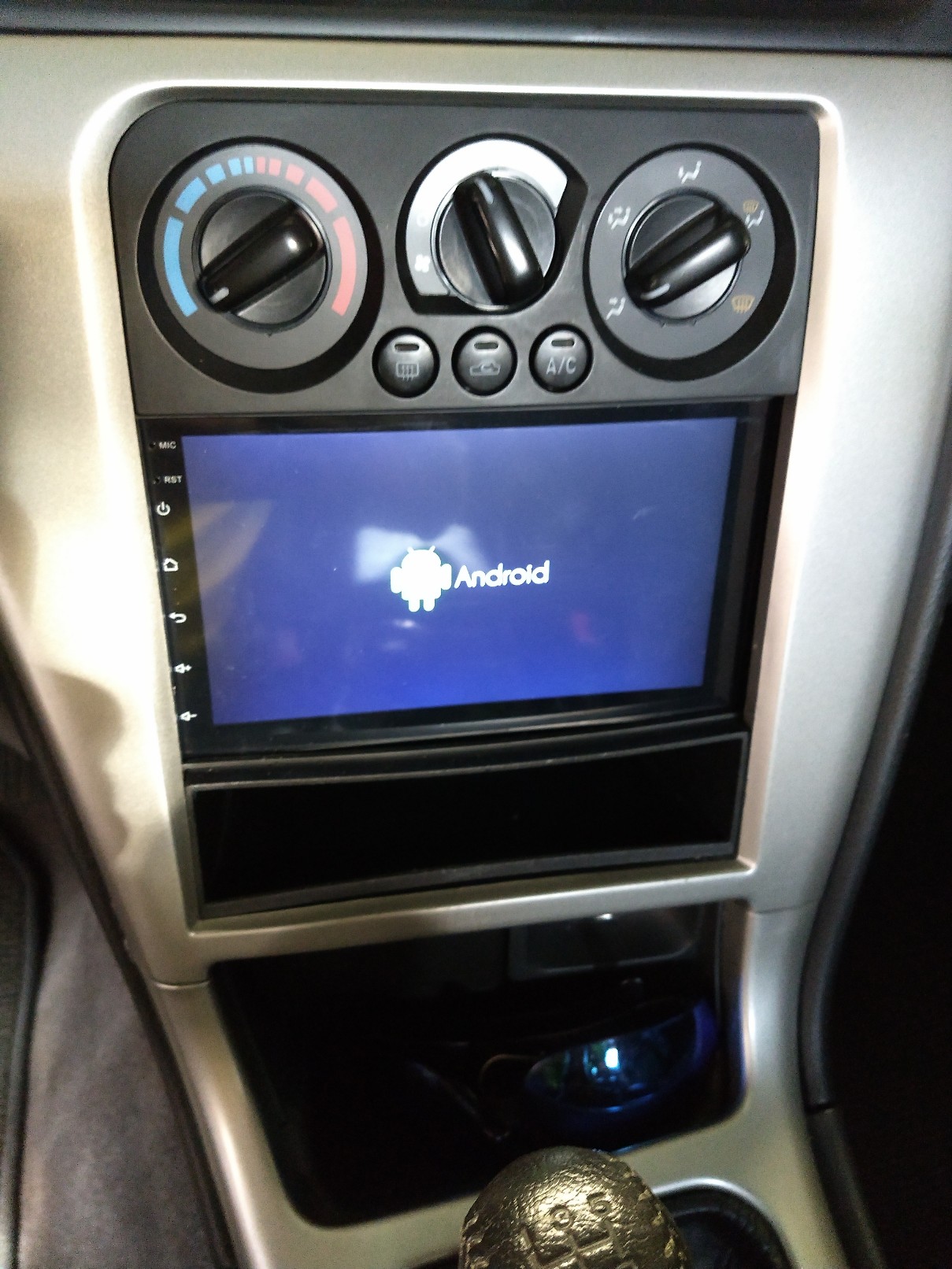

I got the radio installed. I couldn't use a 2DIN adapter I ordered I thought I would need. I had to drill holes in the factory bracket to mount the radio.
The harness adapter works but I'm not hearing any bass from the bass cannon so it's dead. There were two identical connectors on the car. I think one went to the 6 disc CD changer. If I plug the radio into one of them nothing happens but the radio works when plugged into the other one.
My only complaint is when I turn the ignition on, the radio defaults to a present volume which is too loud. So I have to manually turn it down when I start the car. There is also no AM but there is nothing on AM radio these days anyway. Reception seems to be weak in the boonies but I was so far out in the county between mountains I lost mobile cell data and had one bar.
The GPS and Bluetooth seems to work great otherwise. I have not checked the USB function to see if it reads mp3s.
I had to shave some of the fins off the cubby hole in order to get it to fit and it looks a bit squashed in the center.
I got this radio for about $60 but I've seen the same radio for $20 if you order directly from China.
For what I paid for the radio is not bad. I paid allot more for the flip out radio I installed in my 98 Chevy van and it's horrible and I'm going to replace it. Too many glitches.
