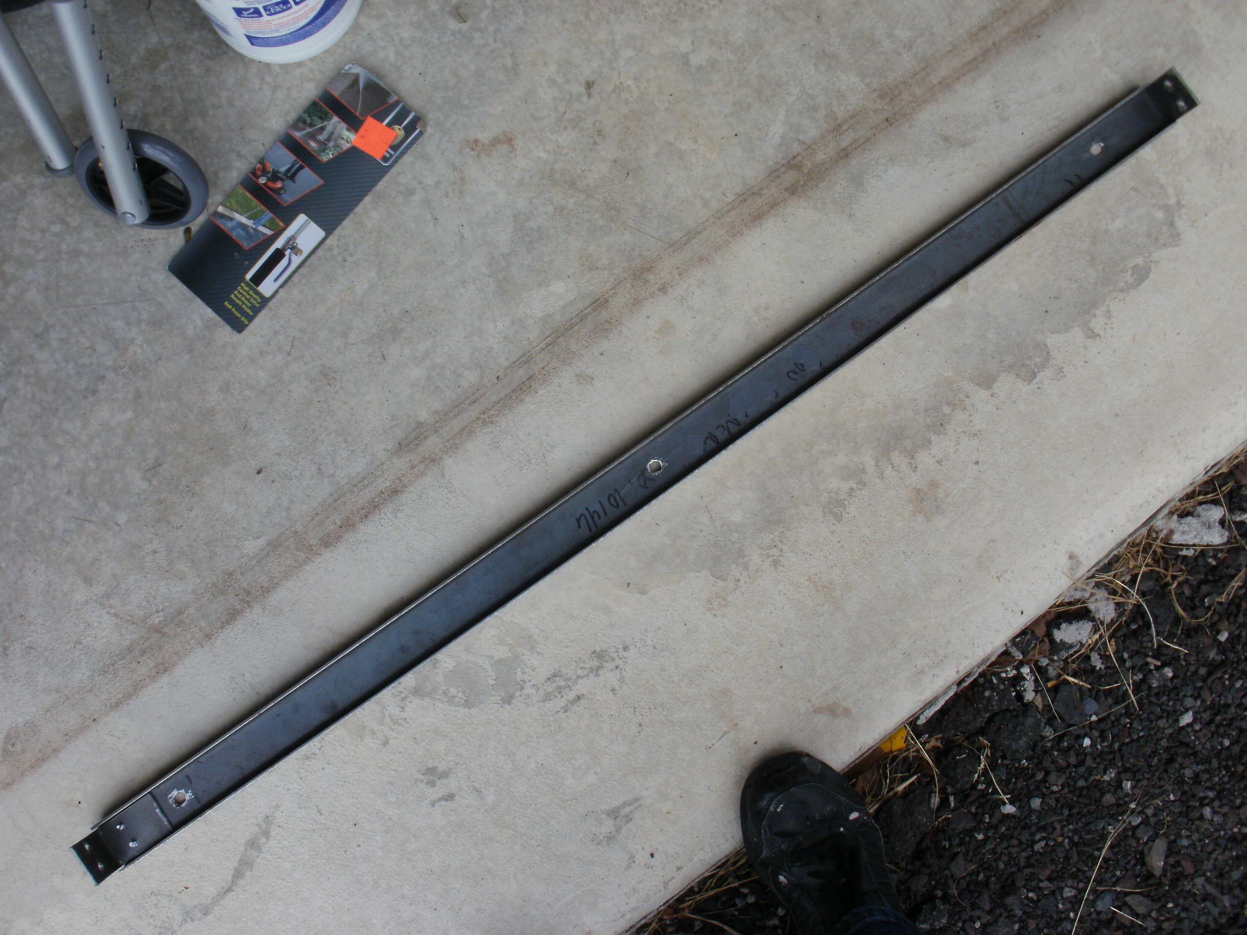

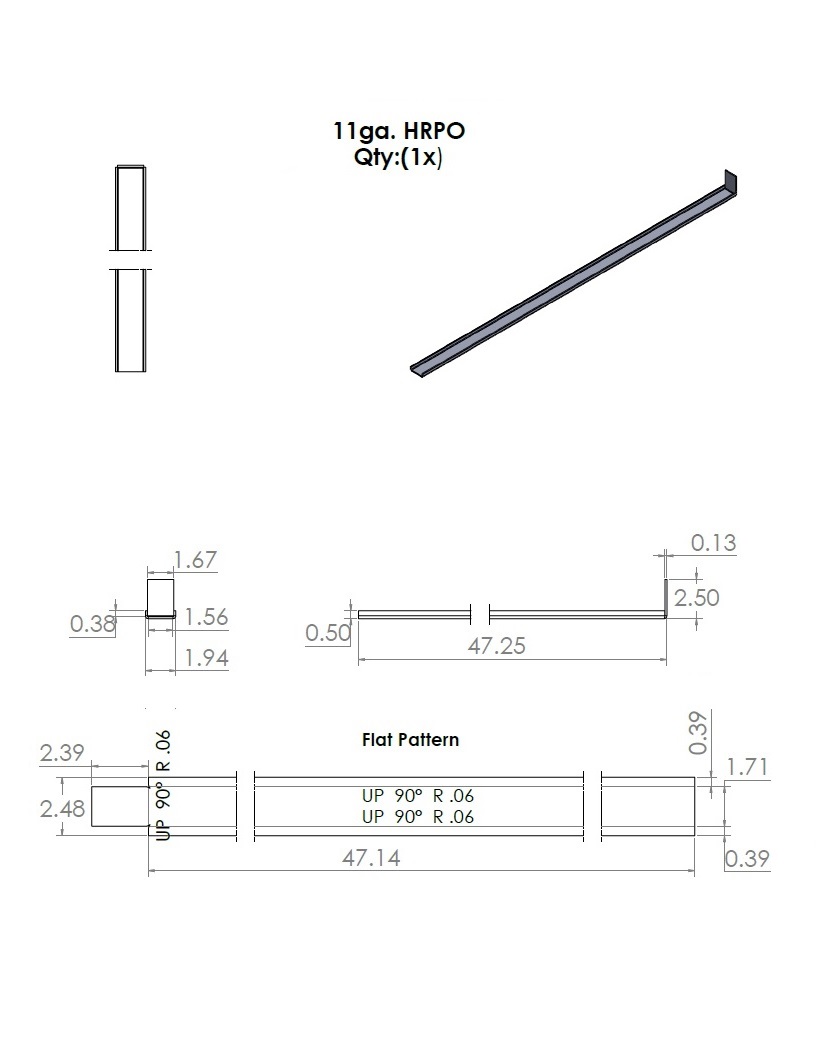

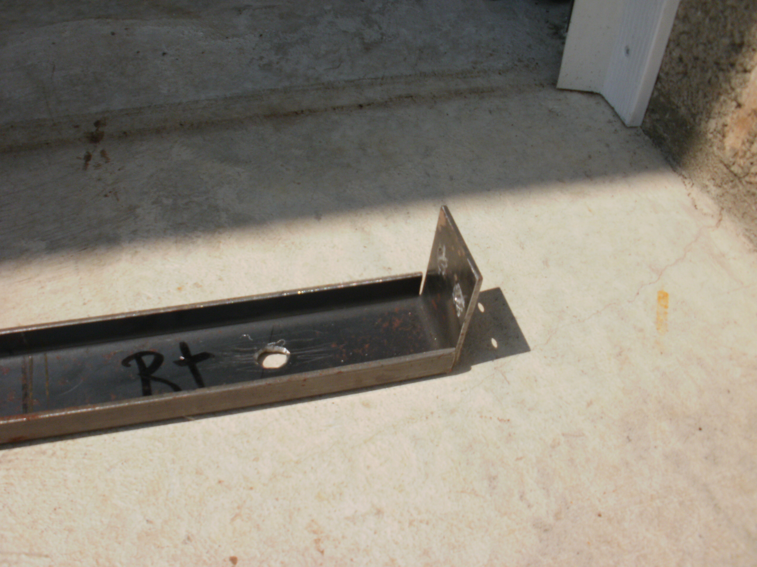

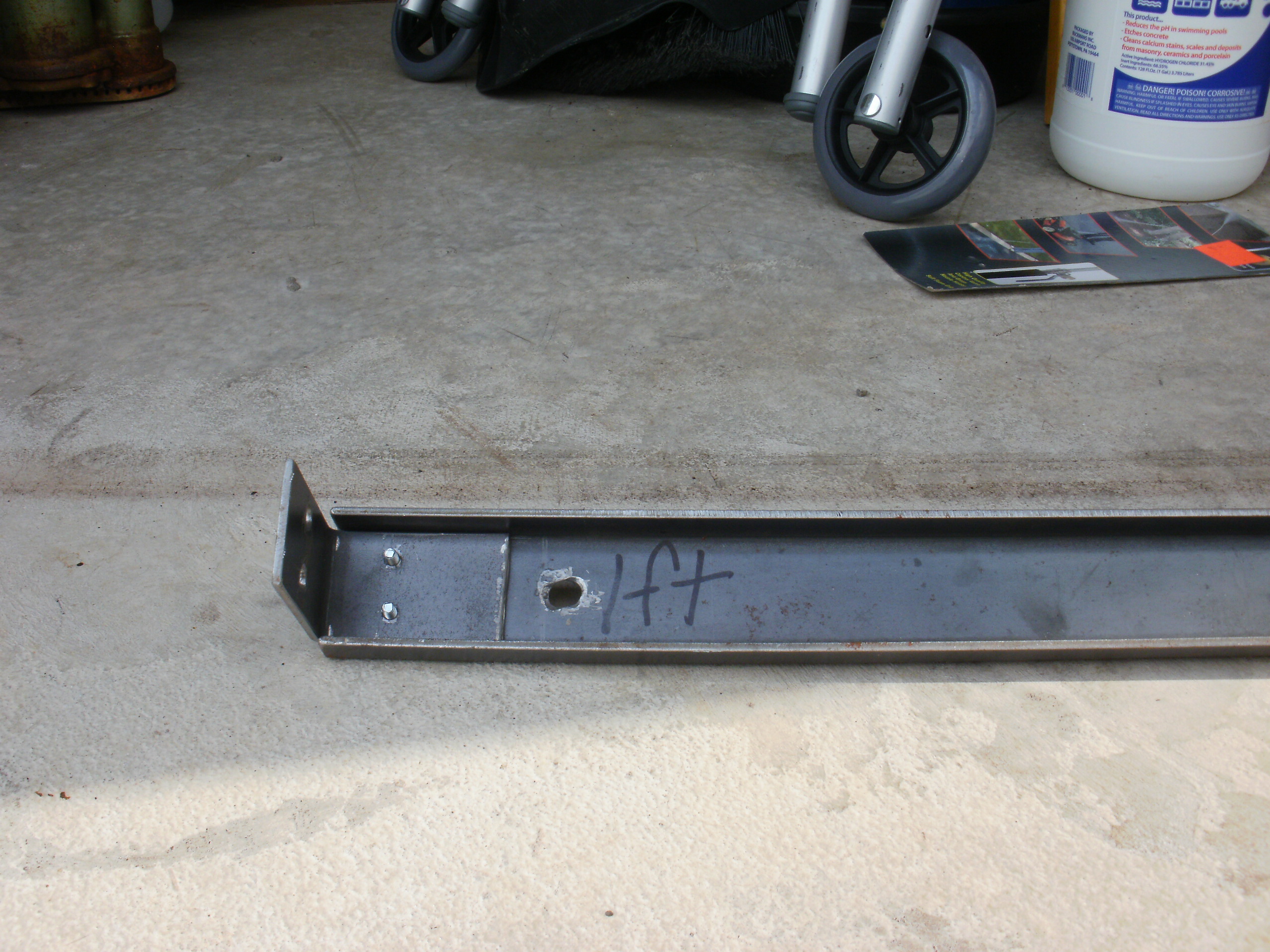

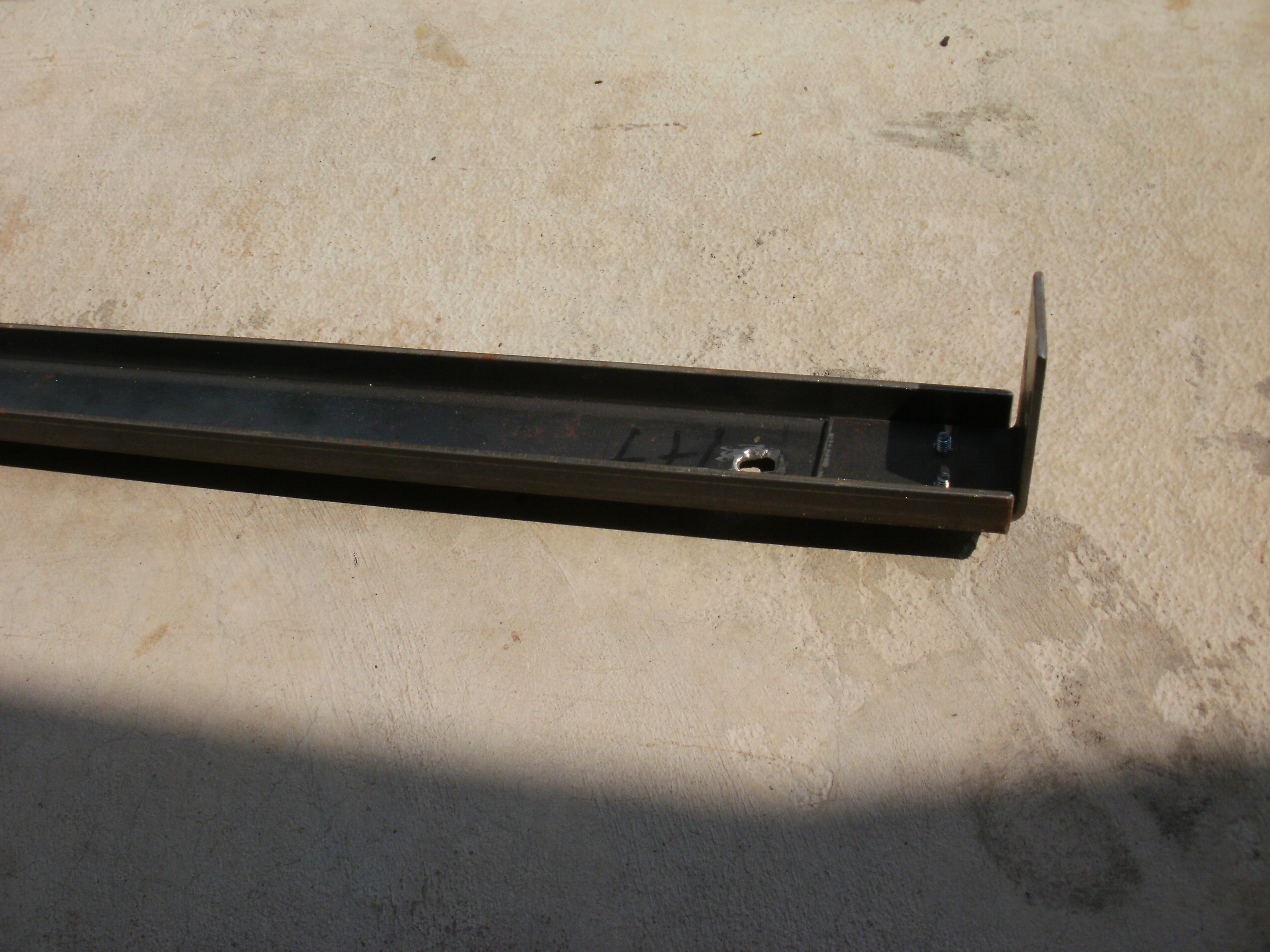

OK! So attached are some photos of my fabricated version of the SnugLid "FRAME CROSS MEMBER". Also attached is the shop drawing made by the shop that fabricated the olpieces for me. It only shows the larger piece. (This drawing might be enough information for an accomplished metal shop to make the one piece for you and you should be able to explain the other piece to them and how it should fit into the larger piece.) The two pieces are made from 1/8" (11ga) weld steel. In the shop drawing it is called HRPO which means Hot Rolled Pickled and Oiled. It can be painted or powder coated after it is cleaned which is necessary since it will have oil residue on it from the factory milling process.
The larger piece is "U" shaped and all bends are 90 degrees. Inside dimensions are 1/2" X 1-5/8" X 1/2" with the bend at the end at about 2-1/2". The 1/2" bends are as small or as short as the metal shop could make them with the brake they had.
I forgot to measure the length of the large piece but you should fabricate it to about 1/8" to 1/4" shorter than you'll need the final length to be.
The small add on piece is 1-9/16" wide and 2-1/2" X 2-1/2".
Again, I made the FRAME CROSS MEMBER in 2 pieces because I had to fabricate every piece of the mounting parts from scratch and could not be sure what the exact length would be. It had to be the exact distance between the two "side frames" (that's what they are called in the SnugLid installation instructions [see section B2]. I call them "Mounting Rails").
If you are using the original Mounting Rails, you might have to increase the width of these two pieces AND/OR increase the length of the bends at the end of each piece to accommodate the position of the two holes in each Mounting Rail where the original FRAME CROSS MEMBER was bolted on, on each end AND/OR you might have to increase or decrease the length of the large piece! (The finished length of my longer piece is 47-1/4" as shown in the shop drawing)
Any questions just ask. Be specific in your use of terms and how you pose a question so I know exactly what you're looking for. I've done all kinds of fabrication and hands on work all my life and I'm very exacting.
Let me know if this is what you need.
They only let me add 3 attachments so I'll add more in another message
Good Luck!
FRAME CROSS MEMBER (2 PIECES)
FRAME CROSS MEMBER w/small add on piece

FRAME CROSS MEMBER end
More attachments![/u][/i][/b]
FRAME CROSS MEMBER shop drawing
FRAME CROSS MEMBER shop drawing.JPG (64.71 KiB) Viewed 18349 times
