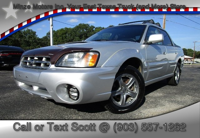

I know, I've been looking. Found a nice one in Missoula Mt. It had 57 K miles, I bid 3200 and someone else bid 3250, but it didn't meet reserve. I don't know how it ended. If I had won, I would have had almost 5000 to get it out of the yard plus 400 I paid the broker to bid, the 1700 shipping. I would have been looking at close to 7000 in a nice little Baja Turbo with the left front end missing.
I just bought this 2006 Baja Turbo, one small lady owner, never wrecked, great maintenance record ( I talked to her mechanic), 110k miles and looks new. Price 9000.00.

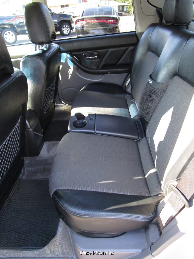

Well, I bought the car. It looks new and drives like new. I knew I had to wear parts to replace. It has not had the timing belt replaced and also the water pump is original. I talked to her mechanic and he told me he replaced the turbo and did all the checkups. Sounded like he knew what he was talking about. The dealer said he had repaired the A/C. When I got there the car started right up and ran so quiet, I couldn't hear it. I signed all the paperwork and we headed for Dallas, headed home. I noticed the car didn't have much power, but I was going along about 65 mph which was fine by me. as we got past Dallas, I decided to turn on the A/C and of course it didn't work. So there were 2 lies that I had been told. I don't believe the Turbo is working, because I think I'm down about 100 HP. That's the way it goes with me on used cars, I always have to spend 3 or 4 thousand to get them sorted.harleyjohn45 wrote: Wed Oct 16, 2019 2:48 pmI know, I've been looking. Found a nice one in Missoula Mt. It had 57 K miles, I bid 3200 and someone else bid 3250, but it didn't meet reserve. I don't know how it ended. If I had won, I would have had almost 5000 to get it out of the yard plus 400 I paid the broker to bid, the 1700 shipping. I would have been looking at close to 7000 in a nice little Baja Turbo with the left front end missing.

One great thing is this car has a pioneer stereo, and I could pick up 15 or 20 FM stations all the way from Long View Texas to Alto, NM. This vehicle has great sound. Oh, one last thing I got a check engine light about 5 miles after I left the dealership. That caused the Cruise control to not work. If the Check engine light is a o2 code, that would be an exhaust gas sensor, and I understand that can rob power.
You can bet I will leave him negative feedback that will burn his ears. I hate people who lie.
