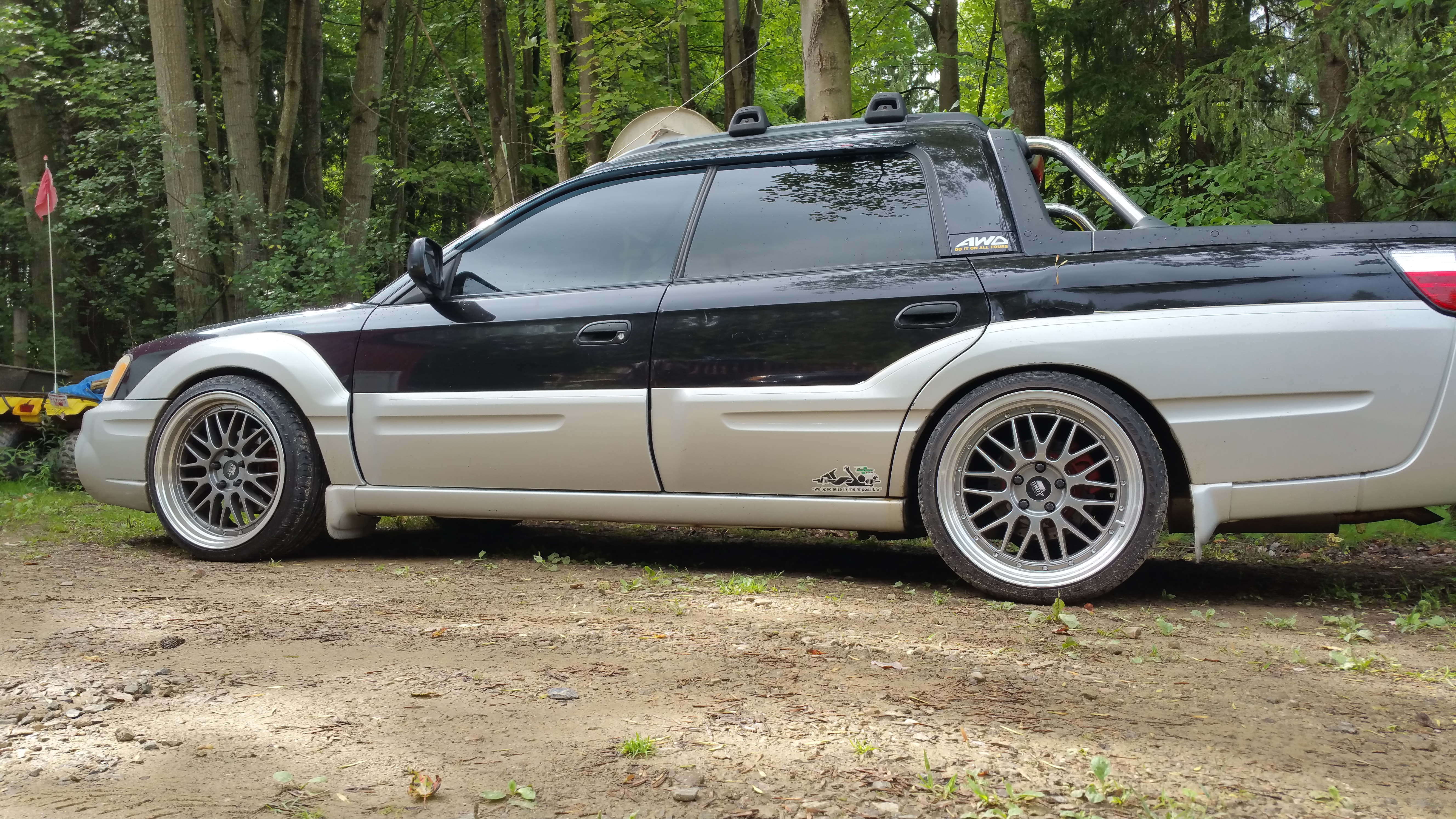

Hey guys was wondering what othe models suspensions are compadable to the 03 I'm tring to peice to geather a new raceland coilovers and any info would be helpful
The chassis code is BE/BH
Idk if this is right ?
fronts are 02-07 WRX struts
rears are 08-14 STI struts
This may help
03 Baja compadable suspension?? RELP ¡¡¡
- 20180818_105213.jpg (6.18 MiB) Viewed 13309 times

I wanted to know what's the closest to stock so I can tell raceland the 2 different ones needed and put a kit together. since they don't have a baja specific kit. their coilovers are significantly cheaper and I'm going to drive this all year round and it's a beater, dont want put the more expensive ones in..
Well the baja in the pic was bought told it had coil overs, unfortunately the springs were cut and they started falling out.. a lil unsafe , so I kinda wanted to keep its stance to drive..
