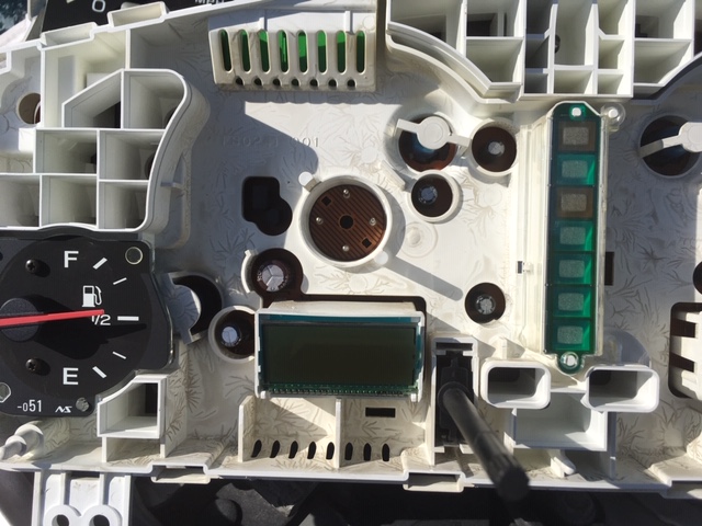

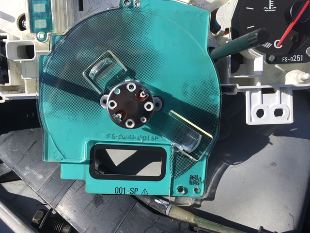

So the latest on the speedometer / odometer / trip reset deal. Ain't gonna happen. I pulled a cluster at the boneyard this morning. Opened it up and pulled the speedometer. The odometer module stayed with the cluster. It turns out, the odometer is a separate unit and is soldered in by about 10 pins to the back of the circuit board. Now you MIGHT be able to swap circuit boards - but you might not. What I DID find is the reset button may (note MAY, I didn't think to check into it that far - that's when my work called me out there :roll:) well, it may be that the reset switch can be replaced. Sometime this weekend, I will pull my cluster and see. I'll post more pictures then.
cluster with speedo removed.
back side of speedometer

I didn't make pictures because I got caught up in what I was doing :oops:. I DID manage to get the trip reset / Trip A-B working though. You have to pull the cluster (the flasher plug is a bear to get released). You disassemble the cluster (there are little tabs that must be released to get the lens, black bezel, and the inner and outer inside (white) covers off. To remove each (any) gauges, there are two little metal tabs (on the back side of the circuit board) that have to be bent out and the gauge pulls right out. In my earlier picture, I show the black reset button. It can be removed, or it comes off with the white cover. You need to access the circuit board. Under where the black button went is a small switch box that is soldered to the circuit board. It is about 3/8 square and has a gray rubber boot in the center). It is at the lower right corner of the odometer module. There are 4 solder joints on the back of the board that hold this switch in place. If you want to do it REALLY right, find an electronic supply and get a new switch and solder it in. You could also get a switch from a cluster in a boneyard (check to make sure it works right first). I powered up about 4 different cars in the yard to verify the resets worked - all did, but I didn't get any because I hadn't figured out about the switch yet.
What I did (try at your own risk): The switch has a little gray rubber boot. I pried the boot out, and cleaned the contacts inside and the inside of the boot and did the best I could to get it back together (couldn't get it all the way back in the groove). I put it all back together and it worked.
Hope this helps someone. If you have any questions, ask here and I will try to help. When I can, I will get back to a boneyard and get pictures of all of this. I will also take a battery powered solder gun and get another switch to do it right this time. Dennis
