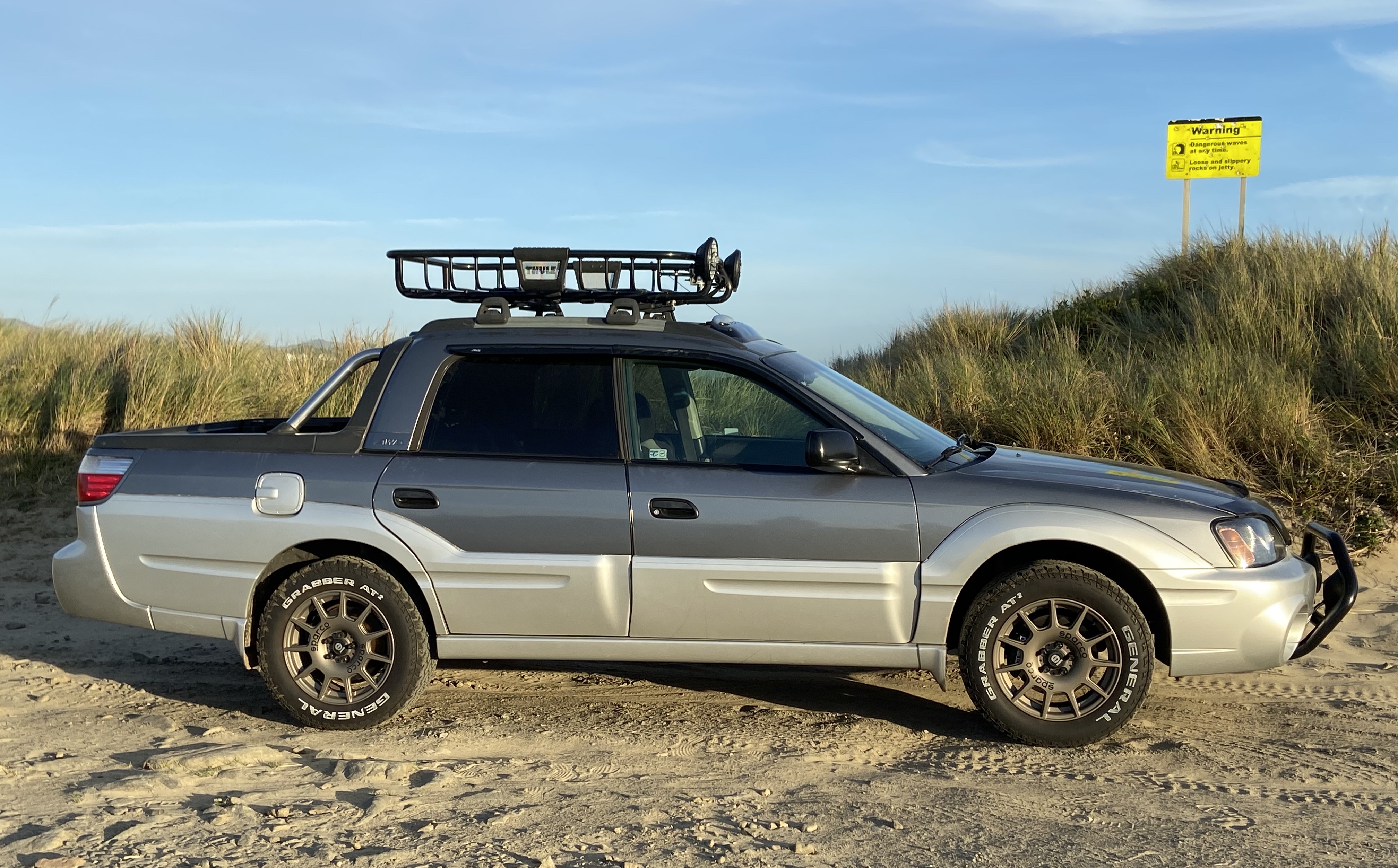

Hello I am new to the Baja world. Looking for ideas on how to do a lift. Do they offer a suspension lift? Or just strut spacers?
Re: Baja Newbie in Oregon.
Strut spacers do lift the suspension, what exactly are you looking for? It's been covered quite a few times. the easiest thing applicable to all years is strut top spacers. If you have an 03, springs and struts from later years will provide some lift as well. King makes springs for the Bajas which are a little stiffer and progressive (about where the baja should have been from the start!) and add about 3/4 to 1". 2" is about as high as you want to go without lifting the subframes as well so you don't bind the control arms or axles.
