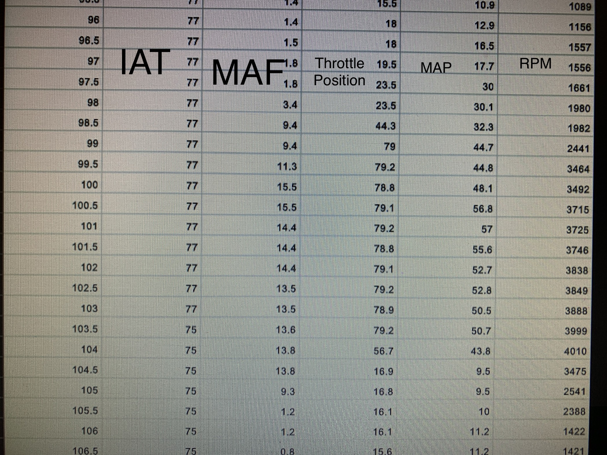

The only strange thing I noticed, was when I did some data logging, I did several WOT pulls (only to 4000rpm....) and my pressure seems high? LIke a slight overboost? I calculated it out to be about 14psi of boost, and I read somewhere that the Baja's only boosted to 11.4psi? Could slight overboost be causing any of these problems? All told, the MAP pressure maxed out at about 57 inHg at WOT and 4000rpm, when it started misfiring.
Oh, and the MAP with KOEO was reading 28.8 inHg; but I was actually at an airport, and the airport altimiter was reading 29.9 inHg. I don't know if that would matter.

I can try to post some of the data logs if anyone thinks it might help? I attached one. Thanks everyone.
Data Log WOT pull
Data Log WOT pull

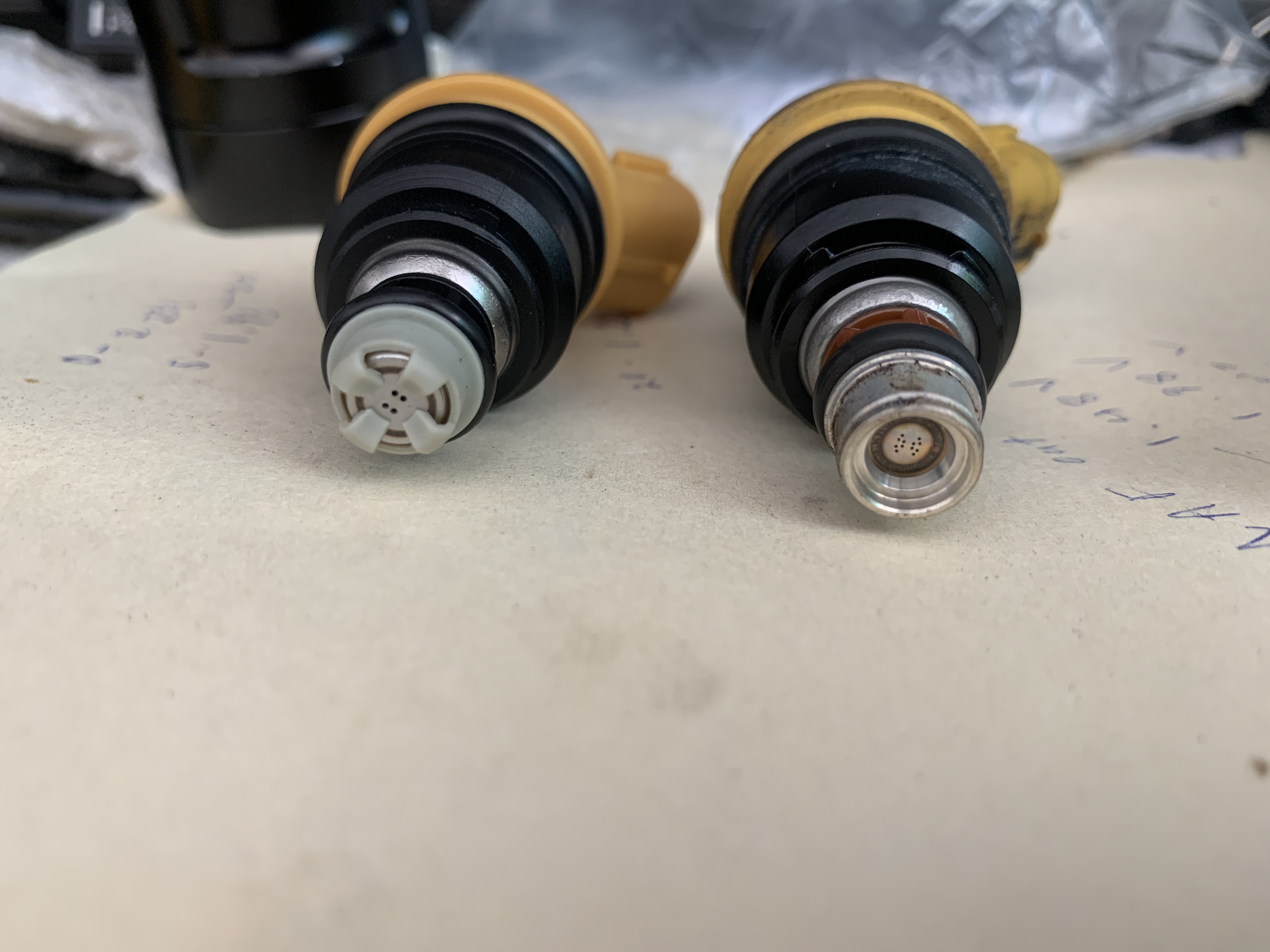

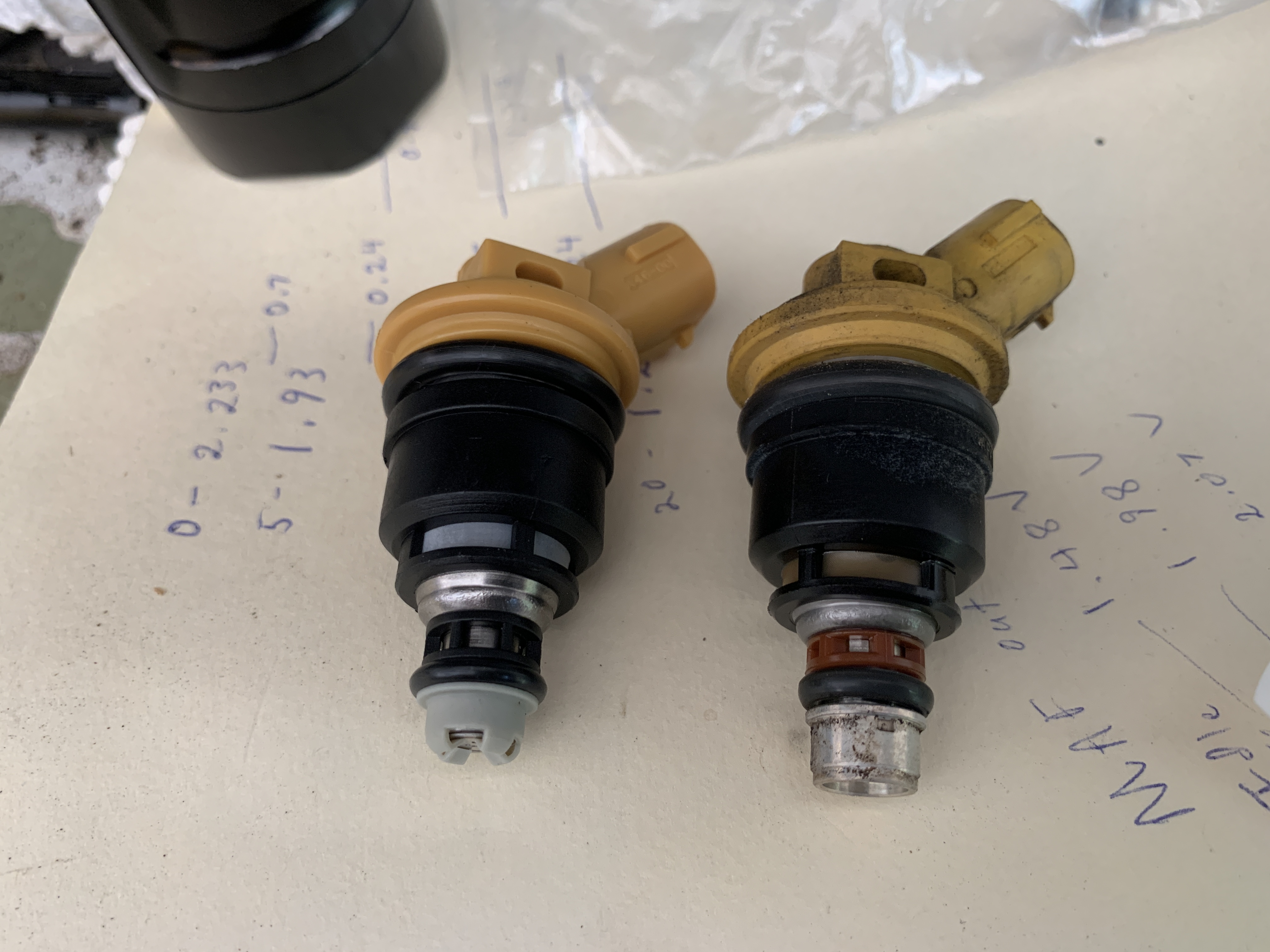

Uhh, guys? Did I really screw something up?
I installed new fuel injectors a few weeks after I got the Baja, and the new ones had this grey plastic collar around the tips.
Was I supposed to remove those???
New.  Old.
New. Old.
New.  Old.
New. Old.
I just removed the front passenger side one, because after removing all the spark plugs, I cranked it over and lots of fuel came out of that plug hole.
When I pulled the injector. There is no sign of that grey plastic thing from the injector tip anymore.
Oh boy.
EDIT: Okay, after reading some other forums, I’m understanding that the plastic cap is there to hold the oring in place on that style of injector. When I was installing that particular injector, it went in the hardest. So I must have damaged the plastic retainer, and when it did fall off, the oring went out of place, and allowed some unmetered fuel into the cylinder. Causing my hydro lock.
That theory will be put to the test.

Ok. Good news.
Baja is back running. One fuel injector was bad, via the bottom seal losing its retainer. I put new seals on one of the old injectors and it’s back to basic running order.
