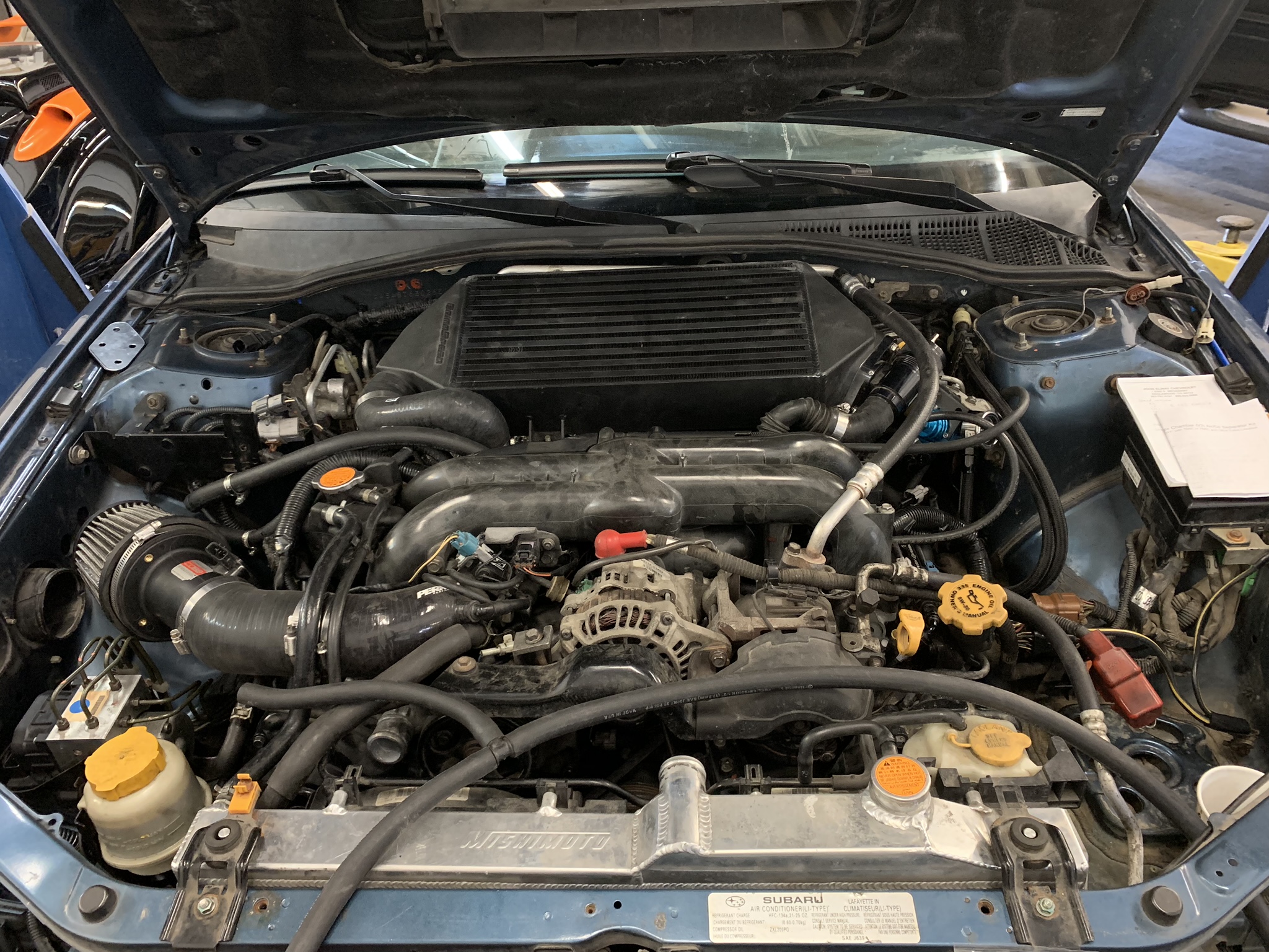

I’ve swapped an OBXT into a Baja. In addition, I turned the 4EAT into a 5MT from the donor OBXT. (Because 4.44 with 378ftlbs on it is so much fun.) I would advise against a transmission swap. It would require you to modify or swap the wiring harness behind the dash. That is, you will be removing everything to the firewall in order to turn an AT to MT or MT to AT. Also, you will need a different ABS module. One is unique to ATs and the other MTs.
As far as your engine goes, I fit the LGT manifold on with the turbo and TMIC from the outback. However, I used a forester manifold harness for connection plug compatibility and location and modified as necessary.
Well, here is a shot prior to tuning while tying up the the last few tidbits (e.g., plumbing, wiring, battery.) I’ve since cleaned it up a bit.
