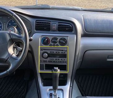

I’m looking at getting a double din and slapping on a back up camera. Can’t really seem to find much except the original one posted here but the link to amazon is a dead end.
I found this one that I would pair with this camera from crutchfield. Struggling to figure out if it’s gonna fit. 03 Baja non turbo automatic.

I put one of these in mine. it bolted right in without needing any adapter kits. I would get a wiring harness adapter though. You will have to trim the inside of the dash bezel though for it to fit around the screen. It's camera compatible too.

Adding a Dual DIN head unit to the Baja is pretty easy, the internal bracket will match right up with no issues. Get a wire adapter for the stock unit to the type of head unit you want, or you will have to do some wiring. A small amp will even fit behind the head unit. I currently have the BOSS head unit and 500w bluetooth amp stuck behind it. I removed the storage box with the closing lid, and left the open storage box under the Dual DIN. Side Note: When installing a head unit, especially with an amp, use clean battery power and use the SAME ground on all items. Will help with any engine whine. (try not to induce ground loops)
Wiring in the reverse camera; you will need to take apart the tailgate backplate, the sidewall of the bed, bed rail, and the bodypannel with the pass-thru. I used some flexible wire loom to cover the exposed wire from the tailgate to the bed. There is a grommet you can snake the wires into the cab in the corners of the bed under all of this. Once inside, you have to remove the interior side cladding (the one covering the struts). Now, if you come in on the Drivers side, you can proly fit a wire up through w/out removing the panel since you can gain access w/ the spare jack removed. Route the wire under the Rear Seat, along front and rear door plates, then up into the dash. If you plan to include any exterior power options, or reverse camera override, now would be a good time to run a few extra wires with your camera.. you can attach them later with relays and all that.. just getting the wires outside is the pain.
On installing a touch-screen panel. Can be done, the dimensions of the opening are not square, so you would have to create a backplate to cover holes, or cut out the bezel to be squared up.
Also, the temp control is cable actuated, so you cannot make it digital w/out adding solenoids etc. Switches/mode is electric activated so you could do that w/ some programming/wiring.
