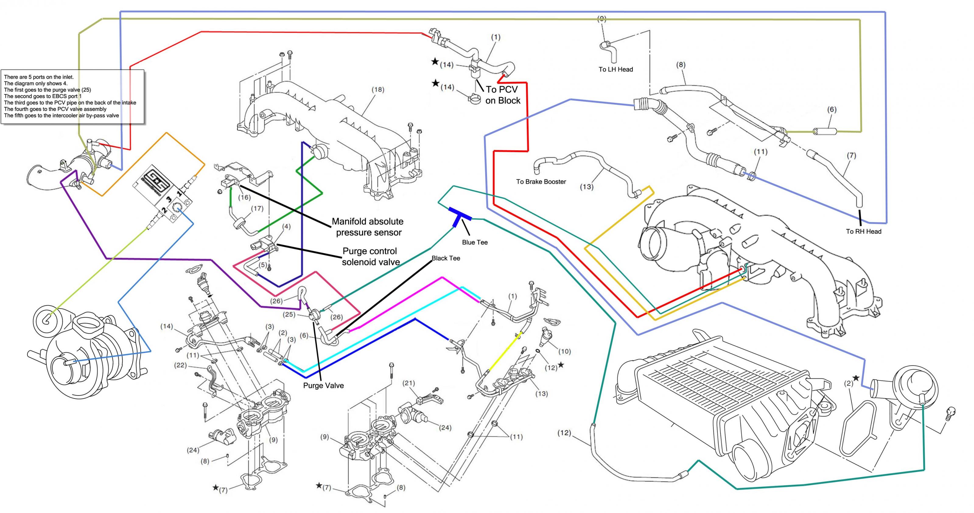

I’m in the process of reassembly after pulling the motor (turbo 5 sped) to reseal, new clutch, new turbo, new ac, new radiator. I’m almost done and am scratching my head on some of the lines on the air intake and others around it as some of my marks are not not legible.
Does anyone have a diagram of all the plumbing?

I found the following on NASIOC and posting here. Haven’t reviewed completely but I think this is what I am looking for.
https://legacygt.com/forums/showthread. ... b7&
