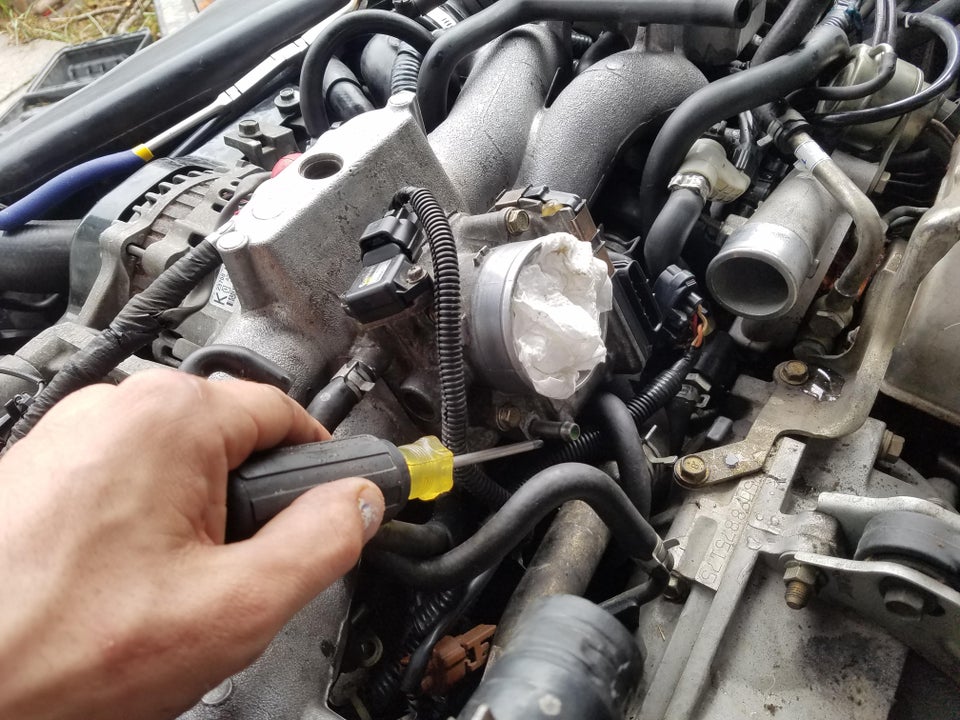

I'm still trying to put my 2005 Baja (Turbo 5 spd) back together. I am stumped right now with the throttle bottle coolant line? Looking from the firewall at the throttle body there is a small coolant pipe coming out from the bottom of the TB. I can't for the life of me figure out where that goes or what hose went to it???
The pic I am attaching comes from a post I found on reddit and while there where answers given on reddit, there was no pic showing the answer and I cannot find the locations mentioned in the answers.
Any help would be greatly appreciated!

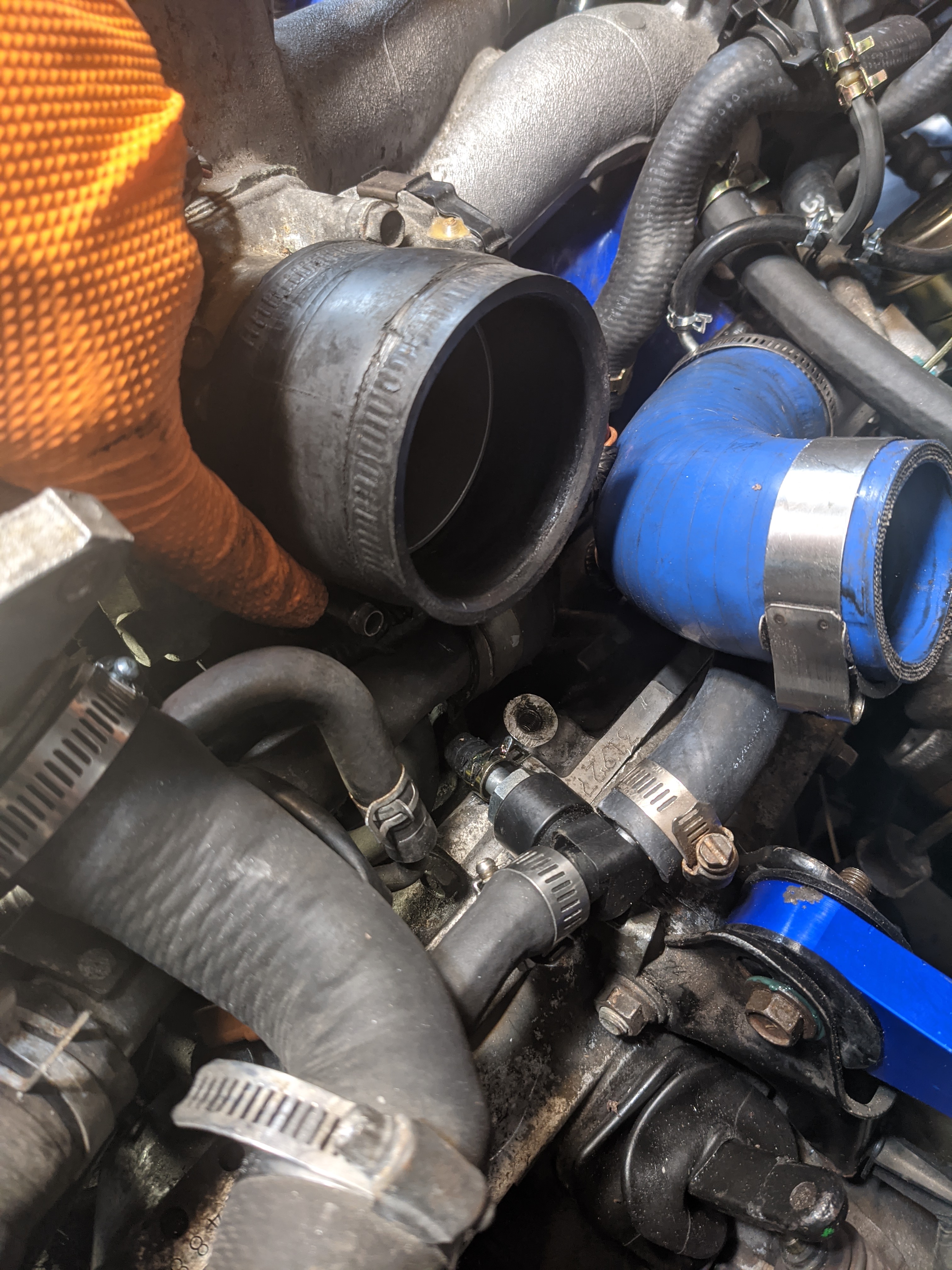

Here is a pic of my TB and the coolant line I can't figure out ...

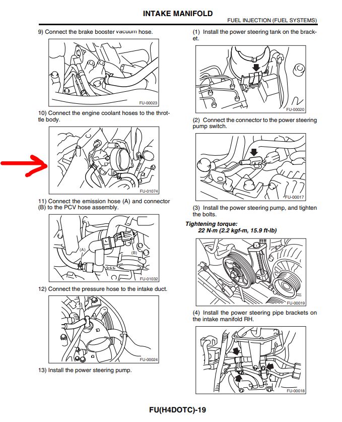

Well, this is as best I could find from the FSM
Saved by youtube... maybe?
https://youtu.be/fmJVkD0F-y0
Skip to about 10:00

Thank you very much for looking this up. Although there is no clear picture providing an answer, based on the text description it sounds like that is a coolant input. If that is the case then I'll just make sure something feeds into it. Simple right?? What could go wrong 🙄
Thanks again!
