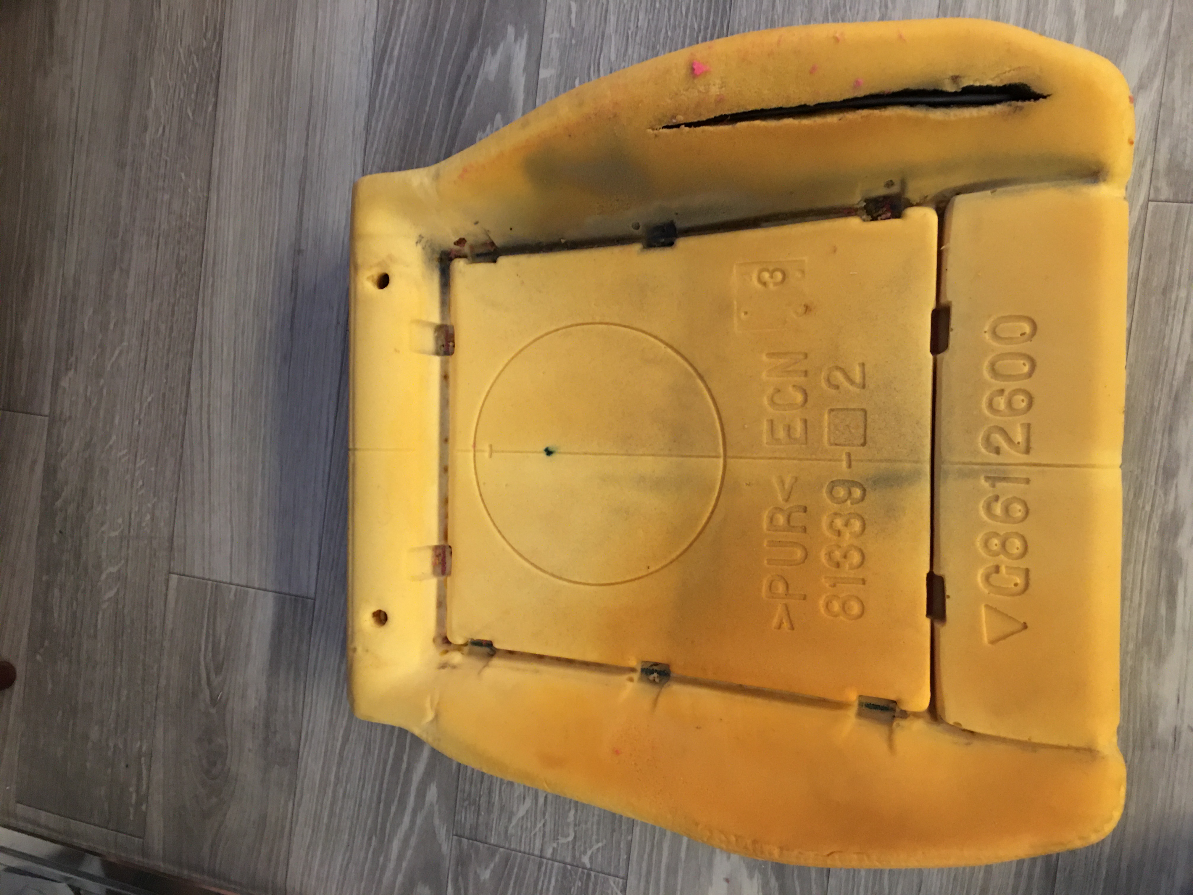

Update: I found a photo of the driver's side foam, and it's visually clear how much more padding there is on the door side than the console side. The passenger side would be the inverse of this, and would require some reshaping to fit in what remains of my oem leather cover.

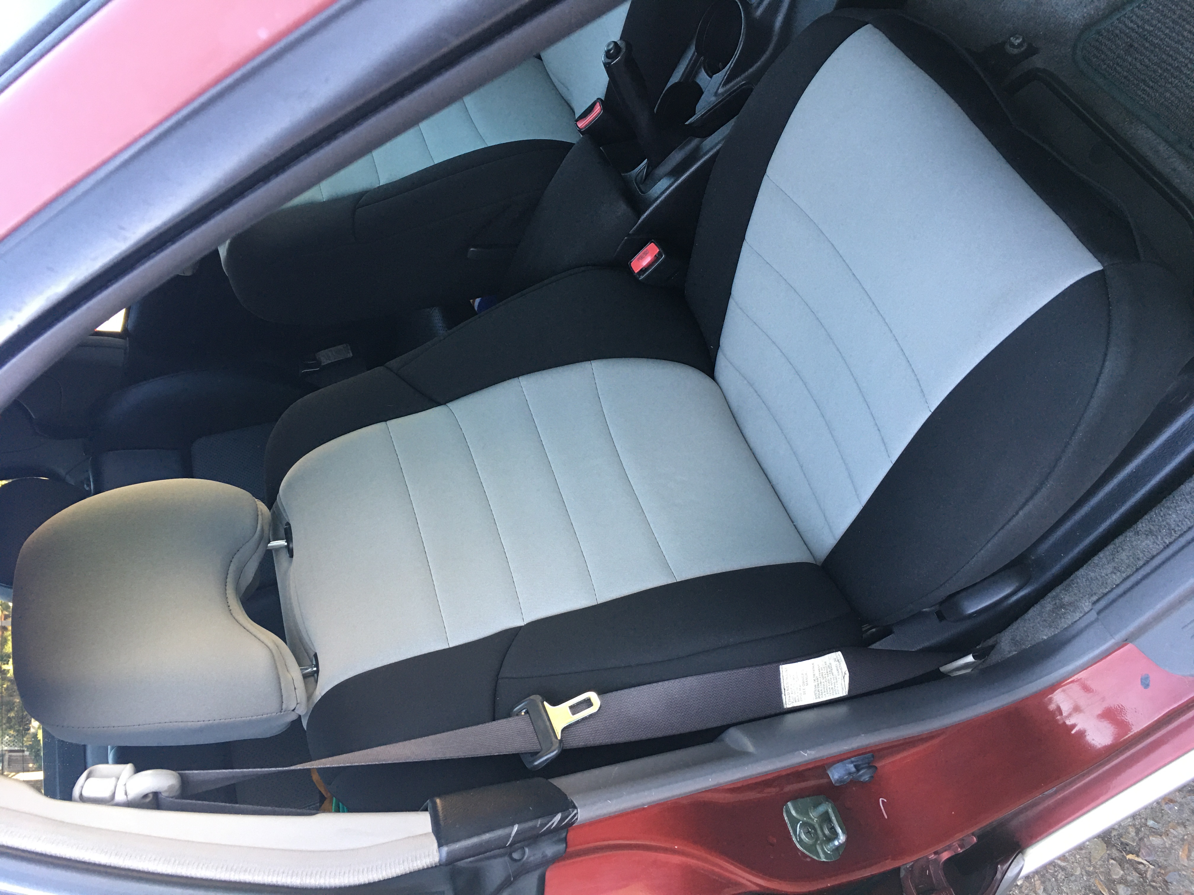

For sure, happy to help.
I kept two of the four I tried, one that my wife liked (passenger seat) and one that I thought was okay (driver seat).
Here's hers, which is an almost perfect fit for the seat covers:
https://www.amazon.com/gp/product/B07PJ3QGX6/ https://www.amazon.com/gp/product/B07SQ1GYH9/ Here's the cute arm rest they give you, too: Now, my update is that I still don't think this is all that comfortable. Also, the coccyx cutout from my seat cushion is starting to show a dent in the seat cover. Even worse, it's two inches of memory foam, so my head touches the headliner for the first five minutes of every drive, until the memory foam sinks down enough to give me some room.
The Wet Okole covers have a bit of cush, but not enough to be substantive. They are, however, perfect for my baja-as-a-surf-car use case, since I'm damp half the time I'm driving.

Re: Have you replaced the drivers' side seat bottom cushion?
Thanks for the update!
You chose light gray for your center Okole covers right?
My idea was similar to yours, get the covers in black/charcoal or black/carbon fiber.
Then use some of this foam, trimmed to fit the depressed foam, then cover over top.
https://www.ebay.com/itm/High-Density-U ... 2749.l2649
Okole says 1/2" foam in the seat area, so I'm calling them to find out if it's medium or high density etc.
I did choose "21 LIGHT GRAY" for the inside colour, you bet. I was trying to approximately retain the Baja seat color scheme. Wish they had an option for black head rests, that would have been even better. In theory, I could have had the Baja logo embroidered, too, that's an option if you have and can upload the image.

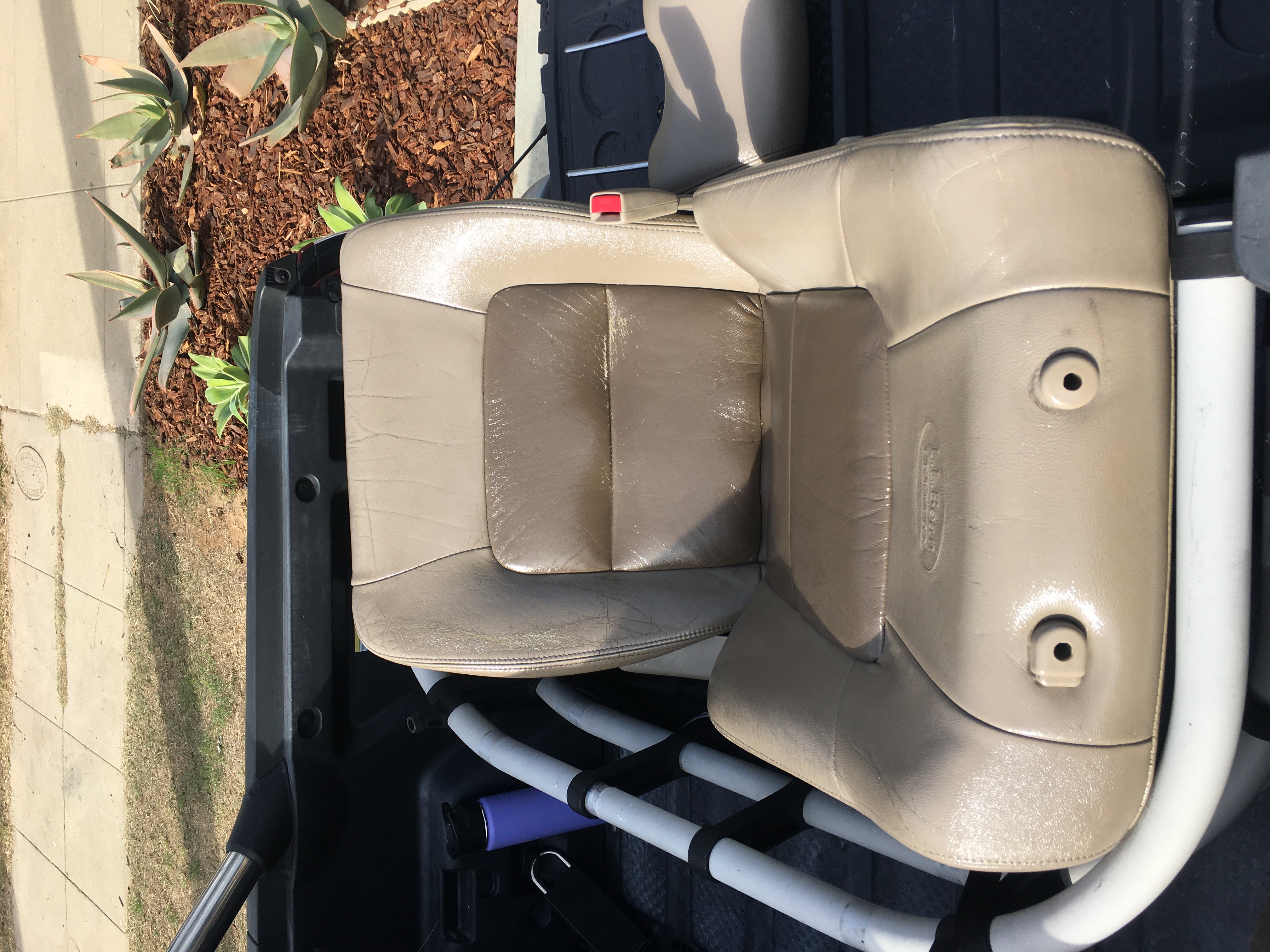

Update:
I installed a good condition leather seat from a 2003 LL Bean Outback. The Baja seat covers fit the same, so that’s a win.
I installed the seat belt and some trim from my Baja seat, because the Outback chair is brown. It’s 8 way powered, so the side trim is still brown (extra motor prevented Baja trim), but I’ll paint it black at some point. Motorized recline is nice.

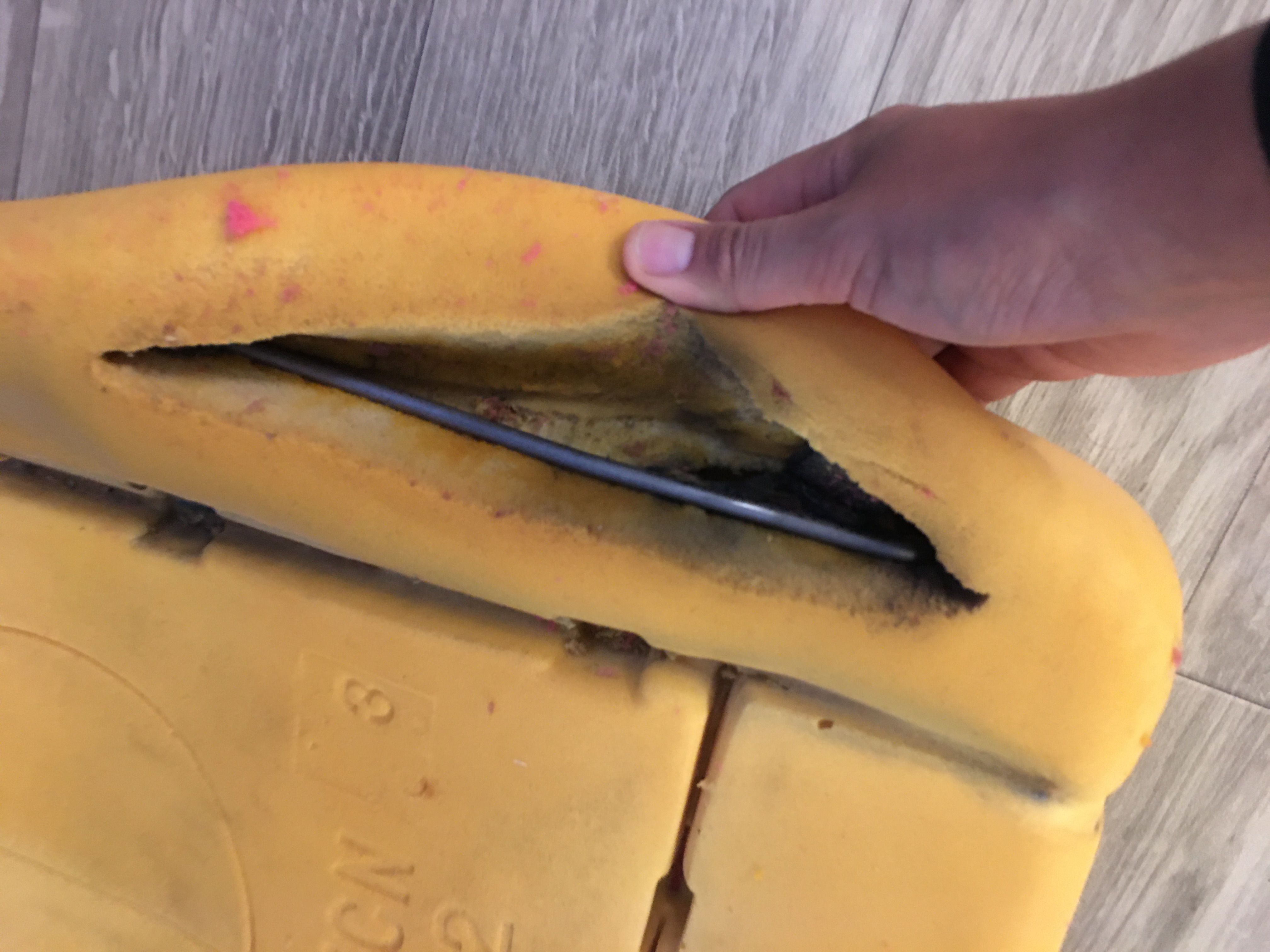

I dissected my Baja driver seat, to understand why it sucks so much. Was surprised to find a thick metal wire is the source of the side bolster destruction. It sliced through the foam and seat cover, and that’s what I’d call a design flaw. On the topic of fitting a passenger cushion in the driver seat... no chance, that same wire is structural, and only on one size.
- Outback LL Bean edition leather seat
- 8F8721D8-19C2-418B-BFF4-7F94C374CE19.jpeg (2.72 MiB) Viewed 43076 times
- Destructive seat cushion wire
- 4F1C6815-ED9A-410E-952E-0569FC9495CC.jpeg (1.47 MiB) Viewed 43076 times
- LH drivers seat cushion
- C805BD7D-9F1D-4582-A2AA-E507E4D5FB33.jpeg (1.8 MiB) Viewed 43076 times

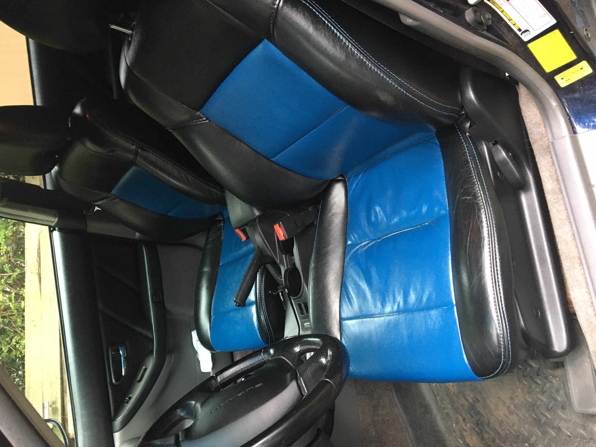

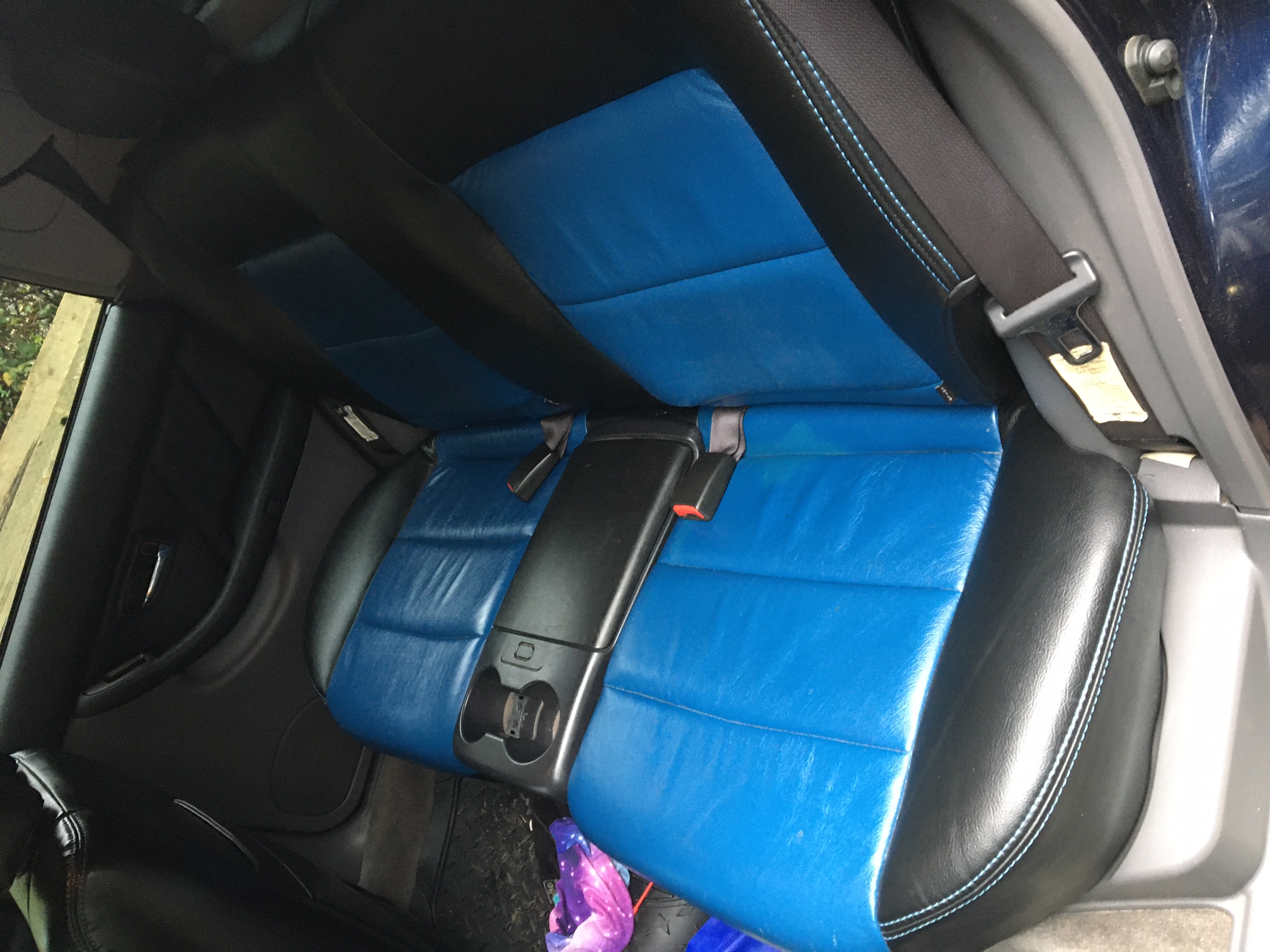

I found a solution to my problem too.
Found another Baja where the previous owner had reupholstered his seats.
Swapped them out last weekend.
Much better.
They have heater elements in the bottom and back, too.
I got those and the center console with the switches but haven't installed them yet.
Much better.
- IMG_5897.JPG (945.9 KiB) Viewed 43048 times
- IMG_5898.JPG (1013.47 KiB) Viewed 43048 times
