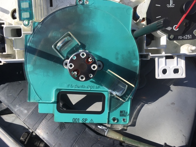

Re: Convert MPH -> KH/h and temp F -> Celsius
I believe you can change out specific gauges. I KNOW the speedometer can be removed separately from the rest of the panel. The odometer is mounted to the cluster, not the Speedometer. Here in Florida (USA) there is a place on the title for changing out speedometers (odometers). It's basically an affidavit stating last recorded mileage (old odometer) and installed mileage (replacement odometer). The title will then have the statement "Mileage not accurate" on it, which may hurt the value of the vehicle.
There are also places (legal places) where the odometer mileage can be set, like a good speedometer shop. There are also crooked ways to do it as a guy I used to work with had a "part time gig" going to a few car lots and resetting mileage (crooked #$%^&*) I always felt like ratting him out.
Now for the English to metric, the engine sensors might have to be changed too. I imagine anyone who has done a JDM engine install could add to this. Dennis
Speedometer back side
Posts: 181
Post by mike-tracy »
The sensors are the same. You can replace the tach and speedo cluster, but there is a chip on the cluster's board that needs to be reprogrammed to convert between imperial and metric. This is the service that G-Rom performs. He can also set your cluster to whatever KM you need also.
