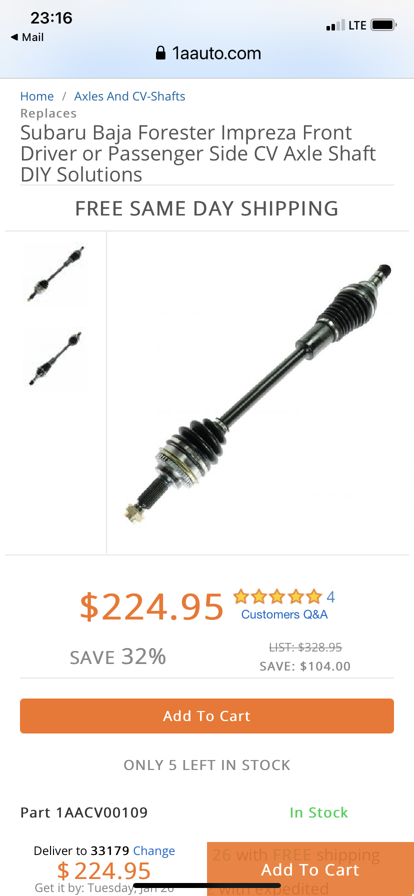

I can't recall the name on the box. On a whim, I did a search and contacted 1aauto. They had my order on file and are shipping me a replacement. Wow!!! The shaft is an extreme duty and is built better than factory. My boot had a small small hole and lost all the grease. Long high speed runs between Nashville and Jacksonville put the grease on the crossmember and trans oil filter. something I will be keeping a closer eye on. Can't say enough about 1aauto's customer service.
