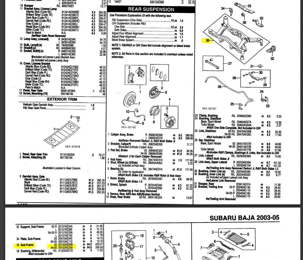

To the manuals we go! (I should've done this in the first place)
source: https://www.scoobytruck.com/pdf/Baja_2003-2005.pdf
:shock: well according to this the 03s use AE00B and the others use AE03A
