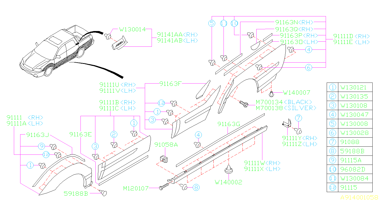

Hello! first time posting, I bought a project baja and most of the cladding came with it, but not attached, I have a good quantity of the clips. My problem is that I don't know which clips go where; most of the clips I have are the stubby pink ones (PN#909130121). The only diagram or information I could find was from the subaru parts website and its not super clean because the perspective is from the outside for some reason.
Also if anyone has any information on the bigger clips for the bumper covers and the bed trim that would be helpful aswell.
- B12_91401058.png (74.98 KiB) Viewed 27665 times

I think I must have been unclear because this doesn't show what I was after either. What I'm after is the specific positions of the clips on the panels, for example for the front fender cladding I counted 15 spots for clips, the diagrams show 3 types of clips are used for this panel but not where they go.

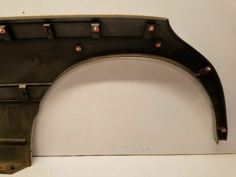

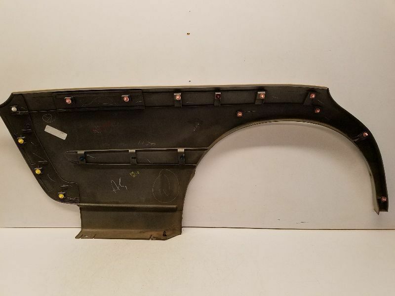

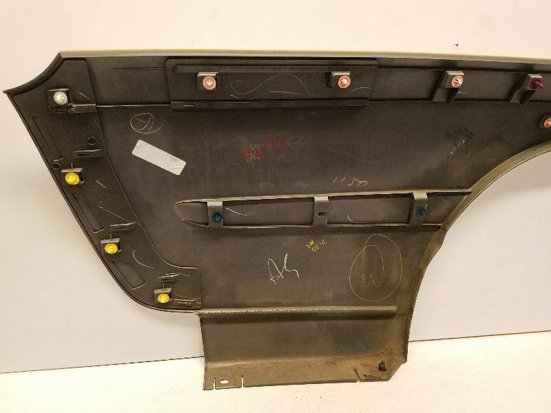

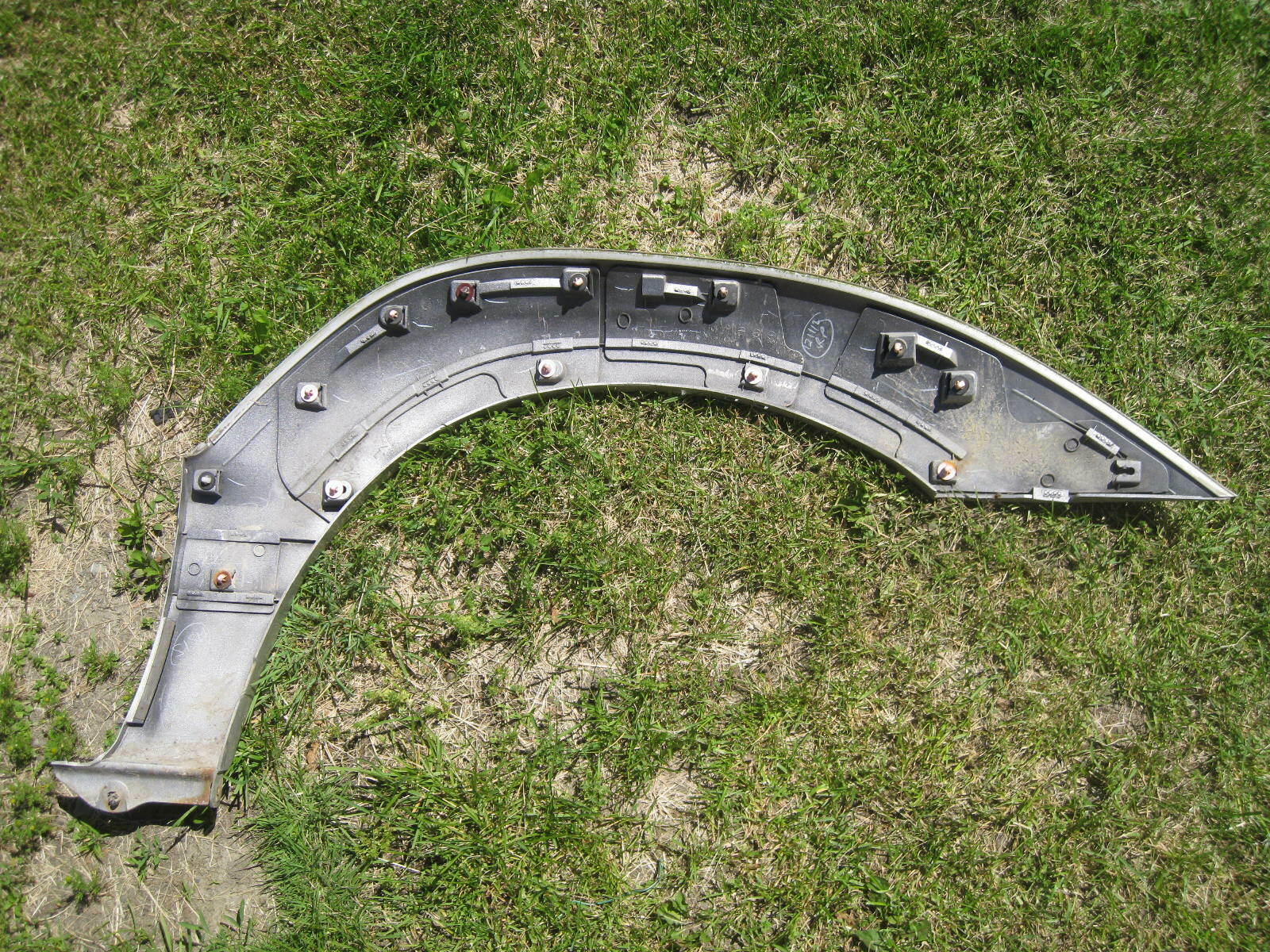

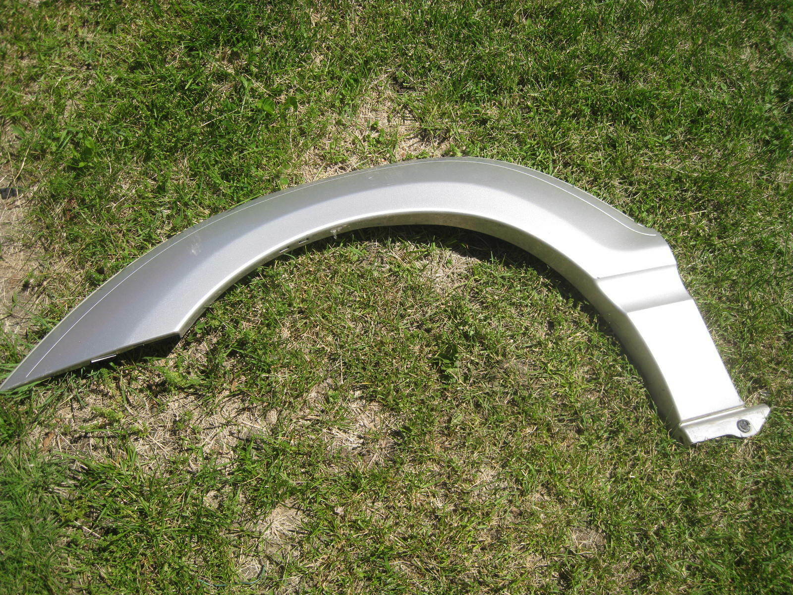

Here are a bunch of photos which should help if you Zoom in on the reverse side photos!kazeeee wrote: Fri Jun 18, 2021 12:36 am bump; still looking for resources regarding which clips go in which spots.
I've never added photos and it looks like they only allow 3 at a time so I'll send a few more messages with 3 photos each
- Left Driver Side Rear Quarter Panel Cladding 1b
- Left Driver Side Rear Quarter Panel Cladding 1b.jpg (36.47 KiB) Viewed 27538 times
- Left Driver Side Rear Quarter Panel Cladding 1c
- Left Driver Side Rear Quarter Panel Cladding 1c.jpg (52.12 KiB) Viewed 27538 times
- Left Driver Side Rear Quarter Panel Cladding 1d
- Left Driver Side Rear Quarter Panel Cladding 1d.jpg (41.01 KiB) Viewed 27538 times

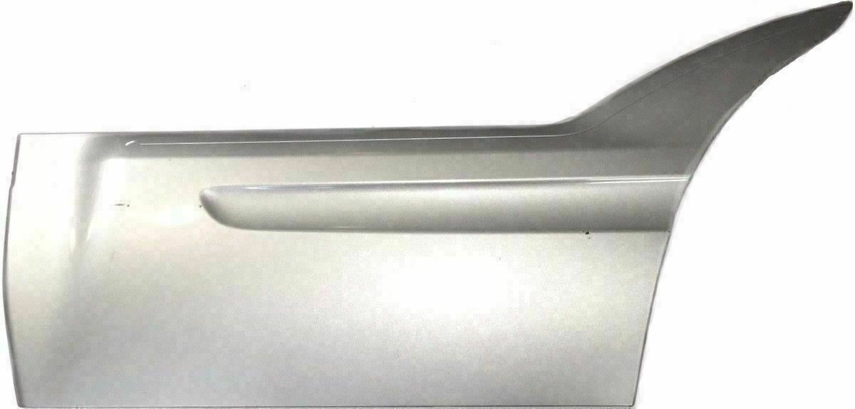

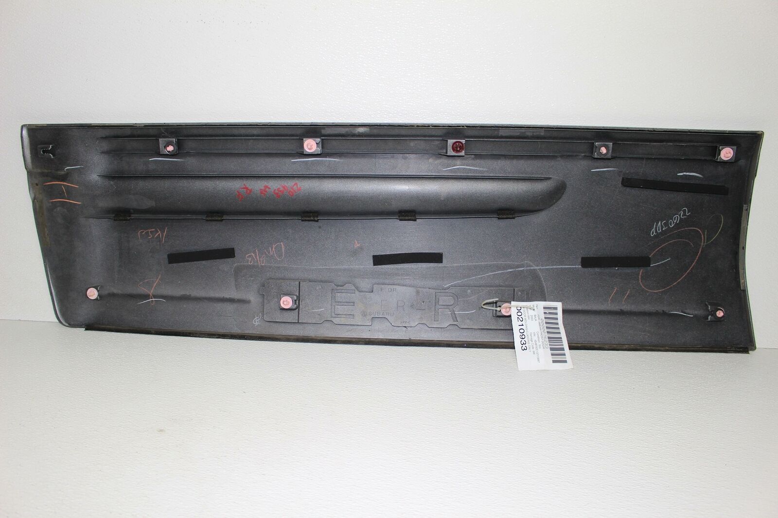

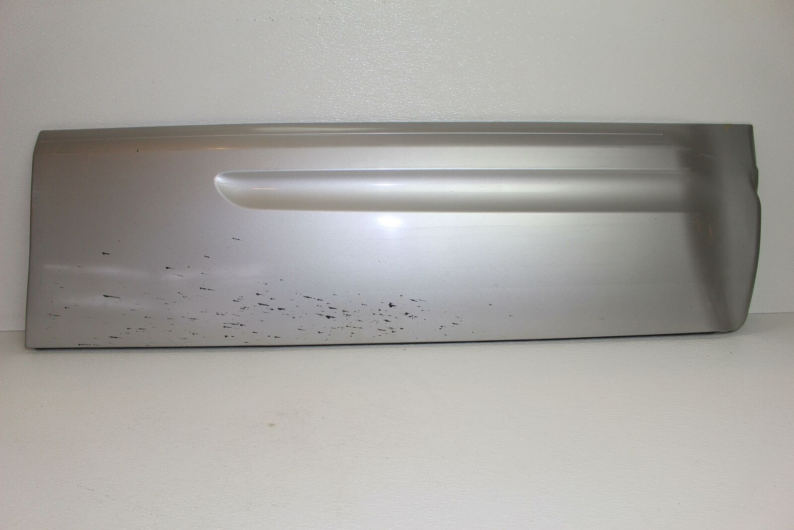

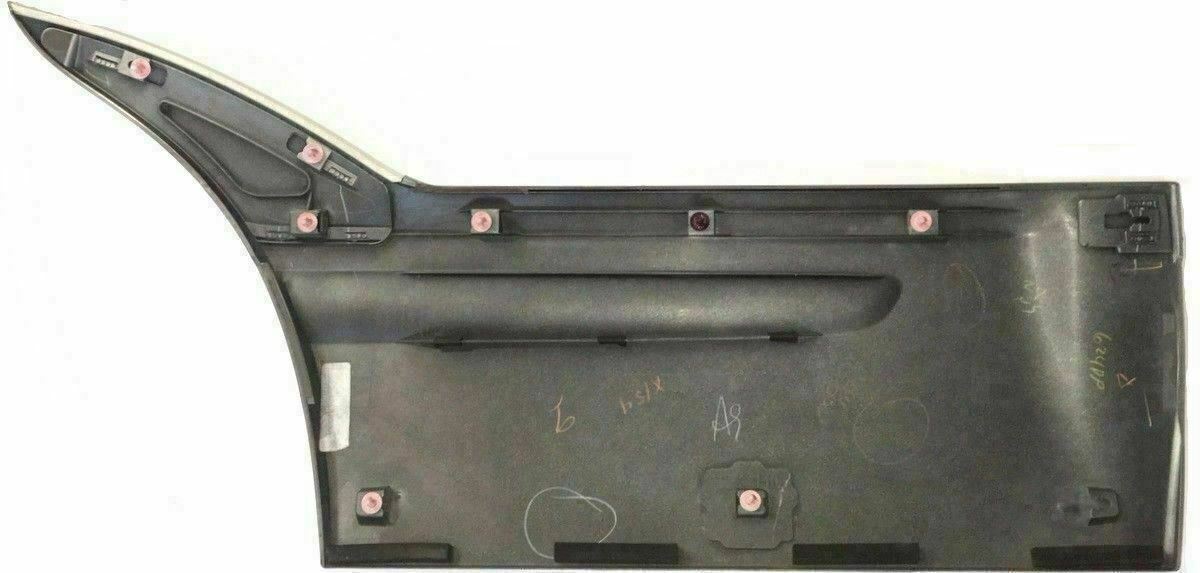

Rather, I'll send the photos 2 at a time!kazeeee wrote: Fri Jun 18, 2021 12:36 am bump; still looking for resources regarding which clips go in which spots.
- Left Driver Side Rear Door Cladding 1a
- Left Driver Side Rear Door Cladding 1a.jpg (40.84 KiB) Viewed 27538 times
- Left Driver Side Rear Door Cladding 1b
- Left Driver Side Rear Door Cladding 1b.jpg (62.19 KiB) Viewed 27538 times

Re: cladding/molding clips
this is exactly what I was looking for, thank you so much!

I forgot to mention that some of the clips are missing from the cladding pieces in the photos BUT all of the clips, including the missing ones, are identical despite being different colors.
