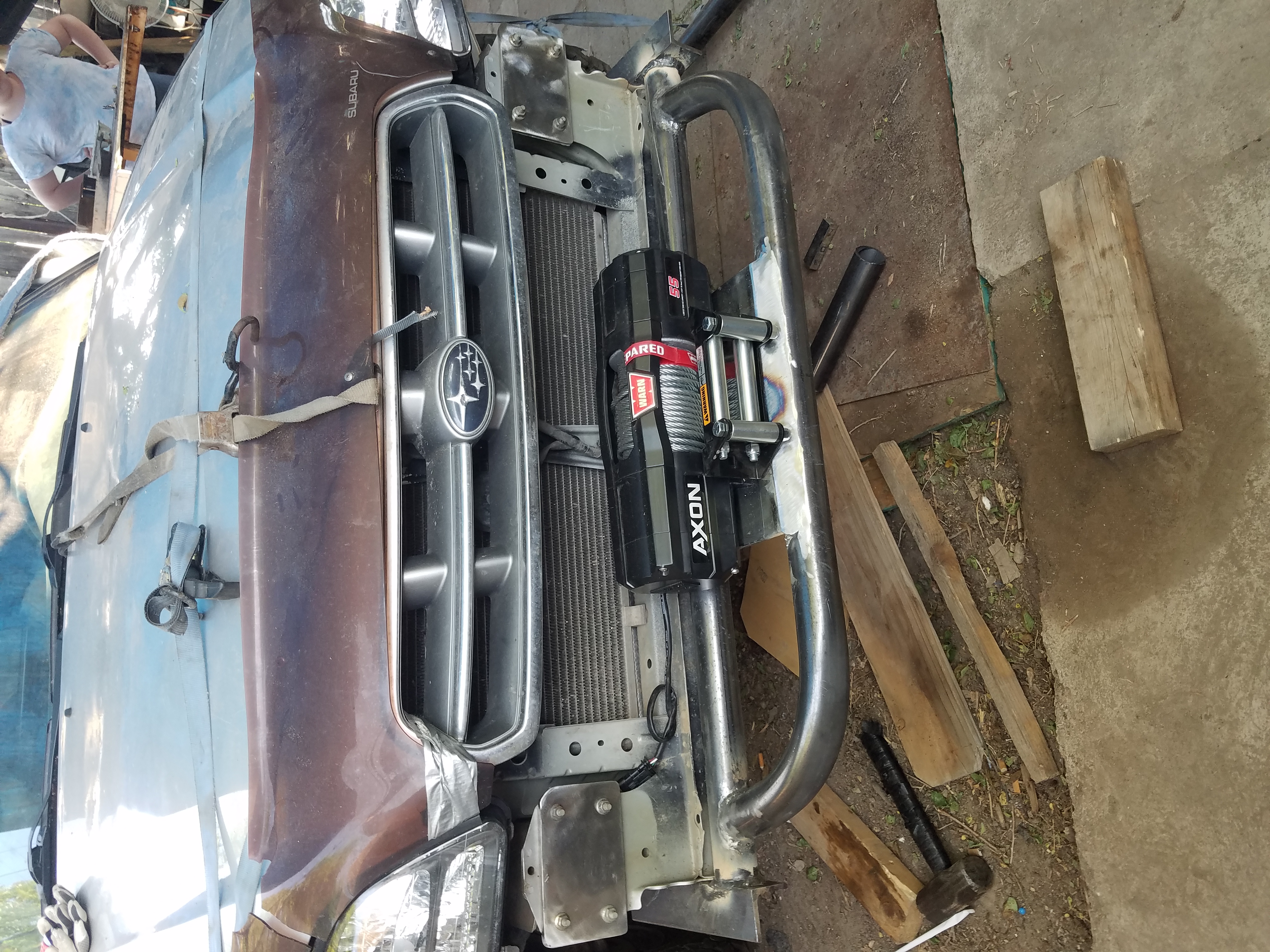

Here is a quick shot of the winch mount bumper. I will be down there tonight looking at it and will get some more pics as it gets more parts added.
- BajaWinch.jpg (4.13 MiB) Viewed 17704 times

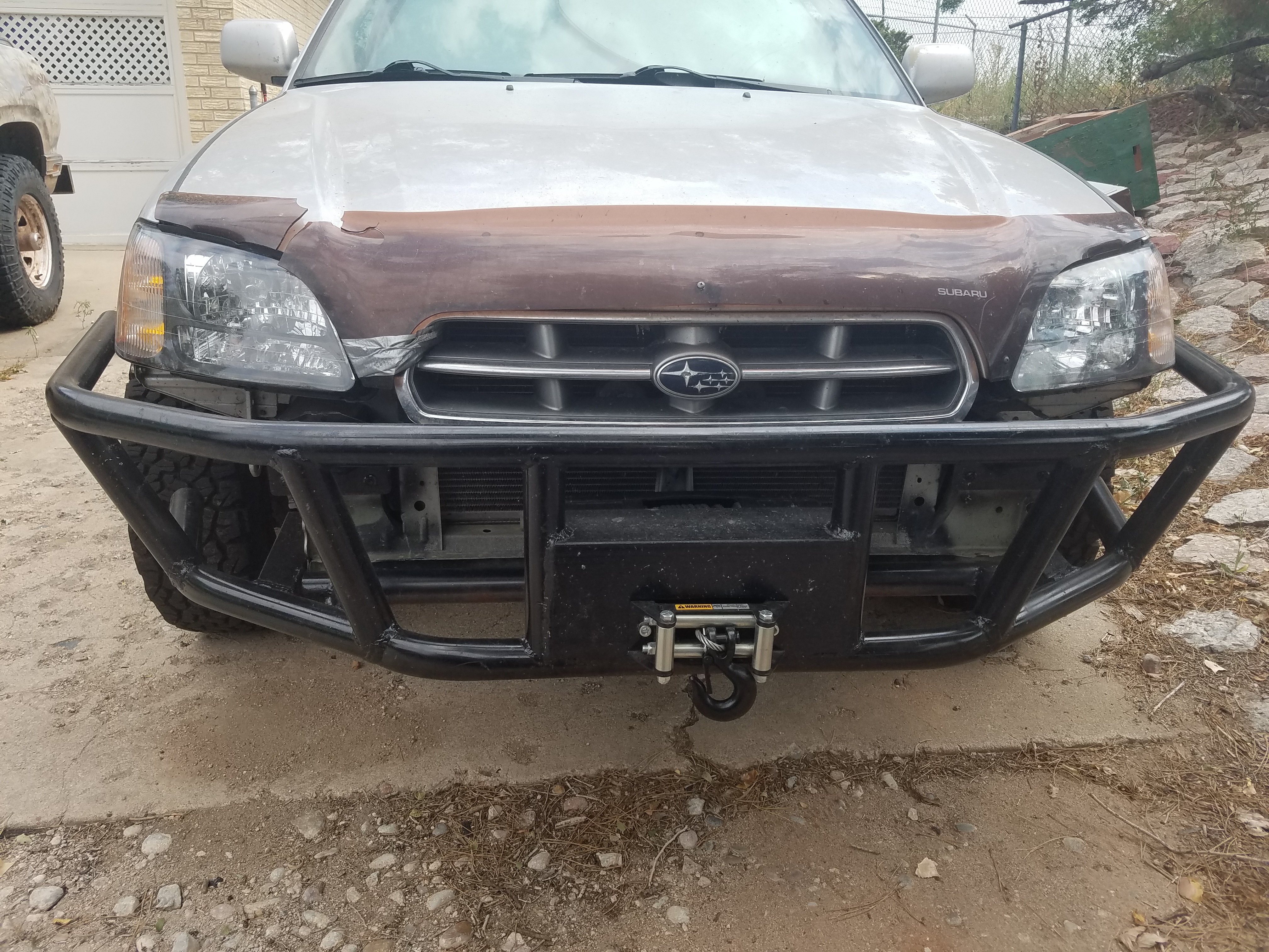

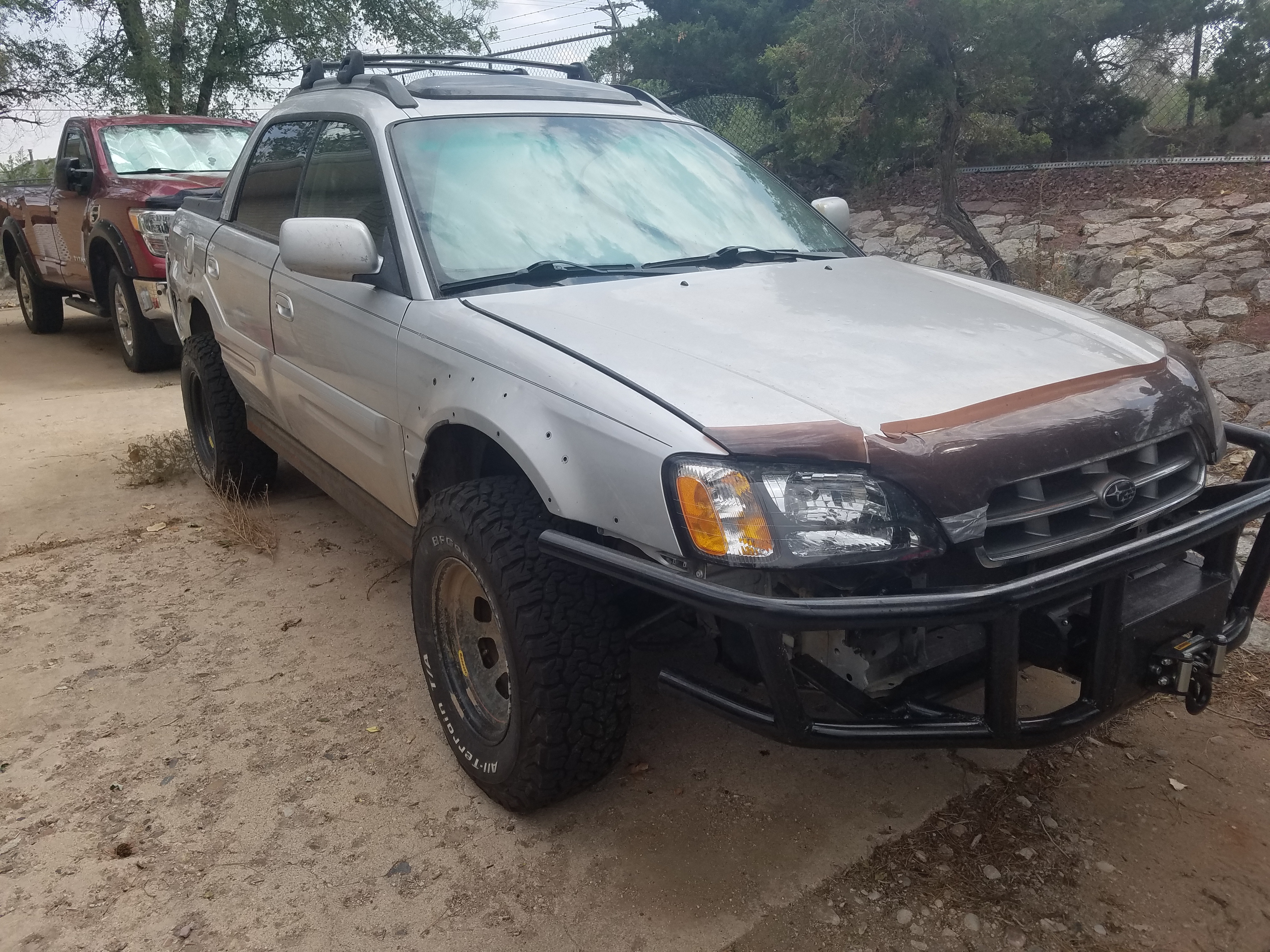

Hi everyone, sorry it has taken so long for an update, I was on a work trip, and the welder broke. Back from trip, and he has a new welder. Here are some pics:
Bumper is almost done, needs to have the push bar added.
5/16" thick, 4x6inch angle iron added as rock sliders

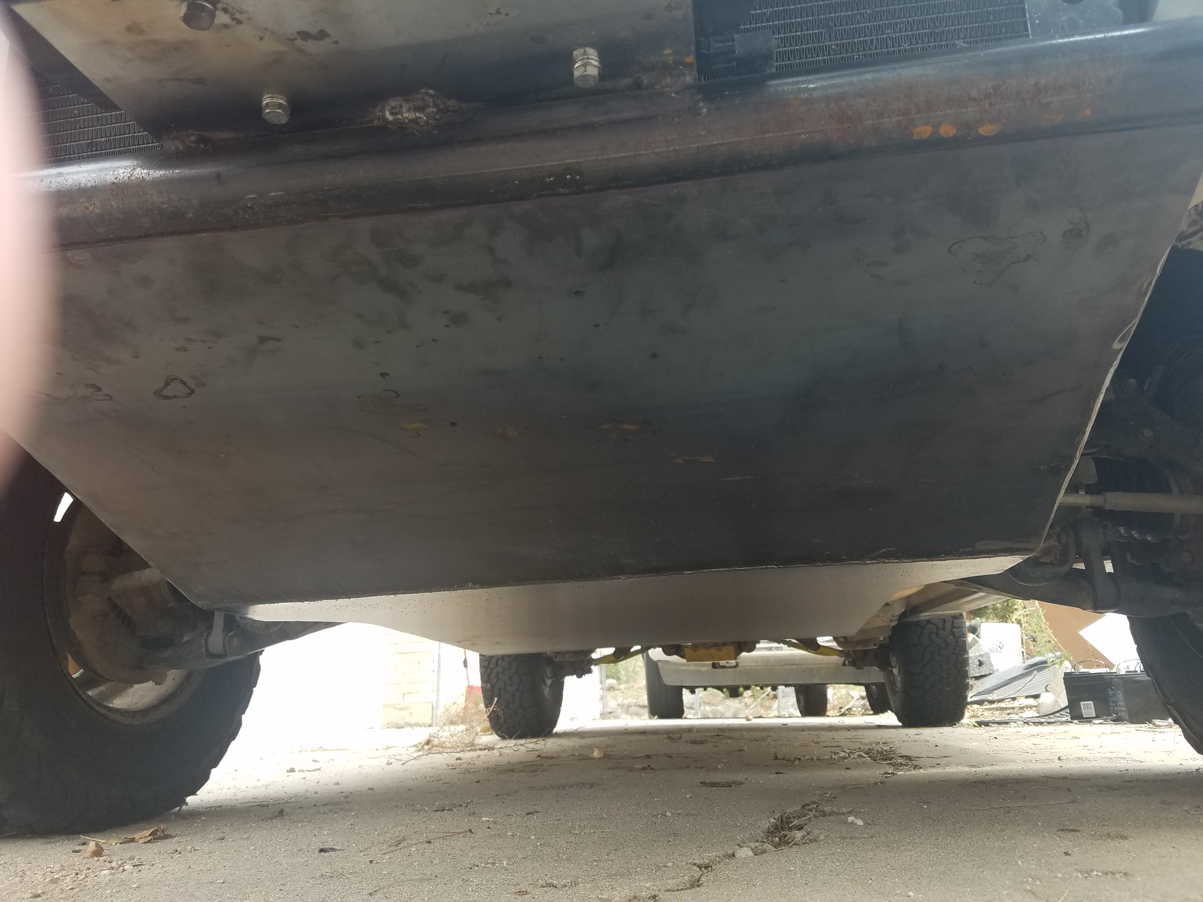

Largest Skid plate ever. Needs vent holes, and might have to cut it down some.. covers the transmission
- 20210831_141042.jpg (3.31 MiB) Viewed 17500 times
- 20210831_141027.jpg (4.65 MiB) Viewed 17500 times
- 20210831_141035.jpg (4.97 MiB) Viewed 17500 times
Re: Who wants an off road/winch Bumper?
I like the bones... Not a fan of the big "teeth"... for a lack of better description.
IMHO... I would alter the design slightly so that the top bar is equal in height to the top of the Wench box... so that some of the factory bumper (could still exist above that point to create a more integrated look.
That's at least what I have imaged having on my Baja... but I lack any ability to make it.
Hi, I am interested in an update on this project. Also any options for a stubby, or bull bar/ winch/lights mount only option - the images are a little beefier than I pictured needed on a Baja. Its a lot of added weight on your front end. Also are you integrating a skid or rock roller bar? Thanks!
