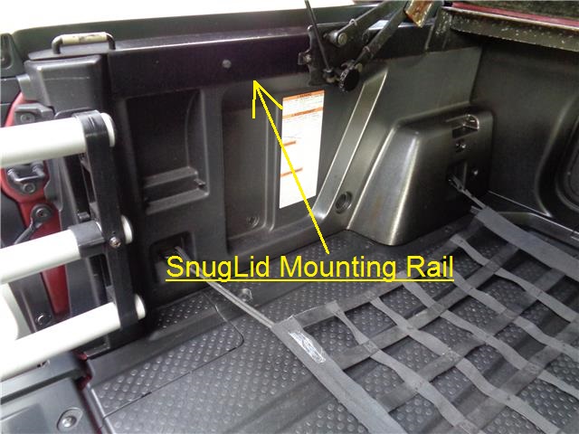

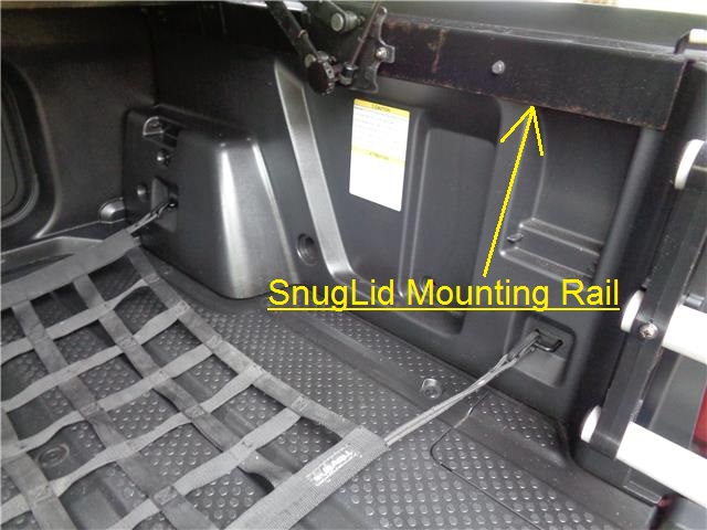

Actually, the SnugLid Mounting Rails are not made of angle iron. They are made of 1/8" plate steel!greymud wrote: Fri Jul 16, 2021 6:31 am The snuglid uses existing bolts on the top or the bed liner - just longer bolts. It's a custom angle iron kind of thing out of thick sheet metal - I don't know the gauge.

Here's a link to a thread I started about 4 years ago when I started to fabricate some missing parts for the used SnugLid I bought. Someone posted photos of original Baja SnugLid rails and I managed to use the photos and my own measurements to duplicate the two mounting rails.MNbuckshot wrote: Thu Jul 15, 2021 6:57 pm Okay so I've seen a few threads about different tonneau covers and truck toppers on here and I think I've got an idea about how I'm going to build a soft topper but I never see anything about mounting. Any ideas from the Baja vets? I'm trying to avoid drilling into the new truck (wife might kill me). So far the idea is a rigid frame probably wood or light metal tubing with either vinyl or canvas stretched over it.
viewtopic.php?f=3&t=3580
(ALSO SEE THE TWO ATTACHED PHOTOS!)
You might consider fabricating them for yourself if you can incorporate them into a cover of your own design. They don't involve drilling any extra holes into the plastic bed parts.
If you want to go that route let me know and I can possibly make a template with exact measurements that you could use to make your own mounting rails. You would need a template because it involves some freeform curves and just having measurements is not enough information to duplicate them!
I would be happy to make a template for you but it would take me some time and effort so please don't ask me for it unless you come up with a design for your cover and you're serious about actually making one. I don't mind helping out because I've gotten a lot of help on this forum for a few different things I've needed but I don't want to waste my efforts on a whim.
Let me know!
