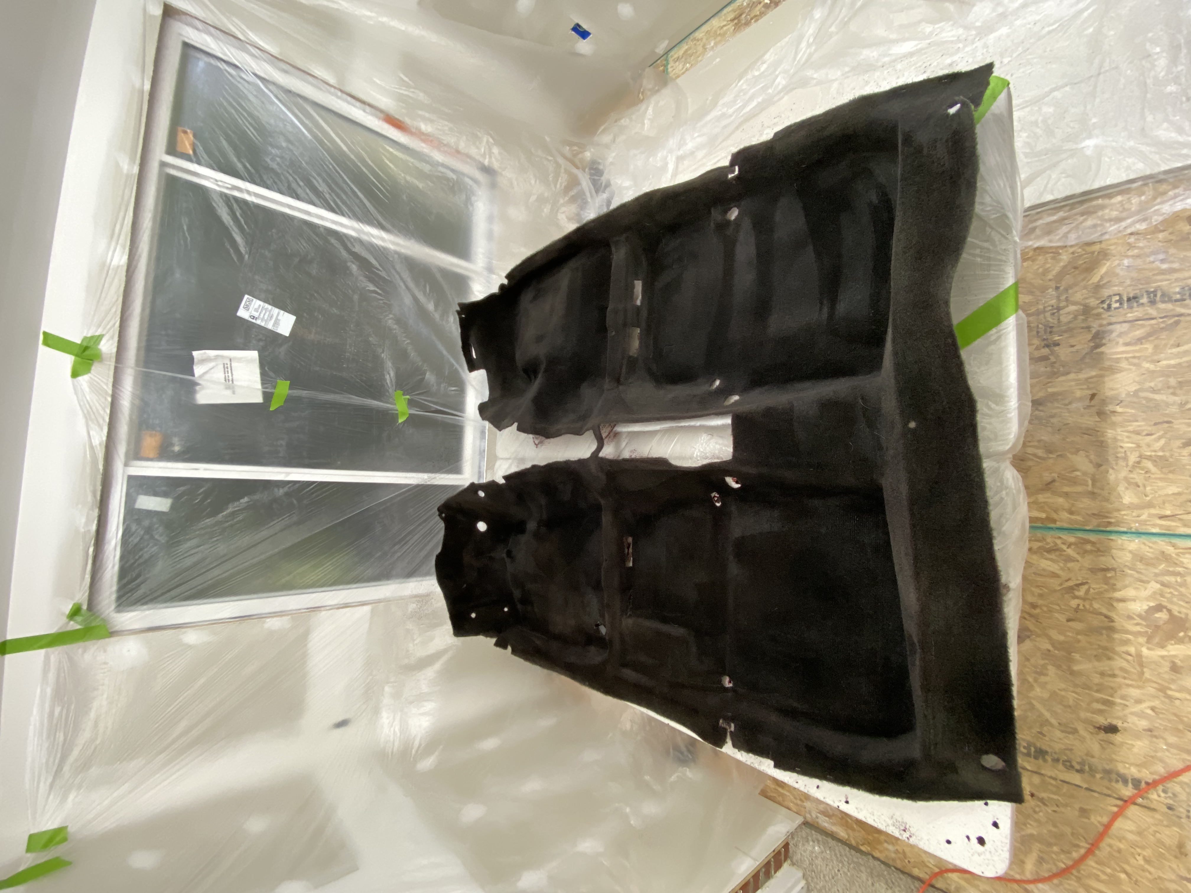

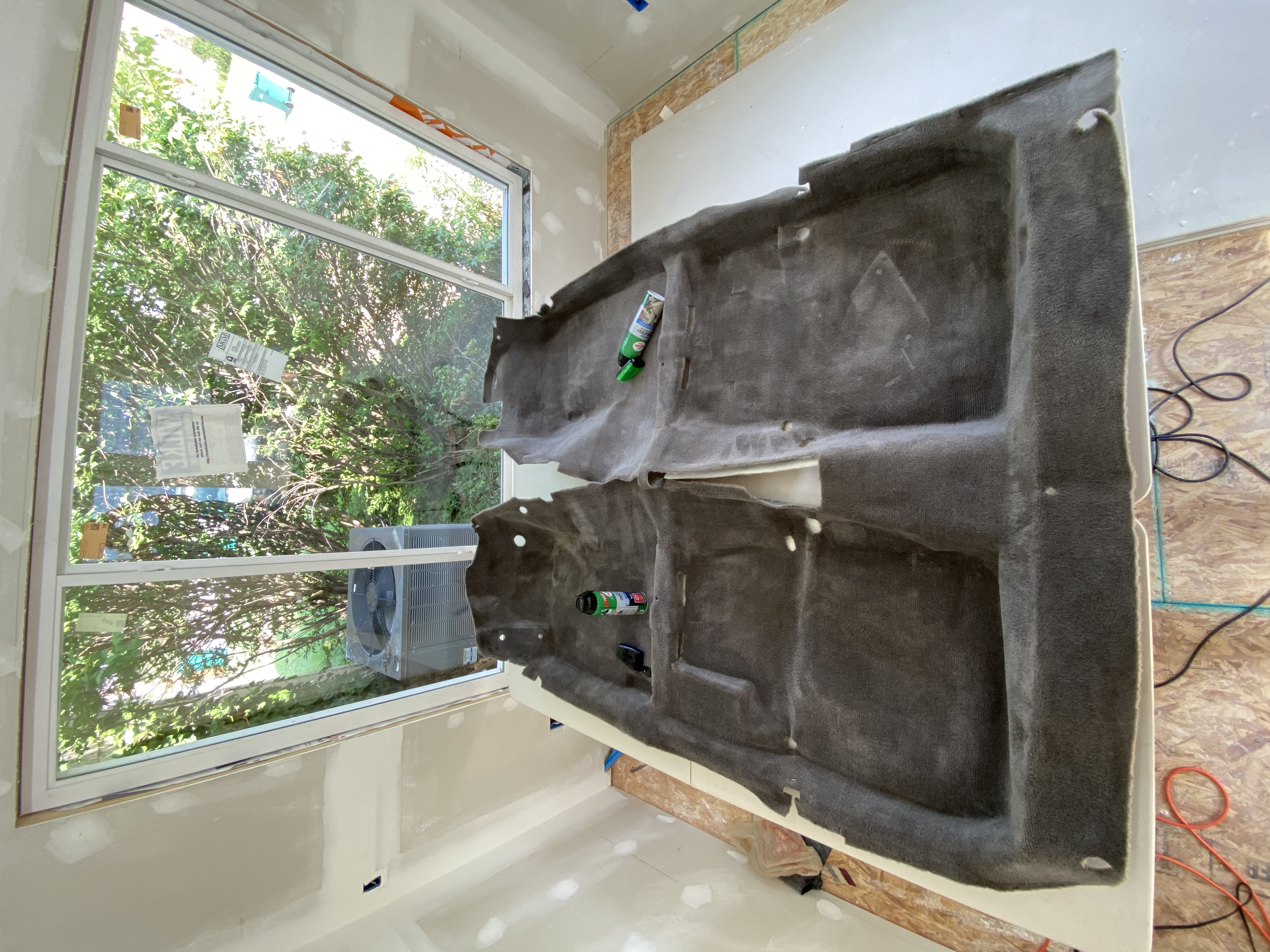

I actually just did this. I found a used Baja carpet on eBay and actually dyed it black and installed it. The dying was messy but it came out really well. I do know of another Baja near me that did and H6 swap out of an '07 outback and installed the dash and center console and the carpet. The carpet installed pretty well but he said it had some loose fitting issues over the tunnel by the seats. He did have to remove the the plastic mounting pieces from the baja carpet and secure them to the outback carpet. I'll add some pics of the dyed carpet I installed. If you are interested in doing yourself let me know and I can give you a quick write up for you.
