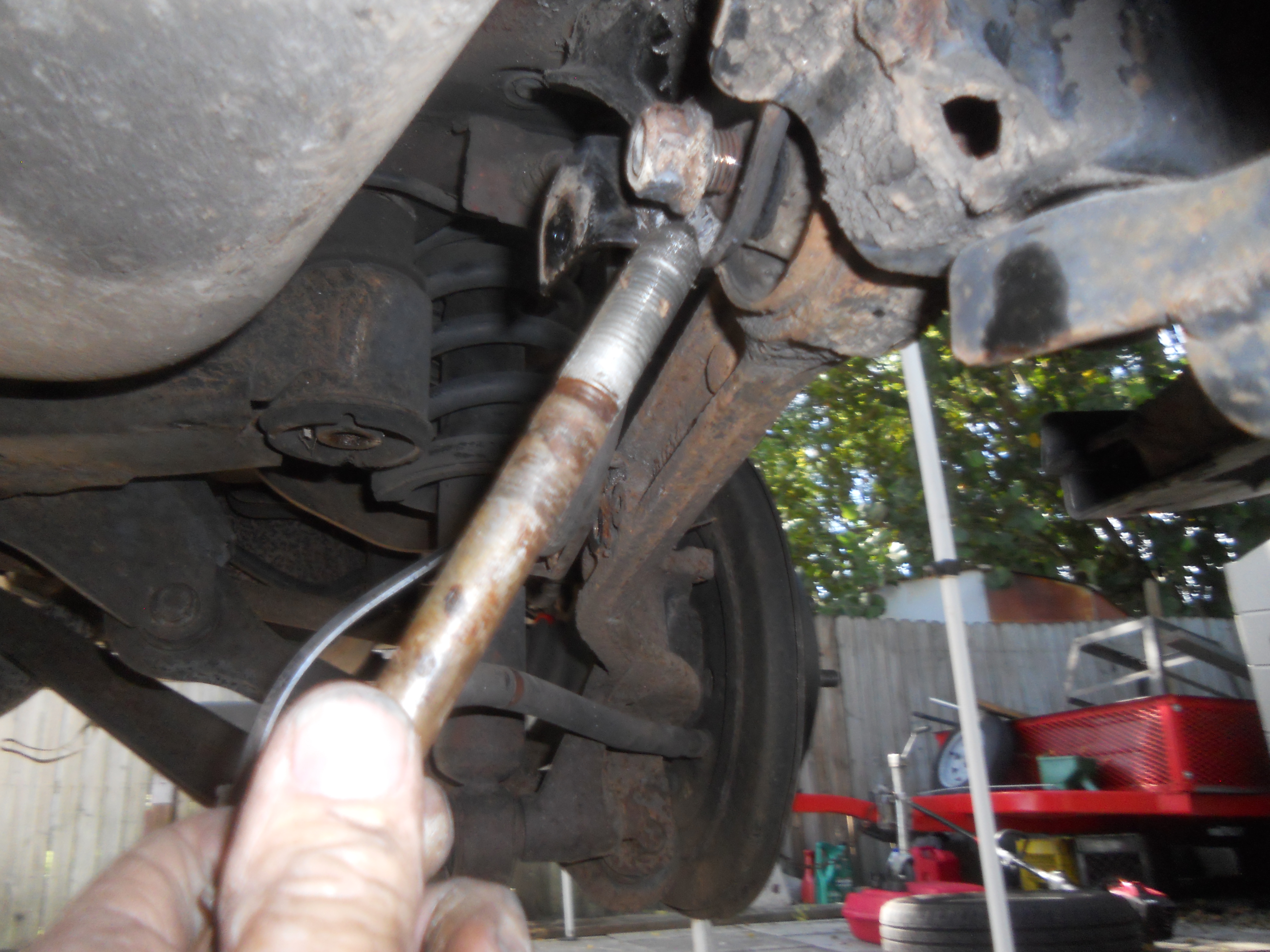

I was able to apply a little heat to the bushing nut and get it off w/o problem, but the bolt was still frozen in the bushing.

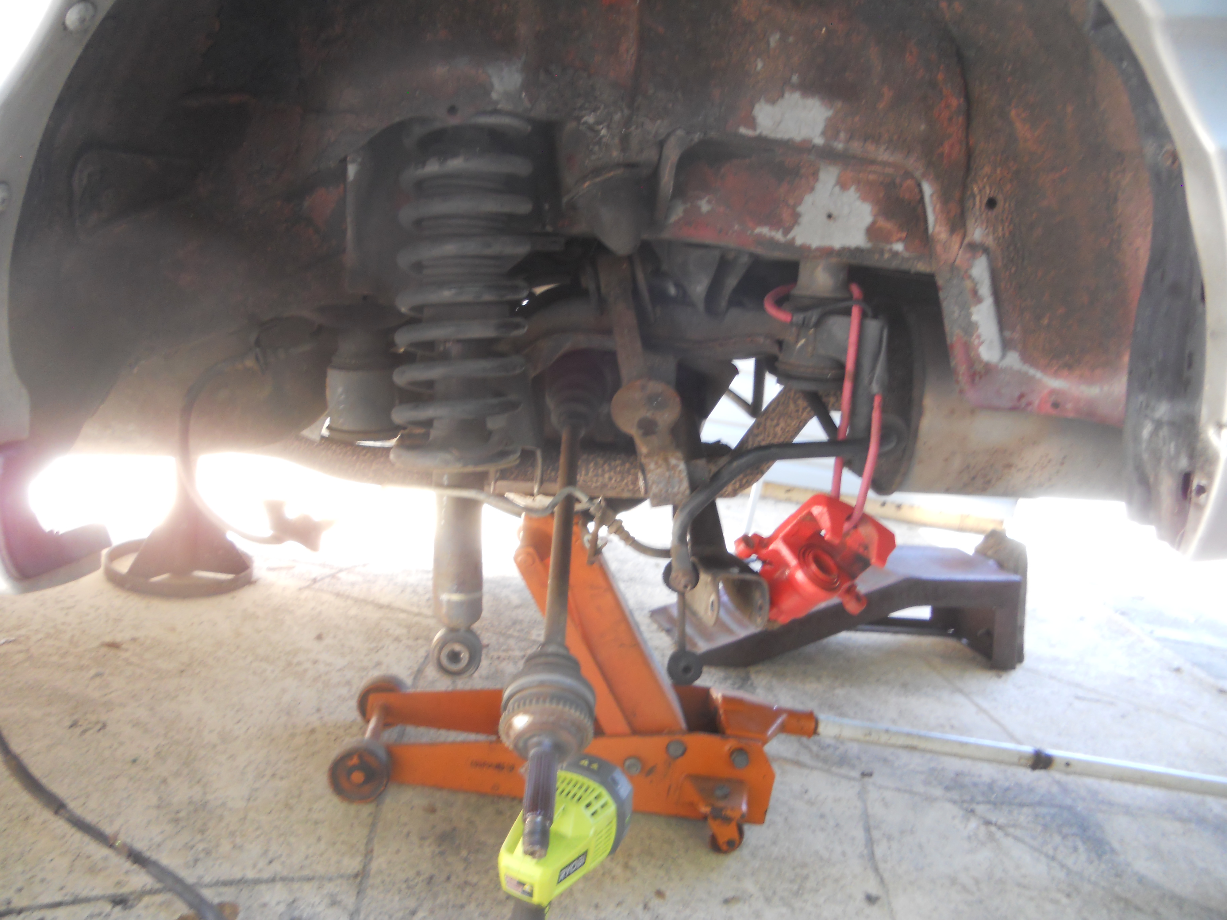

Because of this, I unbolted the shock, the and upper and lower arms, the sway bar link, and the axle nut and ended up pulling the whole arm off bracket and all.

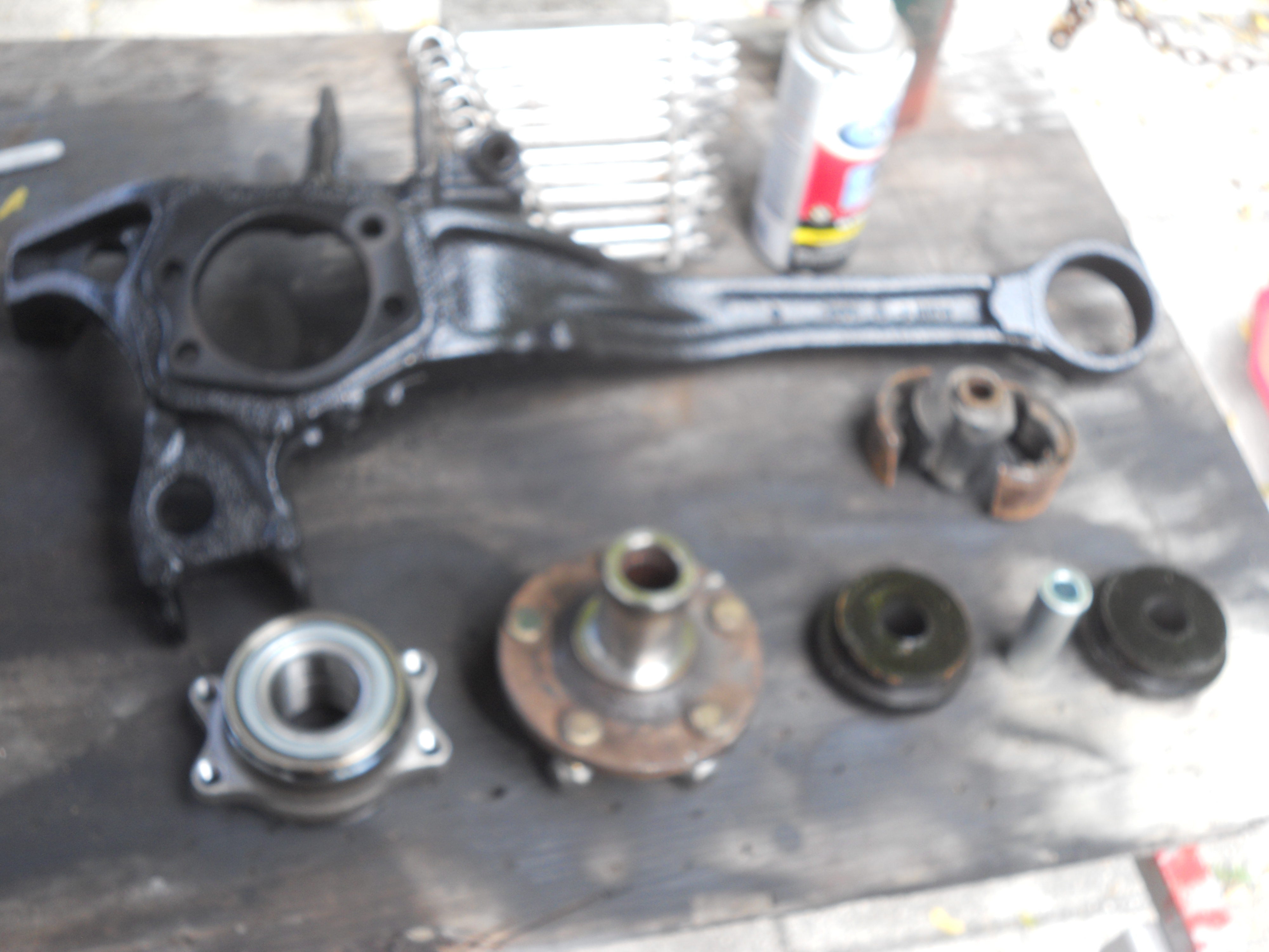

Because the bushing was separated, the center pushed out easily. Some cut through the rubber, some burn the rubber out with a torch. Once the rubber is out, the reciprocating saw was used to cut grooves through the steel shell of the bushing, then I tapped the shell halves out.
After cleaning and painting, I did reassembly. The Whiteline bushing halves easily push into the arm, and the new steel center pushes through the bushing halves. The new bushings pivot on the center bushing, so once installed, the bolt / nut can be tightened. All other bushing bolts (or OEM bushings if used) have to be tightened with the weight of the car placed on the suspension.

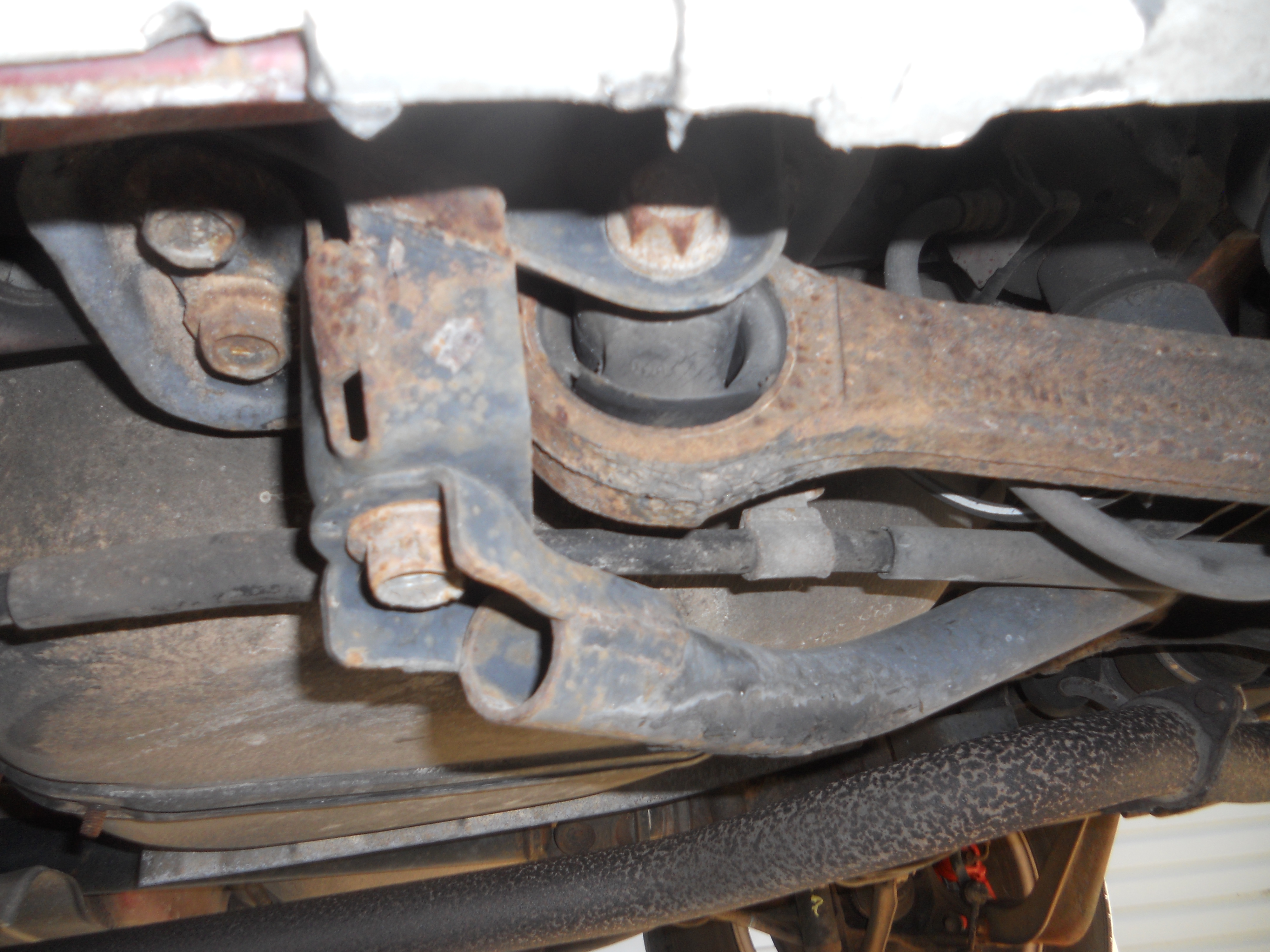

separated bushing - slipped to one side
nut that had to be heated for removal (right next to gas tank!

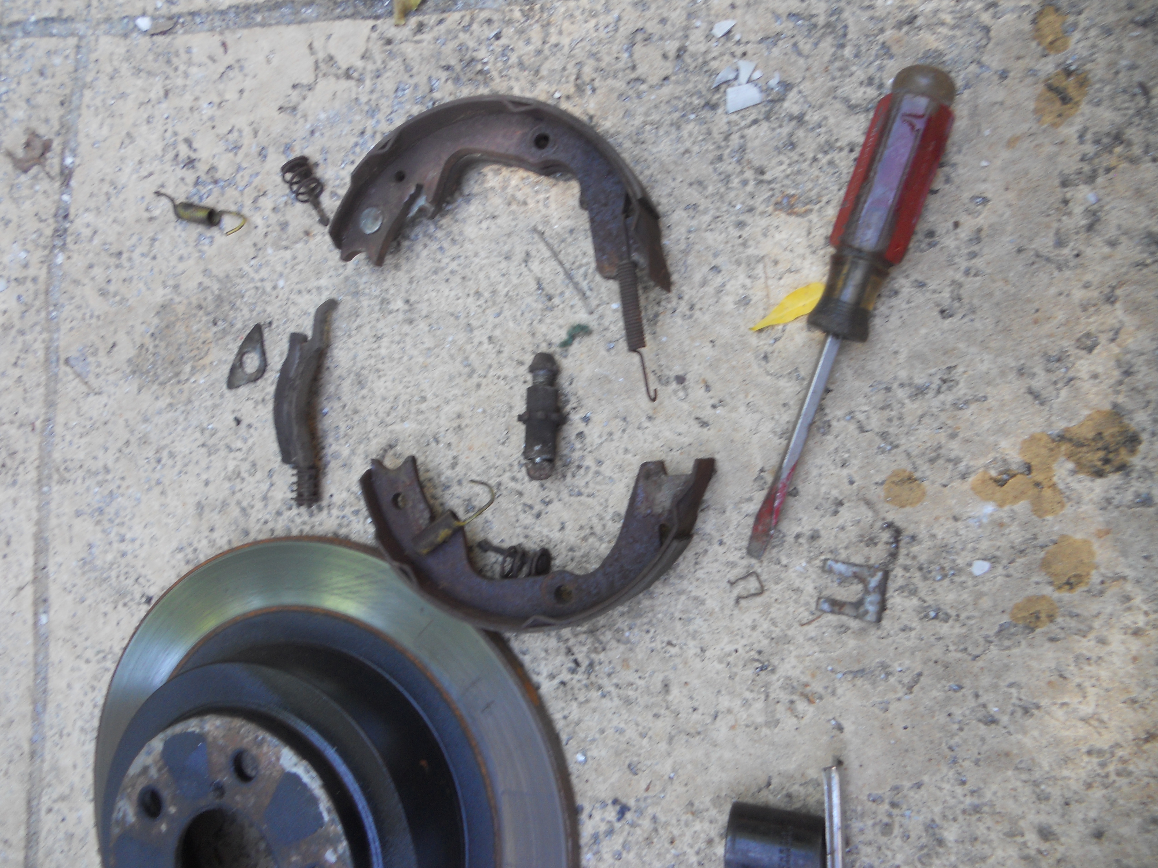

forgot.  Brake caliper, bracket, rotor, and all parking brake parts had to come out

Note in the brake picture, the screwdriver is pointing to a small "horse shoe" clip. This holds the parking brake cable in the backing plate.
Note: If you are going to do this, have a set of GOOD jack stands. You are going to be under the car and you will probably be pulling on a breaker bar. Because you will have the back wheels off the ground, chock the front wheels on both front and rear of the tires.
with everything removed
ready to start assembly
