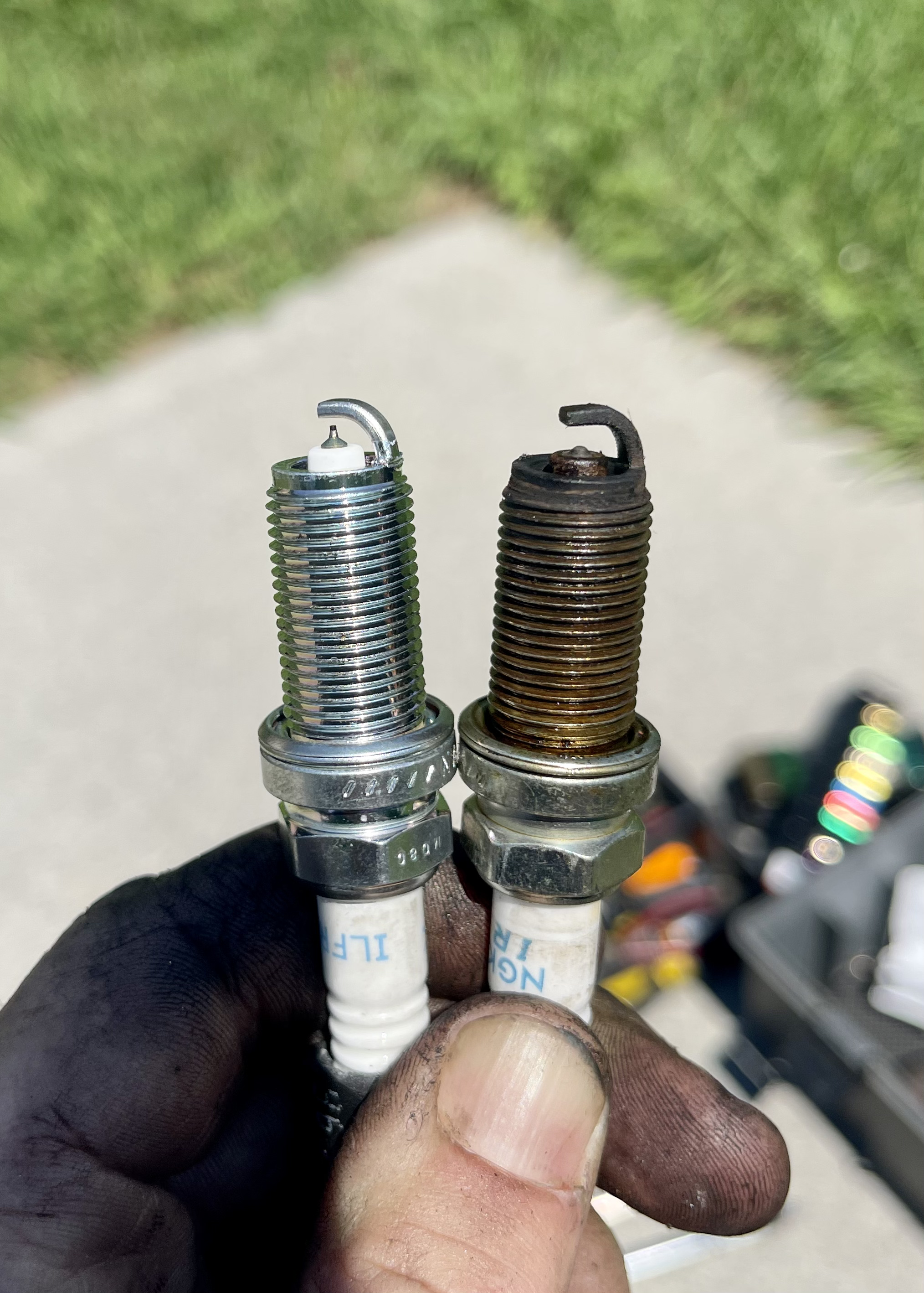

I finally got the plugs changed out, and boy did they need it!
Two 14mm lower motor mount bolts and a floor jack did the trick in about 1.5 hours (taking extra time to be extremely careful of course).
