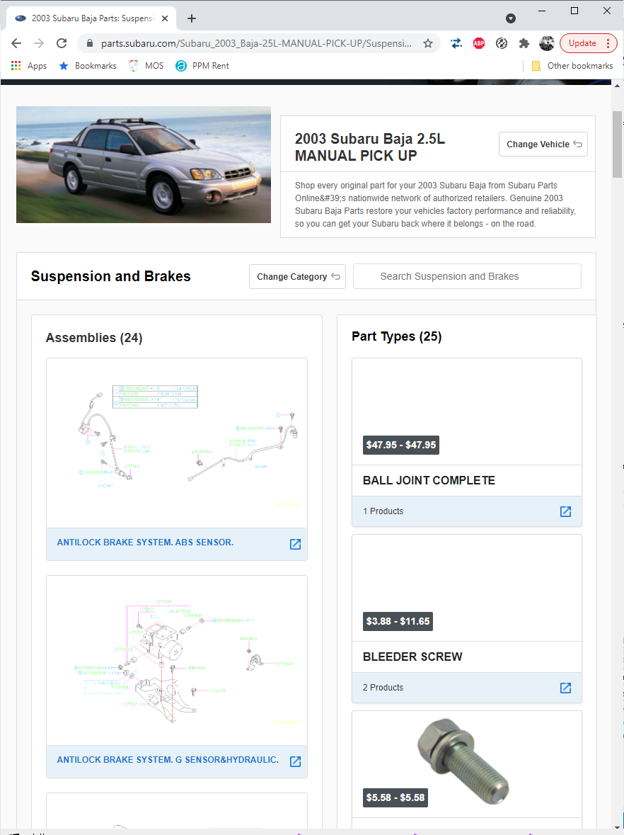

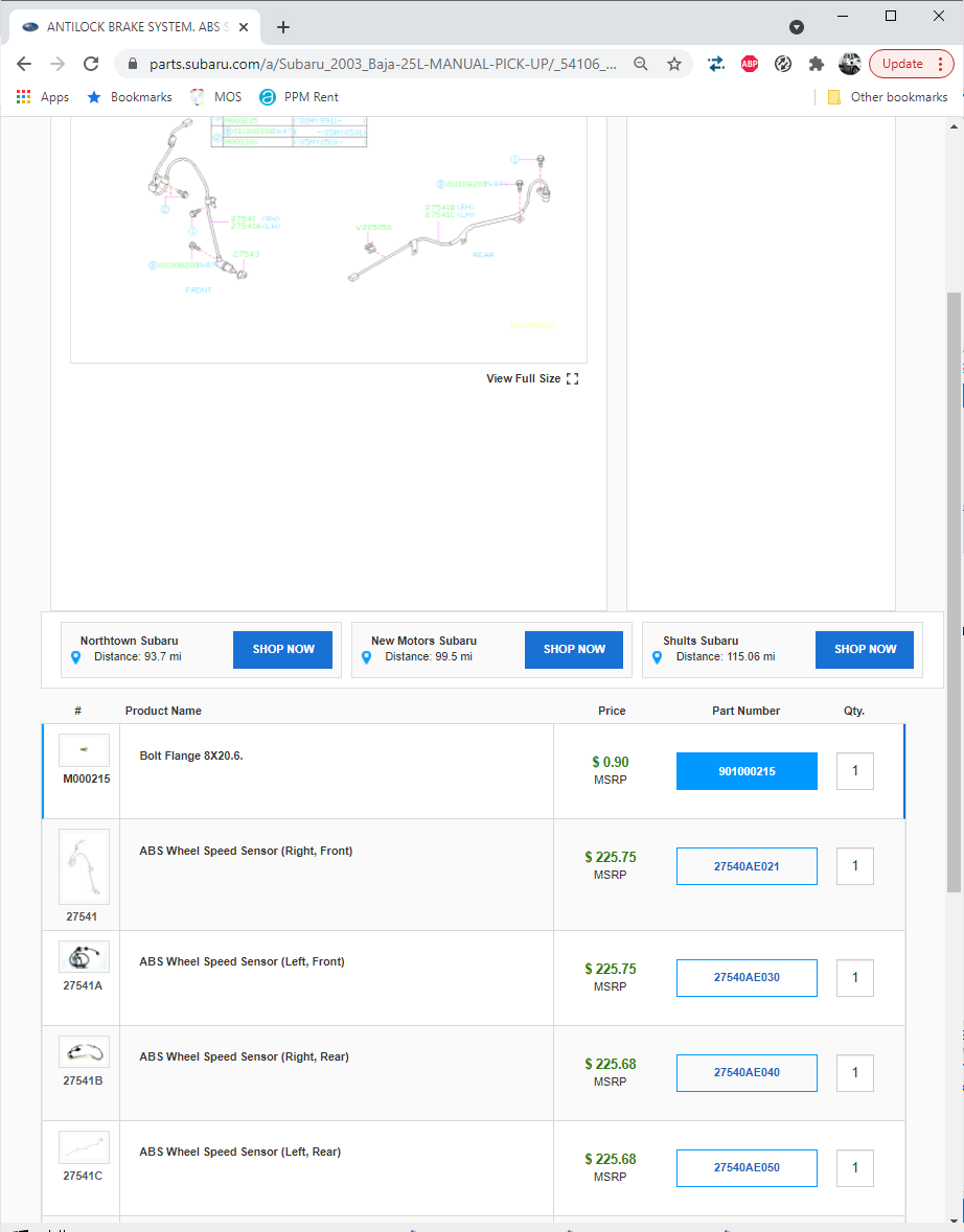

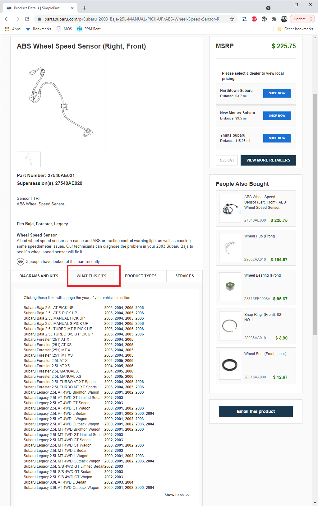

A good place to find guaranteed-interchangeable parts is Subaru's own parts website: https://parts.subaru.com/
They have exploded diagrams of everything on each car: Then in each diagram, there's a list of parts included in that diagram: And if you click on a specific part, you can find the list of vehicles that use the exact same part: Now, if the parts vehicle isn't listed, it doesn't necessarily mean the part isn't compatible; it just means each vehicle used a part with a different part number. Whether or not the two parts are compatible depends on the specific part.
However, most of the parts on the site have some kind of picture of the part, so you can usually determine if there's at least a hope of them being compatible. For example, if the Forester rear strut has three bolts into the chassis (I think it does) while the Baja has two (it does), you know for sure it won't fit (without considerable modification).

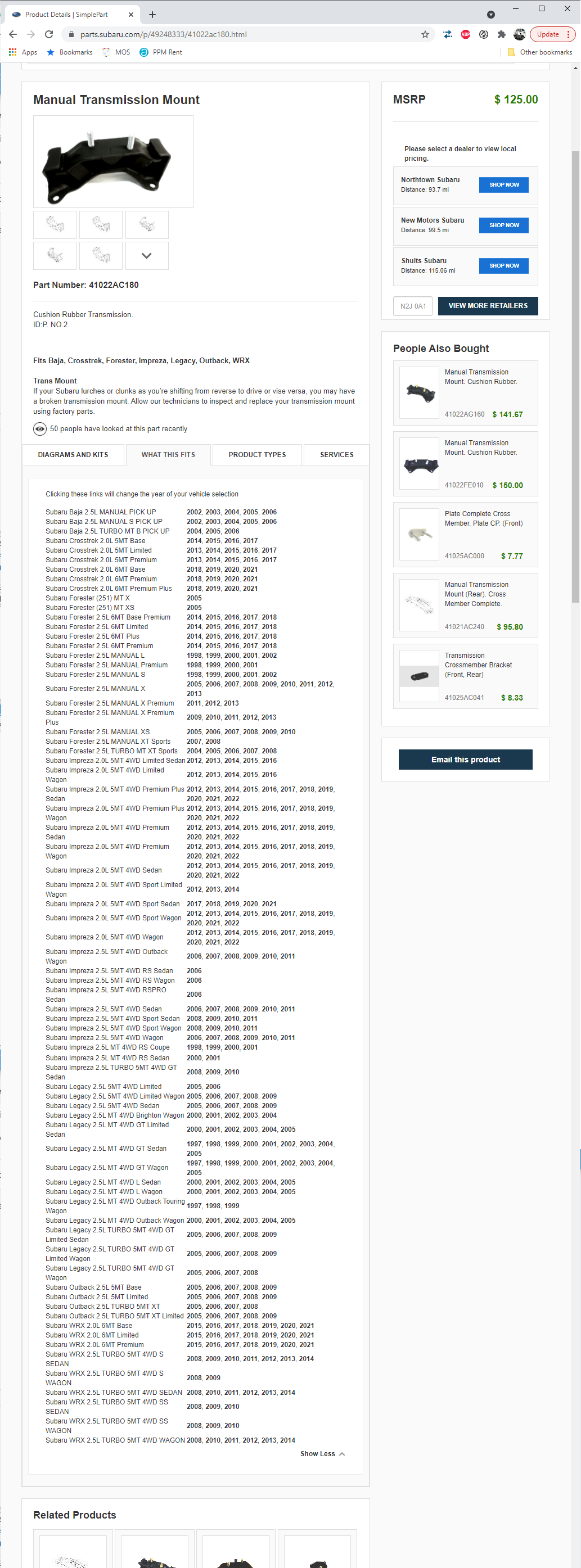

Some parts, like the manual transmission mount, have been in use for over 20 years! (Or, at least, they're compatible with vehicles that span 20+ model years; I imagine some improvements/changes have happened over that time.) Others will be Baja- or Forester-specific.
