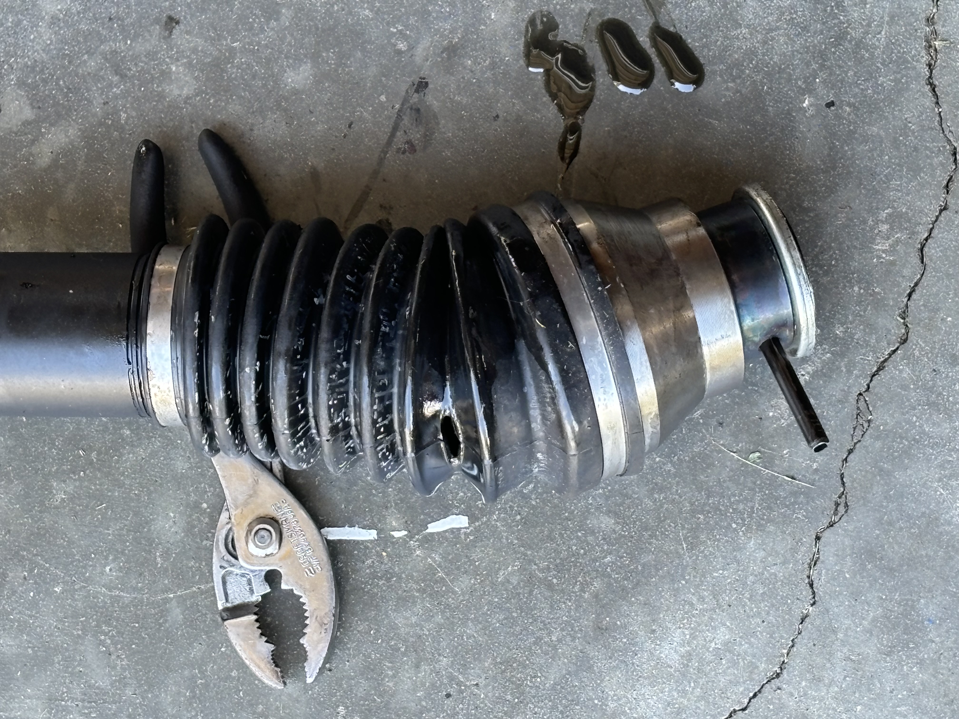

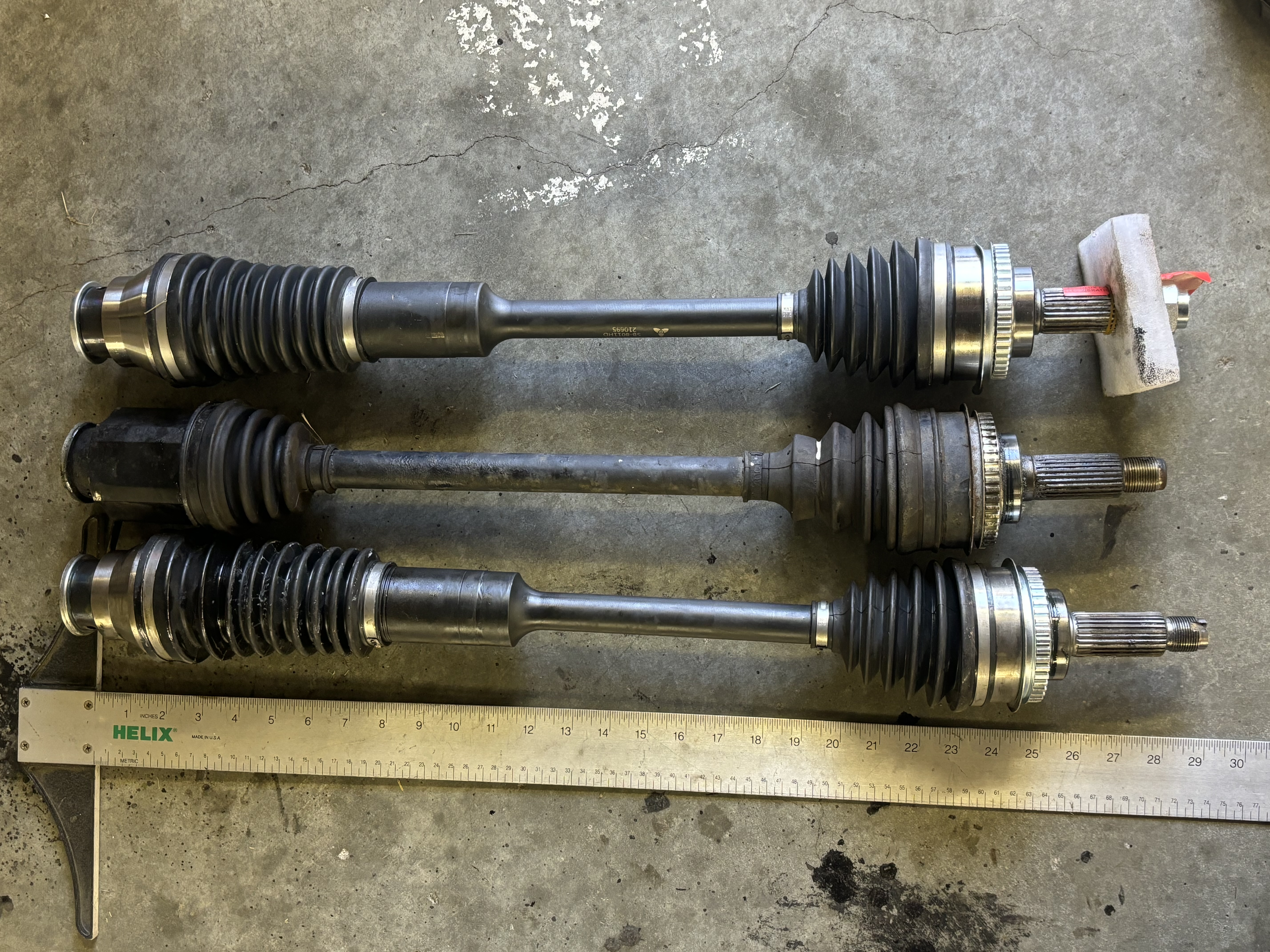

Even if this is an older post it is still a problem. I will be posting updates. I am running almost 5 inches of lift and I’m going through allot of axels. I’m trying different kinds and the heavy duty and extended axels are failing within 100 miles. It is the poor boot quality. They are tearing.
- IMG_7811.jpeg (2.6 MiB) Viewed 106492 times
- IMG_7817.jpeg (5.23 MiB) Viewed 106492 times
Re: 2003 Subaru Baja CV Axles after 2" lift
is it only the boots failing or the joints die? i just installed the trakmotives myself.Z-bolt wrote: Mon Jul 08, 2024 8:04 am Even if this is an older post it is still a problem. I will be posting updates. I am running almost 5 inches of lift and I’m going through allot of axels. I’m trying different kinds and the heavy duty and extended axels are failing within 100 miles. It is the poor boot quality. They are tearing.
