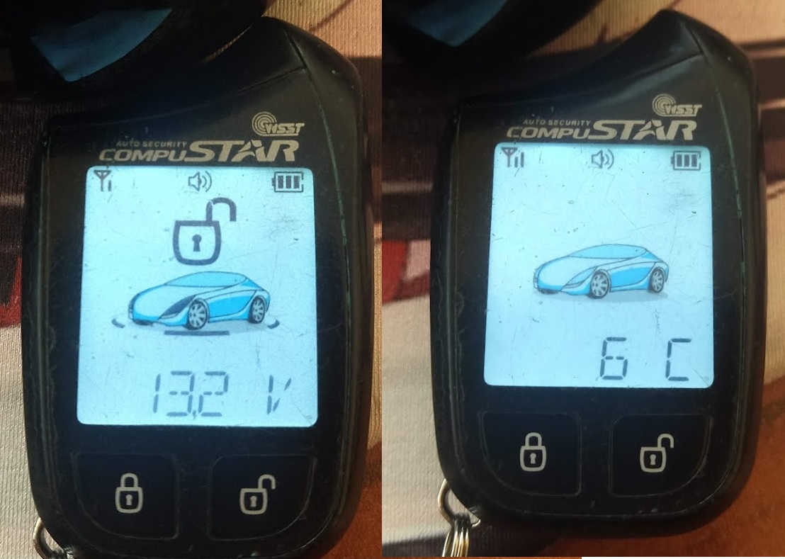

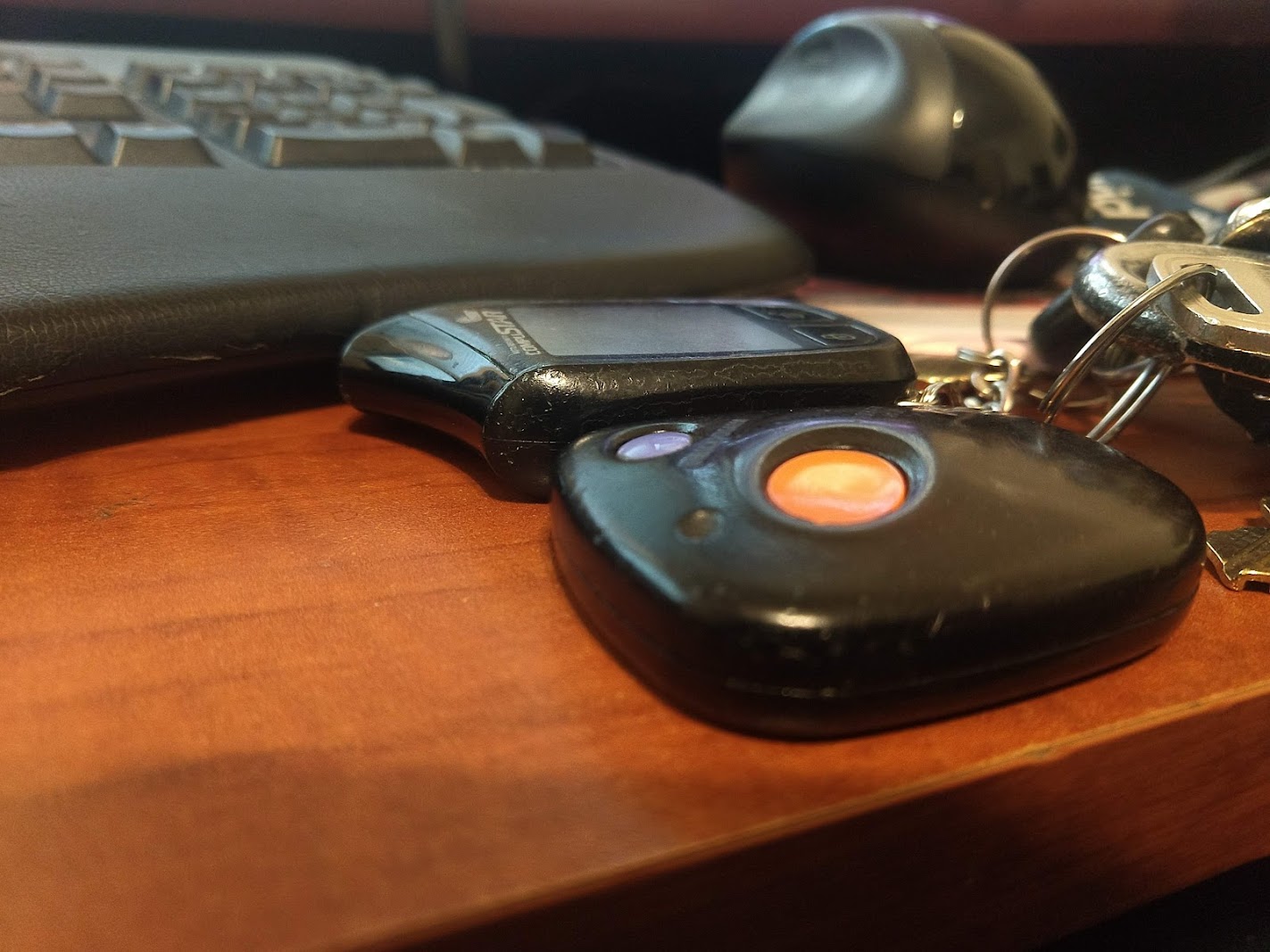

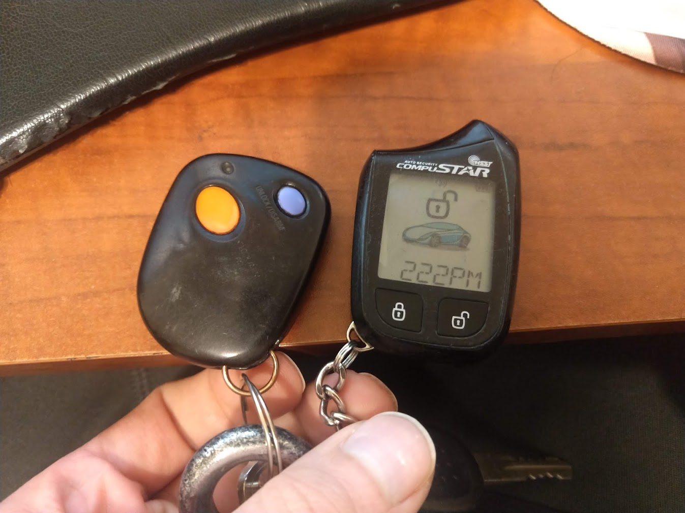

I had a remote starter installed in mine around 2011-2012, and it's still working. Not sure the model number of the overall system, but it's a CompuSTAR, and the remote model is 2W901R-SS. It's likely been superseded by many models already.
My Baja is manual, so if yours is auto, this may not be a consideration. To make sure the car isn't in gear when trying to start it, instead of relying on the neutral position switch, it has a special "procedure" to "arm" the remote start feature. When parking, set the parking brake, release the foot brake, and take out the key; the engine will continue running. Get out of the car (while the engine is still running), and close the door. The doors will automatically lock, and the engine will shut off. The remote start system now knows that the transmission was in neutral when the driver got out of the car. If the door is opened for any reason, the system will not allow a report start until that procedure is done again, since it can't guarantee someone didn't put it in gear while the door was open. (Yes, it's still possible to trick the system by leaving the window down and reaching in to put it in gear without opening the door, so, you know, don't...). None of that is applicable to automatics, since the car won't (shouldn't) crank unless it's in neutral or park.
It has a two-way remote, so when you lock or unlock the doors, or try to start, the system reports back to you if the command was successful (helpful if you're in a mall/office or otherwise can't see/hear the car). It also notifies you on the remote if someone opens the door after you lock it. You can also query the temperature in the cabin and battery voltage. The range is also quite good (I've been in the center of a shopping mall or far end of an office building, and it communicated fine). None of these are features exclusive to this system/brand by any means... they're just features that the OEM remote doesn't have. So, I'd say it can completely replace the OEM remote, at least for daily use.
It was a Christmas present, so I'm not sure how much it cost to purchase and install (not that it would be relevant 10+ years later, anyway). Likewise, no idea about ease-of-installation and things like that, since I wasn't the one who installed it.
I doubt Subaru offers an OEM remote starter for the Baja now, and even if they did, technology has come a looooong way since then, so it would have fewer features, a larger fob, shorter range, less customizability, etc., than any decent aftermarket system you can by now. There are even systems that communicate using cellular networks instead of typical RF, so you can be notified on your phone if someone breaks into your car while you're on vacation (but those typically require a monthly/yearly subscription, because of the cloud/cellular service).
Anyway, I've been pretty happy with the system. Only gripe I have is the non-user-replaceable battery in the remote. The built-in rechargeable Li-Po battery lasted about 10 years for one remote, and the other one is still working "alright" (a couple of weeks between charges instead of months), but eventually they'll need to be replaced, and I could only find one other person who tried to do so, and it was quite difficult. Either way, it's relatively rare for any battery to last that long, so no fault to the manufacturer about quality. However, it is designed to be easy-to-assemble at the factory (one-way snaps, etc.), but impossible to service without damaging it (like many things nowadays....*sigh*).

- I see in your photos that the Compustar remote has a Lock & Unlock button. Do those two buttons work in place of, and the same as, the original Subaru door locking Fob?

In terms of daily usage, similar to many other electronic devices, it has a three-bar battery meter on the remote display. When the battery gets very low (less than a day charge remaining), it starts beeping. Also similar to other devices, batteries degrade over time, and eventually don't hold as much charge as they used to when new. Like, when it was new, it would last for several months between charges. After several years, it would need to be recharged every couple months. Now it needs to be recharged every couple weeks.SoobyToo58 wrote: Sun Jan 16, 2022 9:26 am
- You said that the Remote has a built-in rechargeable Li-Po battery. Does it give you a warning when the battery is getting low and needs a recharge soon or does it just all of a sudden die one day making the system inoperable?
Note: The voltage shown in one of the photos is the car battery voltage, not the remote. Similar with the temperature; it's the temperature in the car (wherever the control module is placed).

Yes, they work the same, so you don't need to have the Subaru fob with you. It also has a "panic mode" (hold lock for a few seconds), similar to the Subaru fob.SoobyToo58 wrote: Sun Jan 16, 2022 9:26 am
