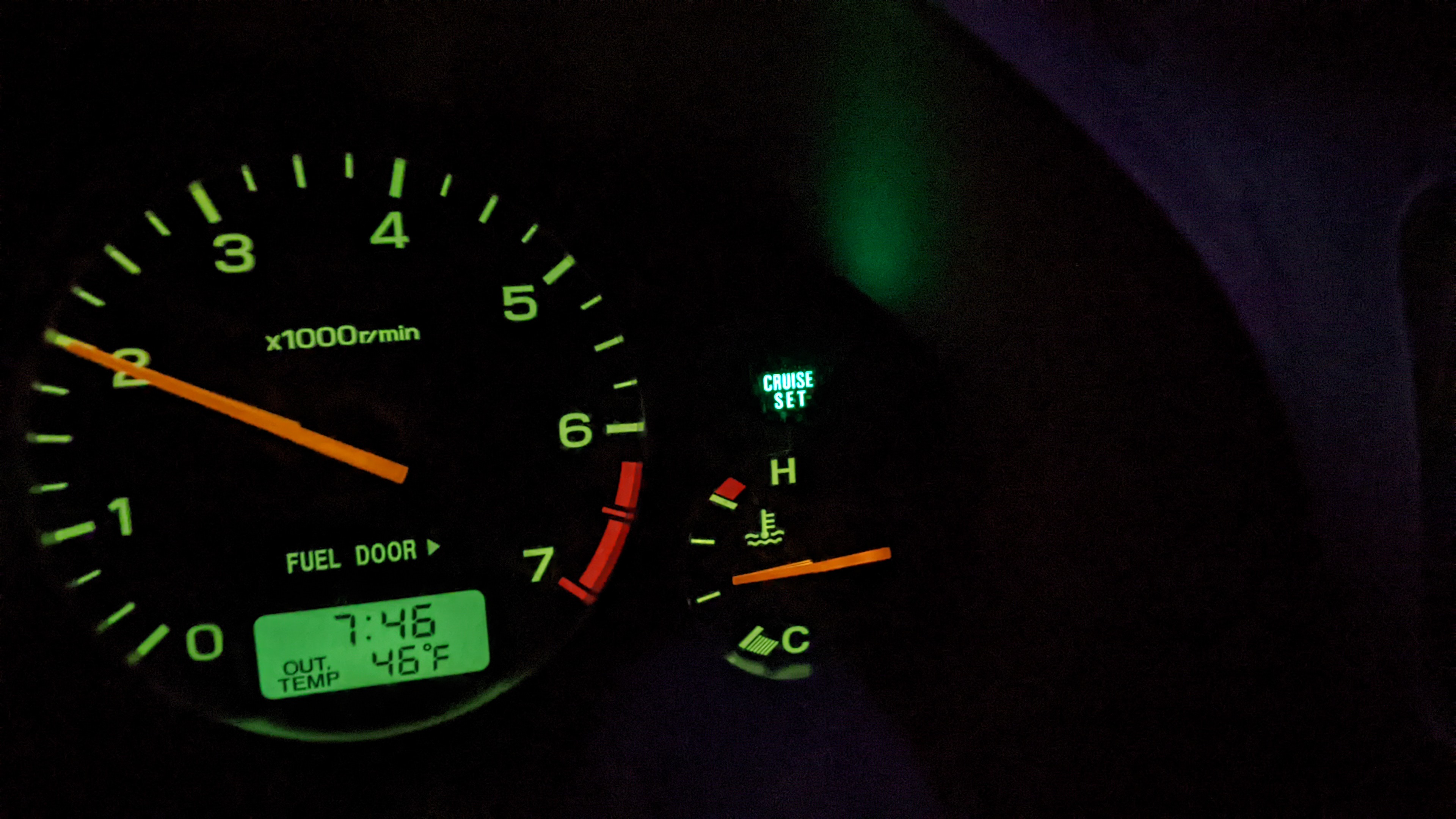

Toybox06 wrote: Tue Jan 25, 2022 9:14 pm ...more frustrating is there is no cruise set light on the dash to know if I got the sweet spot...
There should be an indicator light above the temp gauge that comes on when Cruise is engaged.
