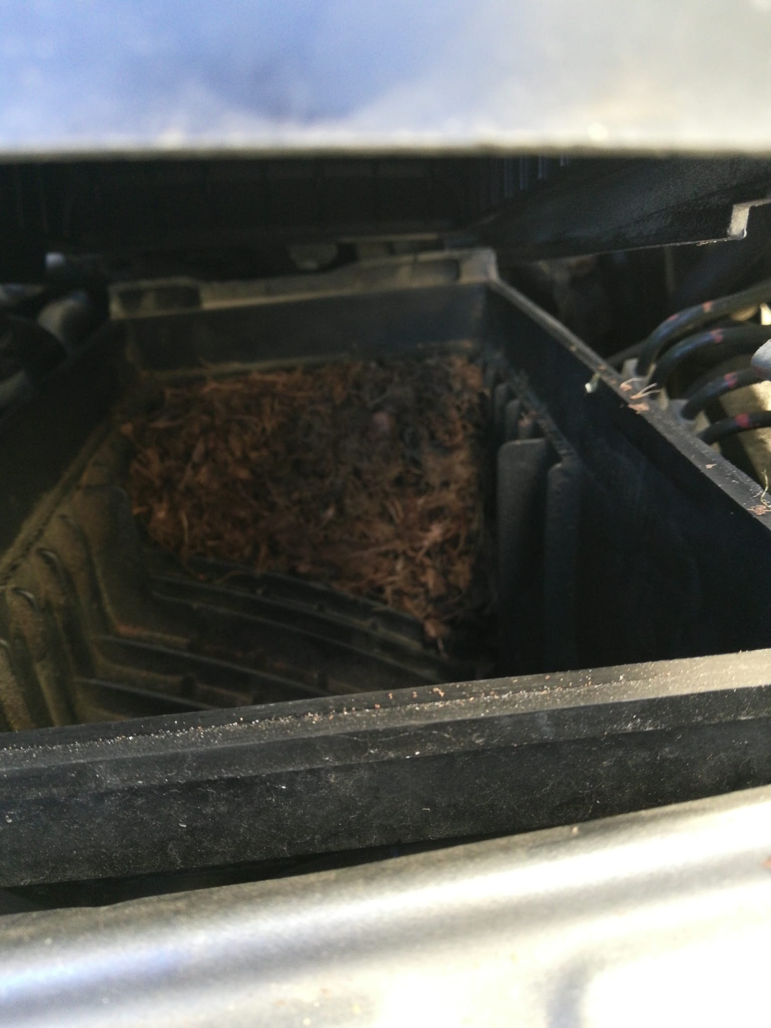

Problem solved!
Had him pop the aircleaner open and guess what he found?
Got the mouse/squirrel nest cleaned out of the airbox and car is back to running great. Now I sent him off to buy a metal reinforced air cleaner 🙂
