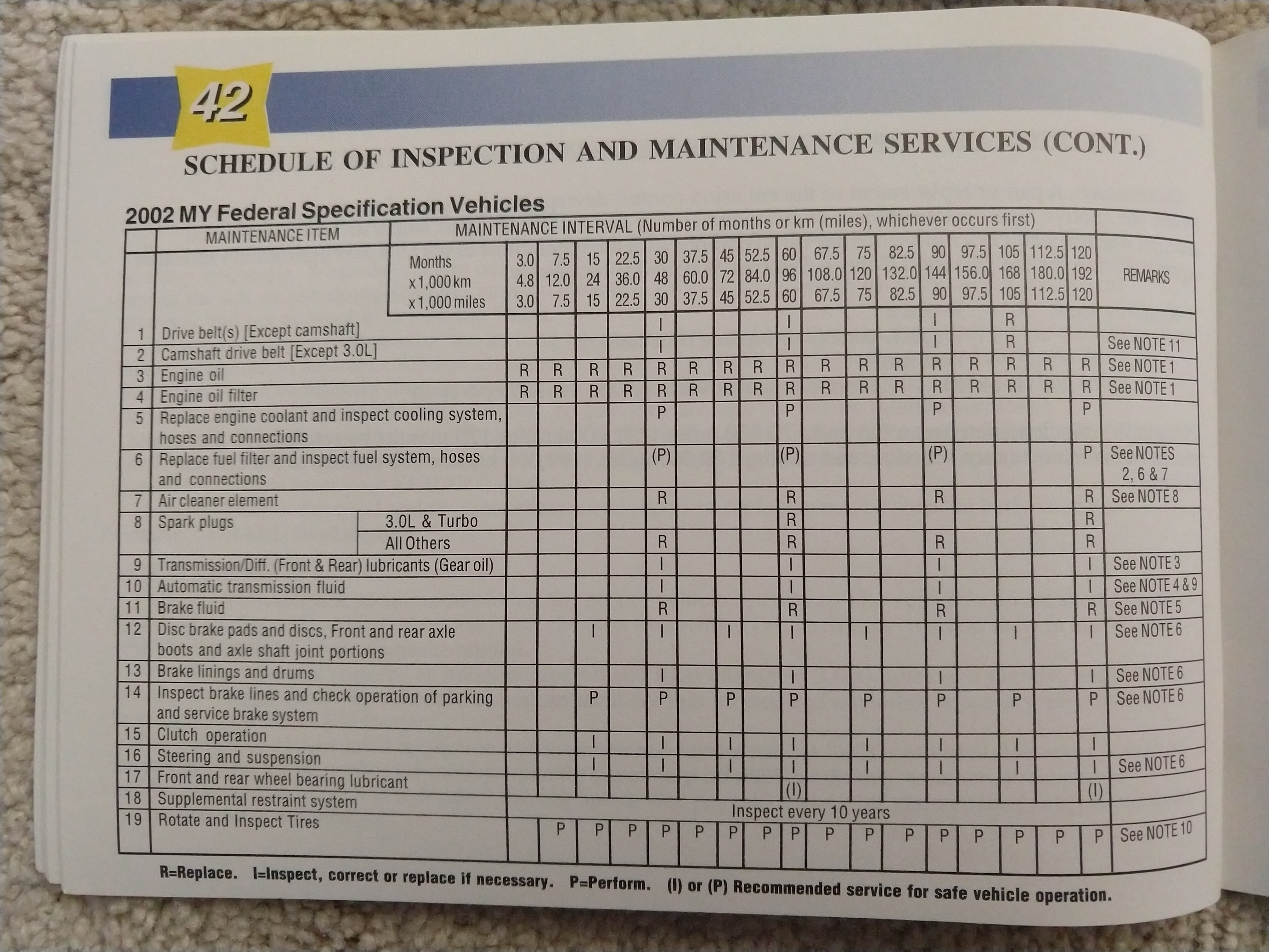

I have the Warranty and Service Booklet for a 2002 Outback, which is basically the same car with nearly the same drive train. I can scan that if that works for you.
Here's a photo of the chart in the book. LMK if you'd like the rest of it.

I just looked at the paperwork that I received with my 03 Baja and I don’t see any difference on page 42 of the warranty and maintenance booklet than has been posted by anarchy1024. If you do think of anything that you would like to see from my paperwork however let me know and I will be happy to send it to you. I am challenged by all of this new technology and don’t know how to scan but I could text you pics of pages...

I mean, attaching a PDF document of the complete booklet, since there's additional information about the service intervals (like, if you drive in dusty areas, shorten the interval for X parts by Y amount).
