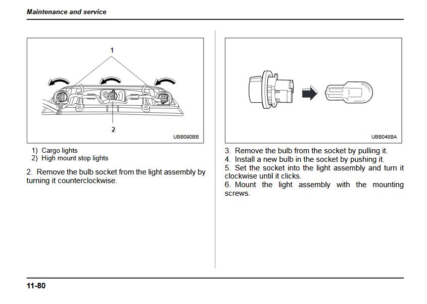

Has anyone installed one of the kits/bulbs that first causes the light to strobe 5 or 6 times and then stay lit? A couple of years ago I replaced the white cargo bed bulbs with LEDs. The 912 and 921 bulbs are pretty small and there isn't much room in that housing. Illustrations of the strobing bulbs shows that they're pretty large. Seems to me that the strobing bulb would be worthwhile if there's room. Anyone try it?

Ooooohhh just the brake light, now I understand. Well according to the owners' manual it looks like that bulb is the same as the taillights, so might be just plug and play with the right size?

It arrived, it fits, it works. No way for me to do a video showing it in action. Check amazon under "Strobe stop light bulb" to see videos. :D
