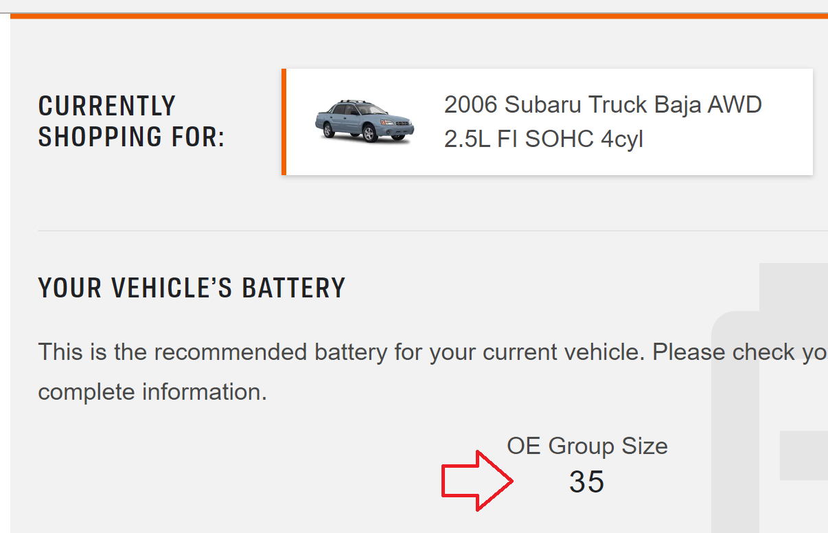

At least for mine, 2003 NA 5MT, it's a Group 35 battery. Autozone also says the 2006 is a Group 35. Probably best bet is, if you can, to just bring your old battery to a store and say, "I need a replacement for this." At least that way you can verify dimensions and terminals before purchasing.gremlinkurst wrote: Mon Apr 03, 2023 11:49 am I have a 2006 Subaru Baja Sport, and I need a new battery. There are a couple of problems with that: 1) All th battery says is Diehard Gold, and 2) the manual completely omits battery specifications. I have no earthly idea what I need to buy, if it's 35 group size, 26 group size, or what. I can't afford to buy the wrong battery.

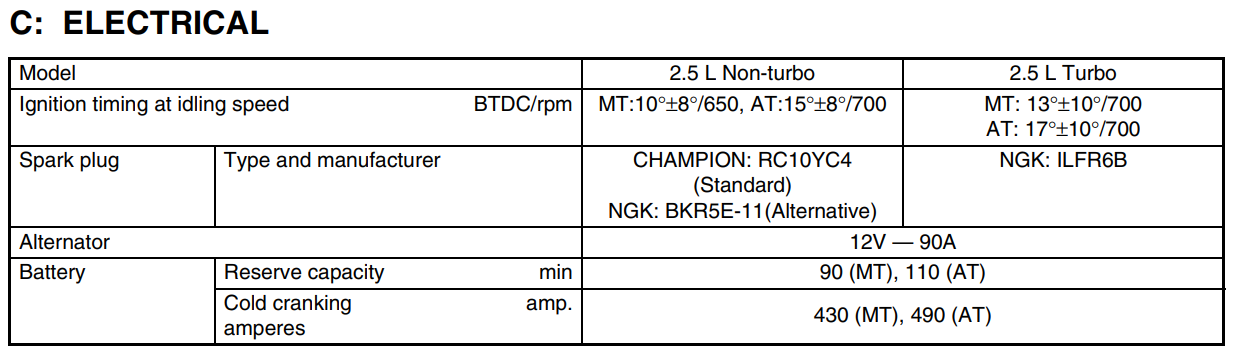

I couldn't find an official Subaru source that says specifically it's a Group 35, even in the factory service manual, which just lists its reserve capacity and CCA. Interestingly, it has different numbers for auto vs manual transmission, but AFAIK, both use Group 35 batteries.

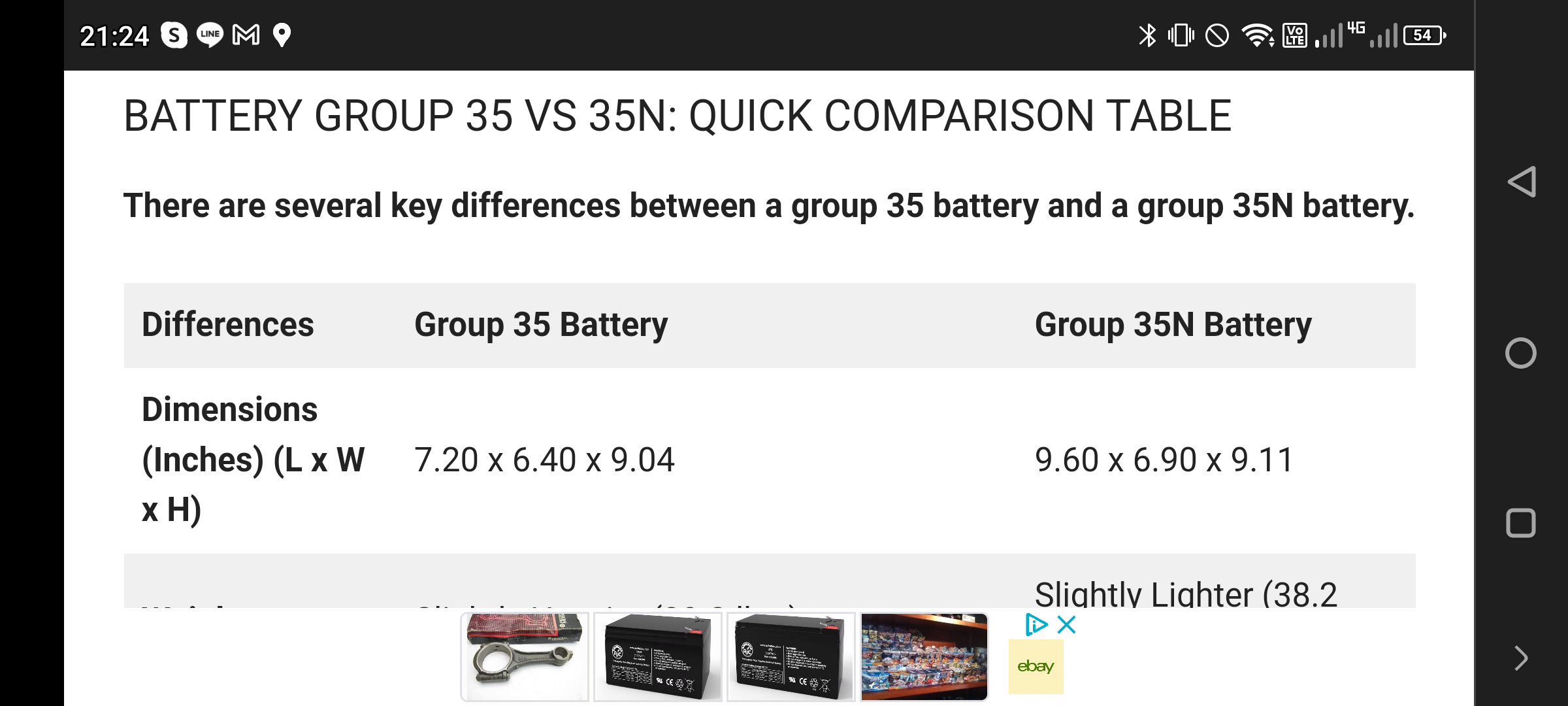

The link you posted is for a Group 35N battery, not Group 35, which appears to be a completely different size.
For other groups, there appears to be "N" and/or "S" variants for northern (colder) or southern (warmer) climates -- tradeoff between heat resistance vs cold performance. But with those other ones, the dimensions are the same; the differences are in plate thickness and/or acid concentration.
With 35 vs 35N, there appears to be a difference in physical dimensions.
- Screenshot_20230403-212457.png (308.99 KiB) Viewed 12655 times

You had the 35N in there, when you should have had the 35 (non-N), right? If so, good to know that the 35N does fit, even though it's not the officially-recommended size.
Yeah, the 35 should be smaller than the 35N, according to the screenshot in my last post, and the 35 is what should be recommended.
