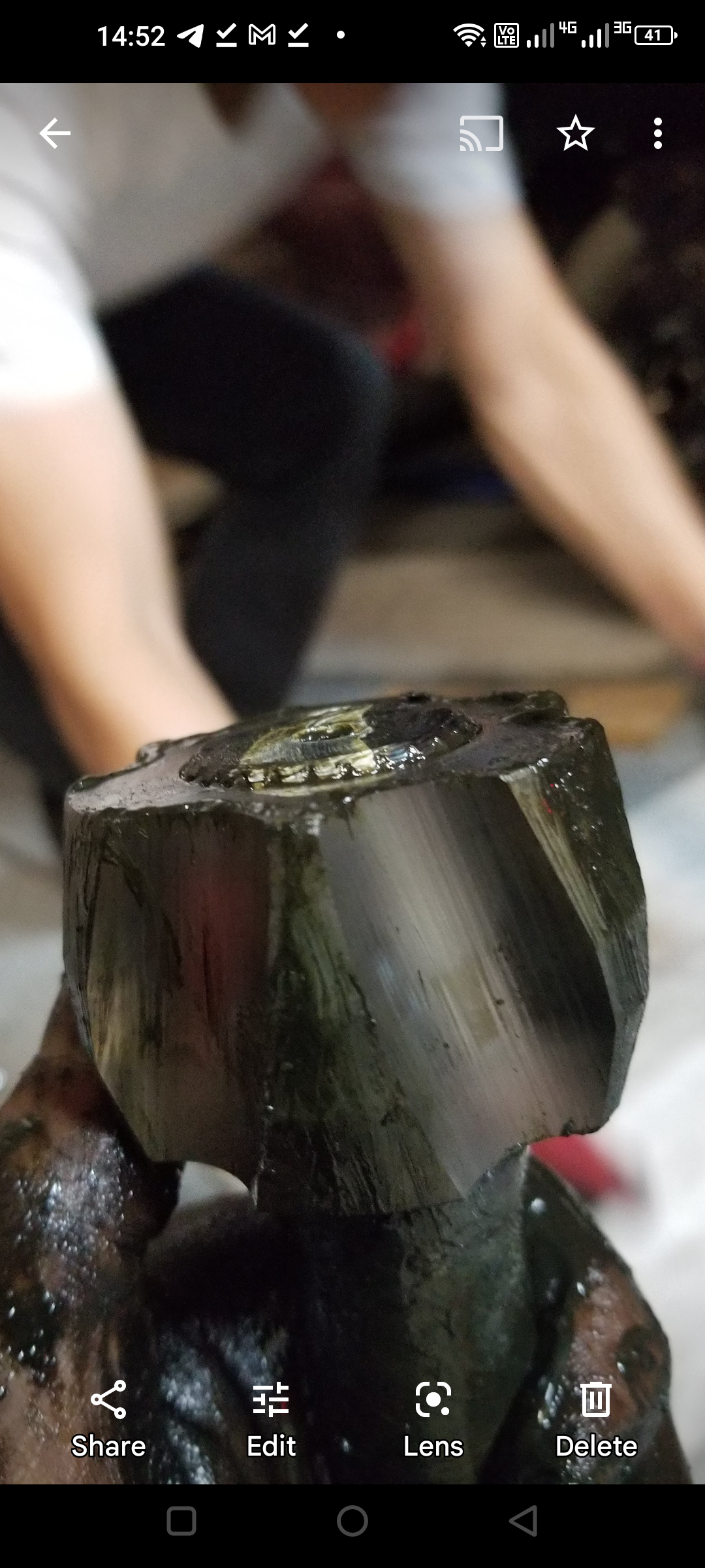

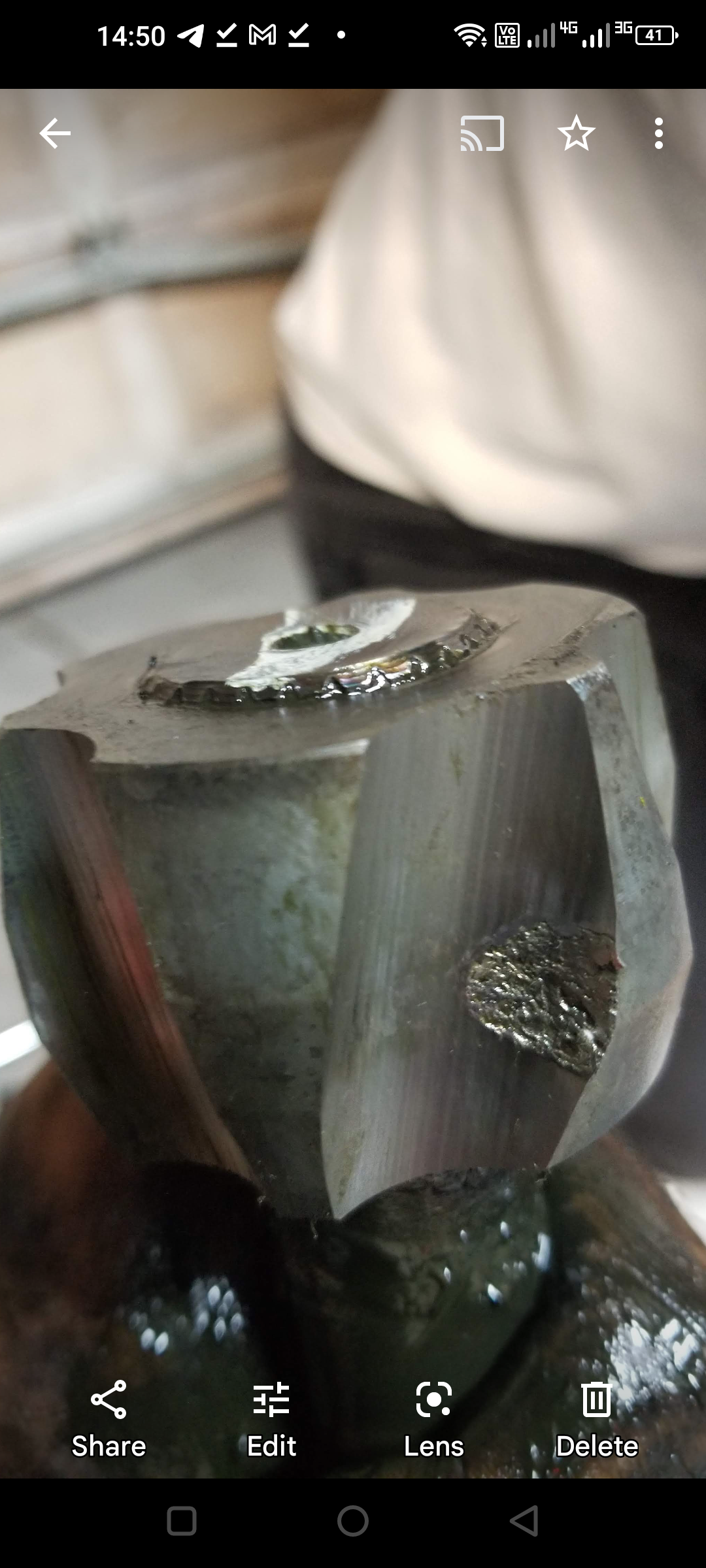

In my friend's case (MR2), there was a loud thunking/banging under acceleration, caused by a part that should be smooth....
...no longer being smooth.
