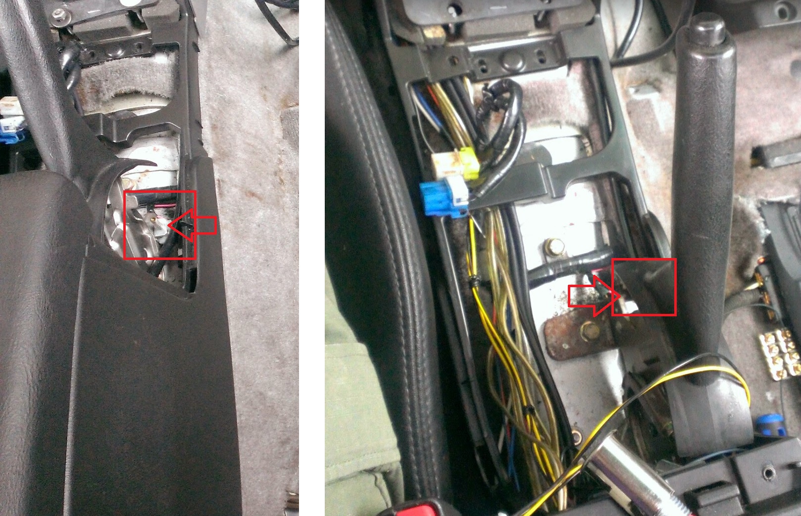

Immediate two things I think of are either the brake fluid is low, or the switch that detects if the parking brake is on is jammed/broken (assuming the parking brake isn't actually pulled up at all).

Booo.... Might also be worth checking the handbrake switch to make sure it's not stuck on. Continuity check on the switch when it's unplugged, and voltage check when the car's on. Same with the brake fluid level switch.
