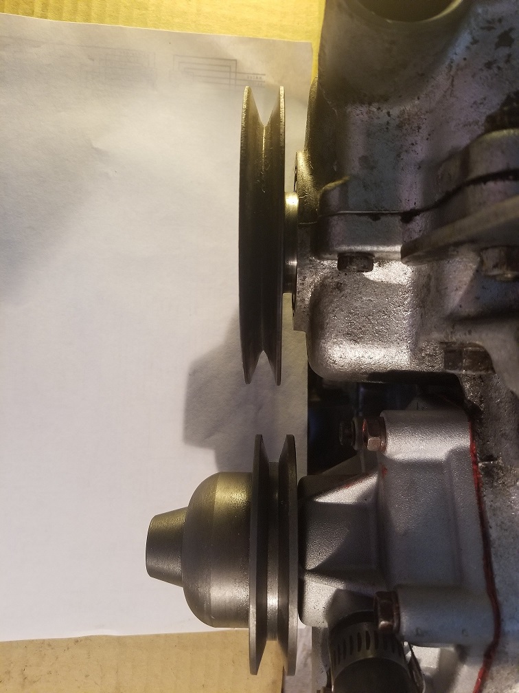

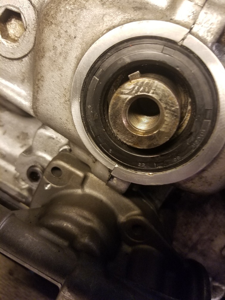

A little background. I bought a 79 Brat with an EA71 last year that had a bad piston. I pulled the motor and took it to a shop that specialized in Subaru engines which was recommended. They machined the heads and block and installed new pistons. I got the motor back from them and began the process of putting installing all of the accessories (new oil pump, water pump, clutch etc.). This is where I am running into my issue. When I brought the motor in the crank pulley was attached. When I brought the motor home they had removed it. Now the pulley does not seem to sit flush and does not align with the water pump pulley. I wish I would have taken more pictures of the motor before because I'm not really sure if it was like this before I took the motor in. The guy that did the work claims he doesn't know why it wouldn't line up and I could bring the motor back to him (it kind of a far drive) but I wanted to ask the community to see if it was something I could fix myself easy enough.
See attached pictures of misaligned crank pulley.
The picture of the pulley shows the original wear and another pic shows the shinny wear not seated.
