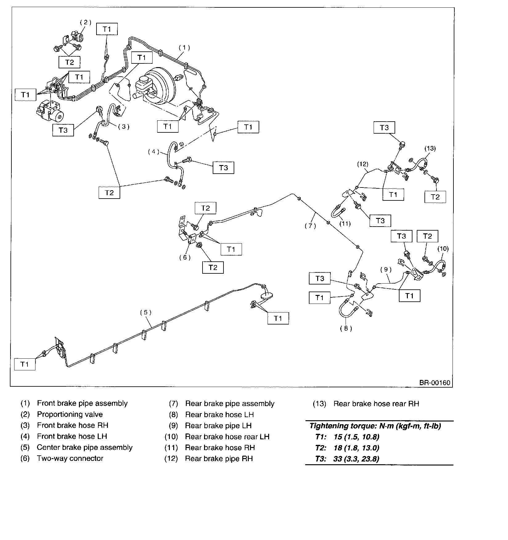

Hello,
As preventative maintenance I am replacing the rubber brake hoses on my ’03 Sport. With that, I went to the dealer to buy/order them and was informed that only one is available. I then searched a few online dealers and found the same thing. At the same time I have yet to confirm whether there are 4 or 5 hoses that make up the system so the picture gets muddier…
So, first off, how many hoses are there and secondly does anyone have any recommendations on manufacturer and/or vendor? I have found several manufactures and associated prices all over the spectrum which isn’t helping the cause much.
Any insight, clarification or advice would be greatly appreciated.
Thanks,
Morgan

The diagram actually shows (6) hoses. Specifically, #’s 3, 4, 8, 10, 11, and 13.
Appears that rear lower = rear outer in some descriptions, which may help tell some of the options apart. Inherently, this suggests that rear upper = rear inner. It also appears that these parts are not right- or left-hand specific like the front hoses are. So, (2x) rear lowers, (2x) rear uppers, and (1ea.) front right and front left for 6 total.
RockAuto currently shows options for all 6 as available, albeit from potentially varying manufacturers. Centric, Dorman, Dynamic Friction, Raybestos, or Sunsong all look like they could provide all hoses if you wanted to stick with a single manufacture.

I printed the diagram that 20Baja06 posted and passed it to my mechanic. Gave him the car last week and said, "do the voodoo that you do."
