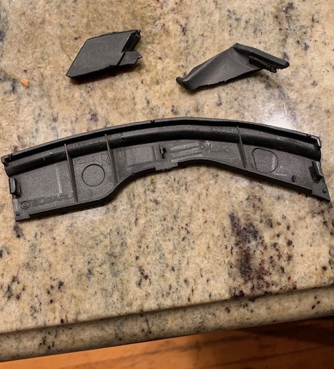

It was a dark and stormy night. I was backing up in an unlit area behind a gas station building and didn't see a large black flatbed tow truck that was parked there, so ended up hitting its black diamond plate bumper edge with the top right rear corner of my Baja at very low speed. Pictures attached, including some broken pieces I discovered the next day after the storm had passed. The largest of the broken bits has the number P2316 R, but when I do a search, I get hits for an ignition coil.
I have the complete shop manual set for 2003 Legacy/Outback, but can't find any references to the Baja body. Can anyone advise on what I need to be looking for, and instructions for making repairs?

Full baja parts diagram: https://www.scoobytruck.com/pdf/Baja_2003-2005.pdf
You'll have to pull parts from a scrapped car/ebay. No new body panels exist anymore.

Thanks for the link. I thought I had a Baja supplement with my shop manual set but it's nowhere to be found.
So it looks like I only need the two right rear tail lamp assemblies in silver, and if so, I may be getting off easy if I can find them in a yard or on line.

Thanks again for the link -- I talked to Eddie just now and snagged both assemblies! I gave him a nudge regarding mirror news and he thanked me for the reminder. Maybe you'll be hearing from him soon.
