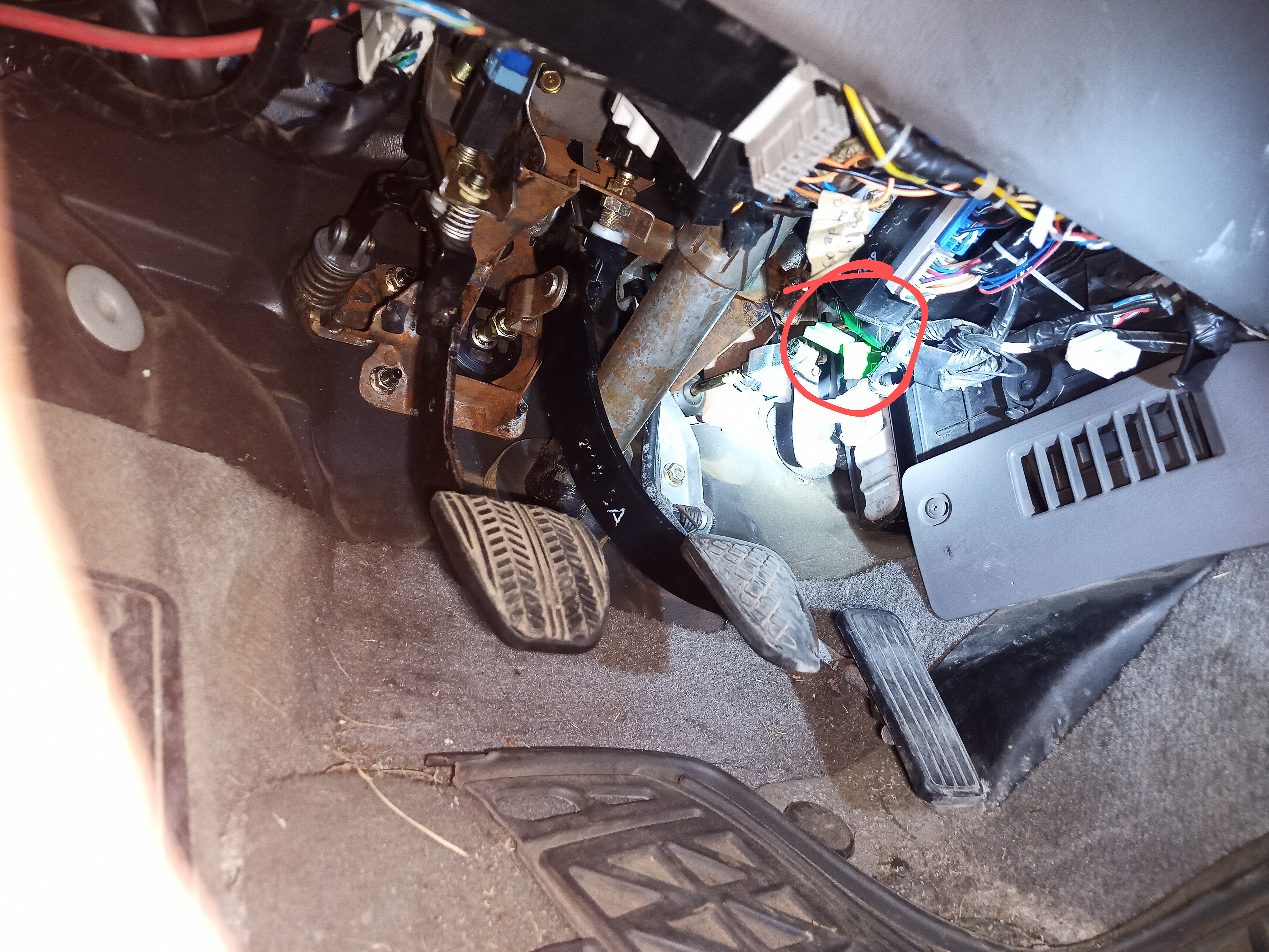

mine was right above your right knee. there will be one green and one white 2 pin plug. youll know it right as the radiator fan will come on when you turn the key on.
Re: Test plugs for tuning
Mine are right above the accelerator pedal. 2003 NA
