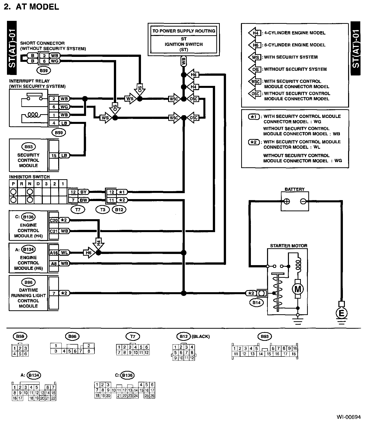

I installed the new starter and tried to start the car. Clickly click. Nothing. I then got out my multi-meter and started testing following the wiring diagram. Everything other than the ignition computer tested fine.
I have noted that the dash lights that should go out when the starter is engaged no longer go out. That had never happened before now. The starter motor of the new starter worked fine when tested, now it does not activate. Any ideas would be helpful.

Disconnect the connector to the spade terminal. With the car and ignition switch off, transmission in park or neutral, securely connect one end of a spare bit of wire to the spade terminal.
When ready, take the opposite side of the spare wire and contact the positive battery terminal. This will test the starter in the car. If it spins, you can start looking at the rest of the circuit. If not, double check your connections at the starter and your battery ground cables.

Everything tested out as working properly. I ended up taking it to a shop. They had it fixed in less than an hour. It turned out that the power cable from the positive battery terminal was too high in resistance. The positive batter terminal was cleaned, the cable was reattached and the car started just fine.
The cable conducted power just fine, but the resistance was high enough that not enough power was getting to the starter. A 200 dollar lesson.
