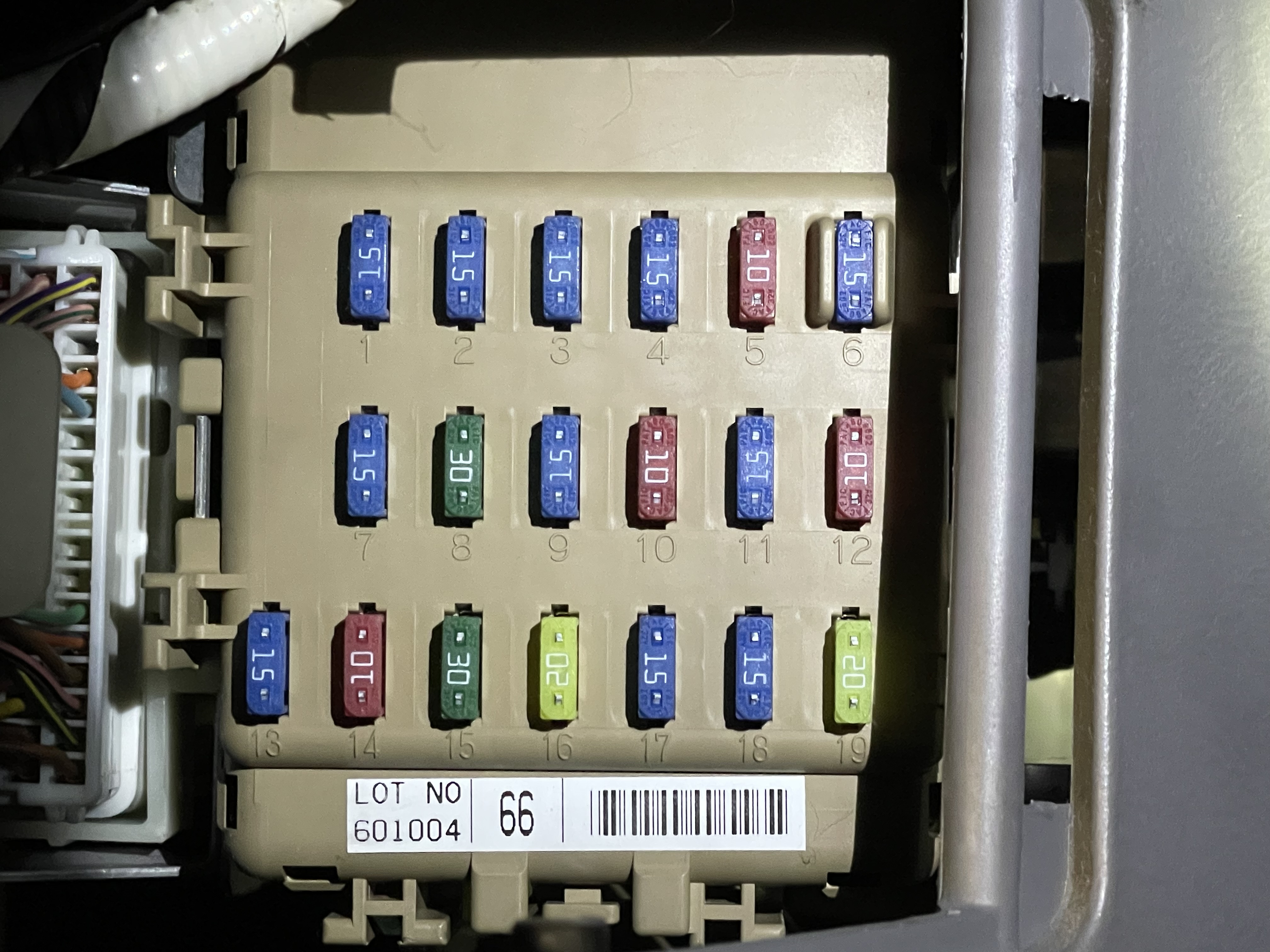

I have a 2006 Subaru Baja Sport pickup. My driver-side back, and both passenger-side windows have stopped working, and the passenger back window is stuck OPEN. I have it covered with a garbage bag secured with black Gorilla Tape. I've located two fuse panels, one in the engine compartment on the driver side, and the other under and to the left of the steering wheel. Both panel covers have ostensibly helpful labels, but I can find nothing about the damned windows.

The "above suggestion" doesn't apply, as my truck hasn't any window lock button. Weird that the driver's window still works while the others don't...and I still don't know where the power windows fuse is, anyway; none of the "informative" panel covers detail such a fuse.

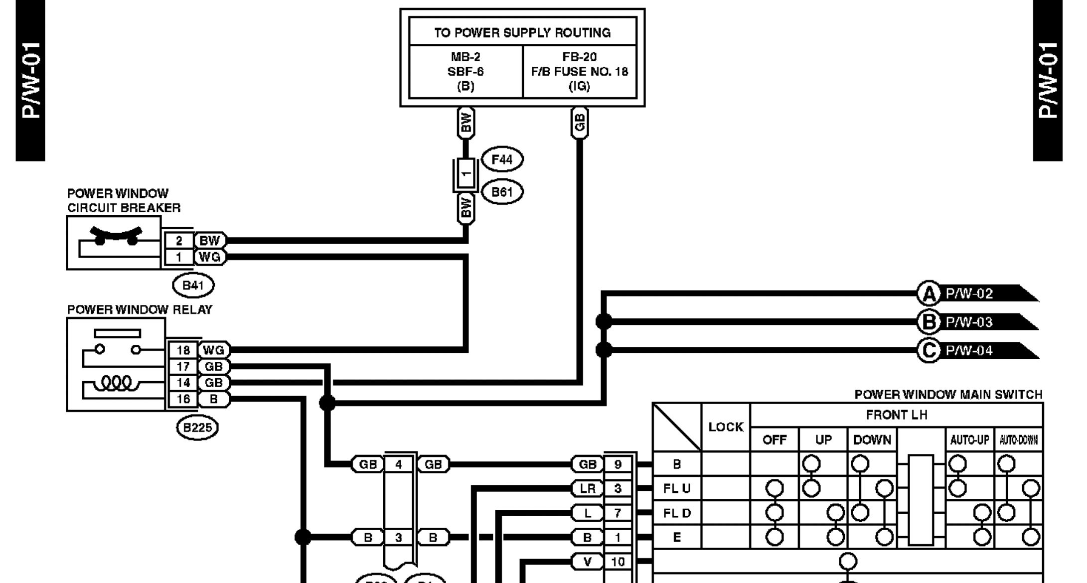

20Baja06
Posts: 95
Re: Help! Where are the fuses for my power windows?
Post by 20Baja06 »
The diagrams show it is fuse no. 18.
