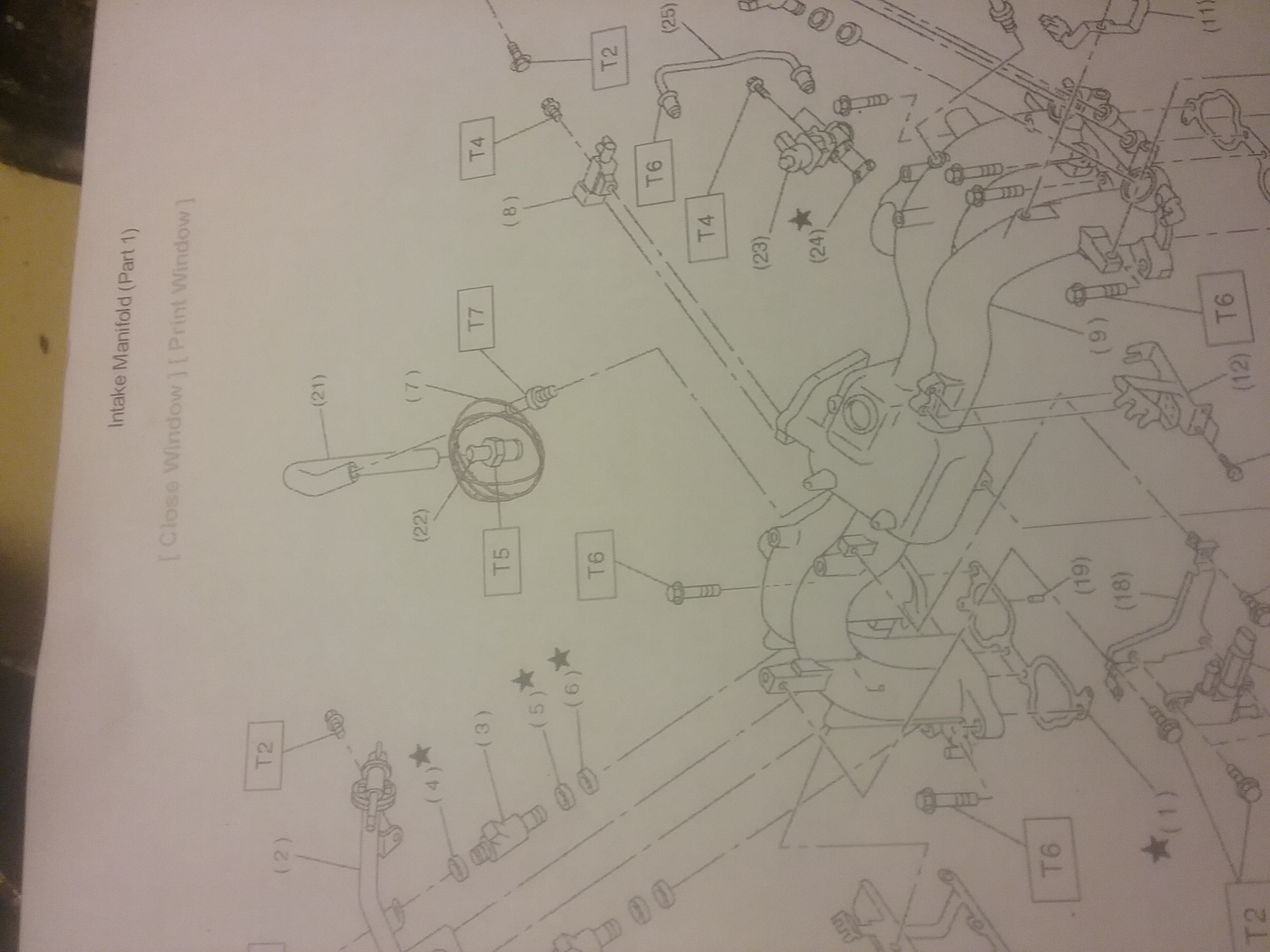

I cant seem to find the the PCV location. Can anyone post a picture of the location even just a pic of the engine with an arrow to the general area would be super cool.

PCV valve is located at the top of the block, passenger side, in front of flywheel/torque converter access panel. Hose should lead to air intake just past throttle body, passenger side

Here's a diagram. To trace from the intake manifold

Ya, that is where I thought it was. Turned out there is a pressed fitting for the pcv and the pcv was so stuck I was spinning the fitting and never making headway. I stuck a wrench on the fitting but still counld not get the pcv free and was afraid of snapping it in half. I am going to see how much the local mechanic will charge me to do it.
