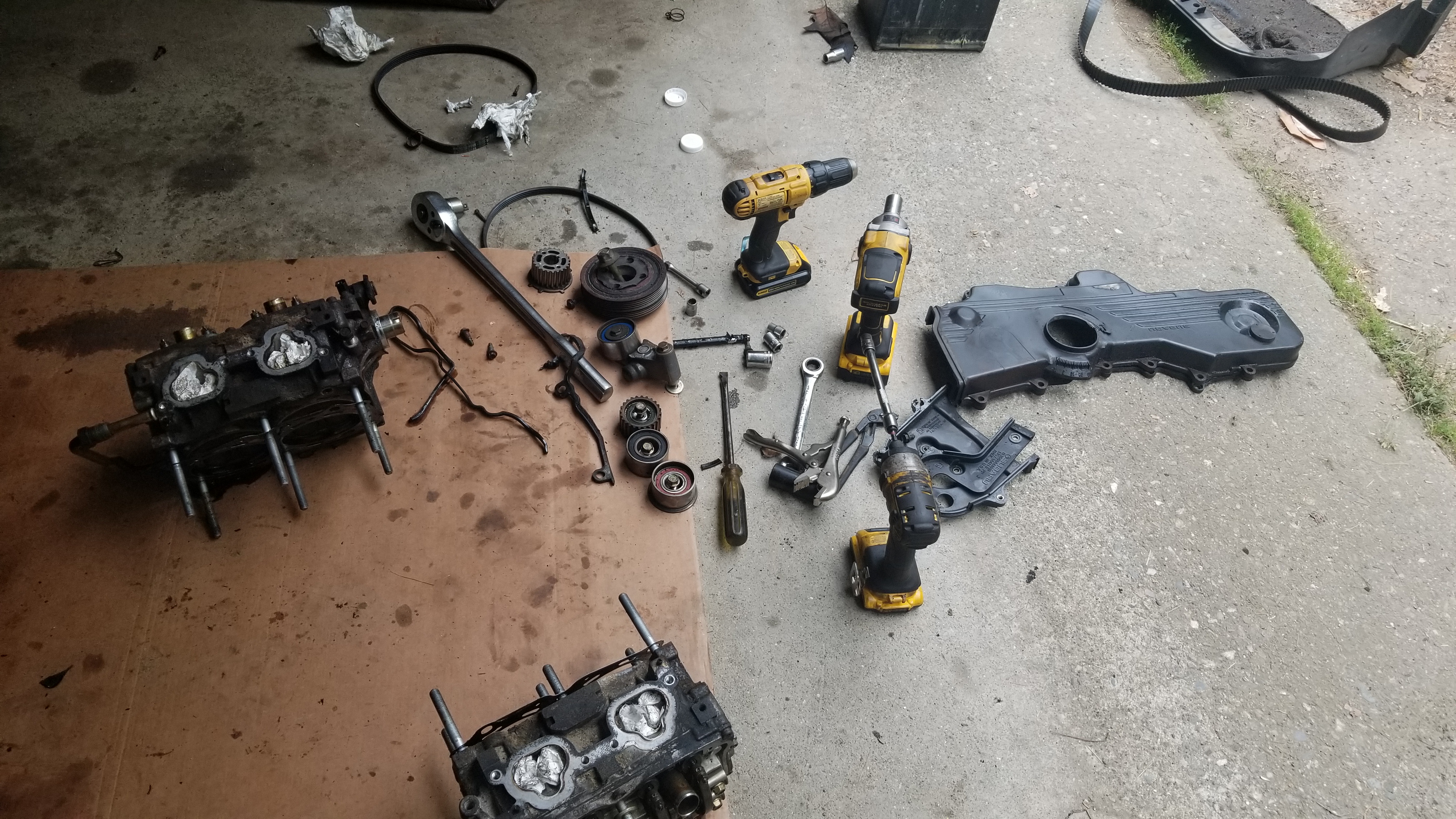

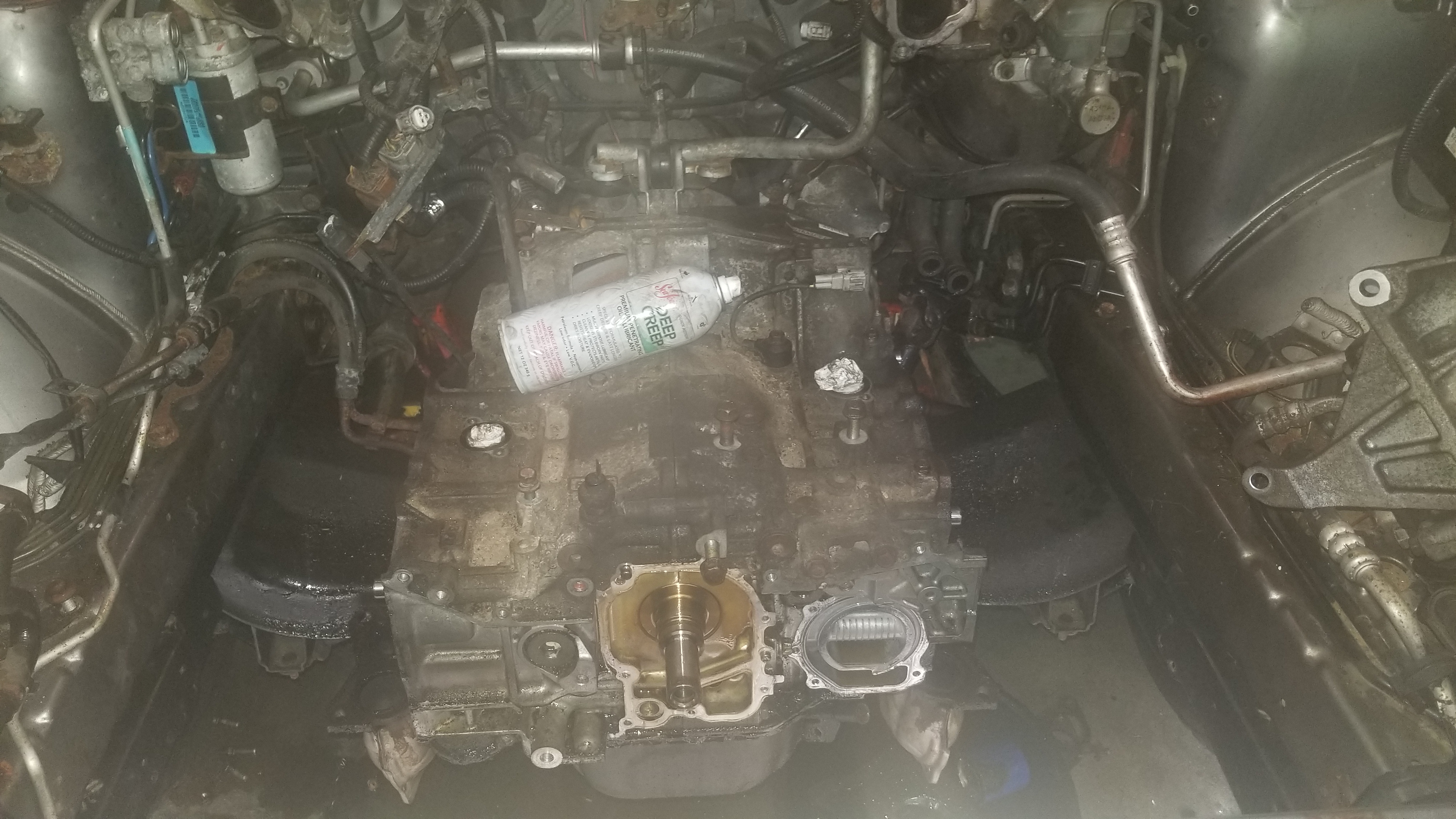

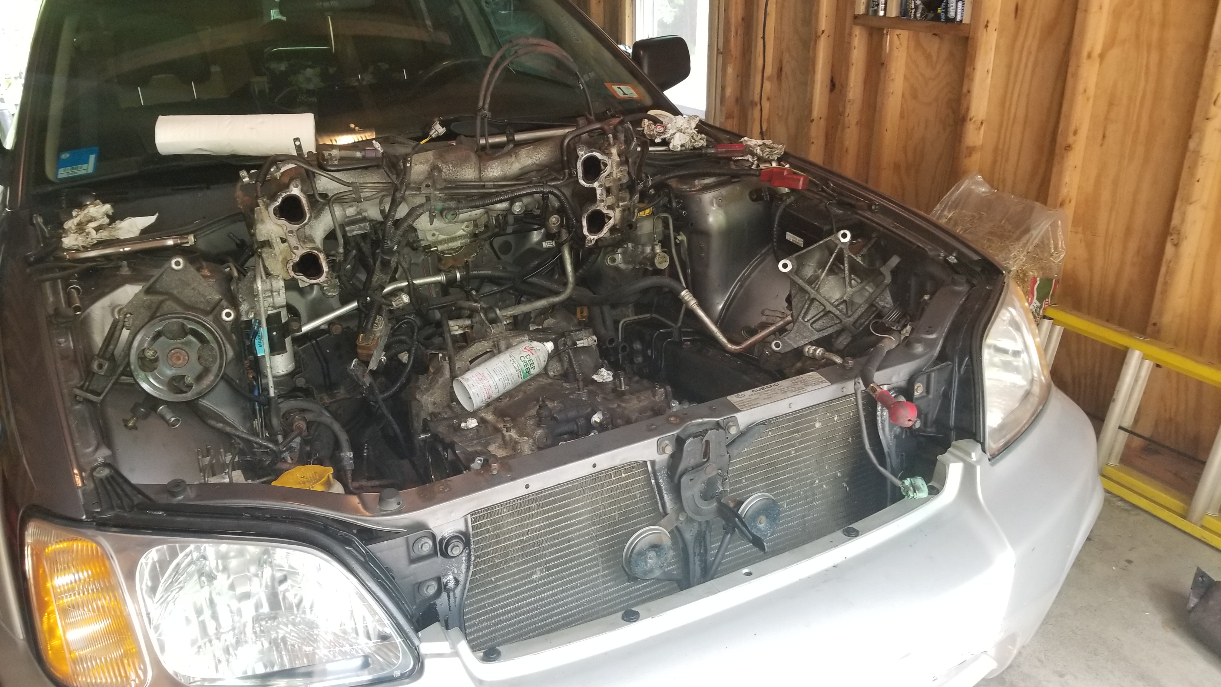

Well. Not MY Baja and it was last weekend. Another timing belt and head gasket job. Ive never seen a belt so cracked or gaskets so worn out. The coolant was blacker than the oil. It ran beautiful though. Waiting for him to buy the crossover pipe and a few other things before i start putting it back together next weekend.

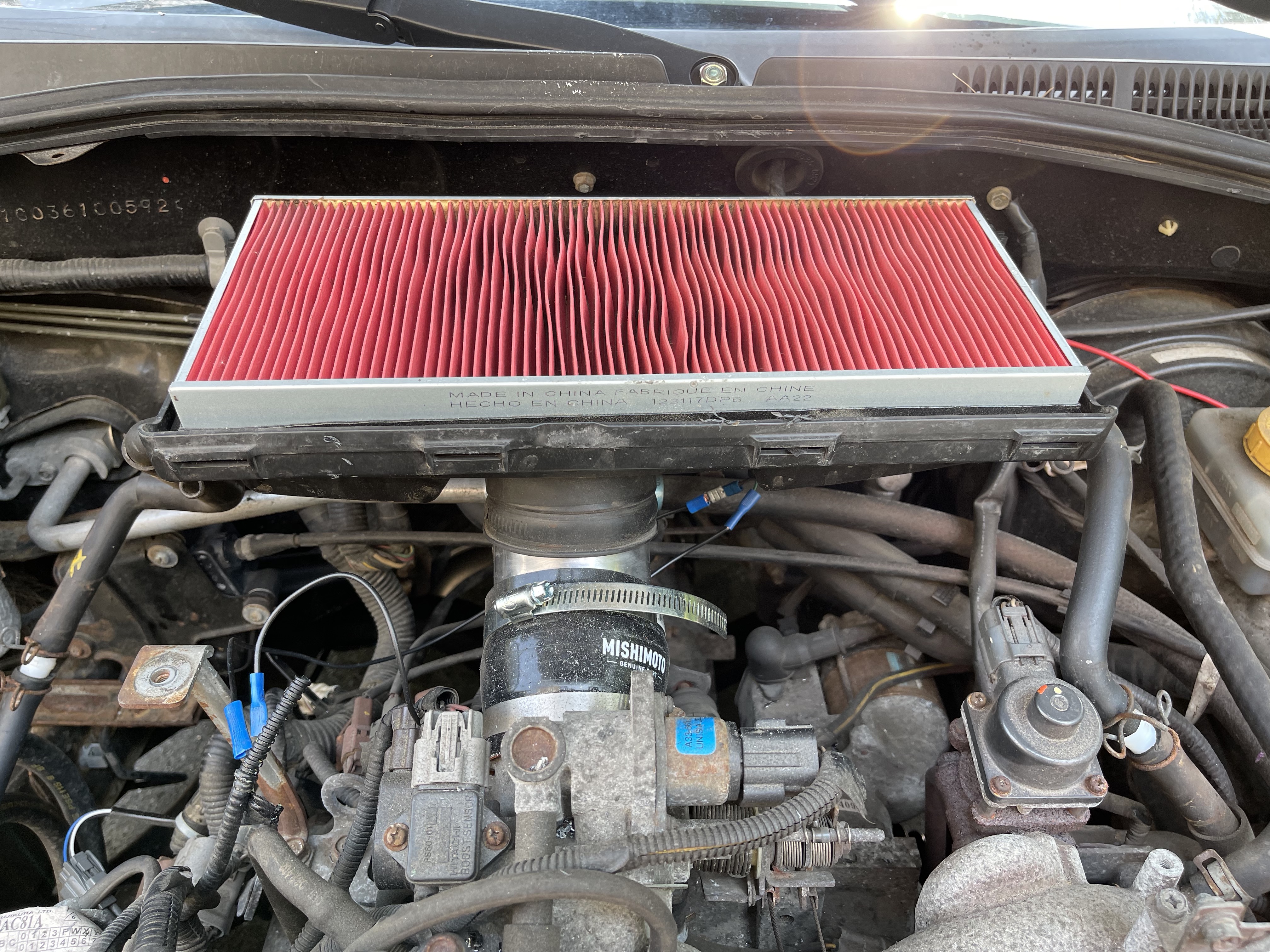

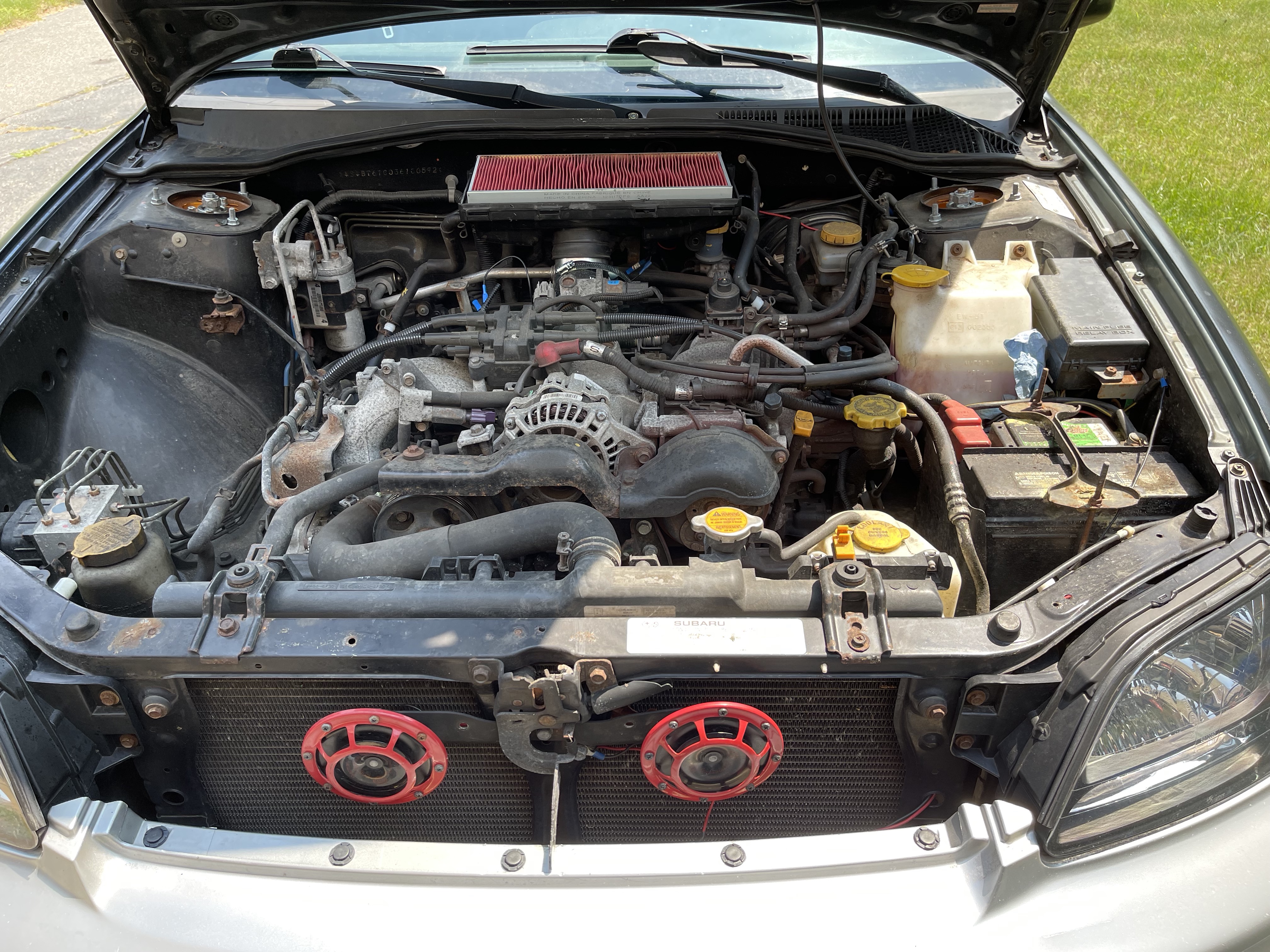

Saw an article about top mount intakes and decided to give it a try. I have better throttle response but no other performance gains, not that I was expecting any. the sound is deep and loud.
I drove it through a downpour and no water got near the filter through the hood scoop. Very minimal water got into the hood scoop at all it seems.

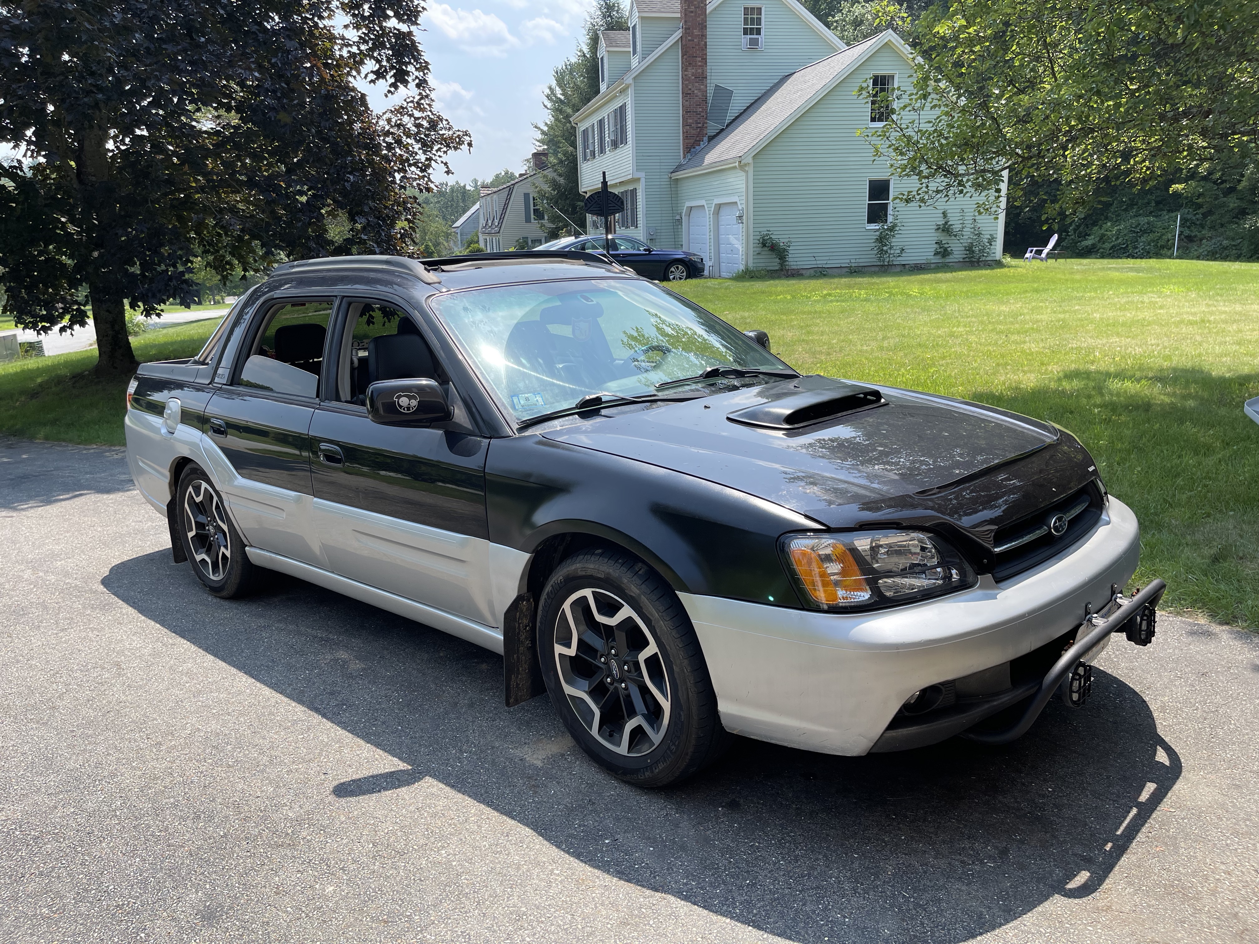

Well i did it again. Just bought my second Baja. My buddy bought it a couple months ago and couldnt swing the cost of fixing it. Now i have an 06 and an 05. Just need an 03 and 04 now.

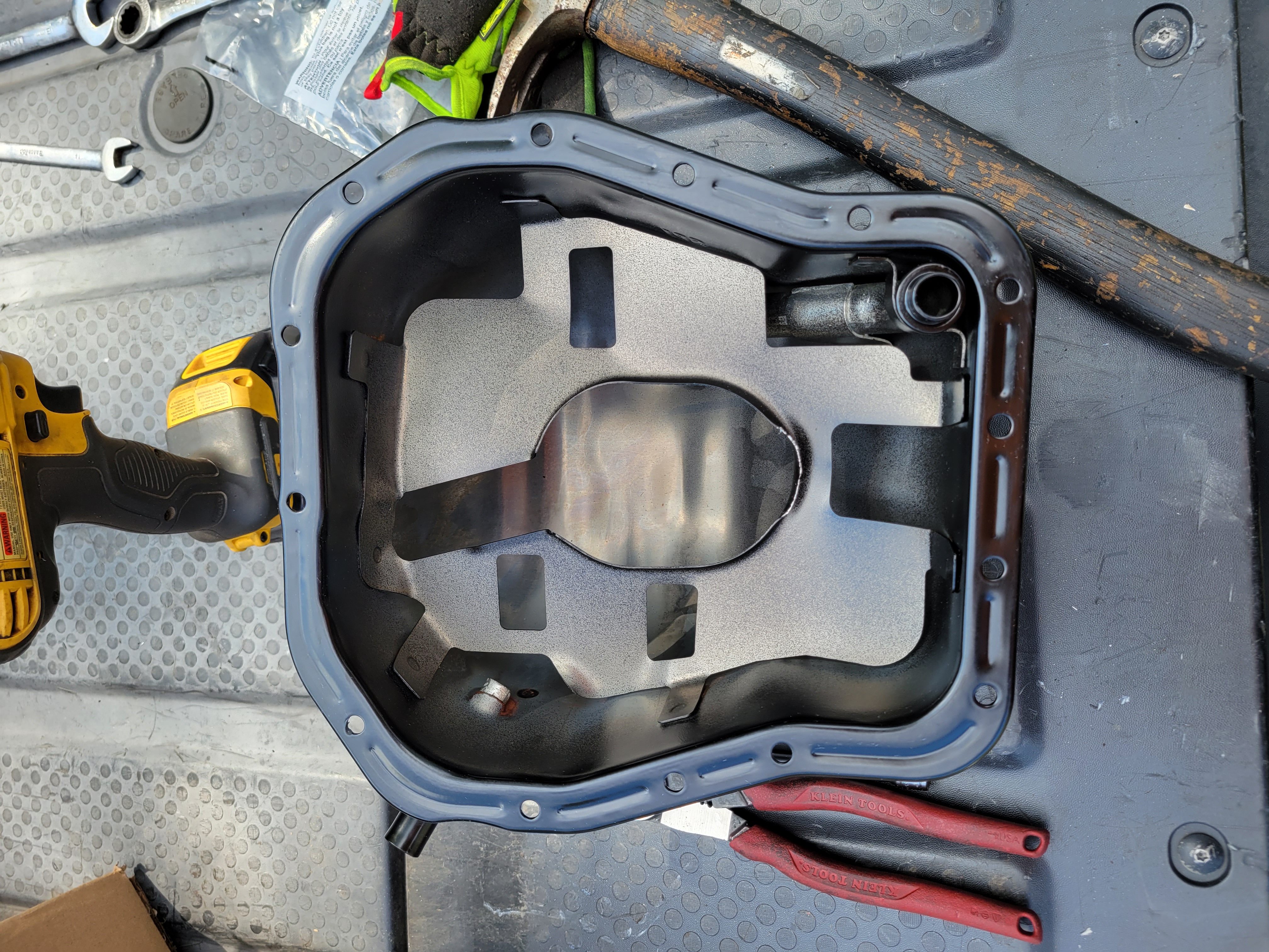

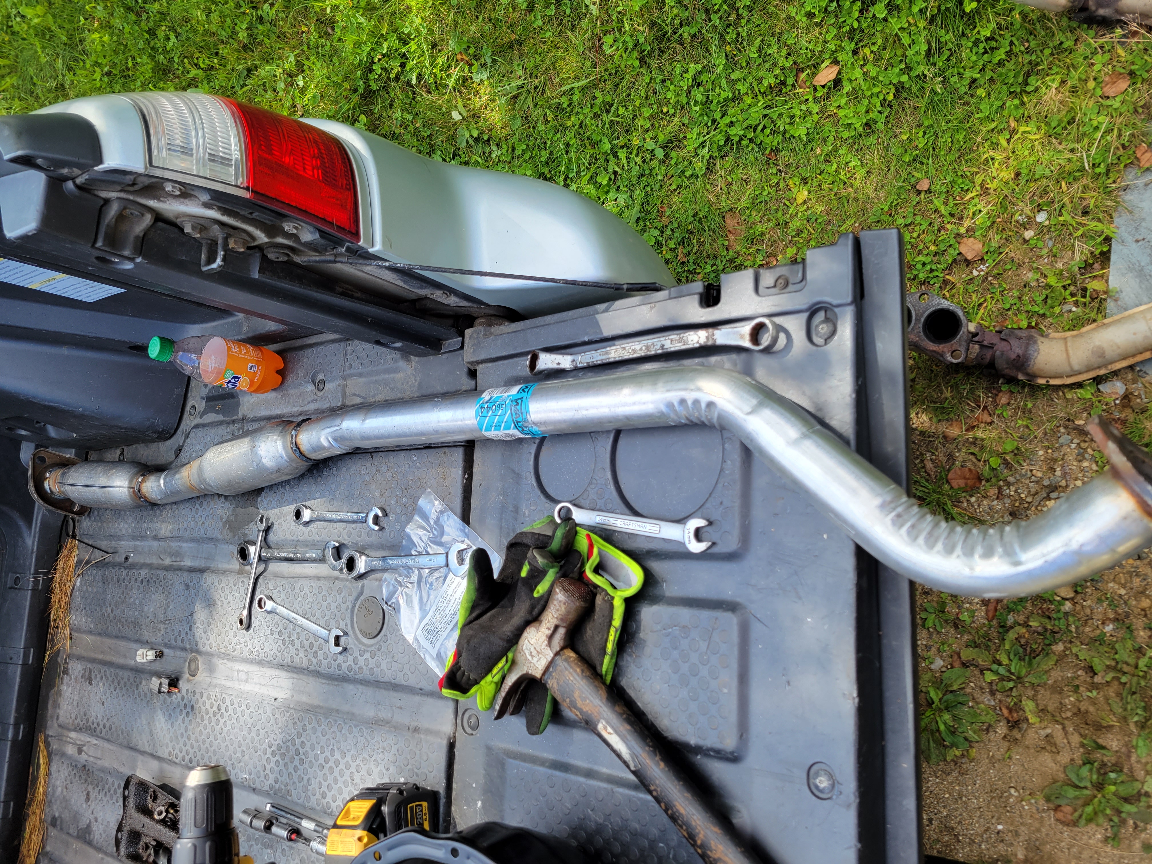

Just replaced the oil pan, and complete exhaust in the 05 Baja i just bought. Had a y-pipe and cats i saved from a donor car thankfully. I used a 2002 Outback midpipe. It fits perfect and is $60 cheaper than what the same place wanted for the Baja midpipe. Replaced the alternator. Charged the AC. Not bad for 5 hours work.

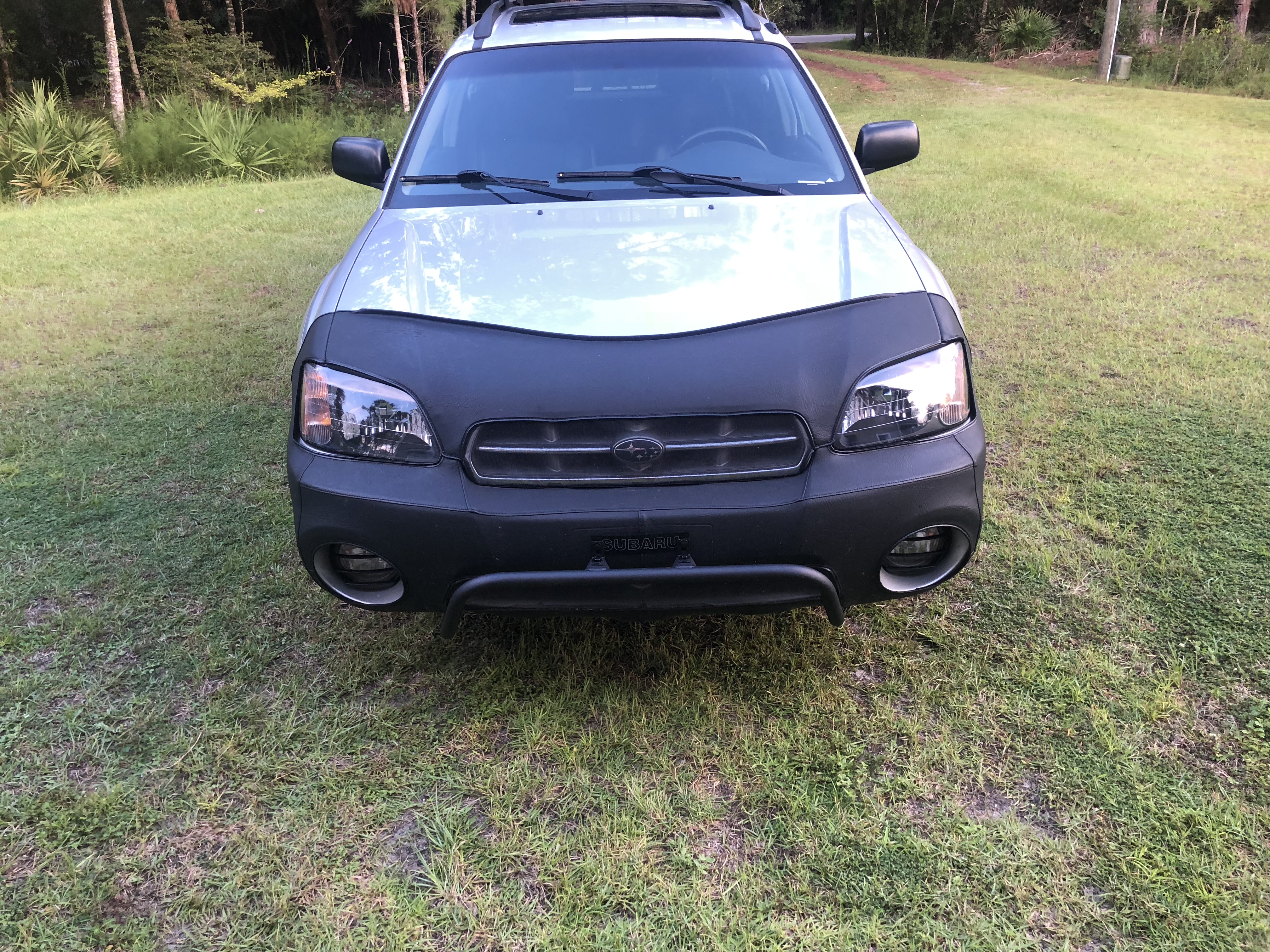

I installed some new headlights. The old ones were pretty cloudy. New ones have Some black accents. Not sure how it would look without the vinyl front end guard, but I like it like this
The head on photo is the after shot. The other is from a few months back.

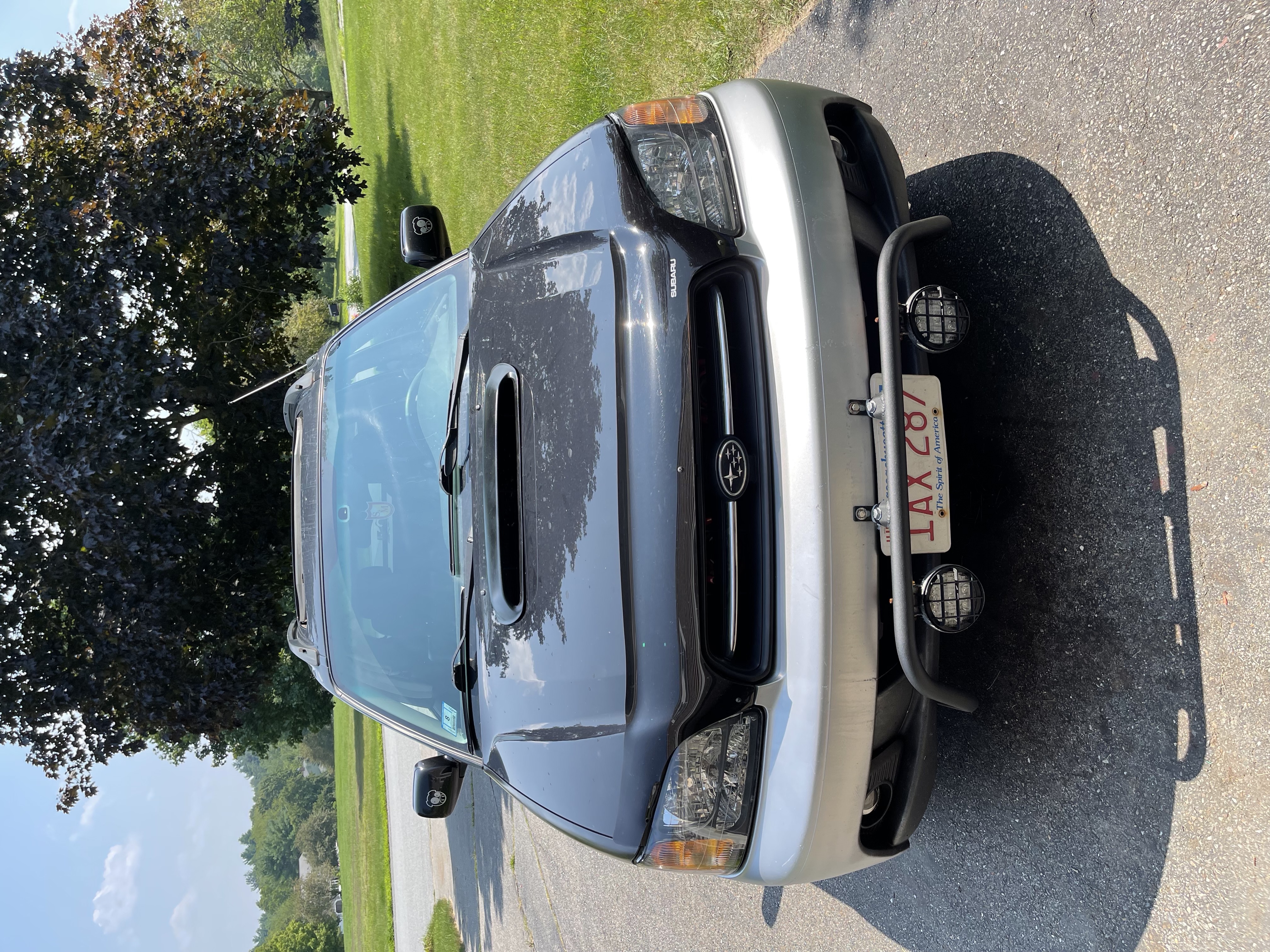

Installed a lightbar using some repop sport light brackets a guy is selling on facebook!
