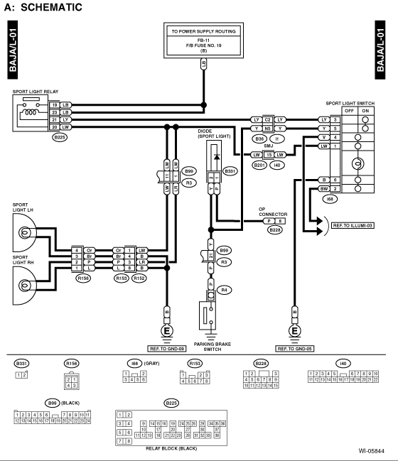

Re: Activity/sport light switch
Found this on All Data , Don't know if it will help anyone but figured it might....
Baja Sport Lighting.gif (24.59 KiB) Viewed 15954 times

That's awesome!
What year was that for ?

Can you find out more about the Parking Brake switch connection?
I'd like to find out what to tie together so they work without the "One Click Cheat".
05 turbo but looked the same for all years
Can't find anything on All Data about that switch.....I've never taken mine out, do you know how many wires are going to it?
