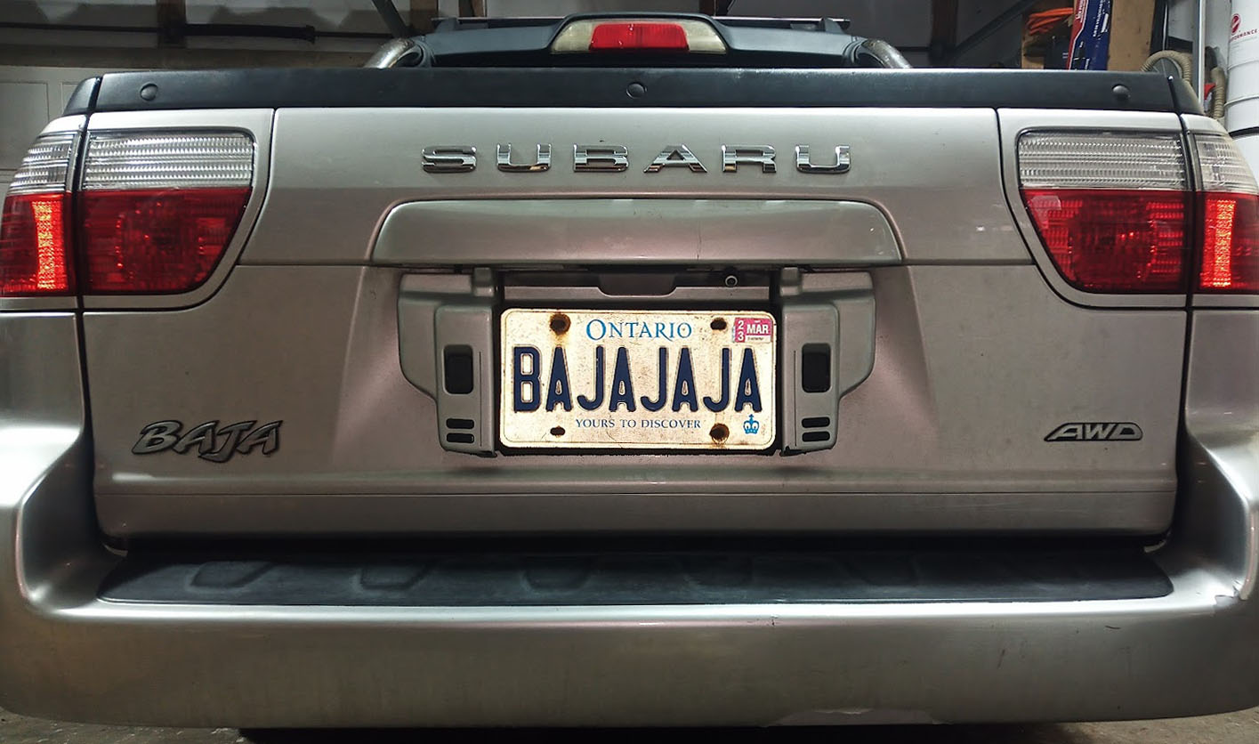

Had the Baja repainted and as part of that the BAJA, SUBARU, and AWD nameplates got ripped off. Could I trouble one of you to take measurements of your tailgate so I can put them back on in the same spot?

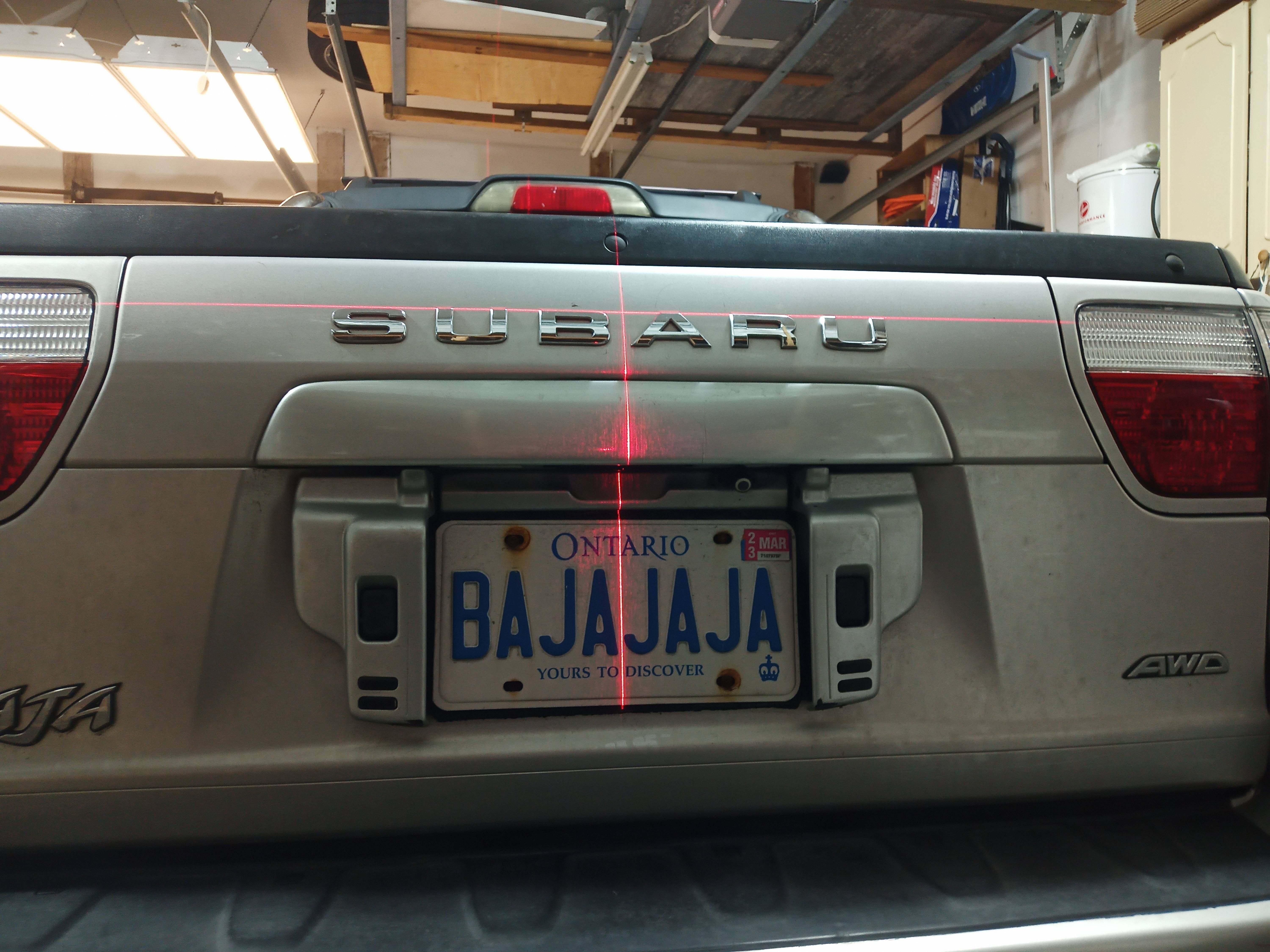

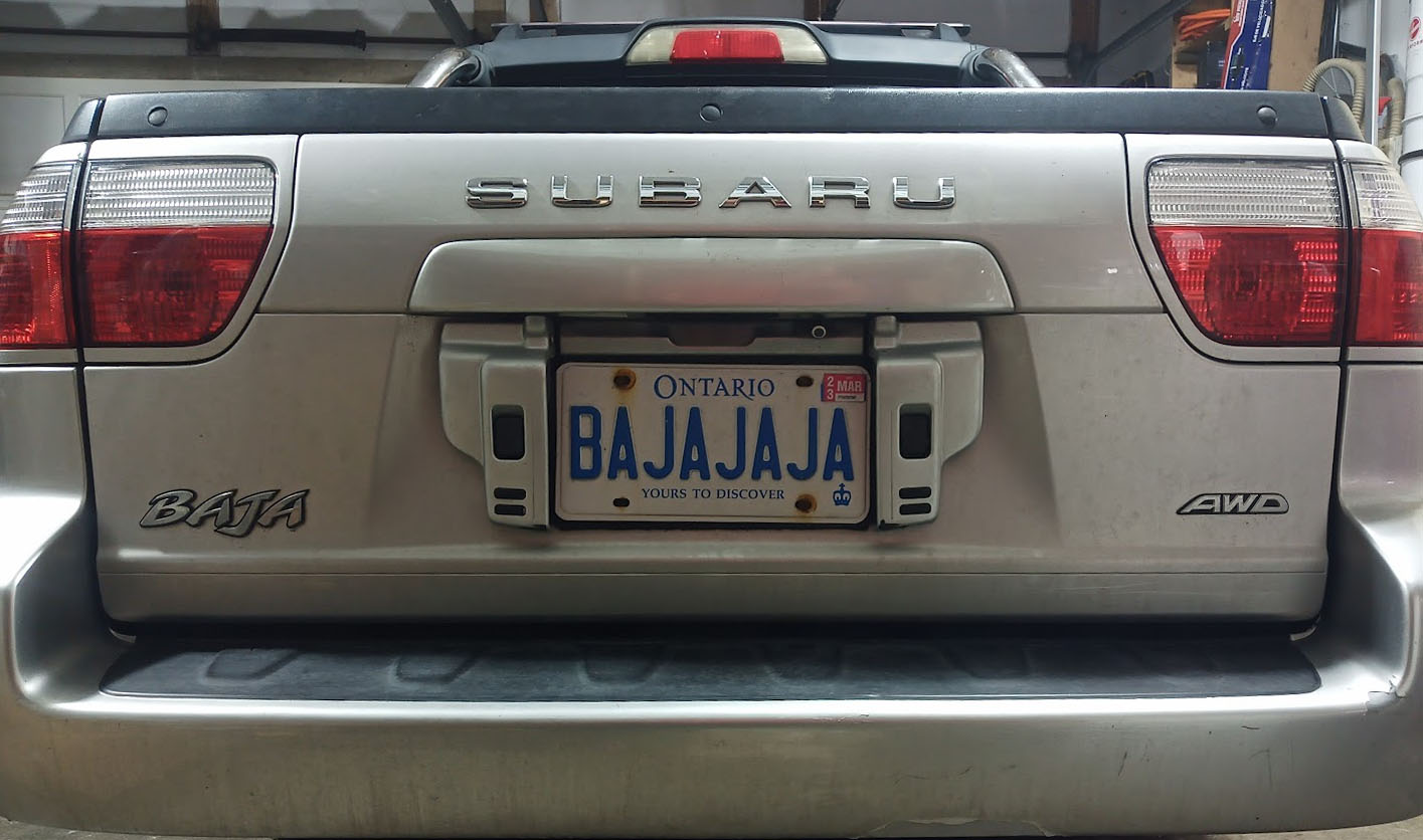

I can take some measurements likely today or tomorrow, unless someone gets to it first, but for now here's a couple of photos of the tailgate.

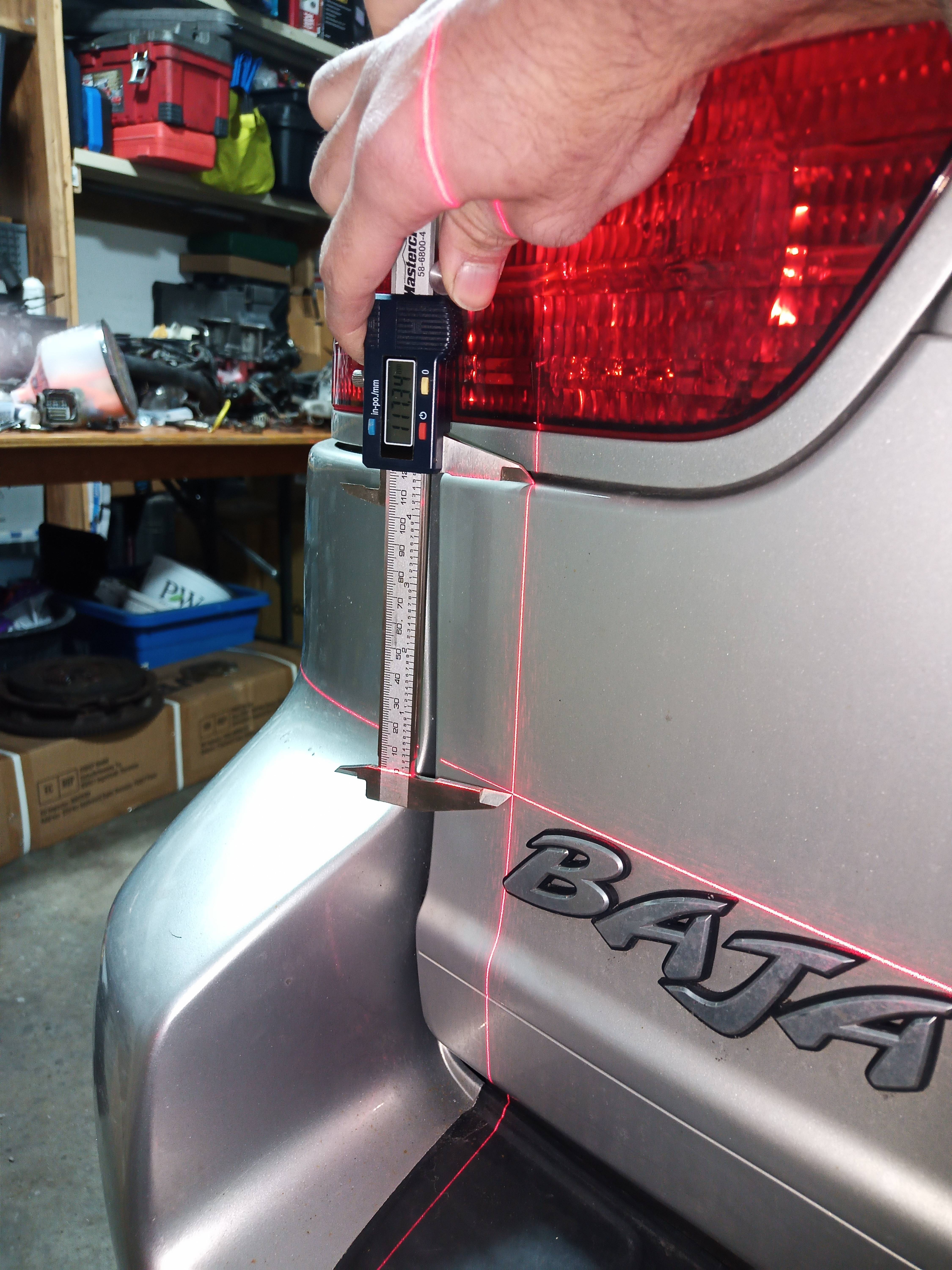

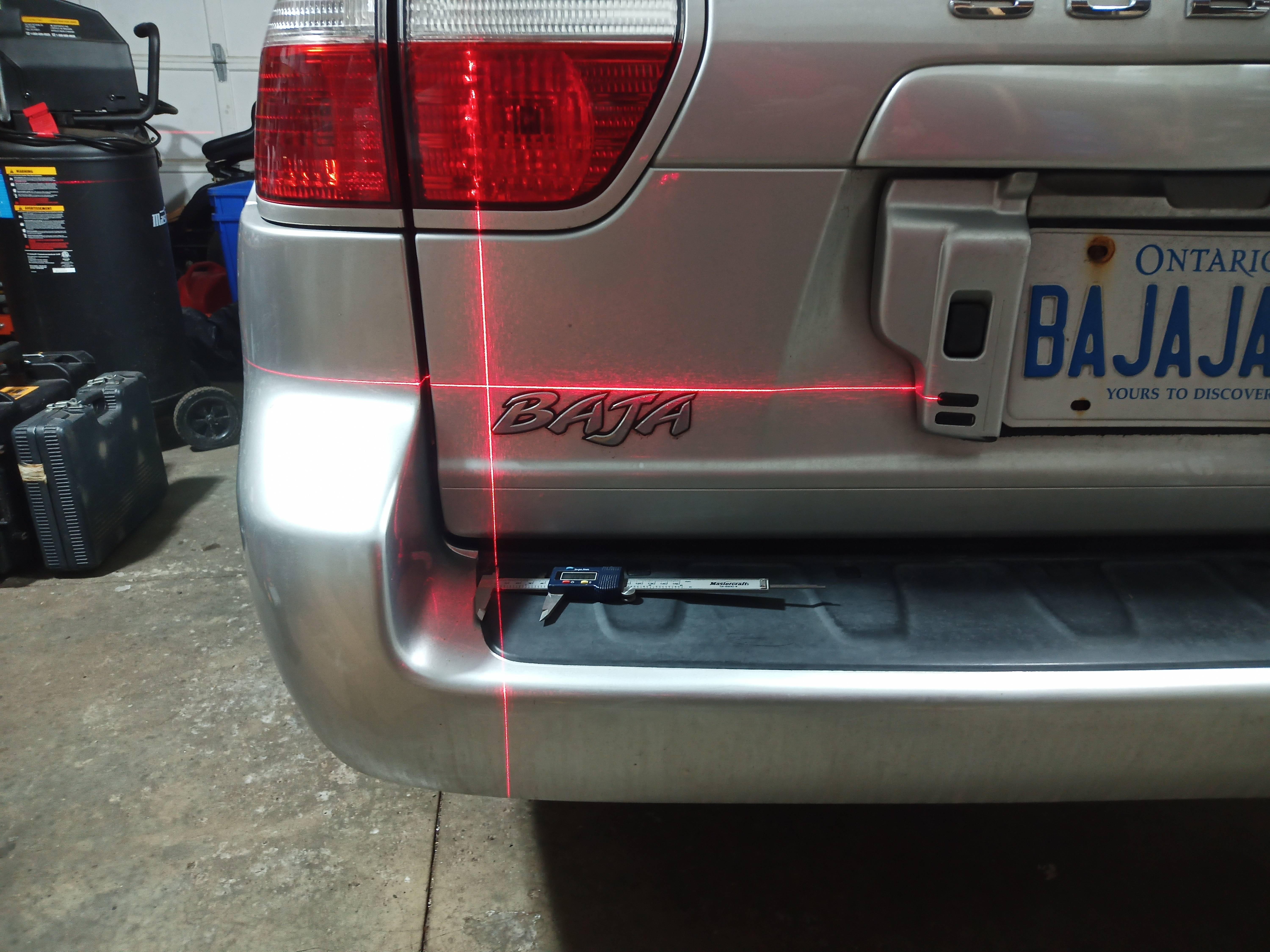

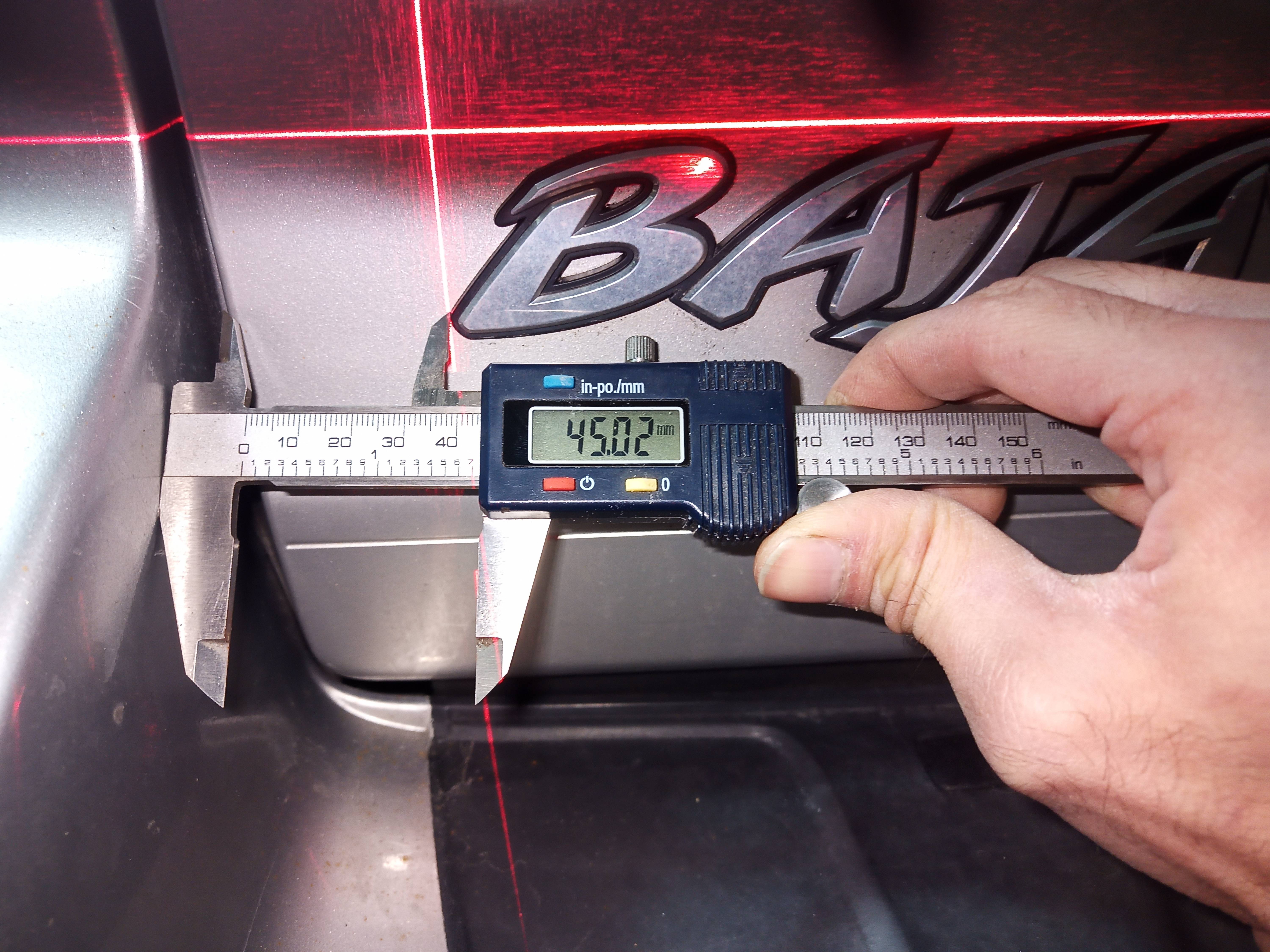

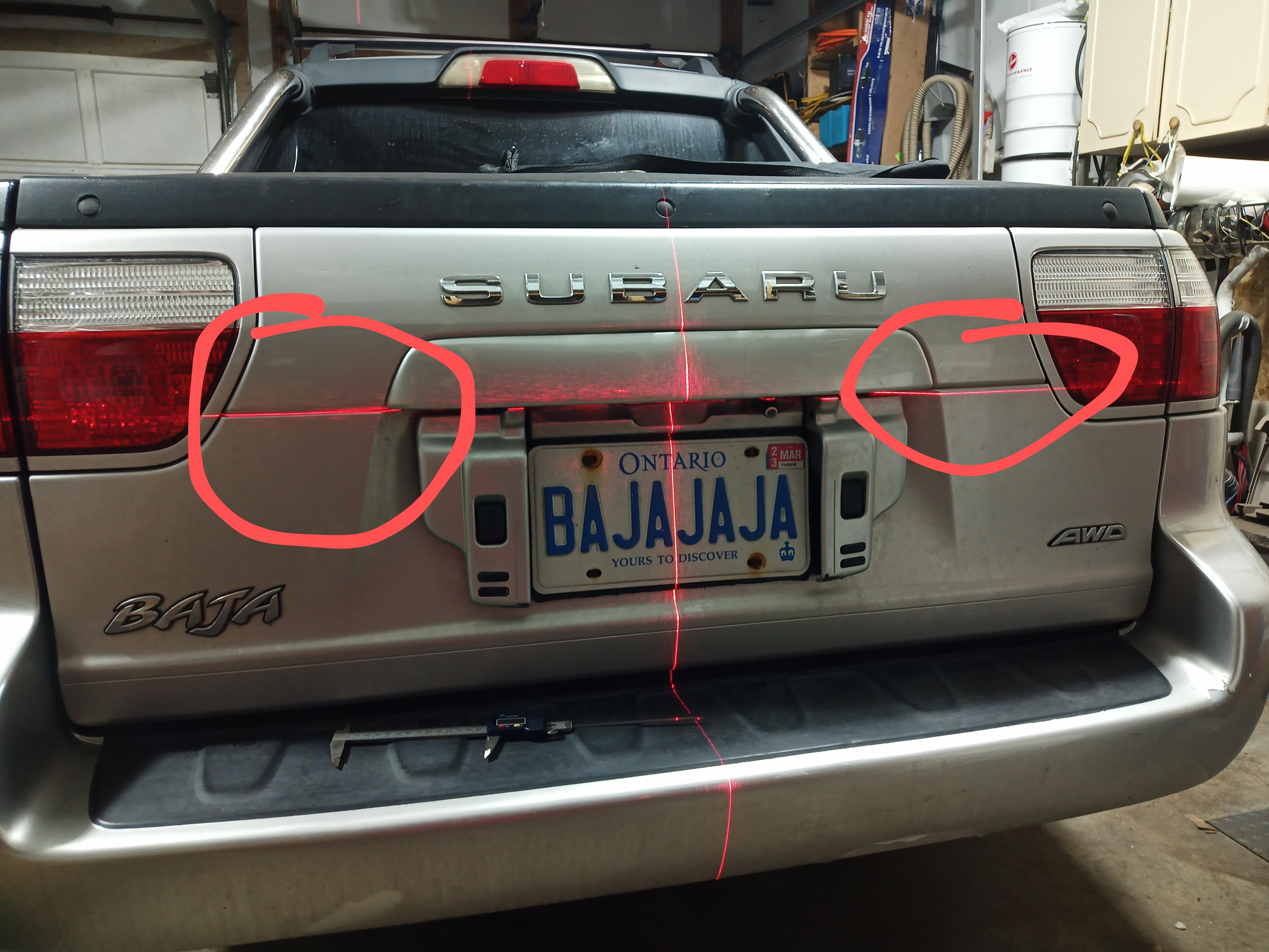

"BAJA" Badge:
45mm from left tip of "B" to left edge of tailgate
117mm from top-left corner of badge to bottom of tail light recess
Lines were drawn with a laser level, and looks like the highest points of each letter are all horizontal/parallel to the ground
(See photos)

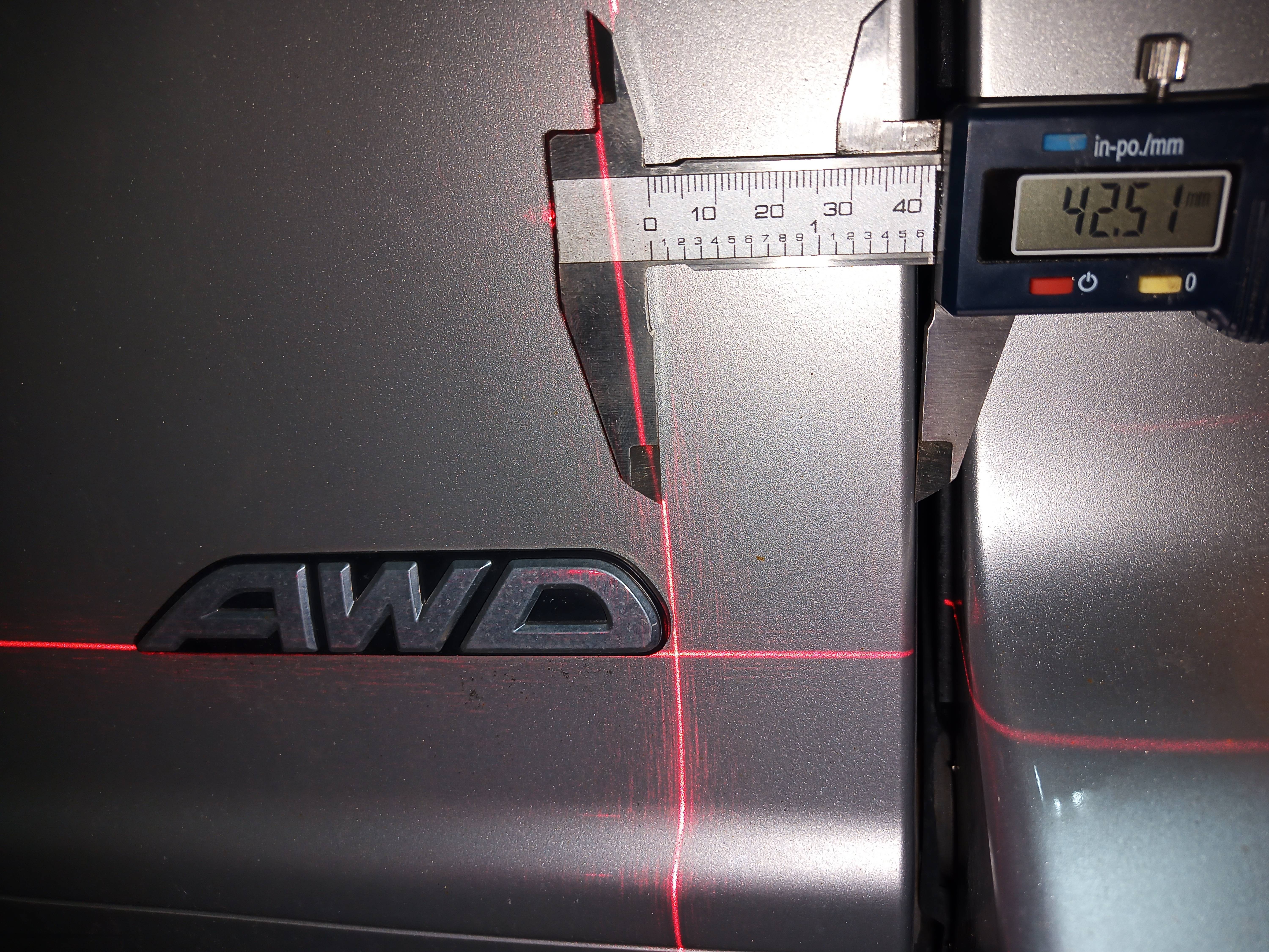

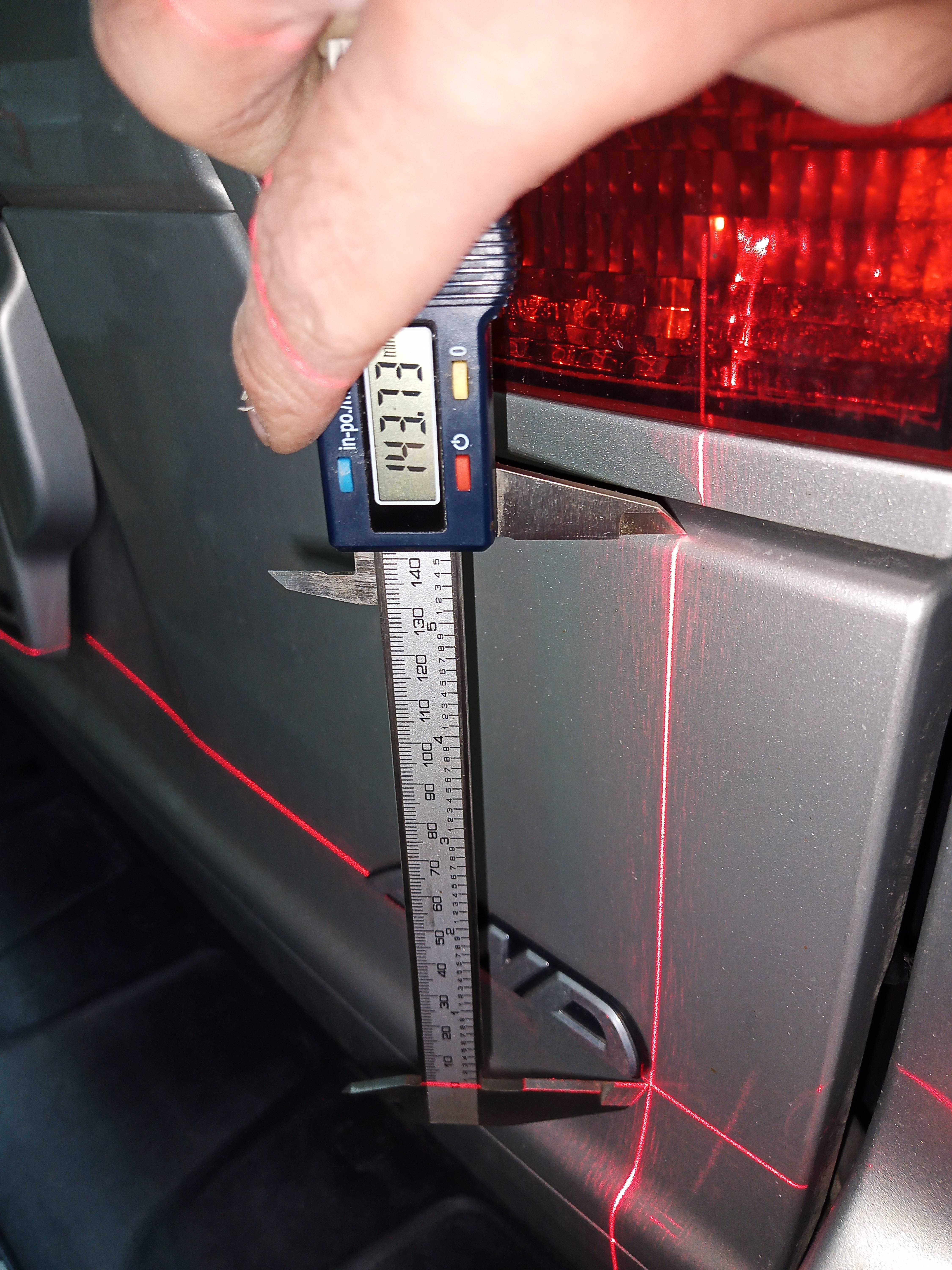

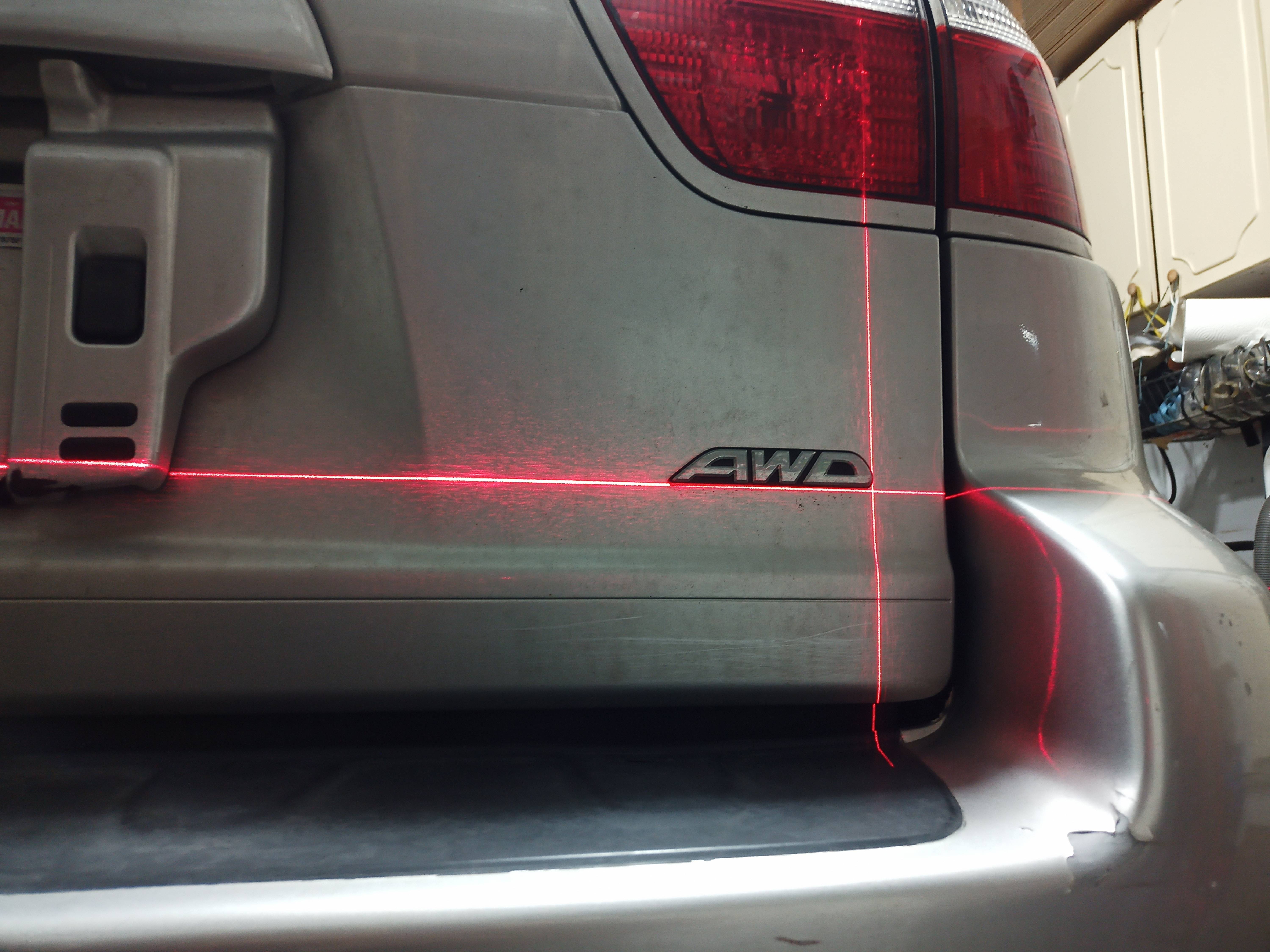

"AWD" Badge:
42.5mm from right edge of badge to right edge of tailgate
143.7mm from bottom-right corner of badge to bottom of tail light recess
Lines were drawn with a laser level, and looks like the AWD badge is perfectly horizontal

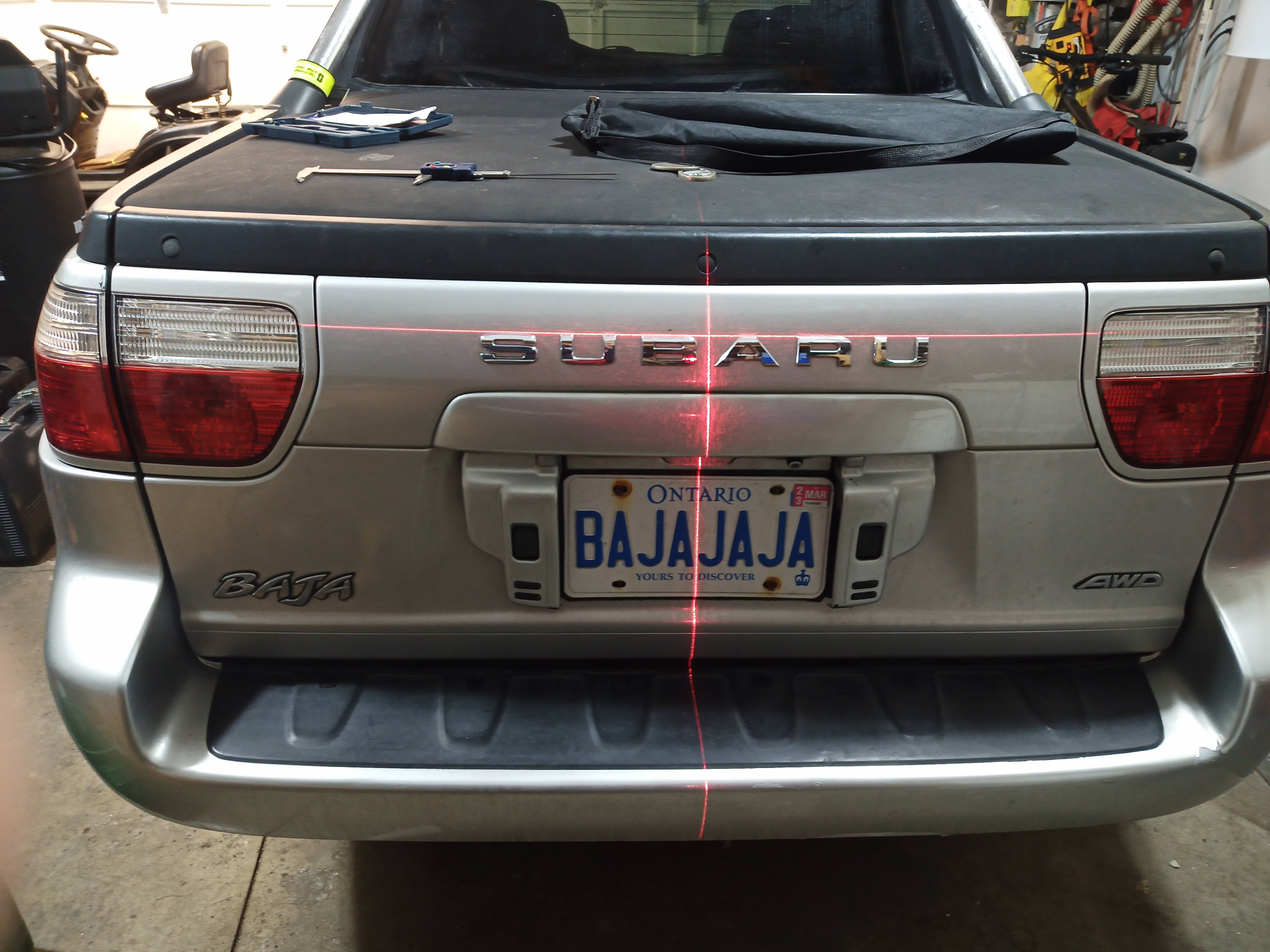

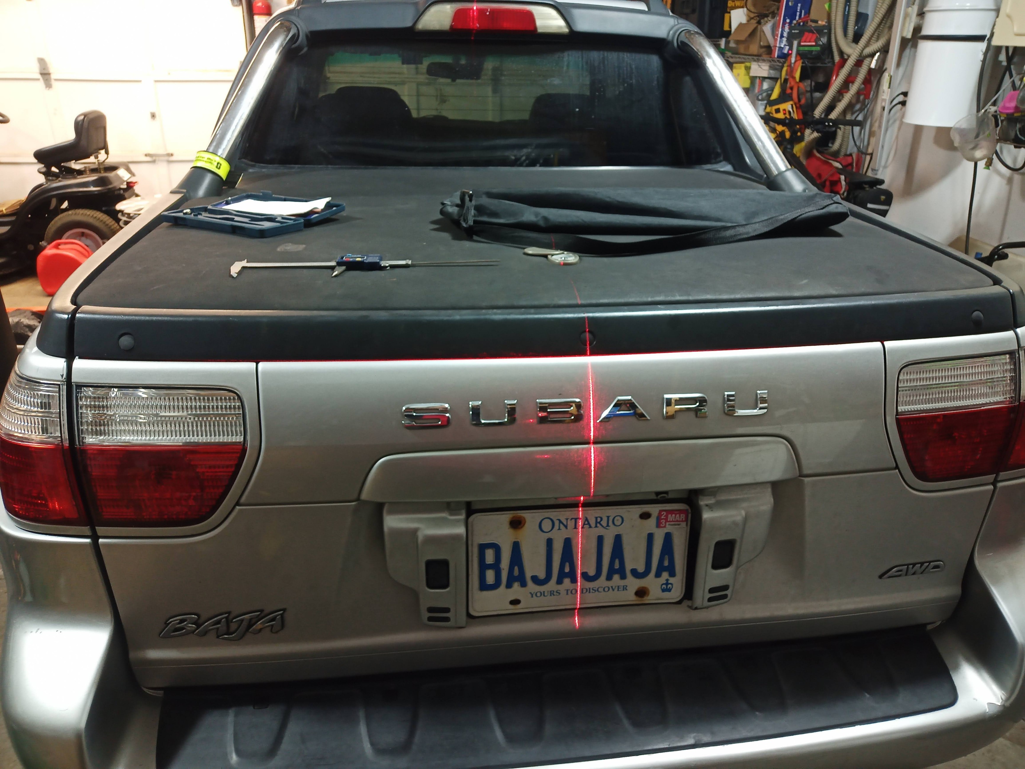

Re: Tailgate Nameplate Locations
"SUBARU" Letters:
50.5mm from top edge of letters to top of metal part of tailgate, measured at the center of the tailgate (based on center of circular plastic trim piece fastener)
The top edges of all letters are coincident and horizontal

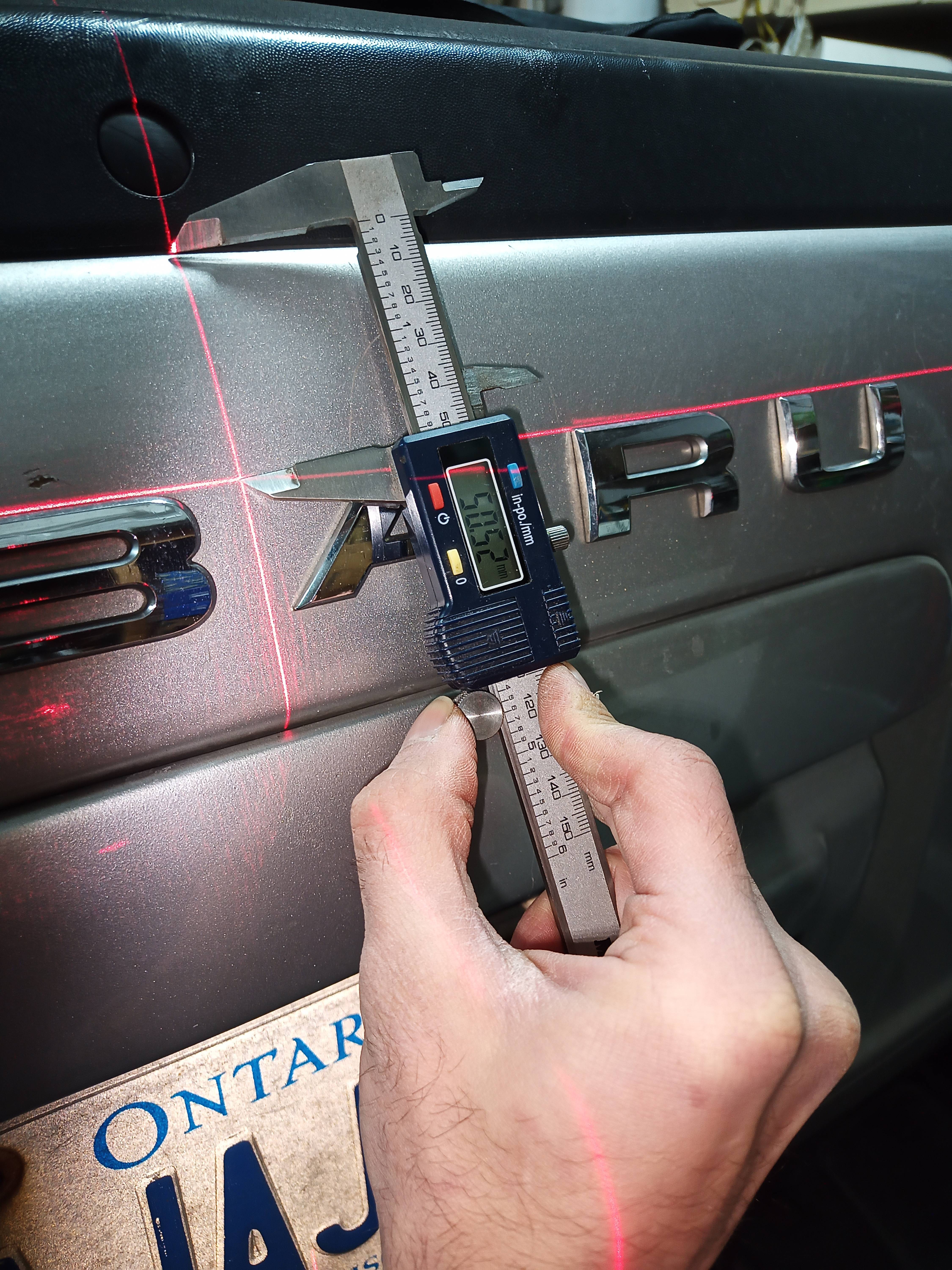

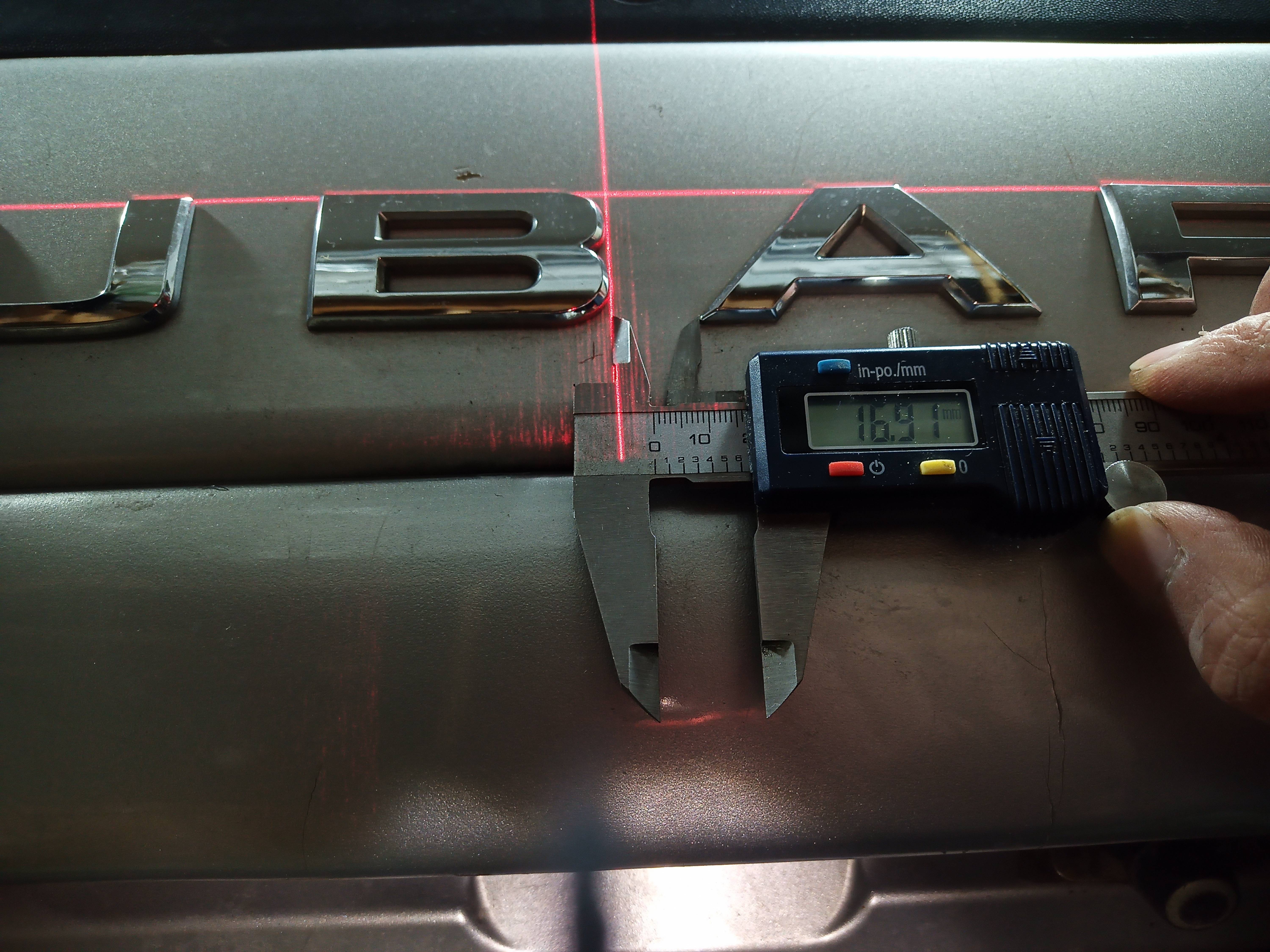

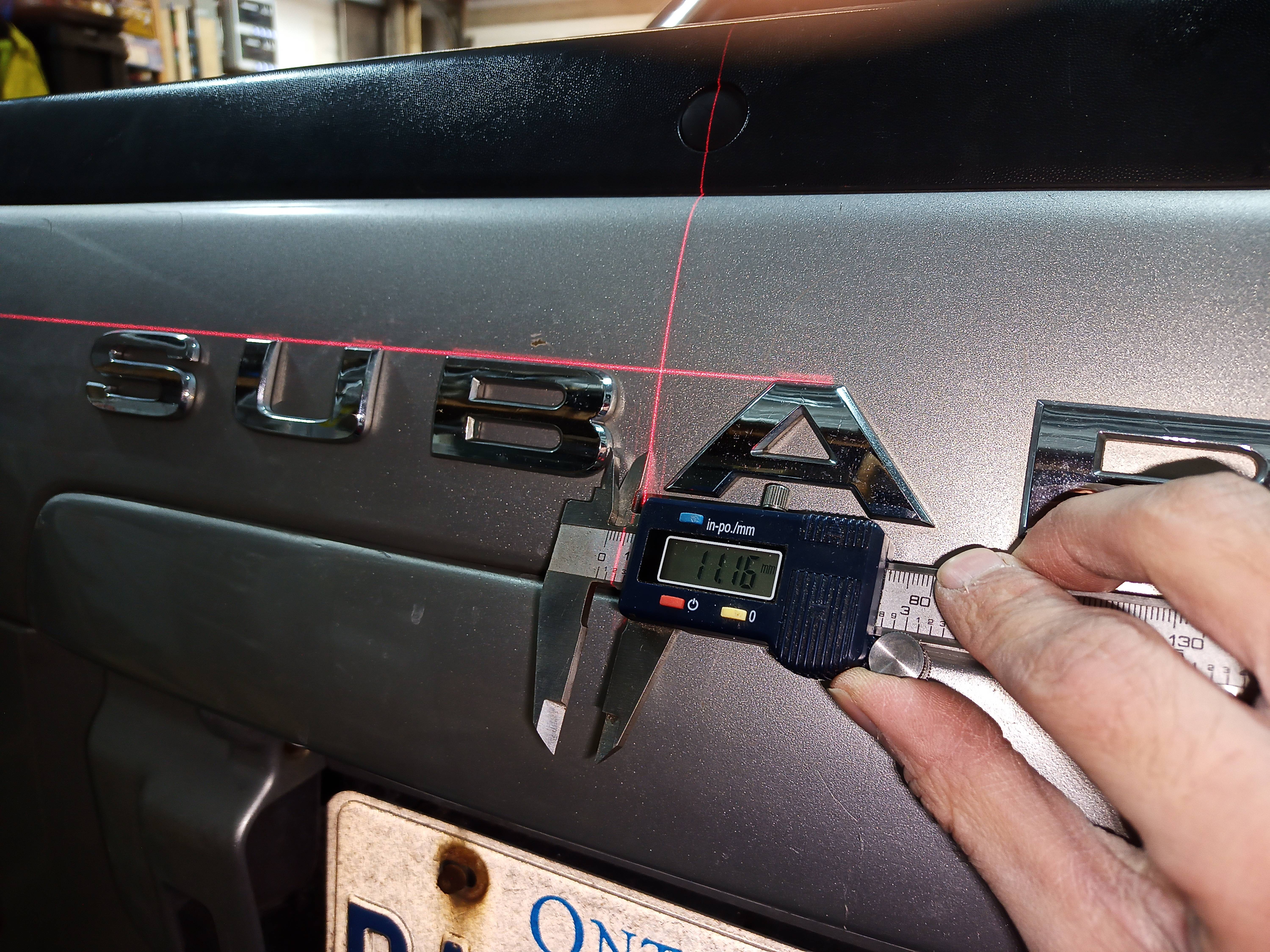

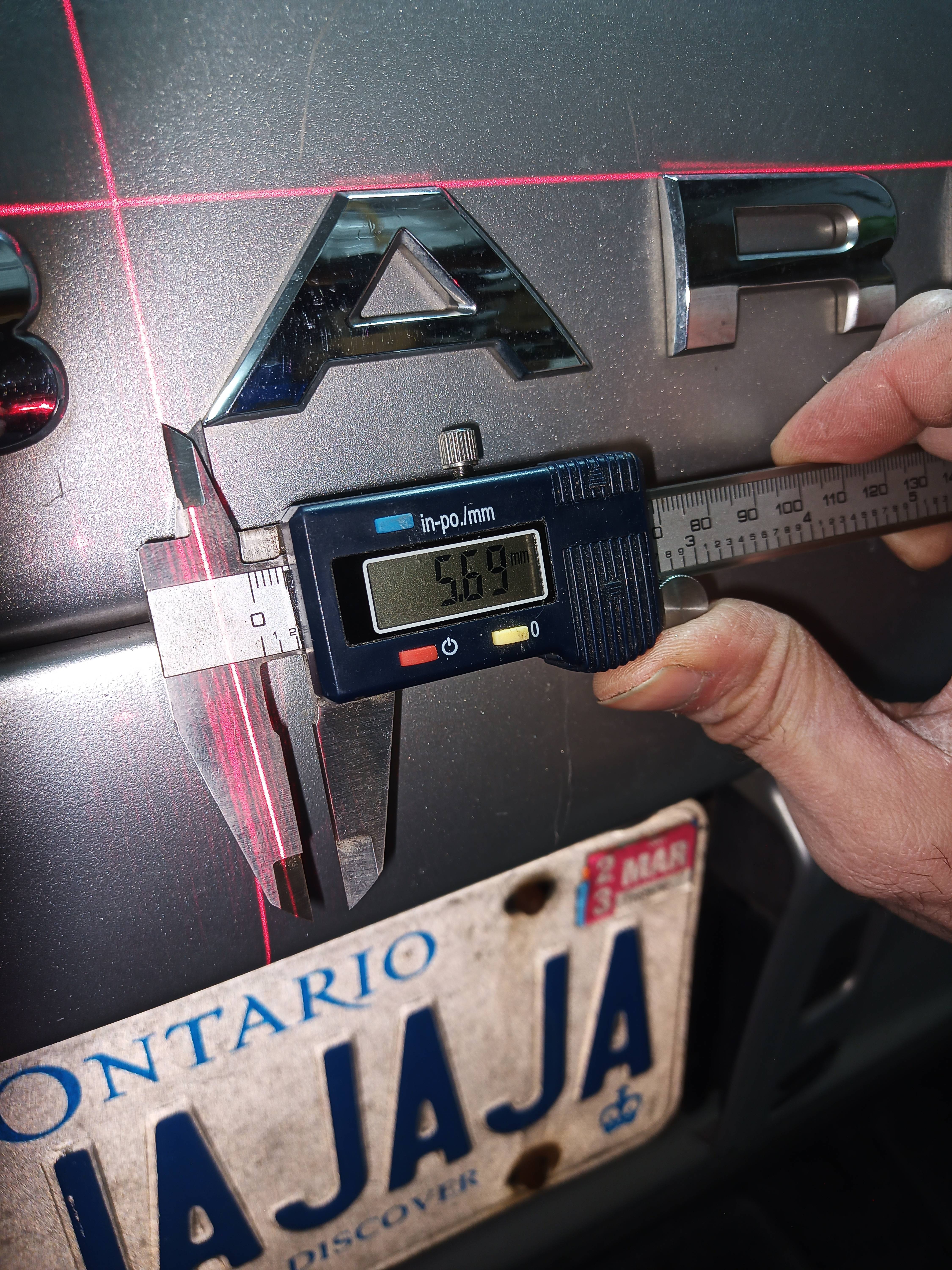

"SUBARU" Letters cont'd:
5.7mm from vertical center to bottom-left corner of "A"
11.2mm from vertical center to right edge of "B"
16.9mm from right edge of "B" to bottom-left corner of "A"

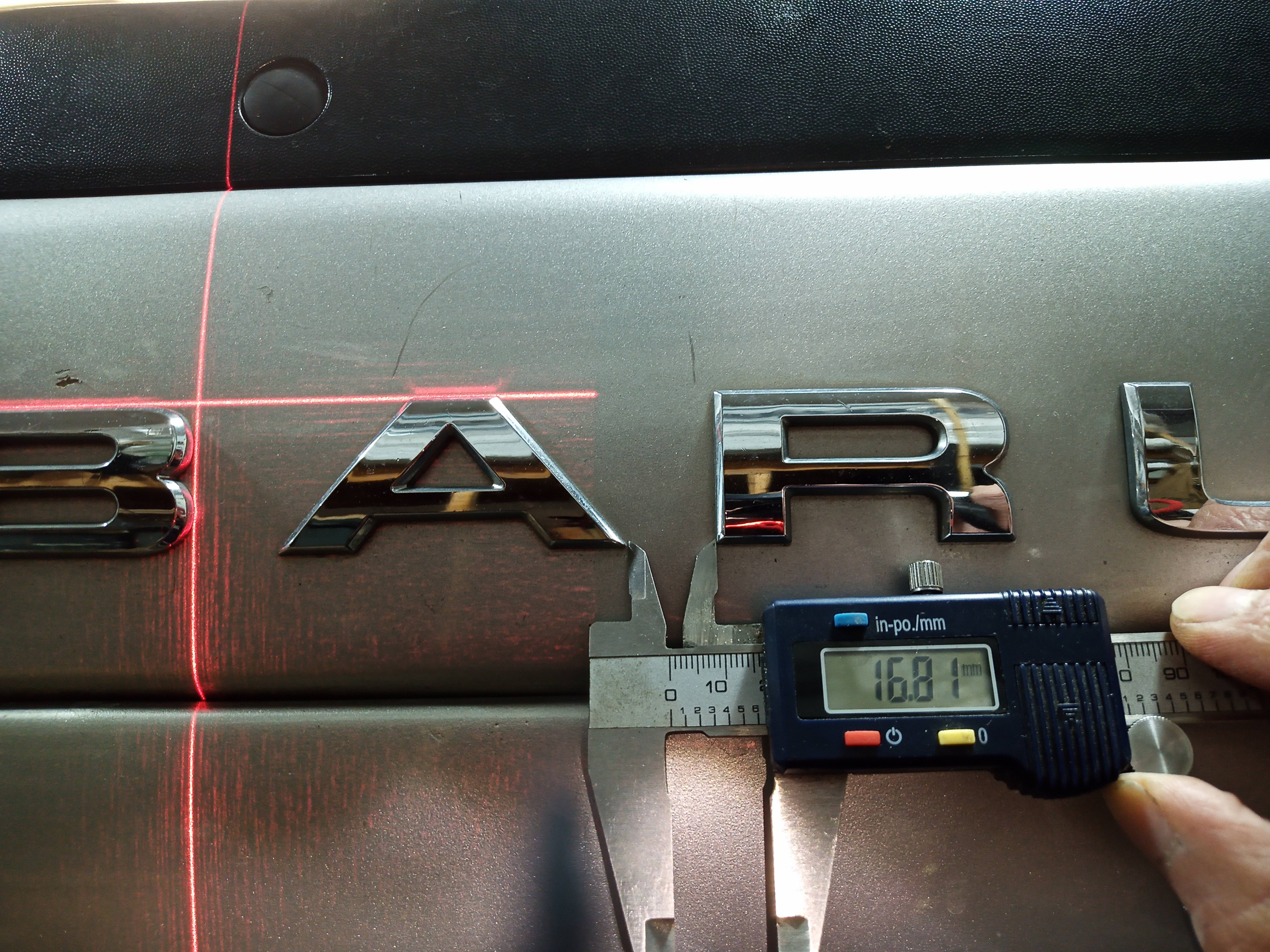

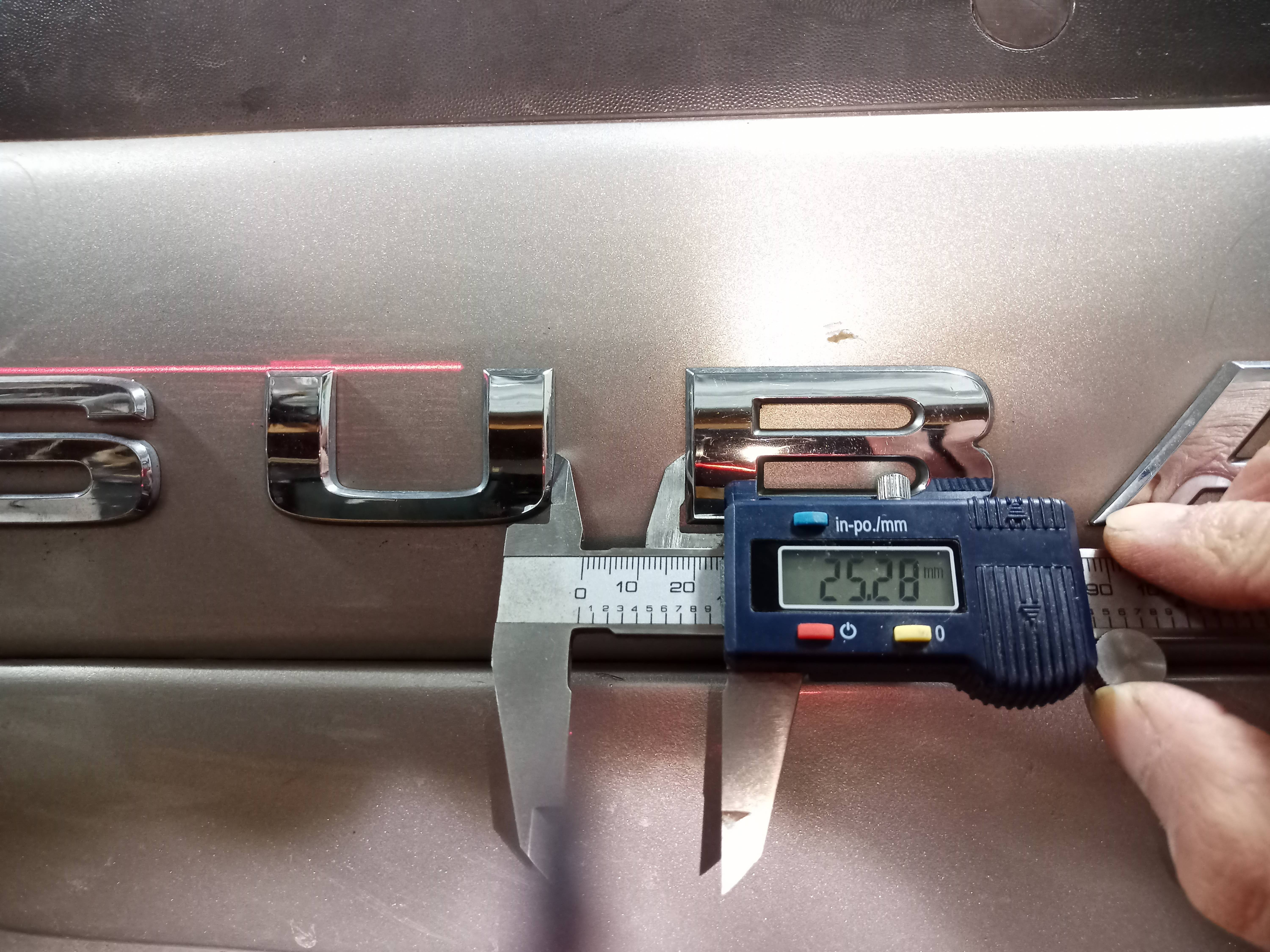

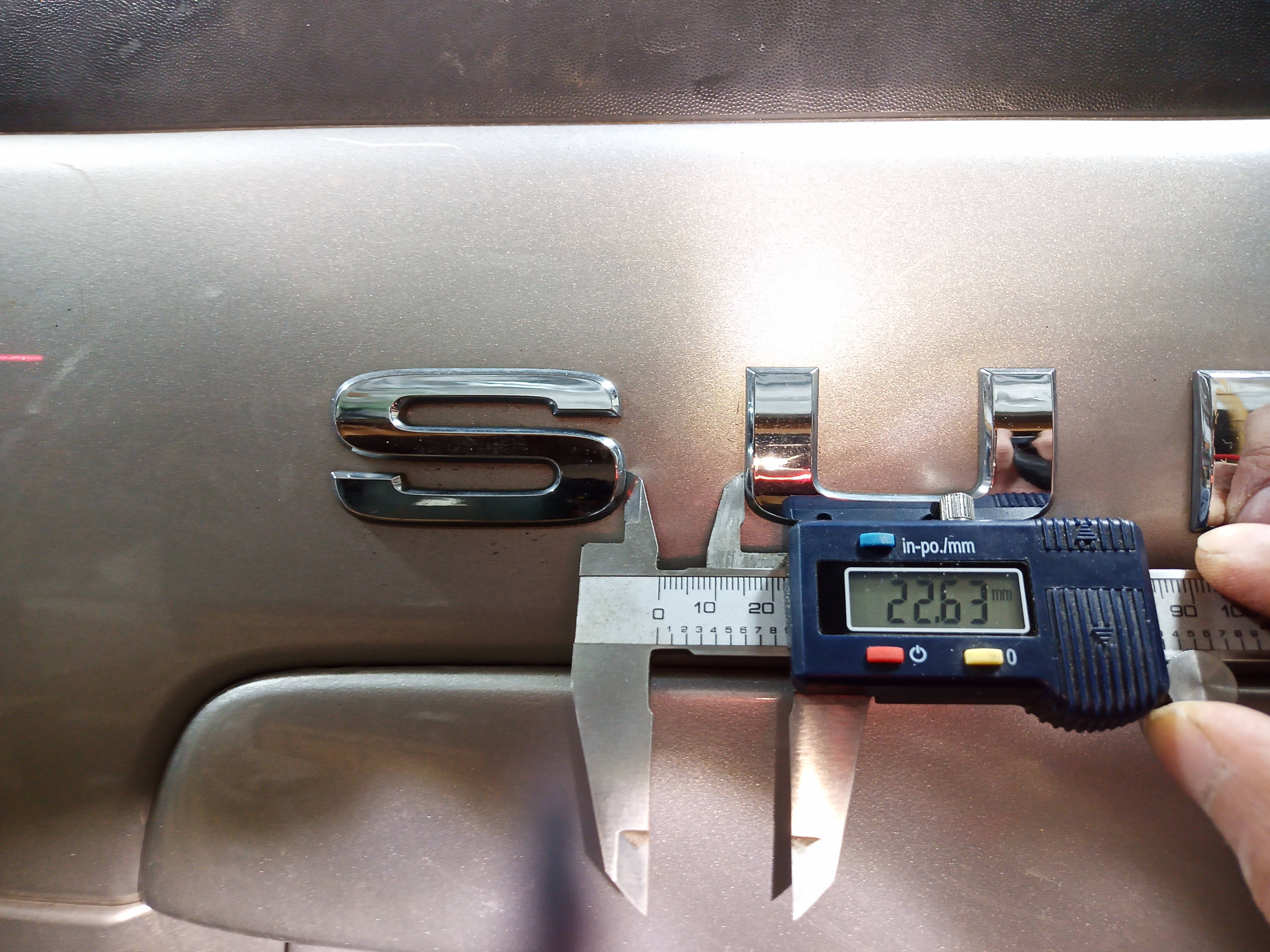

16.8mm from bottom-right corner of "A" to bottom-left corner of "R"
25.3mm from right edge of "U"(1) to left edge of "B"
22.6mm from right edge of "S" to left edge of "U"(1)

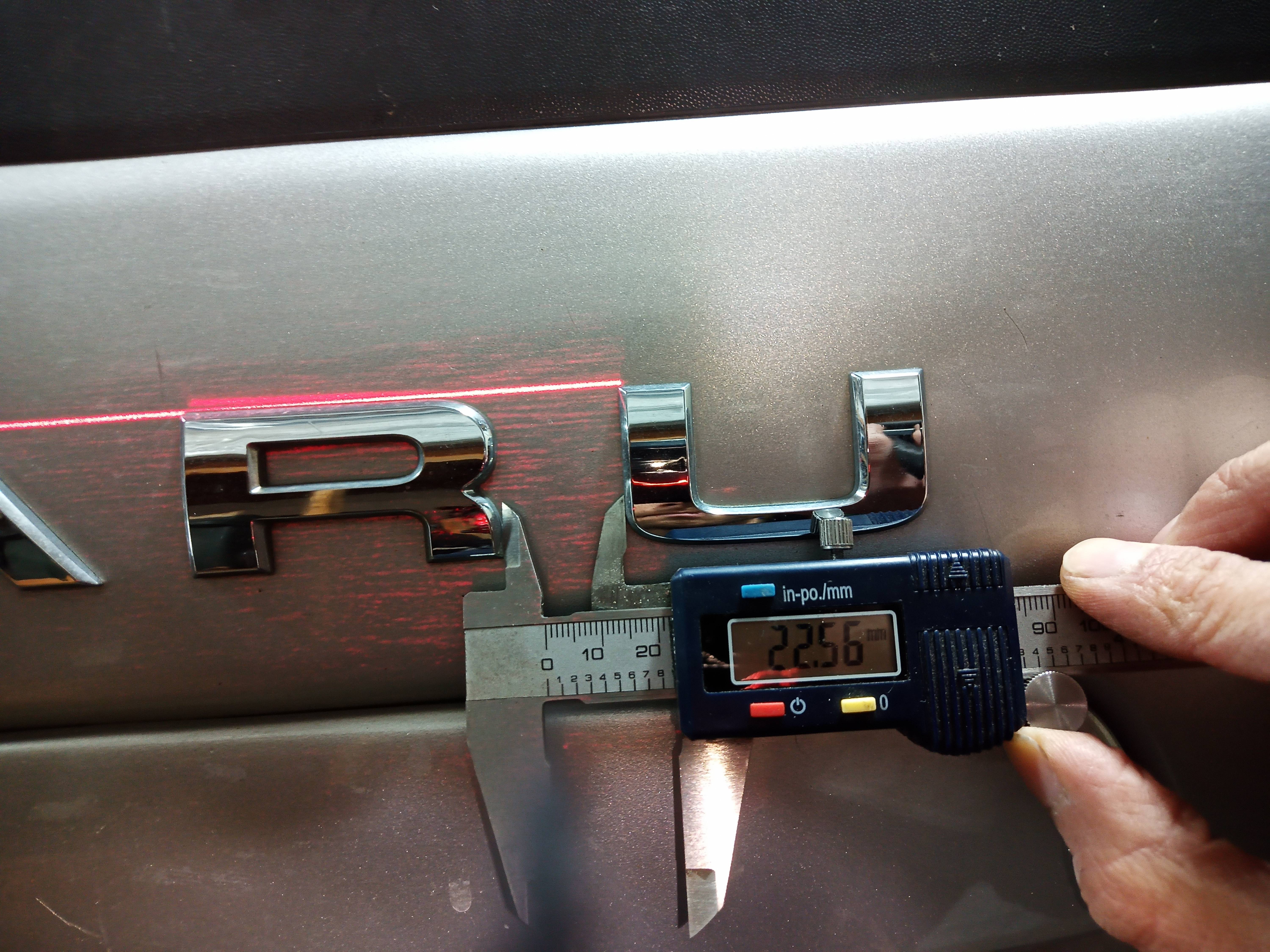

22.6mm from right edge of "R" to left edge of "U"(2)
That should be everything you need to locate the badges, right? LMK if you need anything else.

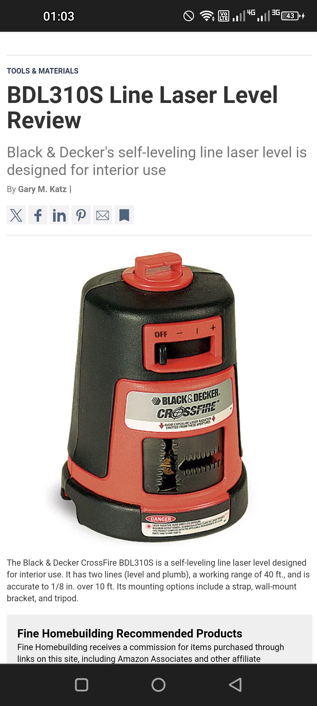

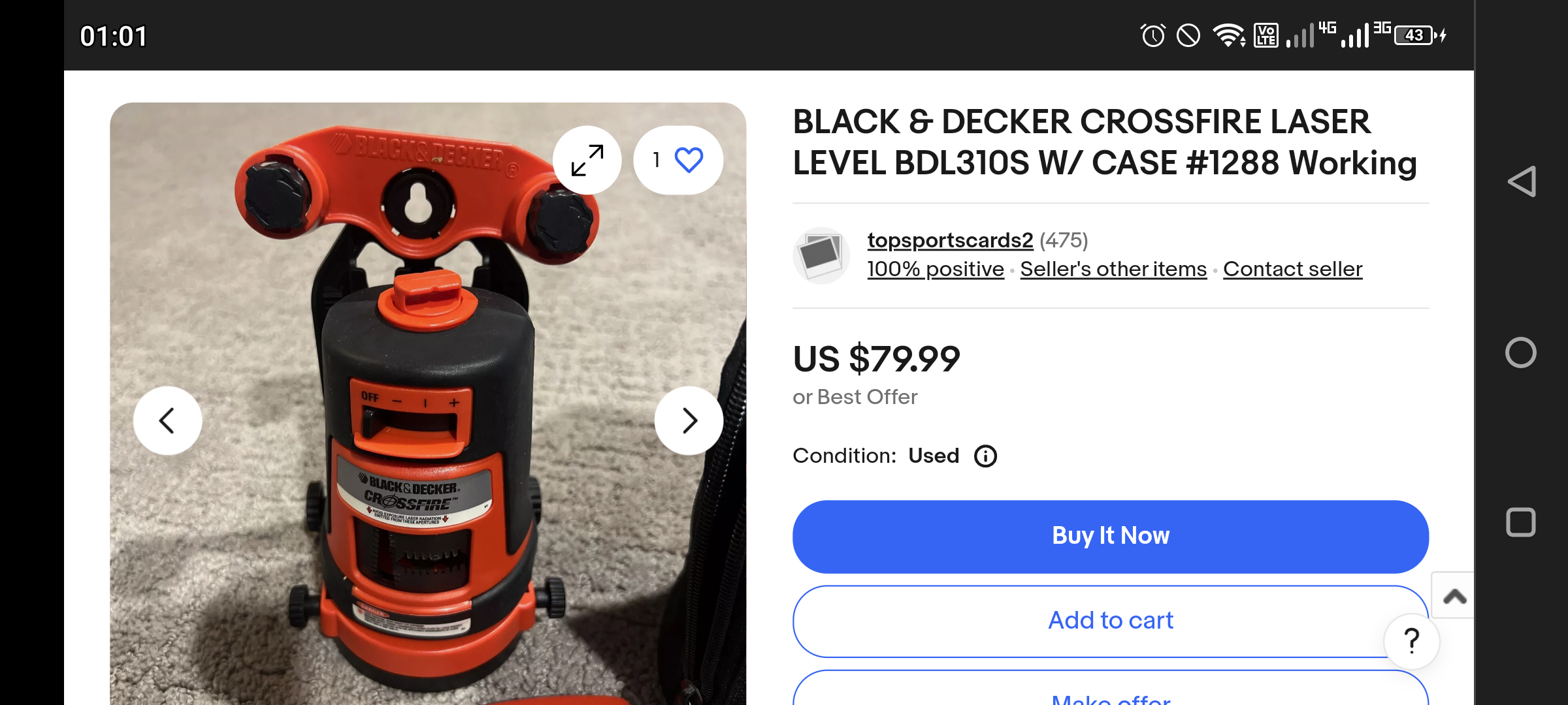

Wow. I couldn't have asked for better measurements and that should certainly be everything I need. That laser level looks like a nifty tool. I'll have to get one of those. I was going to make all of the edges with painters tape and expo marker but I like the lasers much better. Would you recommend the one you were using?
Love the license plate, btw.

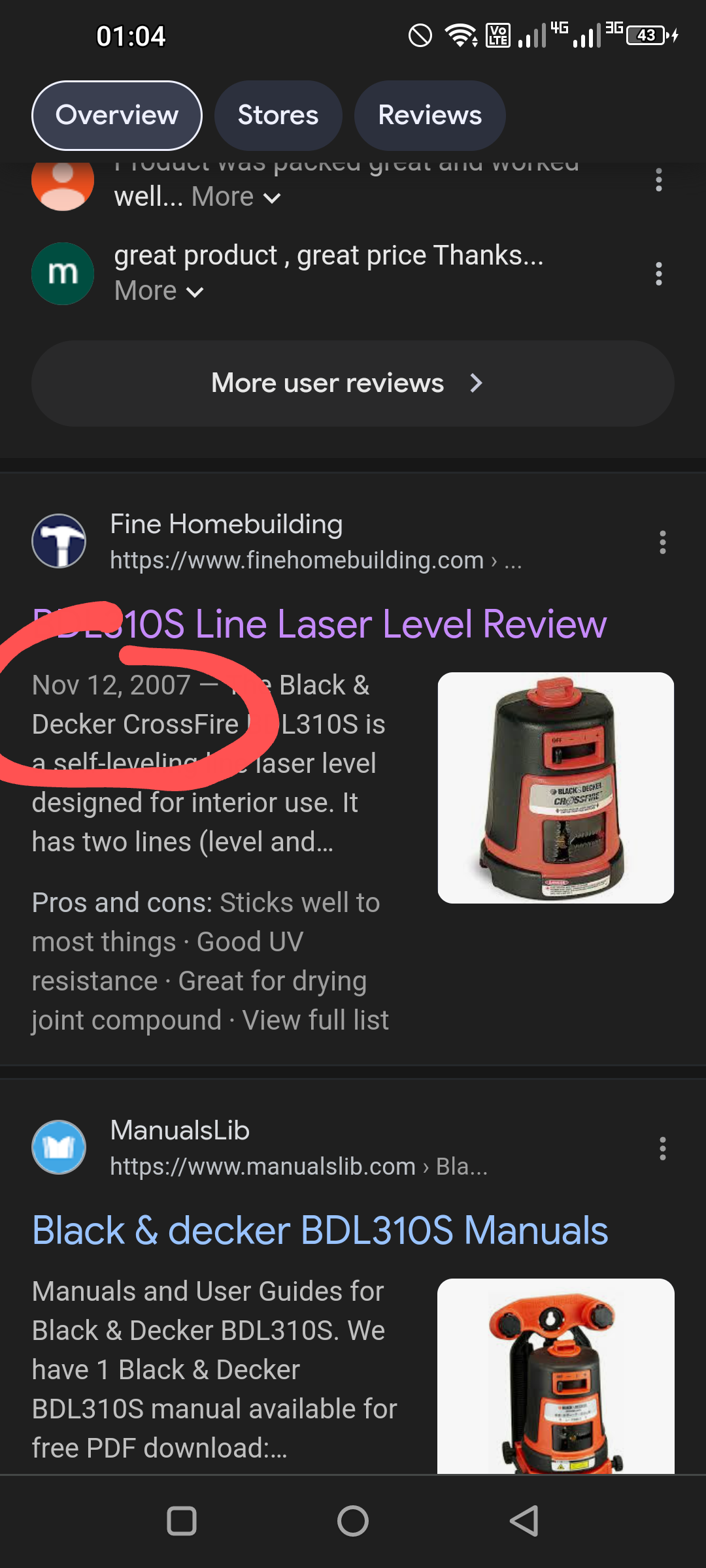

The laser level I'm using is probably around 20 years old by now, so it's long been discontinued. Plus, I'm sure newer models will have more features than this one, but I don't have any experience with any other models yet, so can't comment on or recommend any in particular. I placed mine on a camera tripod, which made it very easy to adjust the position, and especially the height.
Thanks! My brother actually thought of it. We shared the car 50/50 back in 2010, until I bought out his half about five years later. Originally we asked for "BAJAHAHA", but surprisingly it was already taken in Ontario. I actually like the current one more, now, so I'm glad we didn't get our first choice.

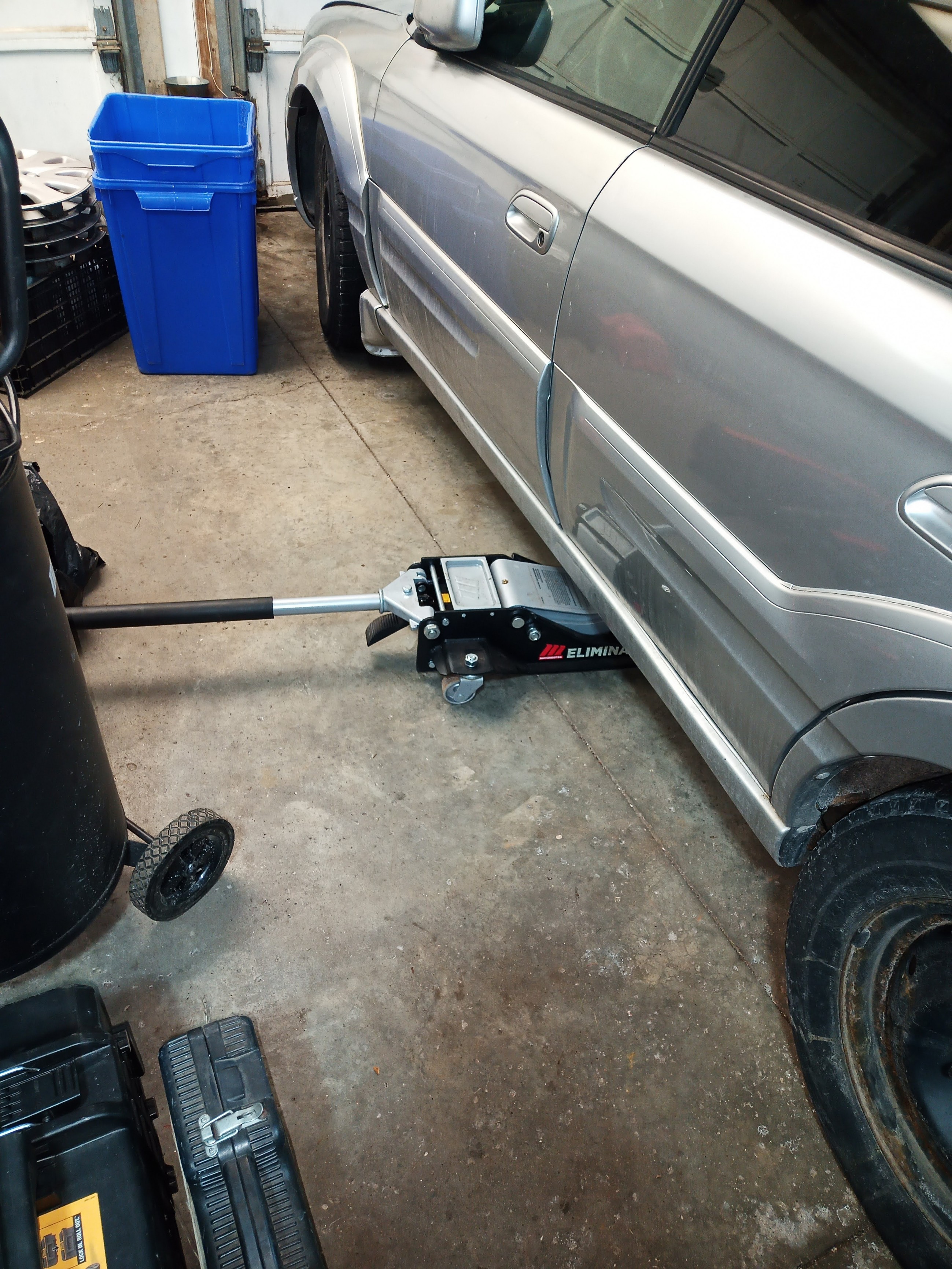

One thing about the laser levels is that they are level relative to the earth, not to the tailgate, vehicle, or floor, so you may need to jack up one side to compensate.

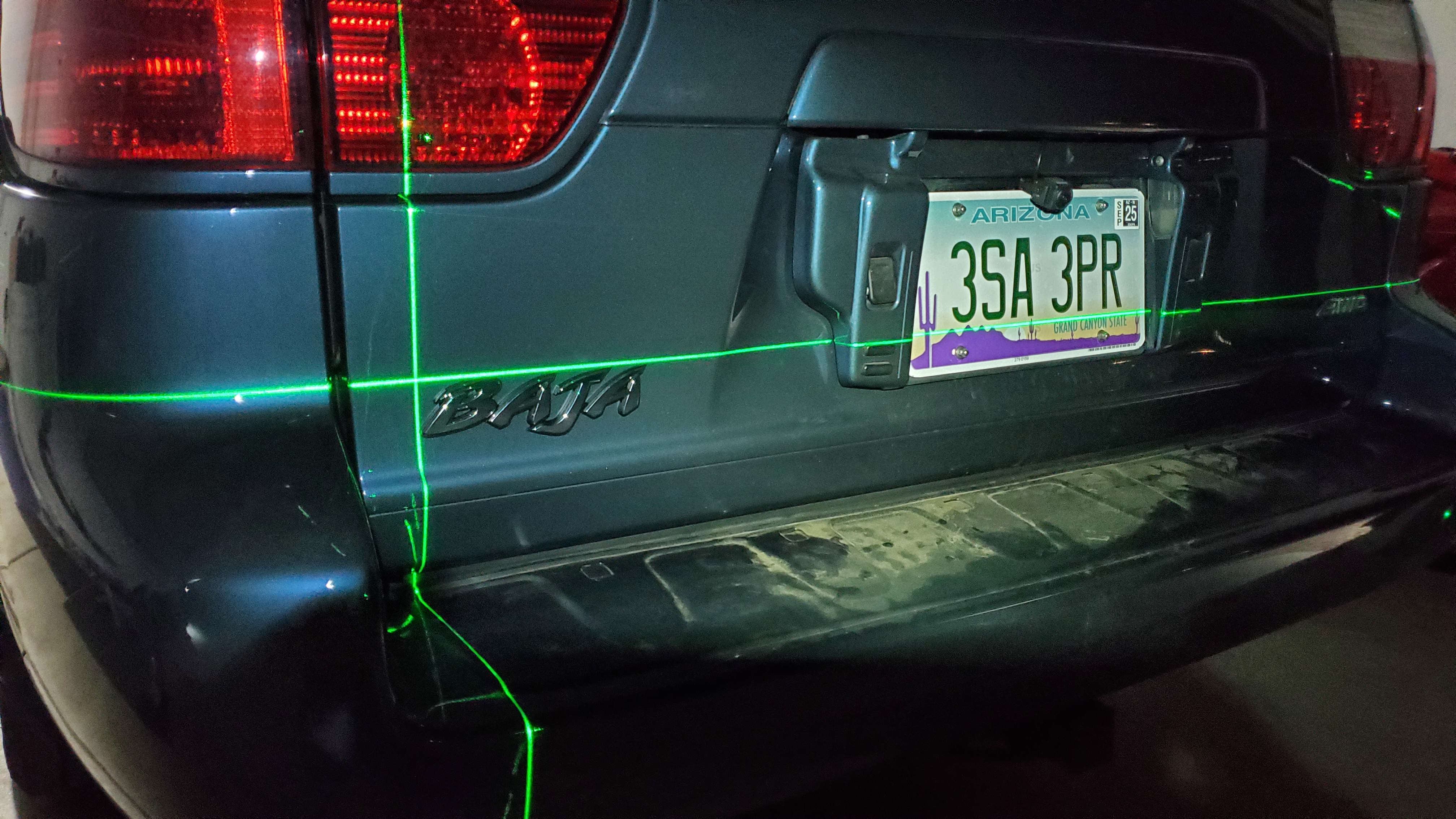

Post by TenPA »

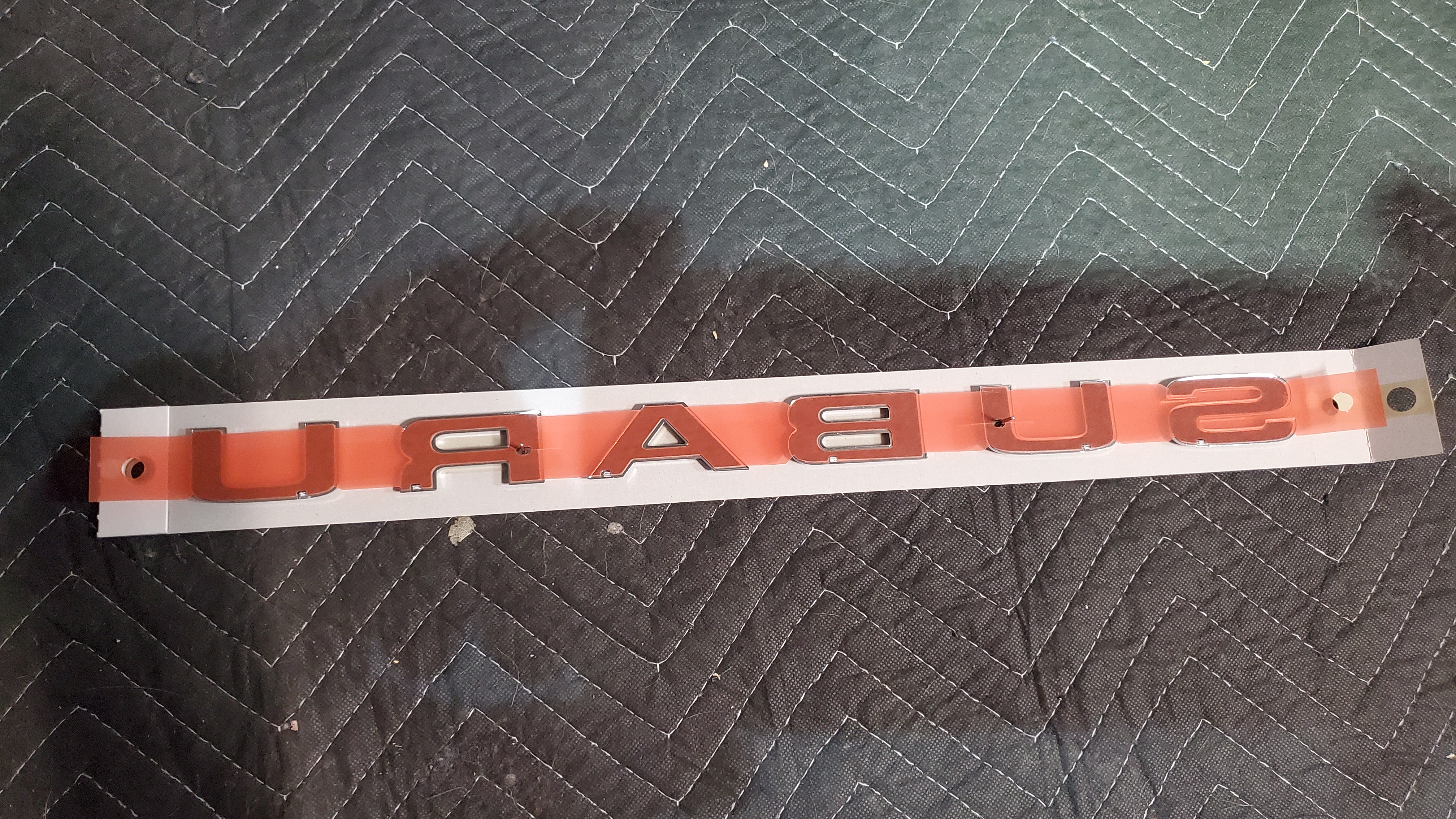

It turned out great. Bought a laser level and everything. Ordered another "SUBARU" nameplate set and it came stuck to a piece of paper for easy install. The "S" is like 5 mm too low, but I figure that's within tolerance. The cardboard paper must've been bent or something.
