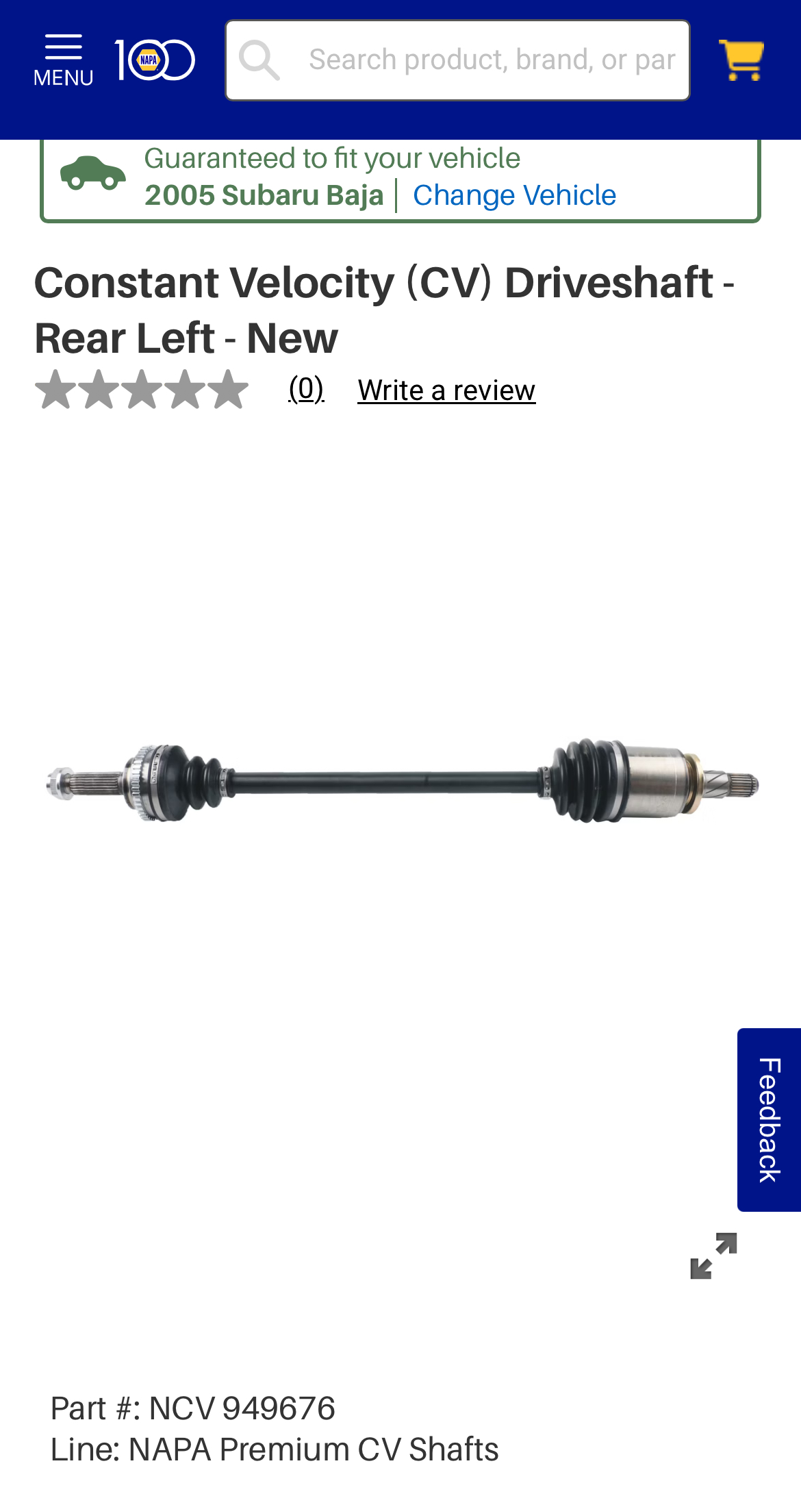

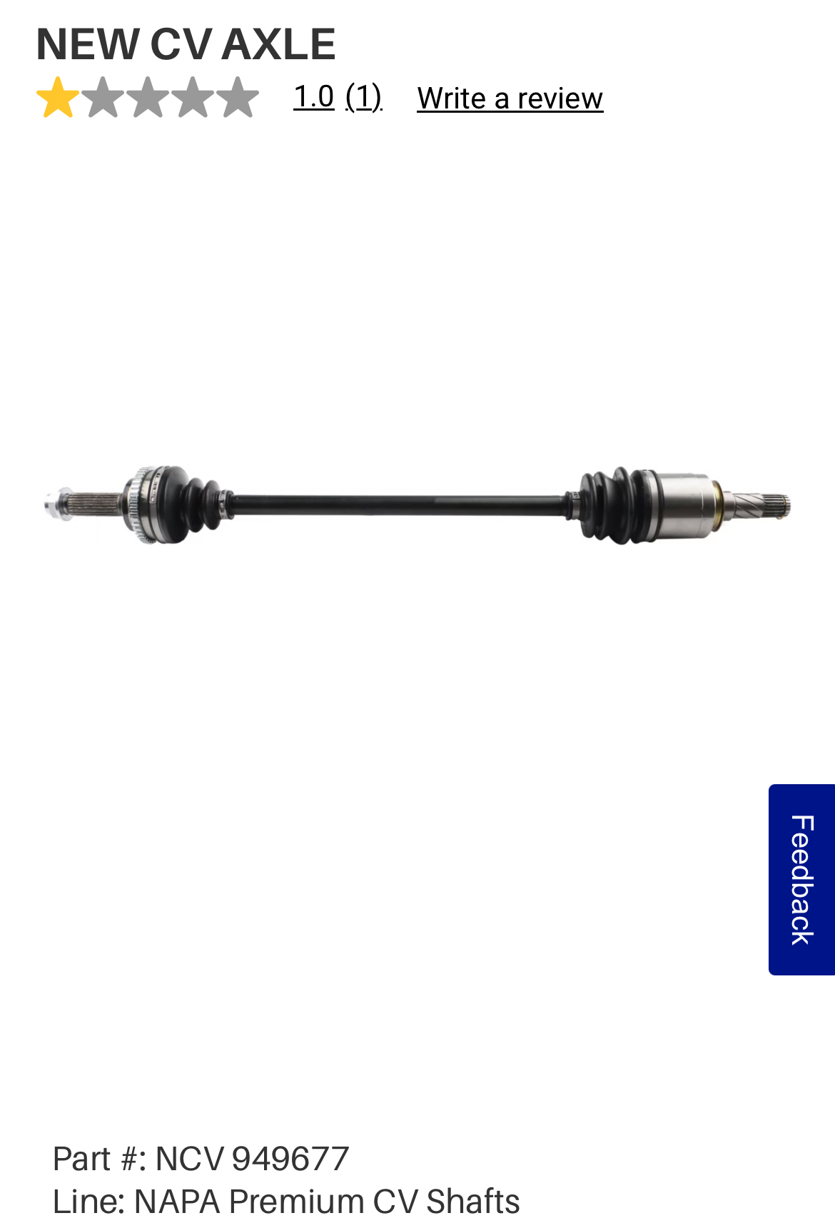

Did some searching for you. Per NAPA:
Right Rear - flutes curve away from view.
Left Rear - flutes curve towards viewer. So that, when placed end to end, they would be directional and perfectly in line with what @anarchy1024 stated.
